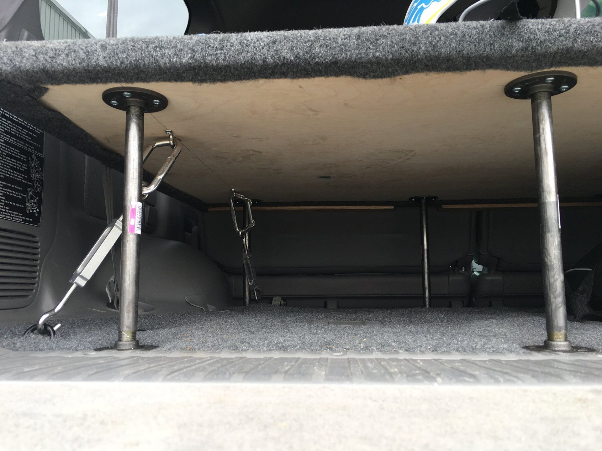

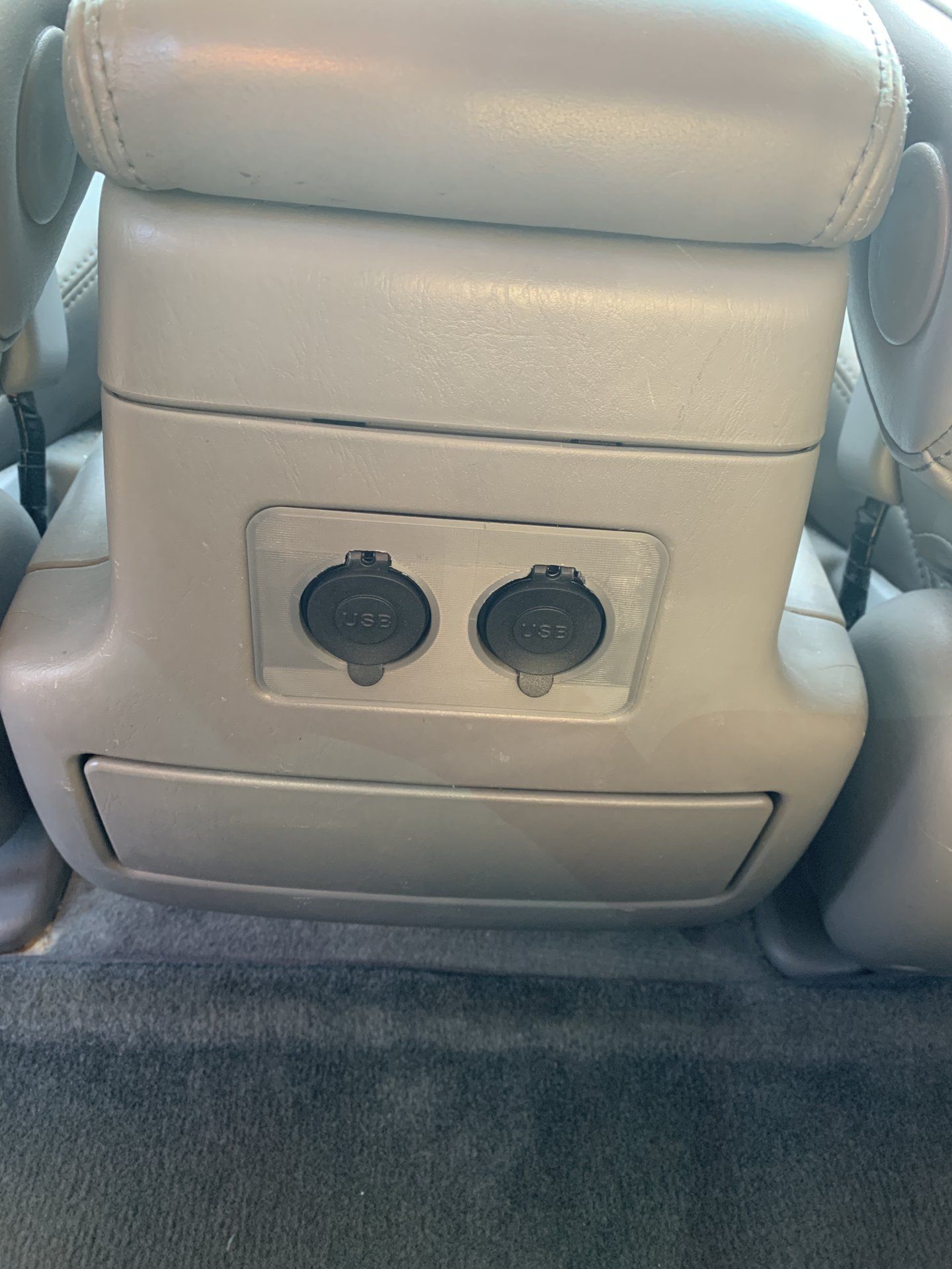

Installed one of BenCC usb housings in the back of the arm rest and put the platform in. Doing some wishful thinking that camping season is here.
It looks great. Did you make the platform?
Thanks. I did. It’s pretty basic but it works great for my needs. Weighs maybe 25 pounds and I can install or remove it in 10 minutes. Some plastic bins fit nicely underneath to make it a poor mans drawer system. I still use the 3rd row seats occasionally so it’s nice that I can swap stuff around easily.

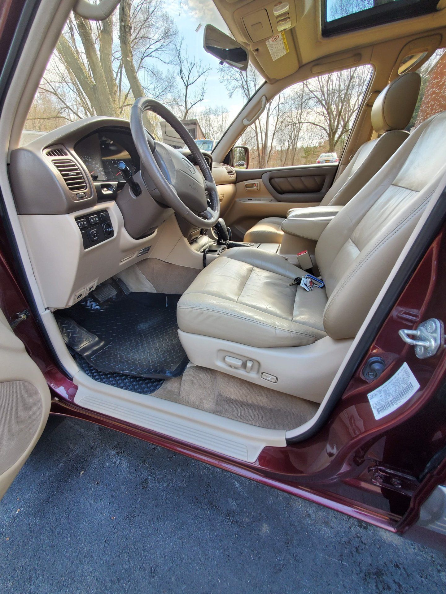

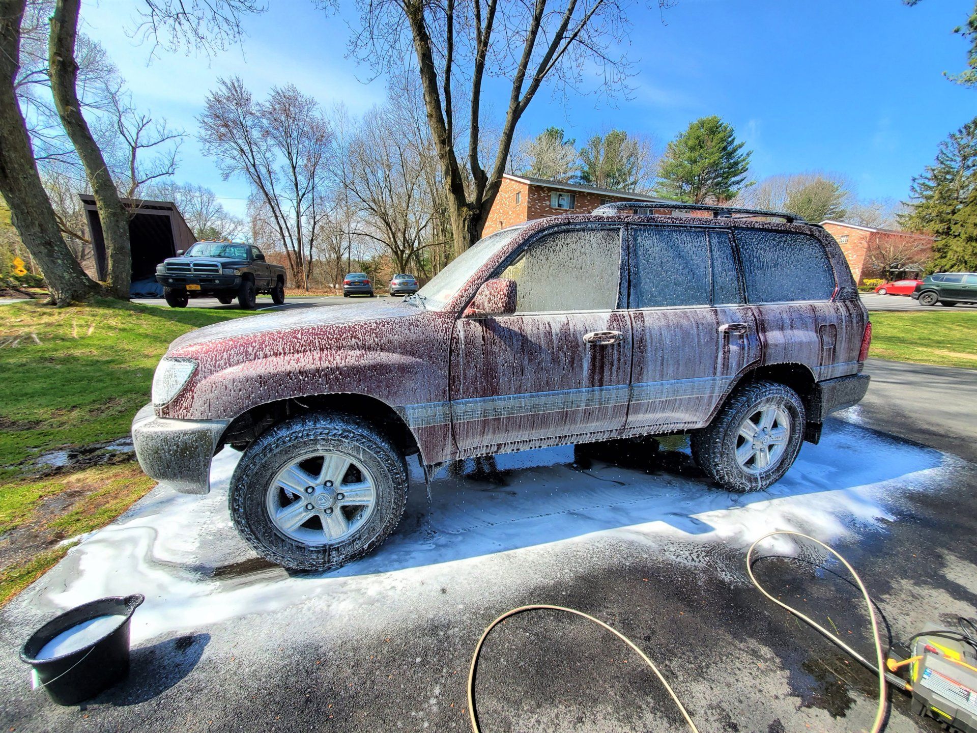

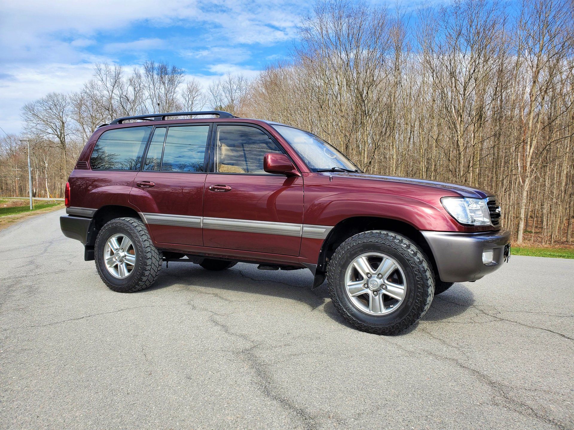

Took this past Sunday to do a full detail (the first extensive one this season), more social distancing but at least I enjoyed myself.
Used the foam cannon and turned the cruiser white. Did a mild buff and polish with a full coat of sealant, detailed the engine compartment, and did a quick interior clean.
Thursday I'll get Nitto Ridge Grapplers installed.

What floor mats are those?
Nice!
On the bottom are Hexomats, and the liners are the original 22 year old Huskies my father bought when he first bought the truck!

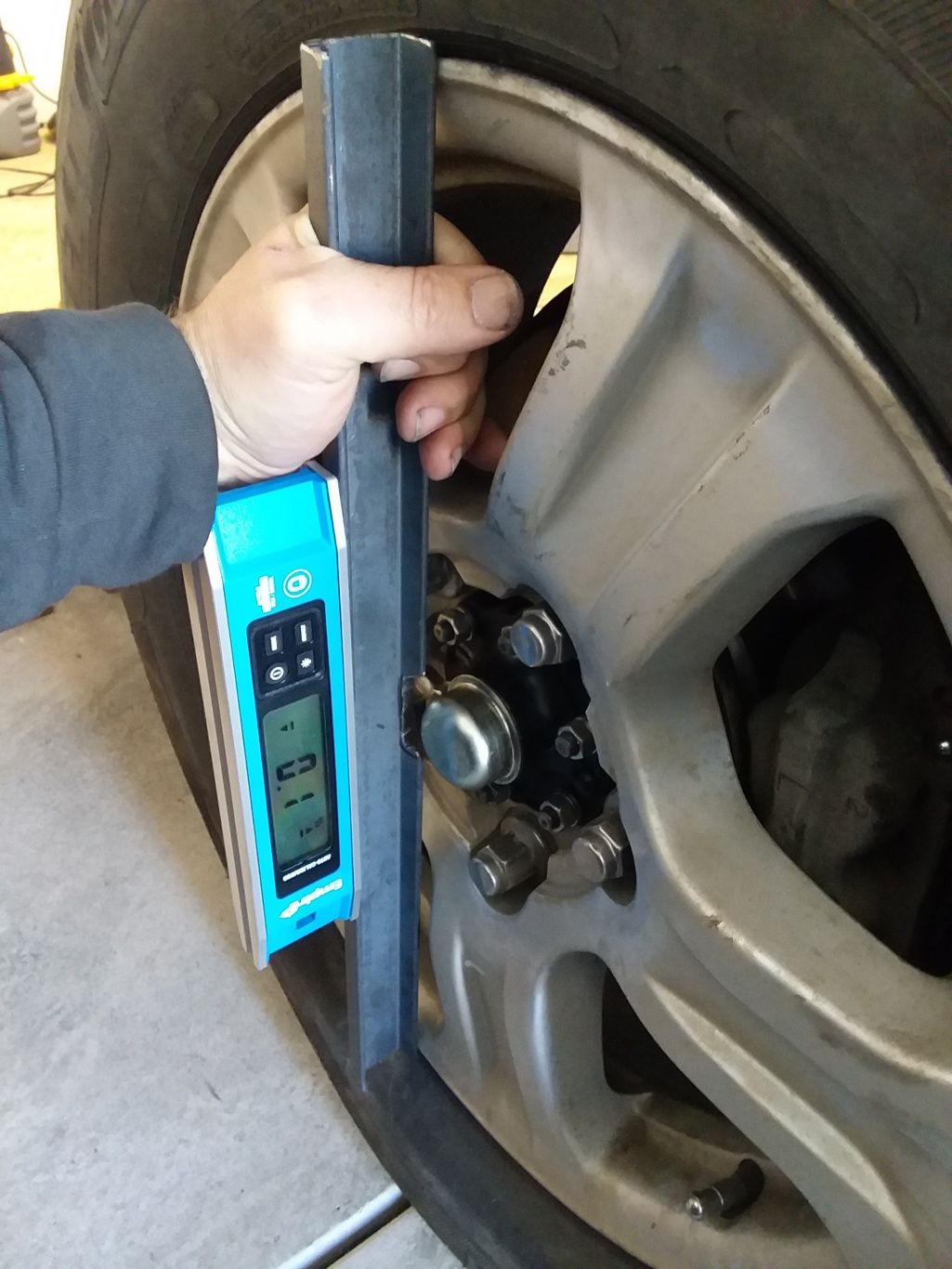

did a DIY alignment after the ironman lift. adjusted caster camber and toe. typical alignment shops don't even bother with camber or caster but still charge you as much as 100 bucks just to set the toe. it took me a hot minute to do all the adjustments as it's my first time but i got a little more caster out of her and she is driving great. it really wasnt too far off with only a 2" lift but it definately is an improvement.
What did you use for materials? I have 4 feet, and was planning to use 3/4 birch. I see you used 6 feet, do you think that was necessary?
12 - 1" floor plates
6 - 1" black iron pipe at 12" long
2 - 1/2" birch plywood - one at 52x41 (main platform) and one at 52x32 (extension for sleeping)
4 - turnbuckles
4 - carabiners
4 feet would probably work with 3/4" plywood. I went with 1/2" to save weight so I went with 6 feet to be safe.
