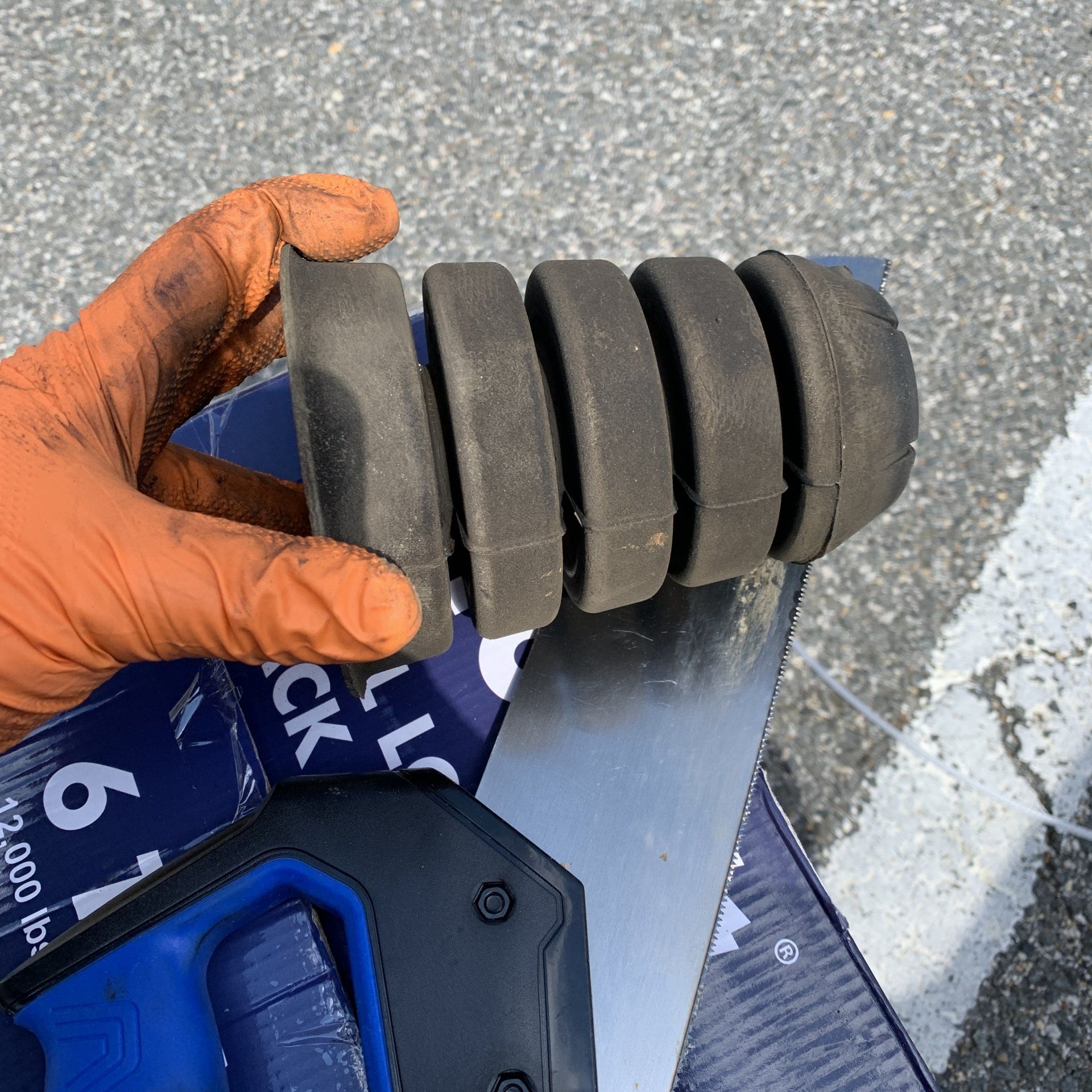

Last summer, we took a road trip to the beach with friends and the truck sagged hitting the rubber helper springs on medium-ish bumps on the highway. It wasn’t horrible but not great— the one downside of a non-AHC truck. Faced with the need to tow the FJ62 about an hour earlier this year to @OTRAMM I wasn’t confident in the 100 doing it based on that road trip experience.
It probably would have been fine but I wimped
out and rented a uhaul truck in addition to a trailer. I’ve towed that much weight before but never when it was close to or slightly over the limits of the tow vehicle.

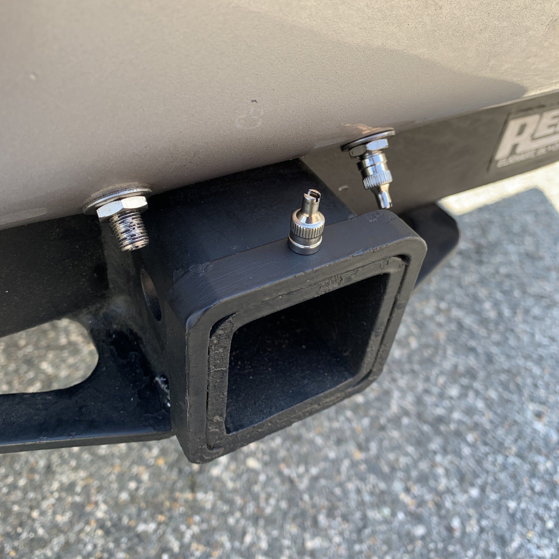

So this is my solution because I didn’t want to loose the buttery ride by adding heavier duty springs as the truck is empty most of the time. I love that I can dial up the stiffness in 5 minutes with a bike pump. Elegant and ghetto at the same time 😂
I know I’ll sacrifice some flex but this is how the truck is usually used.

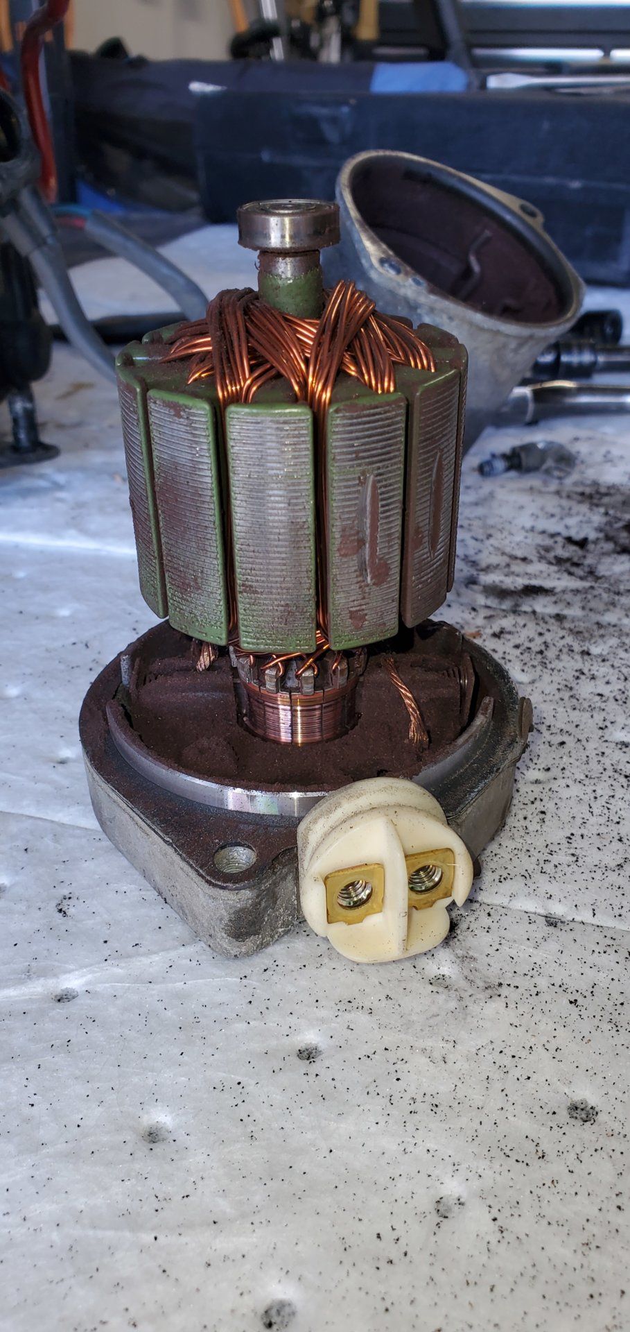

Well the brake booster motor gave out on me the other day. Managed to find a wrecker with one out of a 2002 4runner. Just swapped out the motor like for like. Easy job. Got lazy and kept the drivers side panels under the steering column on and just used a wobble adapter and some extensions. Here's a pic of the old ones insides vs the new to me one. I think I'm going to re build this one and keep if it decides to act up again. View attachment 2268172View attachment 2268173

Thanks but I already got it all fixed up. Took it apart and it was pretty nasty. Swapped it out with one from an 02 4runner with abs and works like a charm! I think I'll rebuild my old one and see if anyone is interested. Appreciate the thought though!

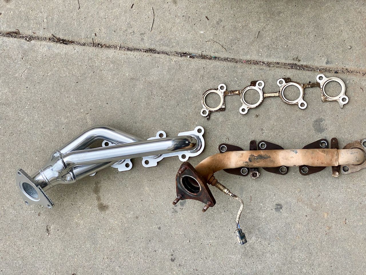

Dropped the front diff, sending it over to Cruiser Outfitters for a gear change.
Then a header fell out...
Some backstory—I bought the headers and all the hardware 9 months ago and was seriously considering just dumping them on eBay after realizing how difficult the drivers side header would be. It's tough to tackle larger projects in mine because I don't have a garage, and it's my daily.
But then coronavirus...and a ton of downtime. I don't have to drive it anymore (and couldn't anyway, without the front diff).
Without the driveline, it's stupid simple to get the old headers off from underneath. Both headers off in about an hour—no broken studs, no rounded nuts...finally, the effort to get a CA truck paid off. Installed the PS manifold in another 30 minutes, and...well, the devil himself invented the DS Doug Thorley manifold. A few of the studs have almost no clearance to the header tube, so it's 1/8-1/4 turn at a time to get a nut back on. And forget about torque specs—gutenteit will have to do.
One nut left to go—got tired last night and gave up.
