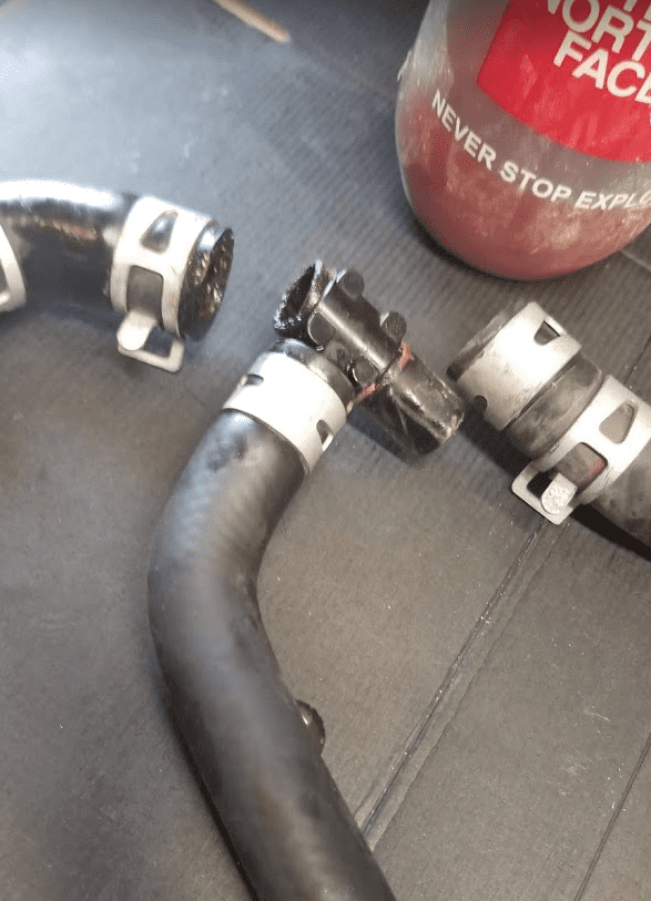

New heater T's last night. Hot side broke during removal (2006 LX w/170k, probably never done before). Appeared a little leaky so I'm glad I finally took care of this during confinement. Replaced all associated hoses as well.

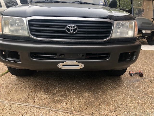

Busy couple of weeks. Installed Yellow Box and dialed them in for the KO2s. Then had Slee install a ComeUp 9.5rs winch and Factor 55 fairlead. Bought some recovery more recovery gear to be ready for the desert. Then plugged in OBD reader and found the pressures in front came up to where they should be and back is still a little light after King Springs, but should be perfect when I get the truck loaded down. Purchased a first aid kit with my HSA account and filled the drawers.

Hardest part of the whole project was cutting the hole in the bumper! And I guess second hardest was cutting the metal bumper frame but all in all pretty easy job

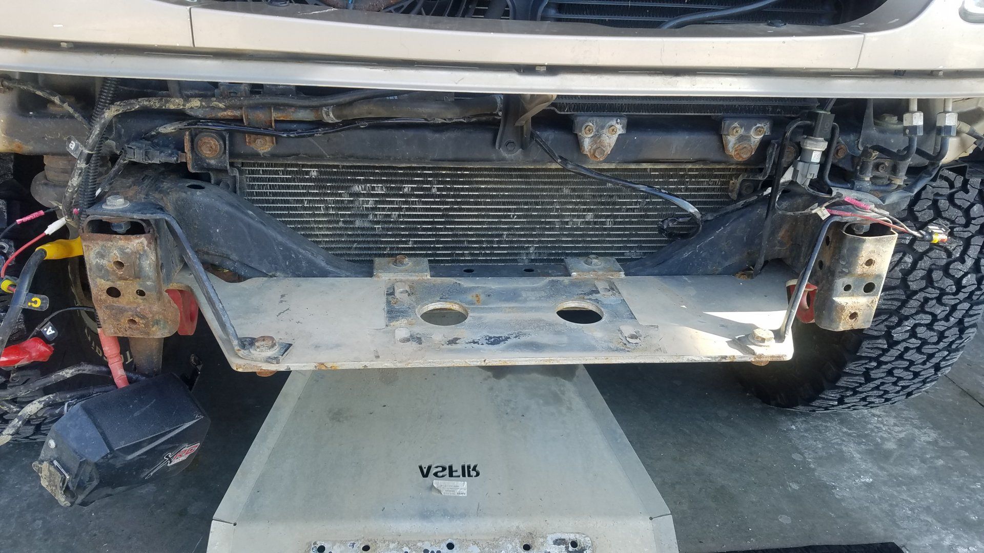

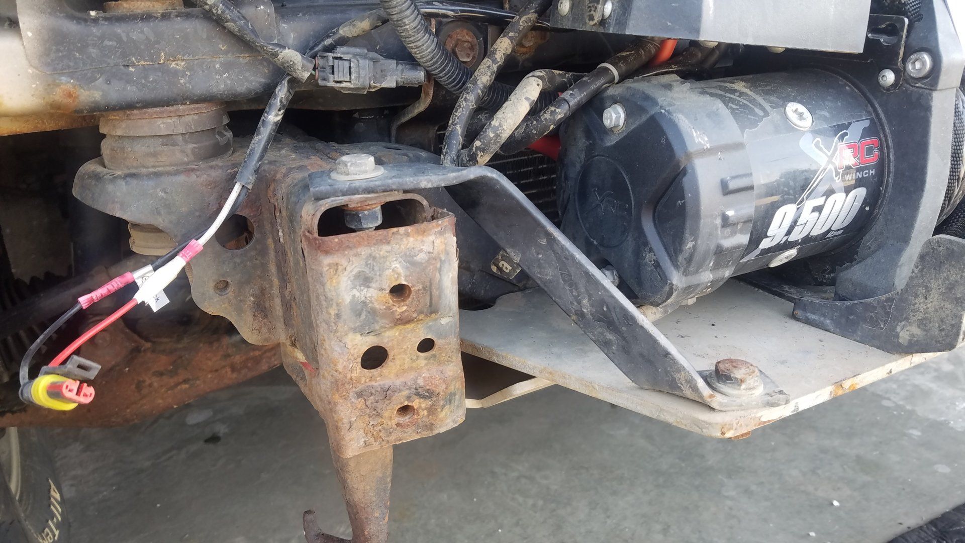

Looks clean! Which winch mount did you go with? When I was running the TJM one it had an extra brace on each front corner:
Yes it’s a TMJ, no extra braces on the corners though. This one looks a lot like the trail tamer one that used to be available. Solid as a rock and very very easy to mount. I was expecting a little more difficulty but honestly if you have a sawzall the bumper frame is easy to cut. The actual hole in the plastic bumper was the hardest part and that’s only because you don’t get a second chance to recover from a mistake. So I installed the mount (without the fair lead) and then replaced the bumper cover to its normal position and then reached inside the winch Mount and used a sharpie to outline the opening in mount and the bolt holes. Then took bumper back off and placed the fair lead inside the bumper cover and traced the outside of the fairlead to give me exact lines to cut.

Don't want to sound any false alarms but with the winch mounted feet down and having no bracing at all at the outer edge will make me worry about mount. Everytime you pull, there will be a lot of torque on the plate and nothing to stop it from twisting since it is only mounted/braced on one edge. Having two extra braces to counter the torque on the leading edge would mitigate that.
Yeah good point. Well the trail tailor ones didn’t have those either but I do see your point. Honestly in my particular application ( I don’t plan to do any crazy stuff that would require extreme winching) for the most part I would only envision straight away pulling but I guess you never know what could happen or what situation you might find your self in. I have two mounting locations on this plate. The under frame mounts ( under the recovery points) and then on top of the cross member so any torsional forces would be mitigated to some degree by the counter locations of those two mounting points but to your point, if I were to say try and hang my rig from my winchline then the upward forces could bend or twist the mount plate. Or really any considerable angled recovery but again, I’m not a hardcore rock crawler so the most I would need is getting unstuck from a bad mud hole 😁

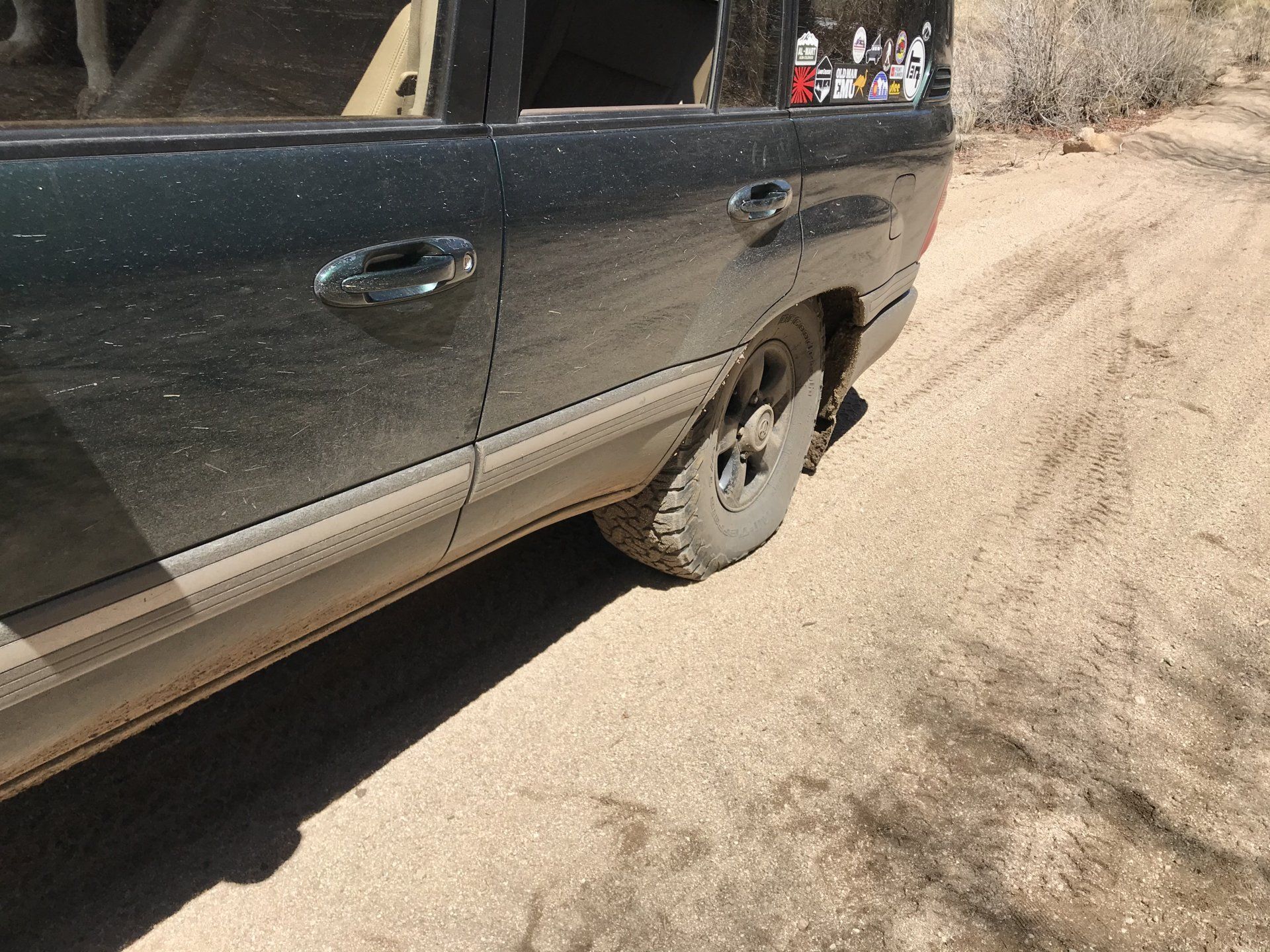

Also installed my hitch due to a upcoming move and pretty much blew out my AHC. The combo really causes a lot of dragging on the ground!

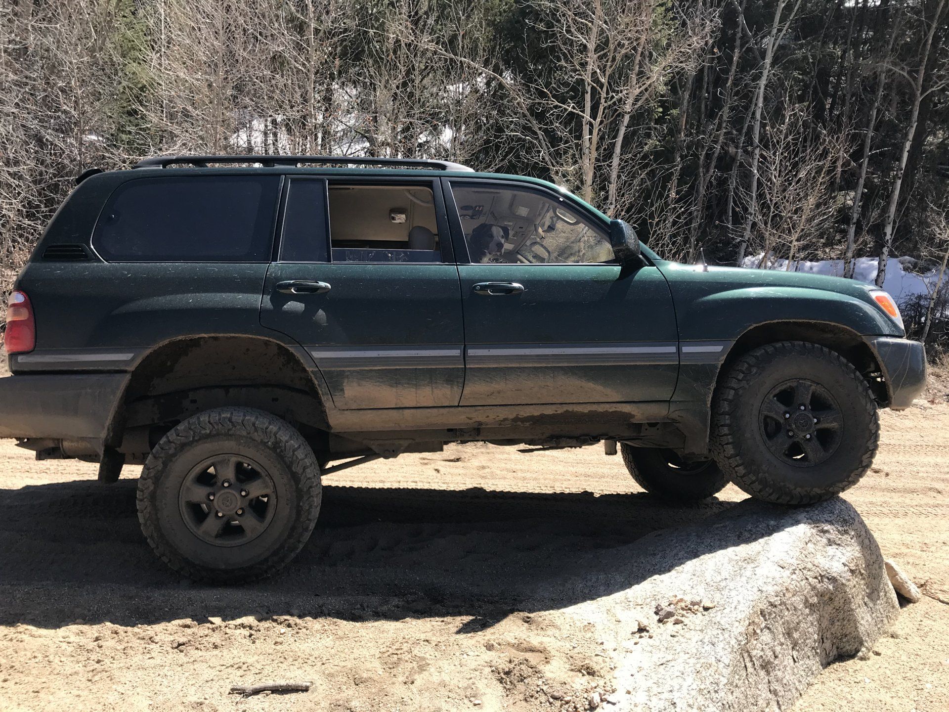

Took off my rear sway bar.
Went out for a little test drive.
Found a good rock for testing out the flex. Have to admit I think it flexes pretty good.

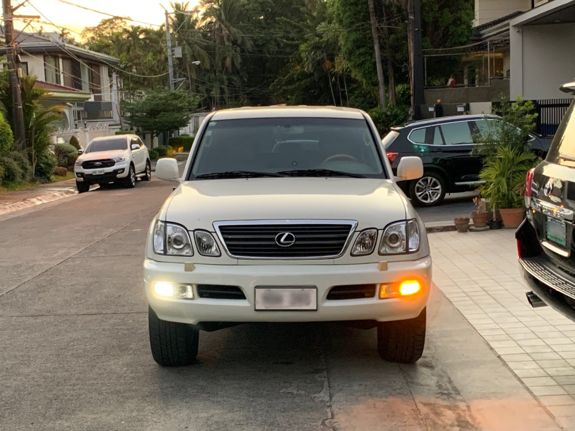

Converted the turn signals to DRL/turn signal combo

I like this. Are you planning to do a write up on what you did to convert this?
I was planning to do a write up but decided to wait since the wiring I did isn’t final yet. We are currently on a lockdown here in Manila due to the Coronavirus. All the stores are closed so I had to make do with what I already have at home. Here’s what used:
-two waterproof SPDT relays
-fuse holder and 5 amp fuse
-DRL controller (optional)
-two 1157 bulb sockets
-two 1157 LED switchback bulbs
-LED flasher relay to prevent hyperblink
I’ll go ahead and post a more detailed writeup with the wiring schematic tomorrow
