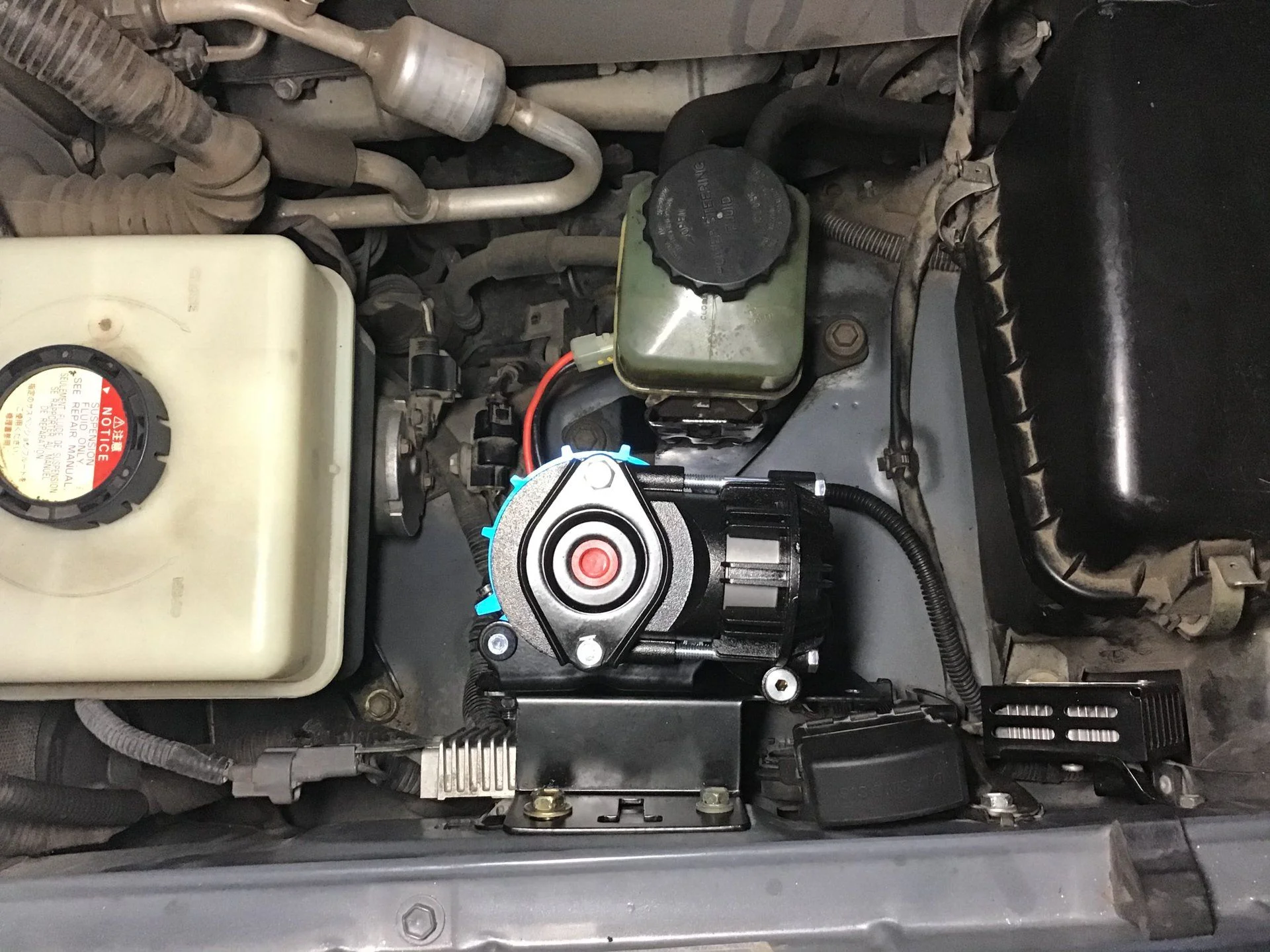

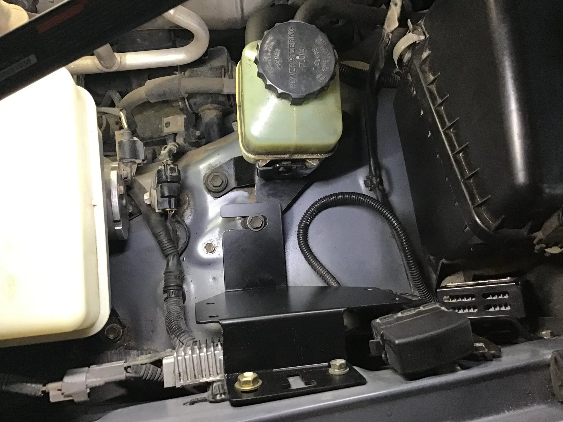

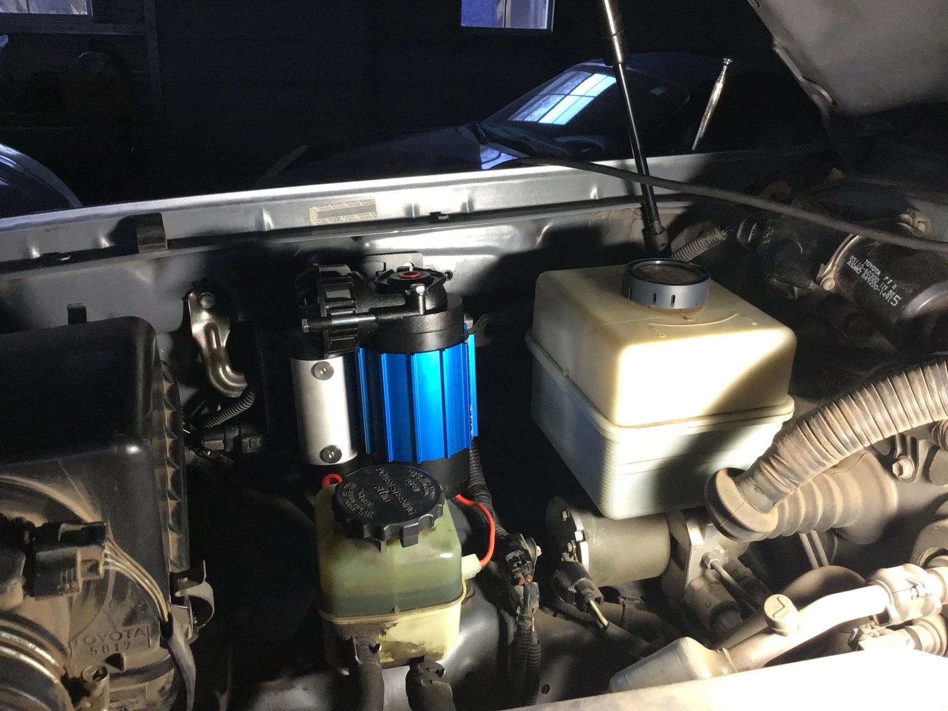

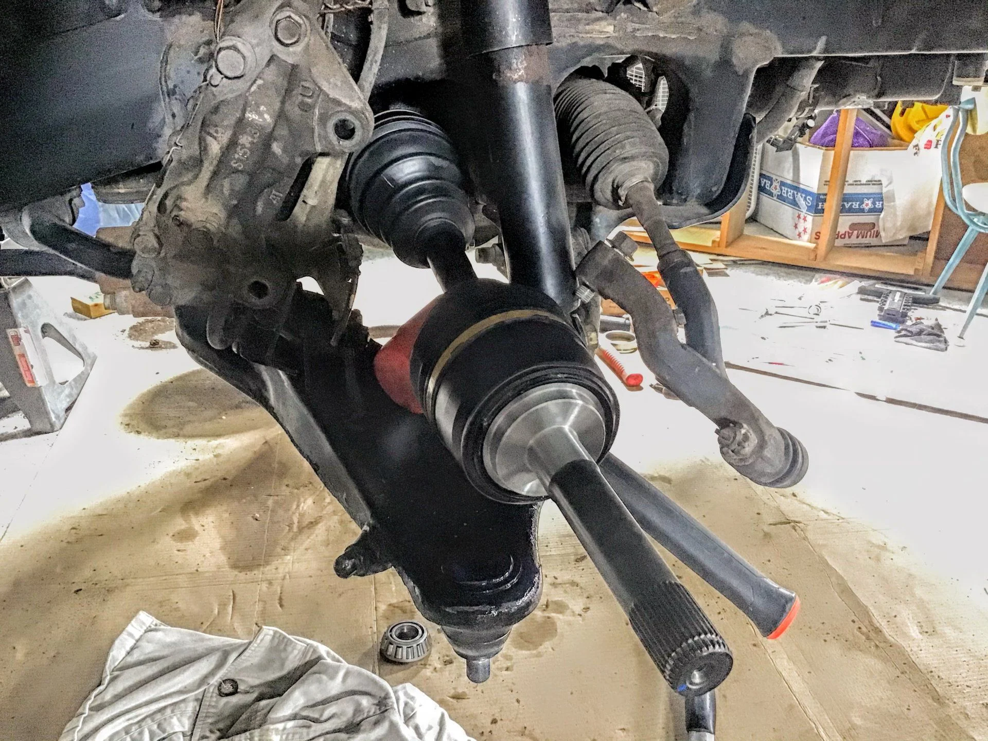

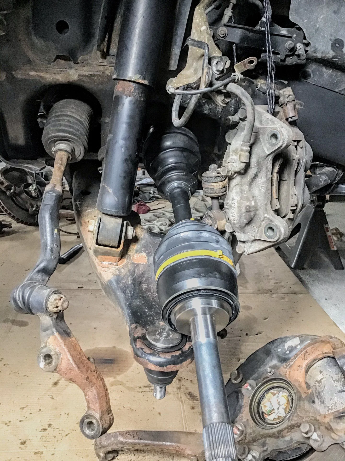

All four ball joints are in; Got my front diff seal today from @cruiseroutfit so the CVs went in! Also sprayed some Rustoleum on top of the ball jointsWas going to install the knuckles, brakes and wheels, but couldn’t find the grease, so I moved on to the Torfab bracket and ARB air compressor. Way harder than I had hoped, since the items needing relocation didn’t really have enough wiring or clearance to do so, esp. the horn. I also had to cut a bolt for length to clear the part under the bracket. Another issue is which way to aim the air outlet. Turned clockwise, it comes out aimed at the power steering reservoir. Turned back it is aimed close to the AHC reservoir. Haven’t gone any farther, so I do not know the clearance once the outlet is finished.

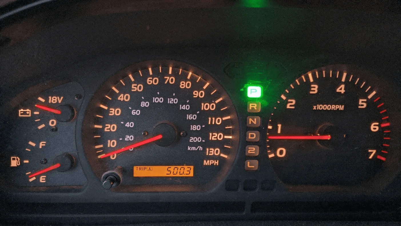

With no interstate travel or waiting in traffic due to non essential drivers, the Cruiser really pushed the mileage envelope the past few weeks. 15mpg versus the typical 13.5mpg.
With your LRA tank - you must be getting 500+ miles between the fill ups!
