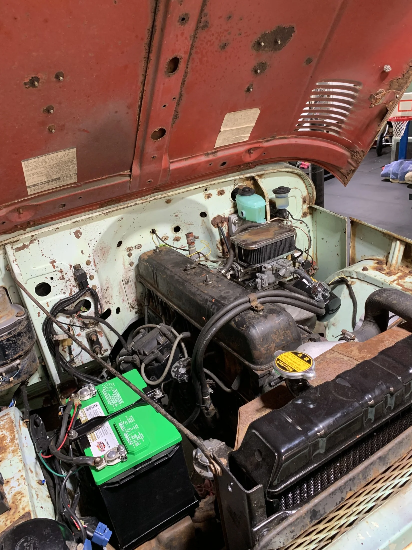

But on a good note I put the new battery in and am one step closer.

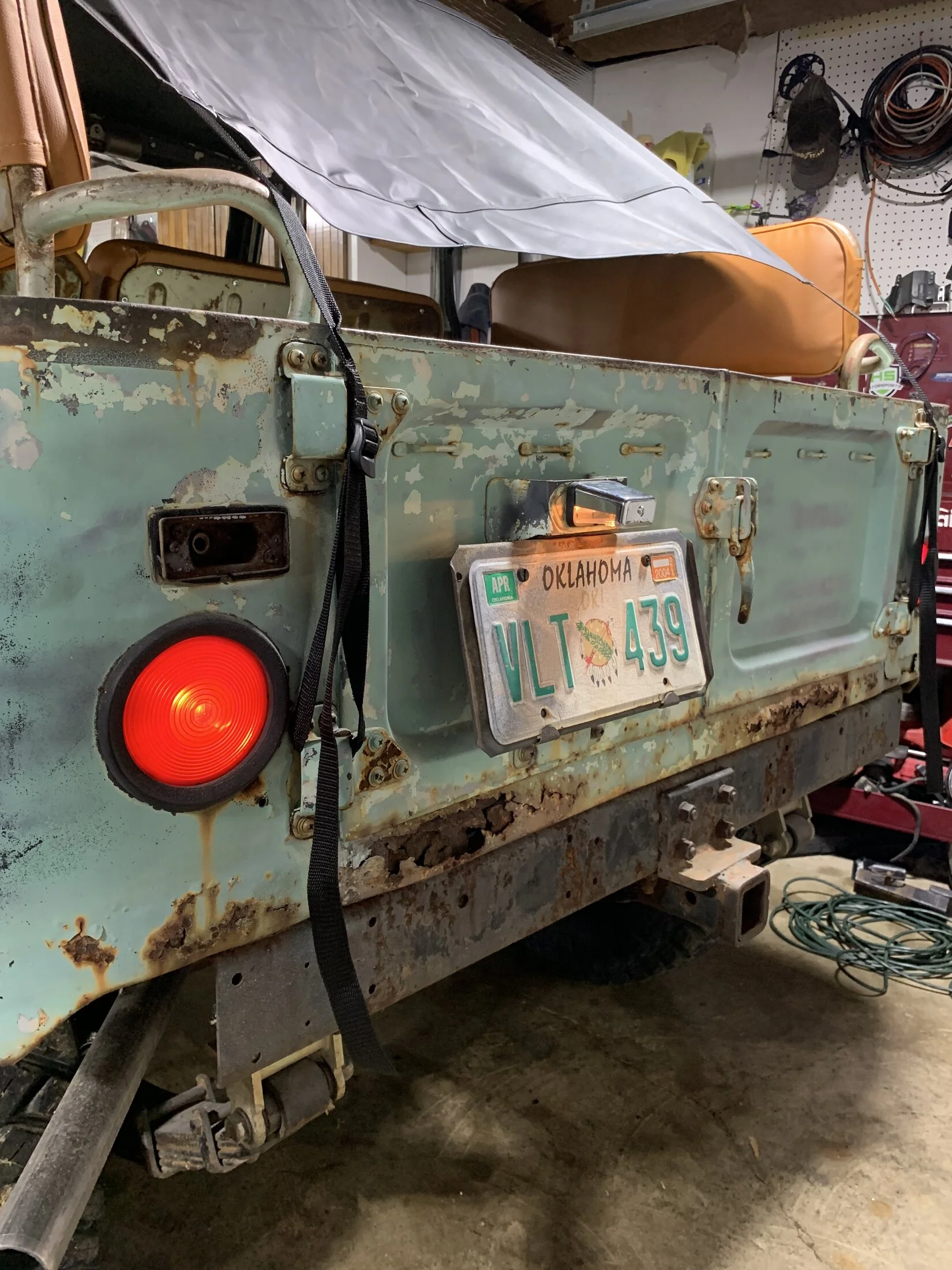

Tonight. Installed a license plate light I had Latin for around for my trailer build. The oem was rusted solid to the bulb so I’ll update eventually.
Reinstalled the bikini top, obviously it’s not correct without a rear bar but I wanted it on for tomorrow. One of my friends was kind enough to bend me a tube for my rear bar as I don’t have a bender and that’s on the short list to pick up and install.

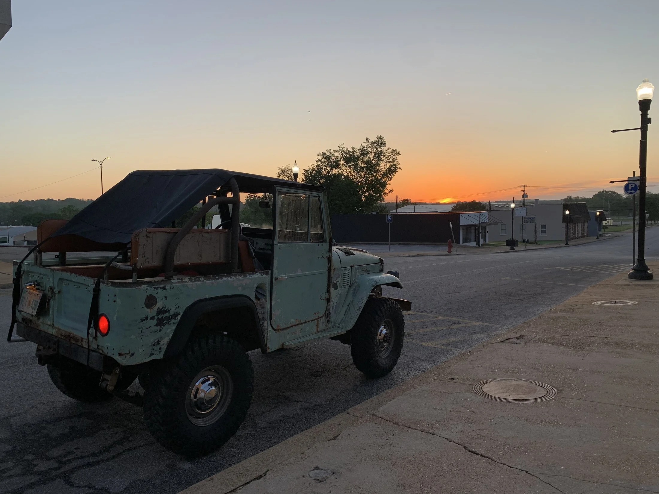

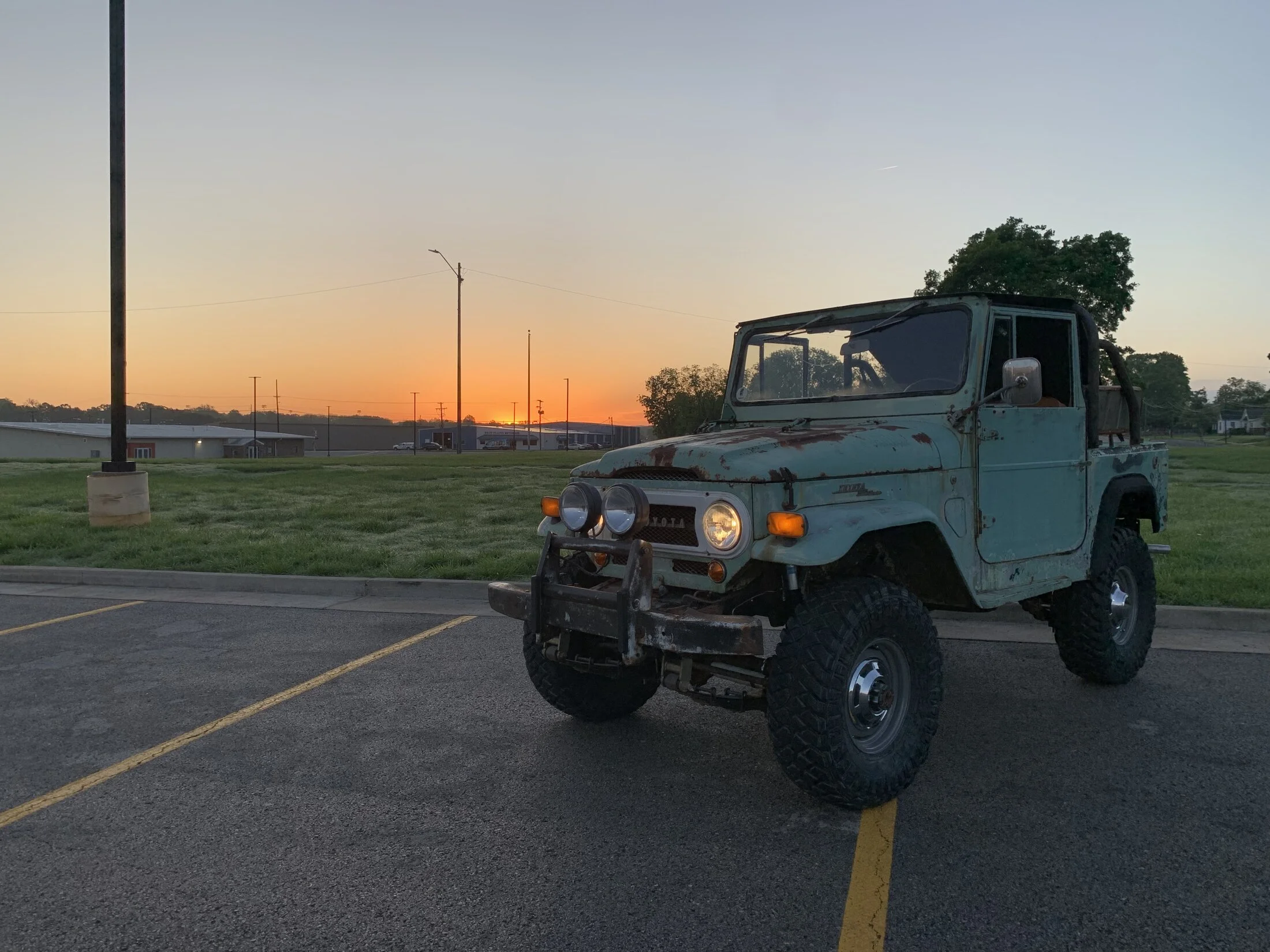

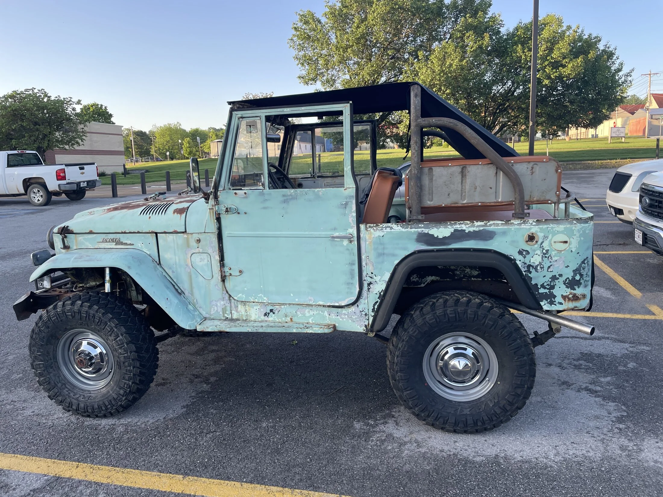

Great first day in the 40. Put about 15 miles on it, filled it with 91 ethanol free and picked up the tube from my buddy. Greased all the fittings, checked a couple fluids.
Only had 3 people call it a Jeep 🙄
It didn’t break down, it has a couple oil leaks popping up, it made me happy. I’d say it’s a win.

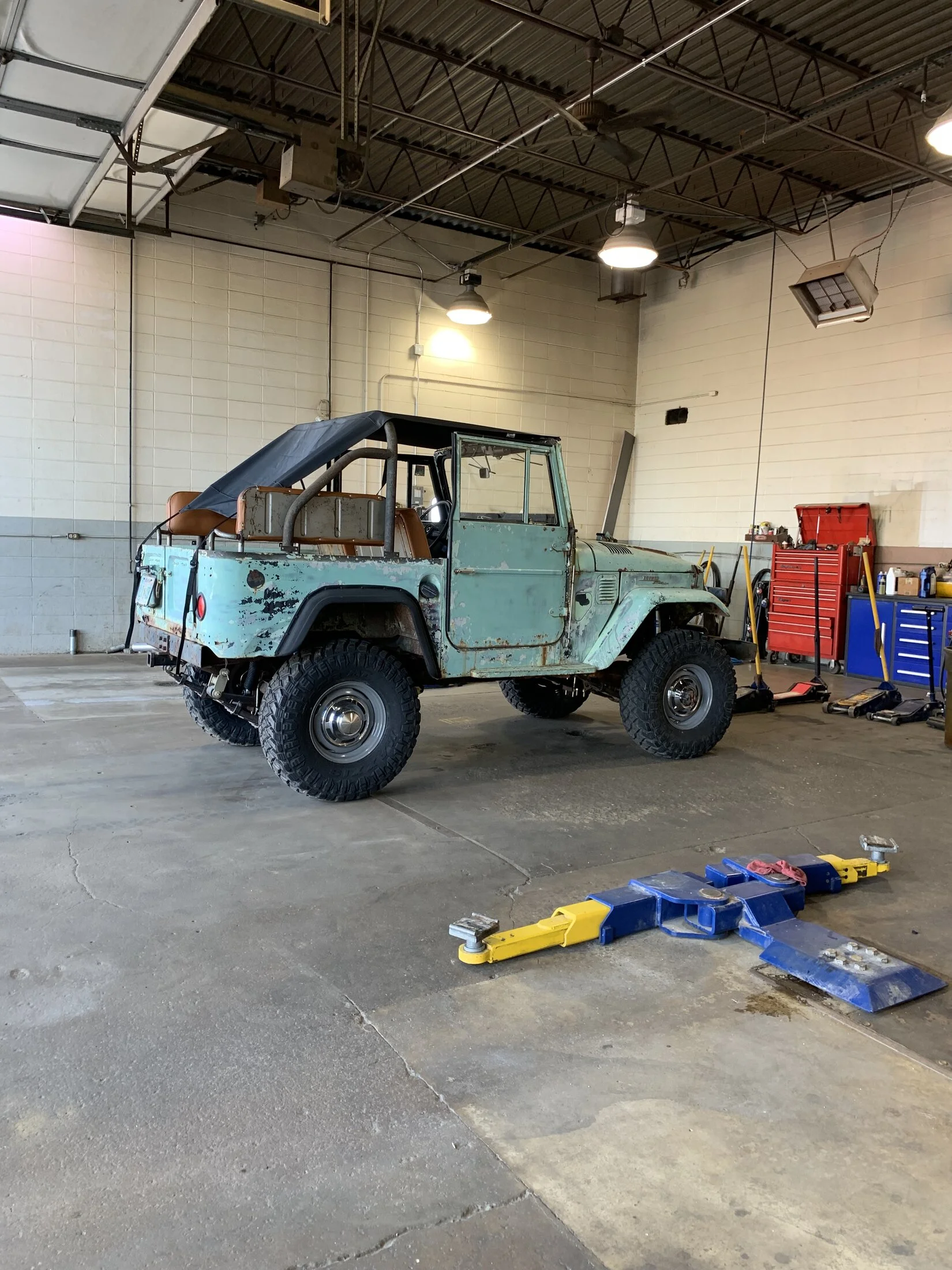

Random side profile before the tube install. Someone actually took this while I was swimming and sent it to me, wondering if it was mine.
I had someone pass me in a no passing zone today. I was even going the speed limit but I guess they were in a hurry in their Escalade

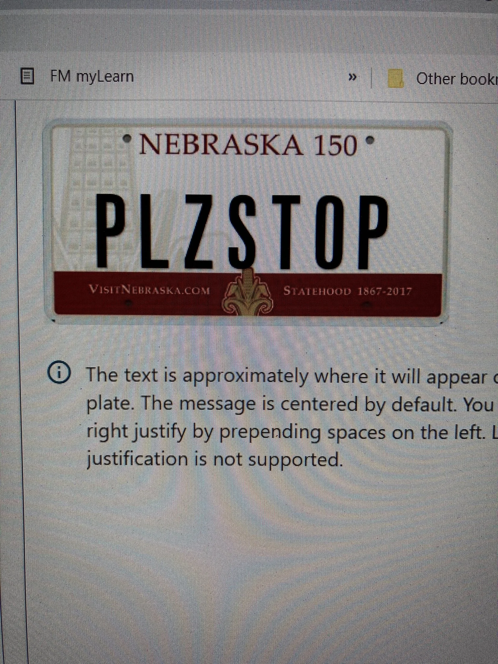

40’s are tailgate magnets. I have several bumper sticker designs in mind. A couple favorites are:
“Please stop trying to figure out what I had for dinner last night”
And in smaller print, “If you can read this, you’re an A**hole”
