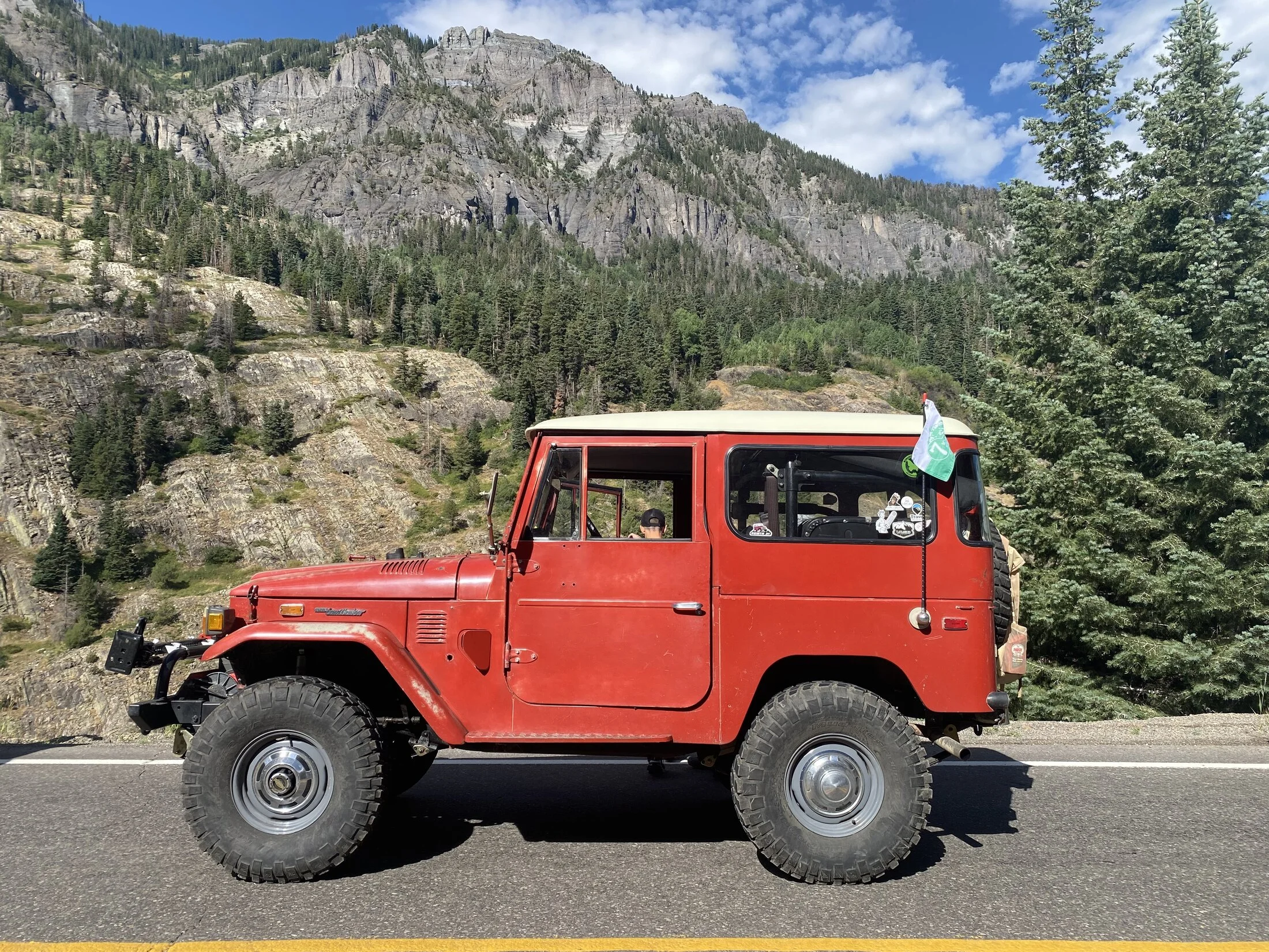

Does anyone know of what cb antenna mount was Used “back in the day”
@Flatlanderfj40 has the same antenna on his 40 as I’m looking for. Mine had one in this same location at one point.

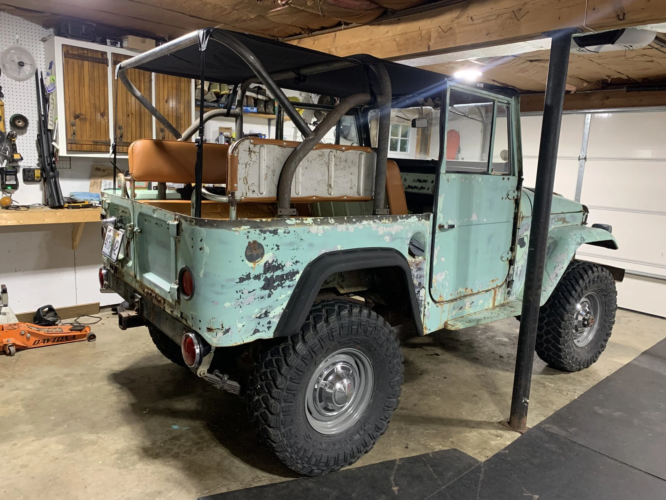

As I sit here staring at a computer screen wishing I was pulling the diff apart instead I had the though of a thought last night.

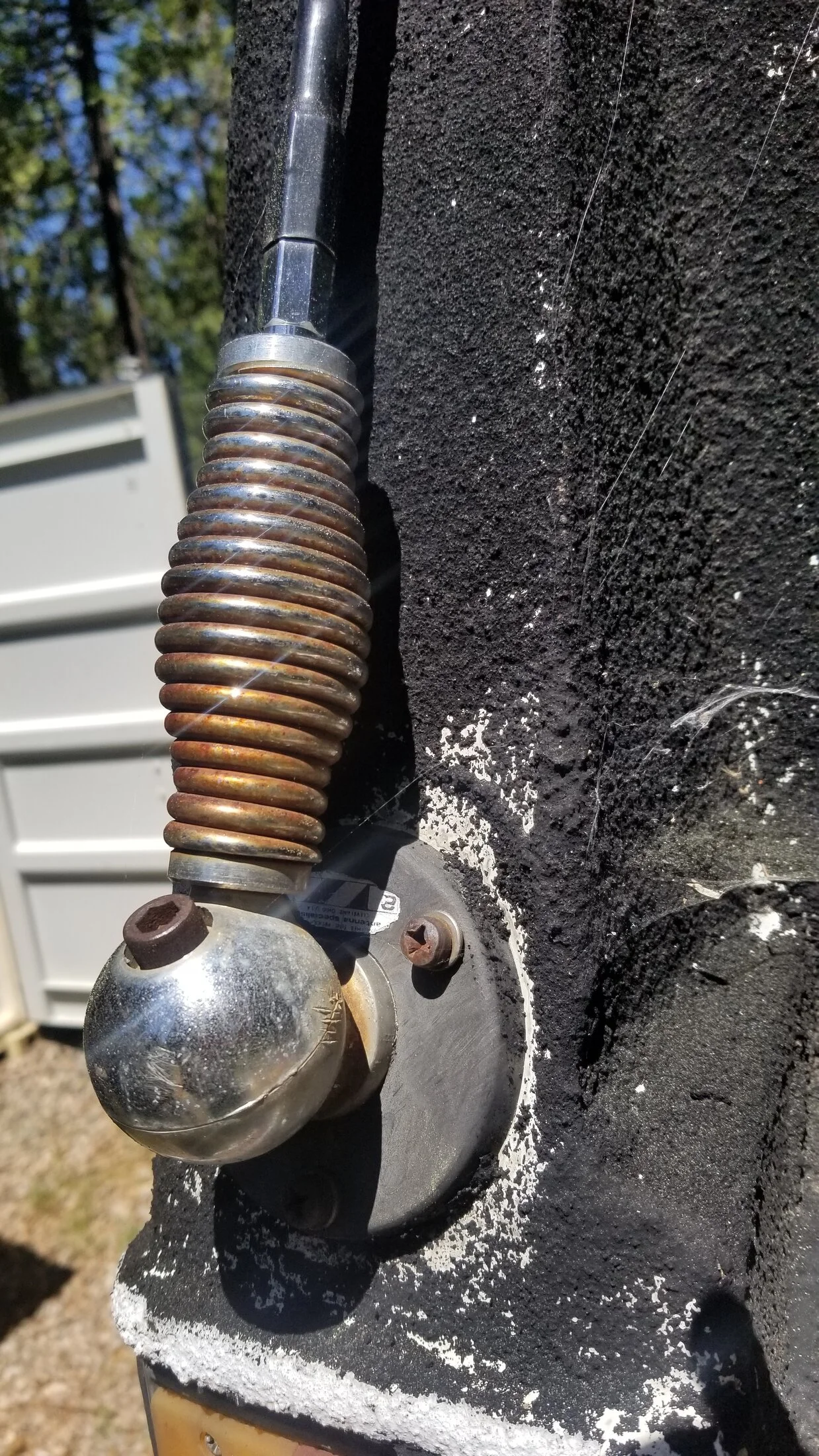

Its crazy how many 40's had that same CB antenna mount installed somewhere on the vehicle. Those mounts are still available. I learned a long time ago the trail rash/trees have a tendency to knock stuff off the side of a vehicle. Fortunately my PO mounted it on the rear. Just search the net for CB antenna ball mount. I'd add a antenna spring.

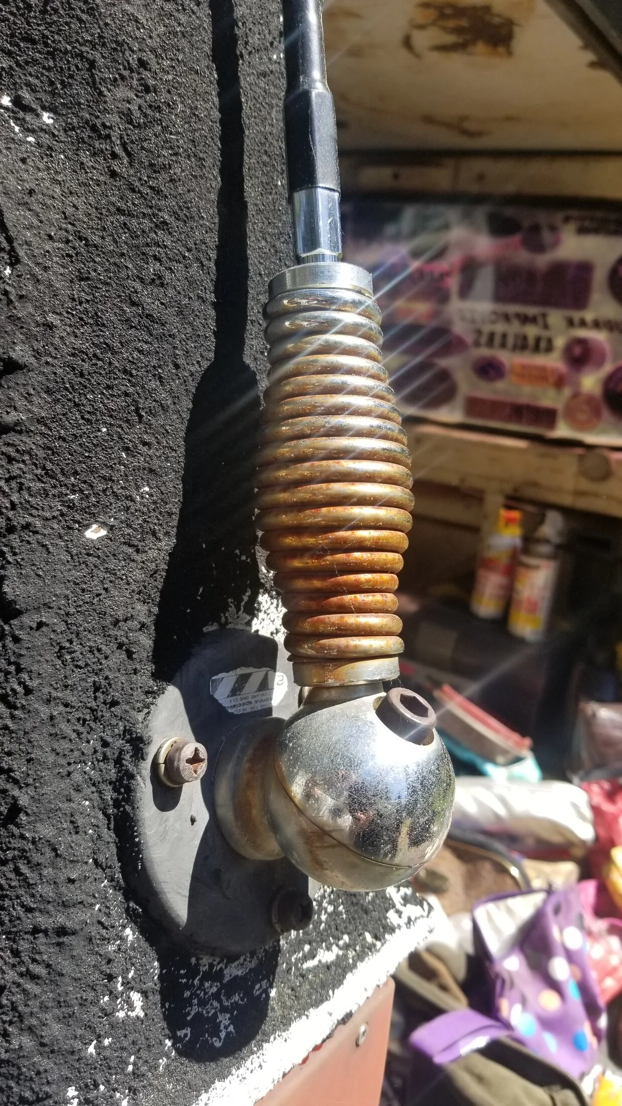

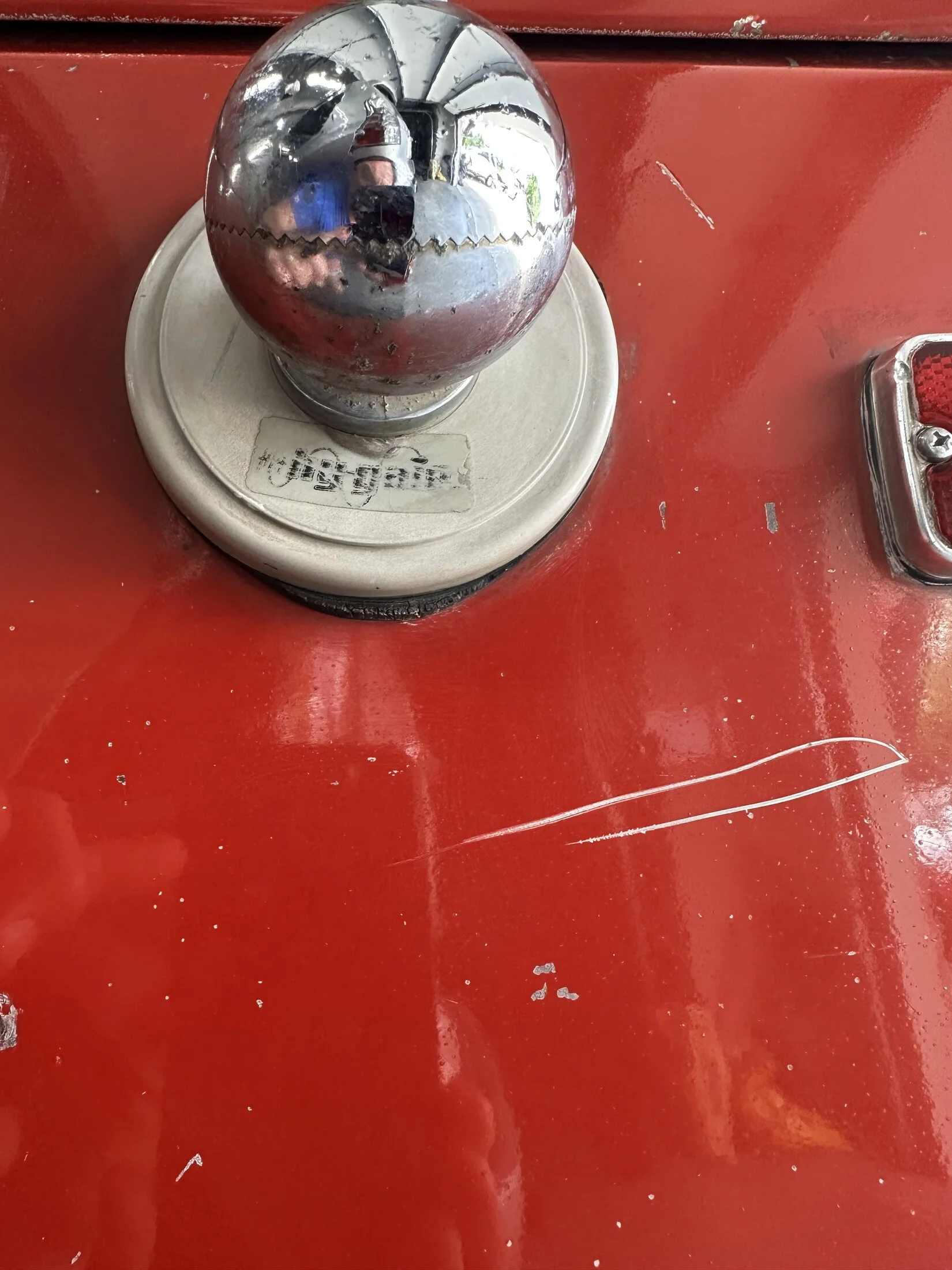

I think it reads Hy Gain? Don’t mind the scratch from my daughter and her bike 🫣
I had that same mount in the same place on all 3 of my 40s, my 55 and now my 80. Pretty stout really. I drug the ball mount across a rock face when I leaned my Cruiser into it on a v notch on the Rubicon last year and it was fine. I usually ran 102" whips on those Cruisers though

I got mine at Radio Shack, HTH

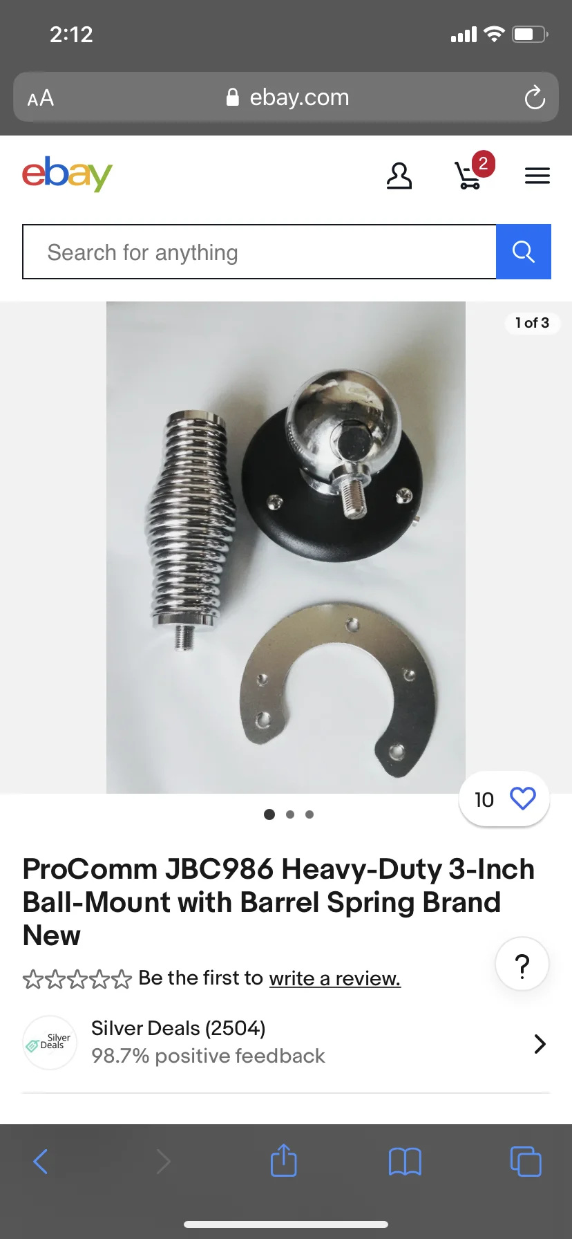

Cb antenna ball milky got me exactly what I needed. Thank you!

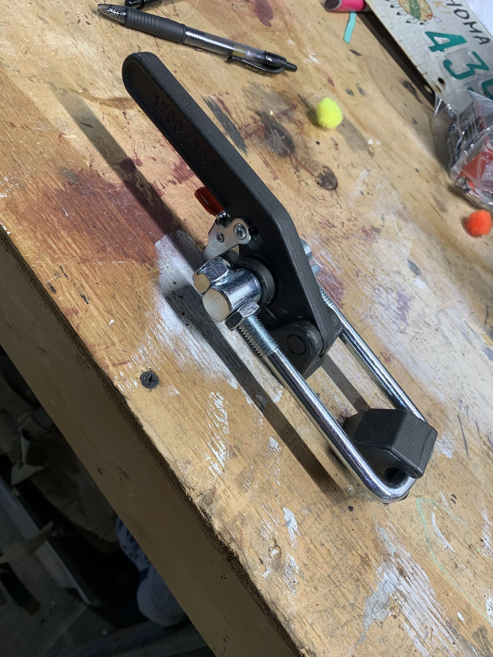

Ive also received all my parts for my swing out build. I just need time to actually build it now. I have a concept in my brain. Just need to get it to paper.
Thanks @TRAIL TAILOR for the latch assembly.
Edit for pix, because we all like pix :

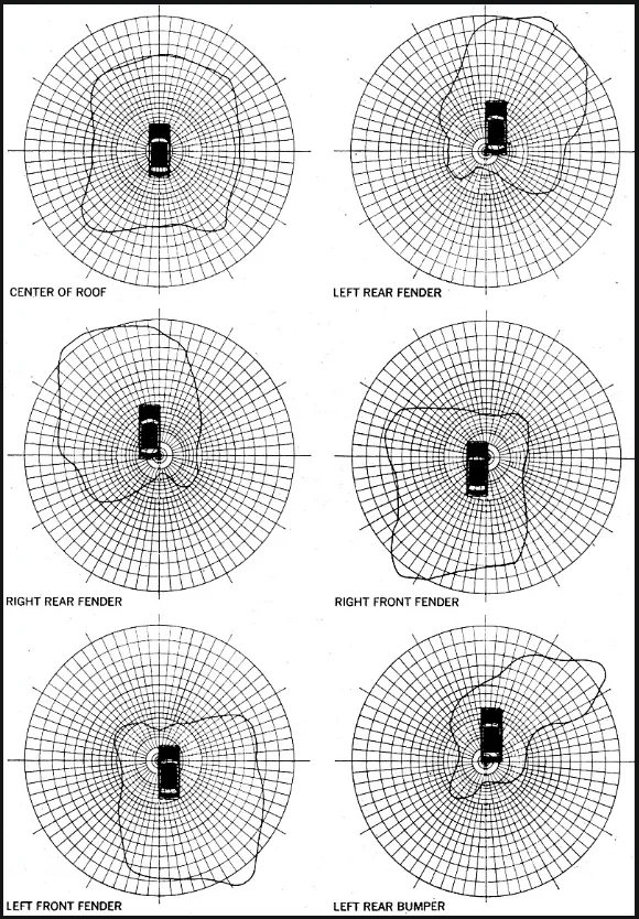

It is interesting that people install antennas for decorative reasons on a vehicle. Rarely have I seen the transmission profile addressed. The reason for an antenna is to receive and transmit. This installation will work somewhat, but will be transmitting into a whole bunch of steel. I will attach an image of vehicle mounts and the result of the RF .
This diagram likely wasn’t around when a ‘PO’
hacked a hole in my tub, lol…keeping the old school look, without function in my case, beats having a random hole in the tub.

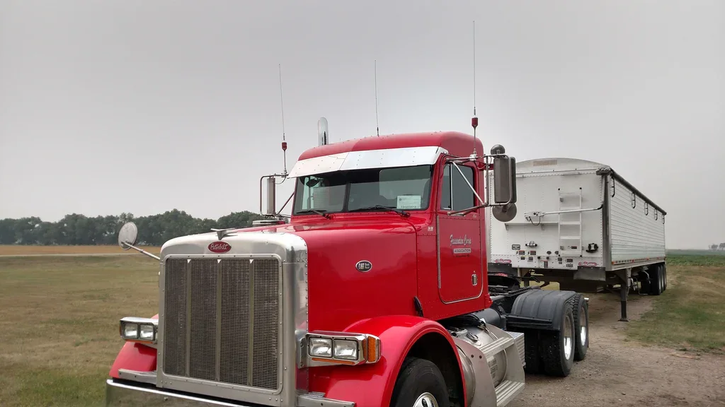

Understand. But this type of RF chart has been around a really long time. The problem is the lack of knowledge of antenna theory. Years ago as a CB installer, truckers would want their antennas to fit the beauty of the truck. Driving they had lack of transmission/reception until others told them the best SWR for the truck. I will give an image of the best place to install. Always remember the antennas function RF energy , (low power), either is received or transmitted, and does not like big metal blockage. Take a look at radio antennas at various places ( for big wattage radio stations), and notice they are NEVER adjacent to any blockage .
Mine also will be more form Over function. I wouldn’t install one if it wasn’t already there. Shoot I don’t even know if I’ll put a CB radio in it, but I want to fill the hole and the antenna fits the “Look”

Is the latch on the website? I think I want something like this when I build my 60 bumper. @TRAIL TAILOR
