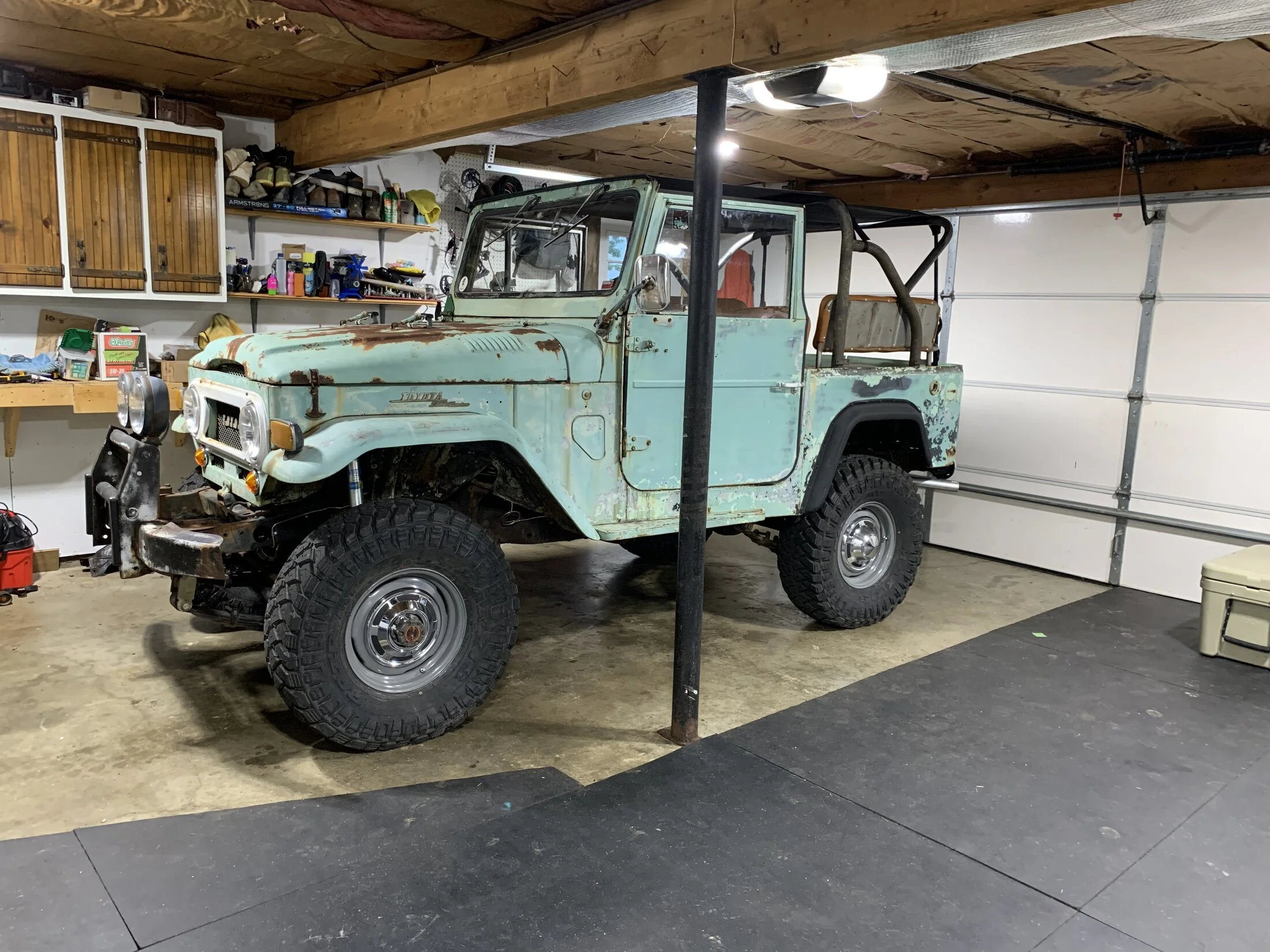

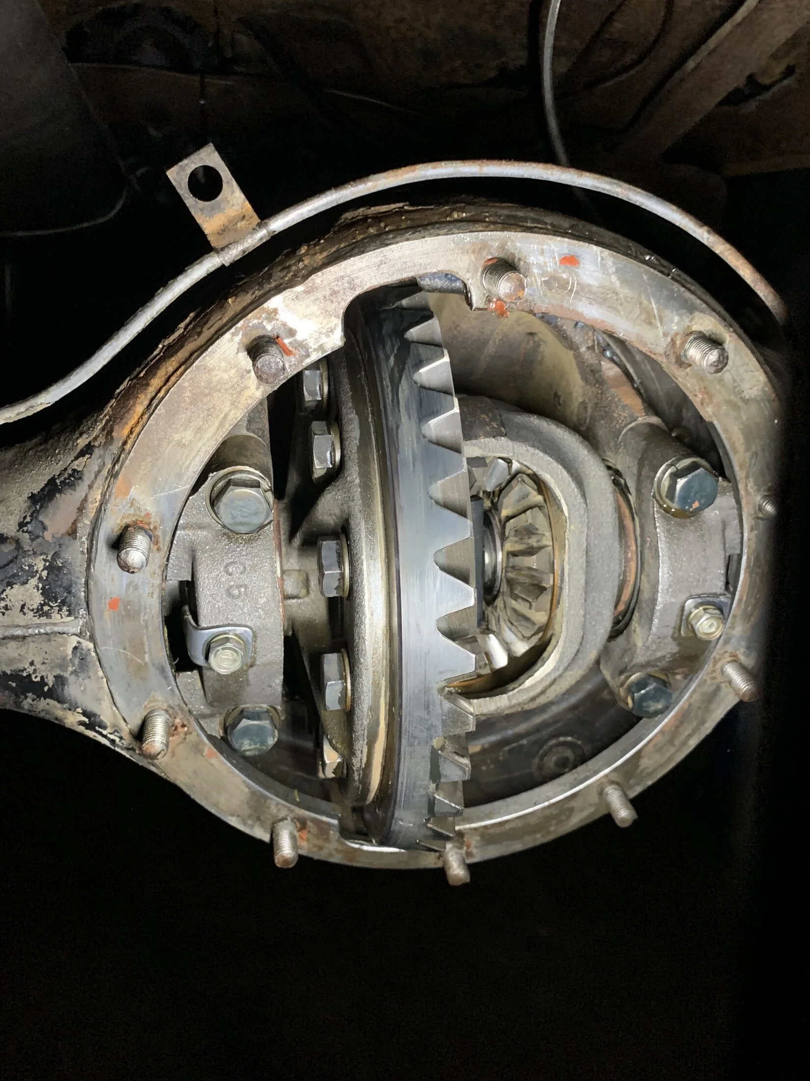

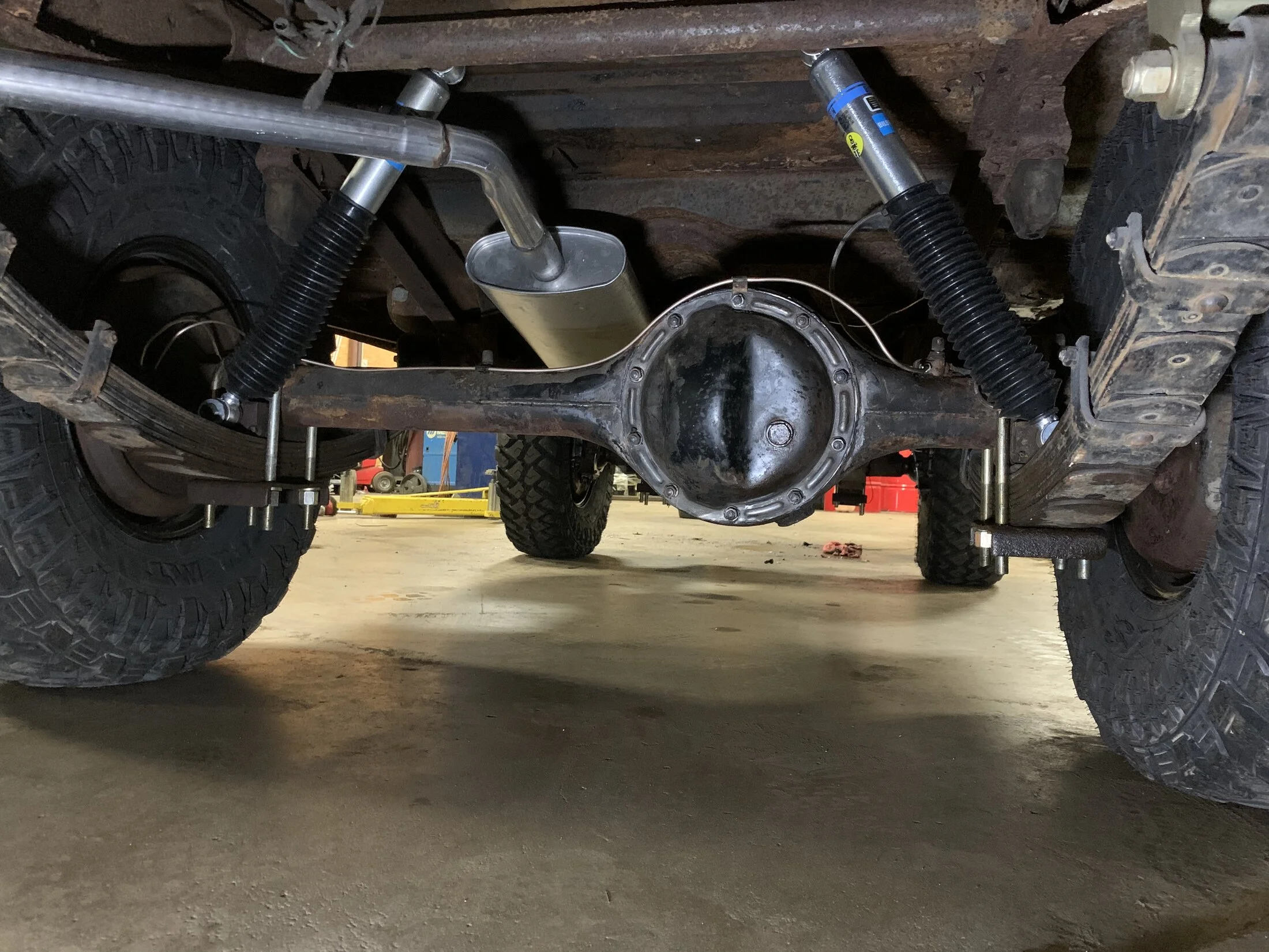

Well I couldn’t wait anymore and had a break in the weather at lunch today. So I rolled it outside and popped the cover finally.
Found it.

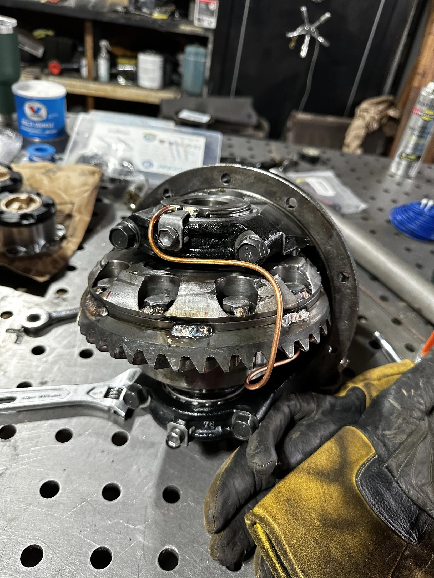

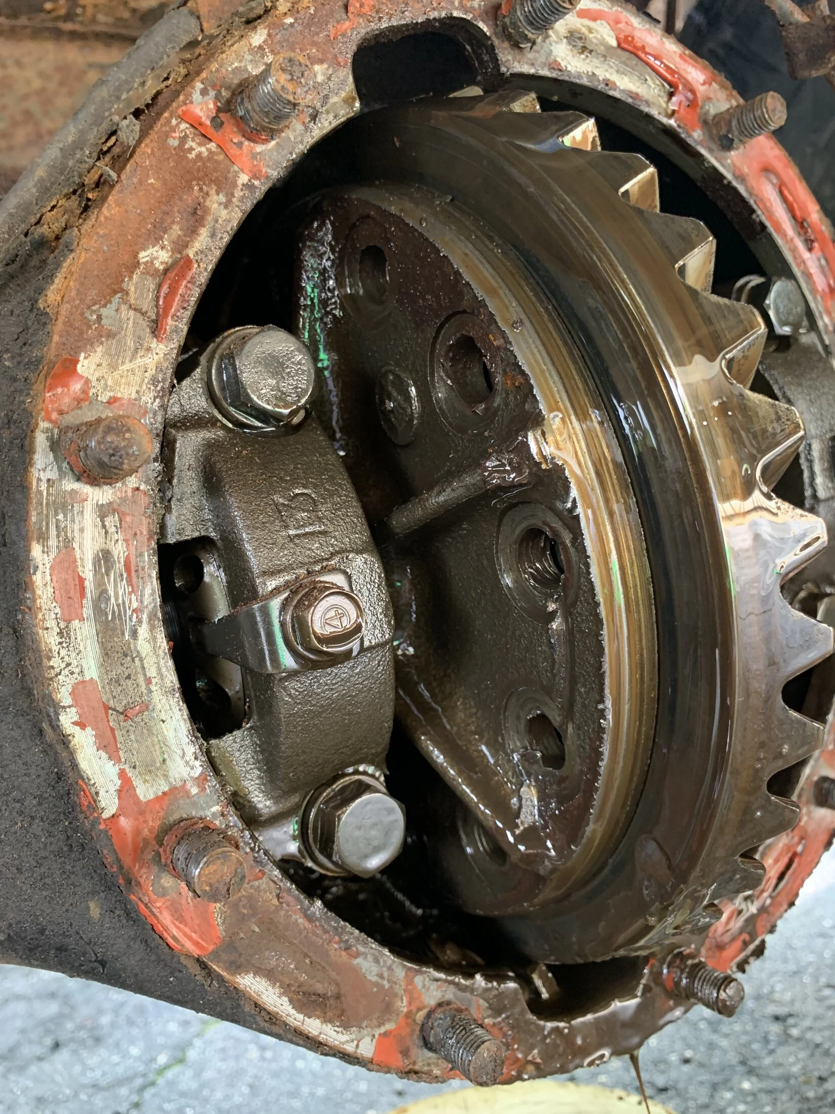

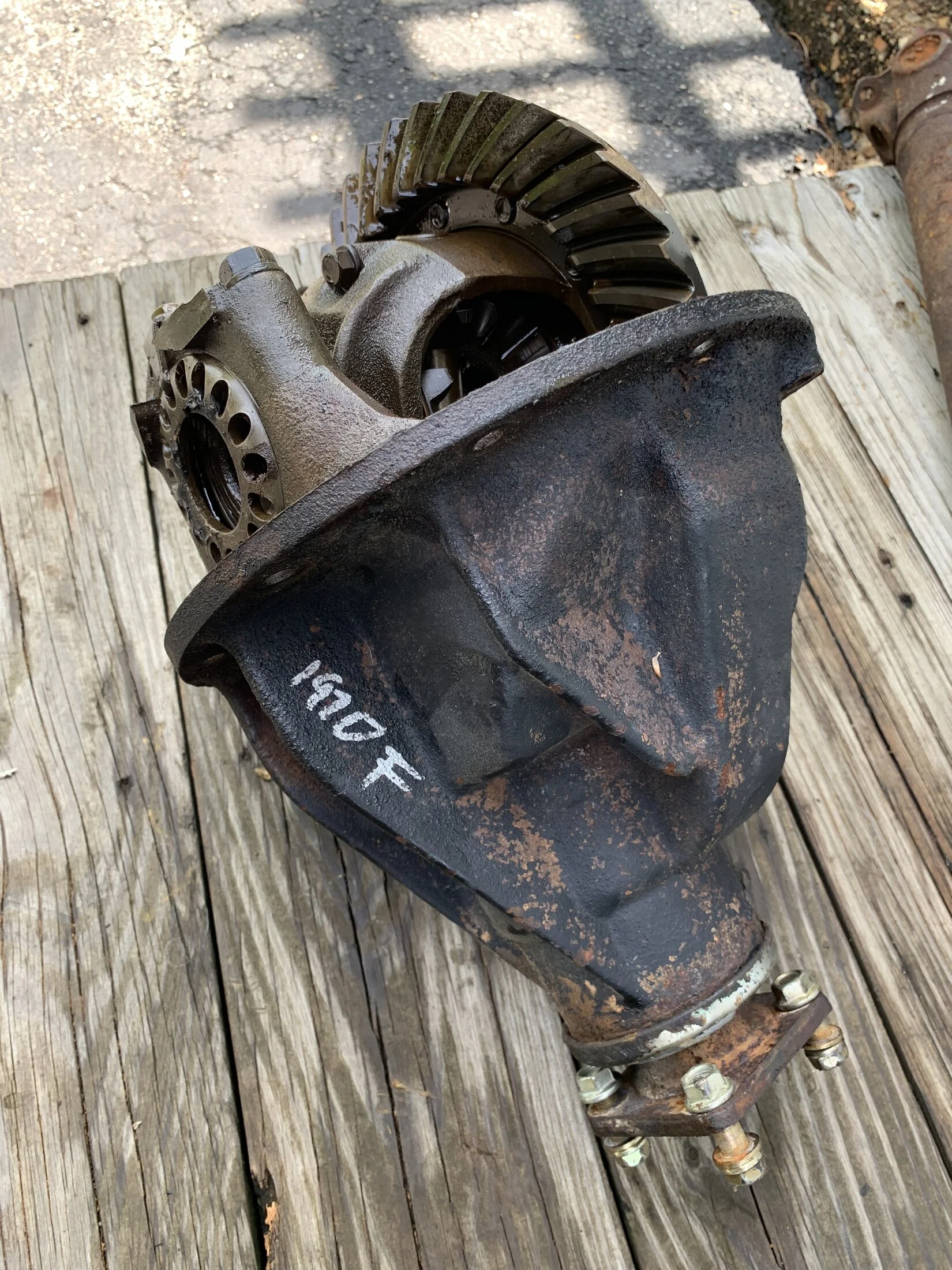

Picked up my new to me diff from Jason today. Promising little writing on it as well.

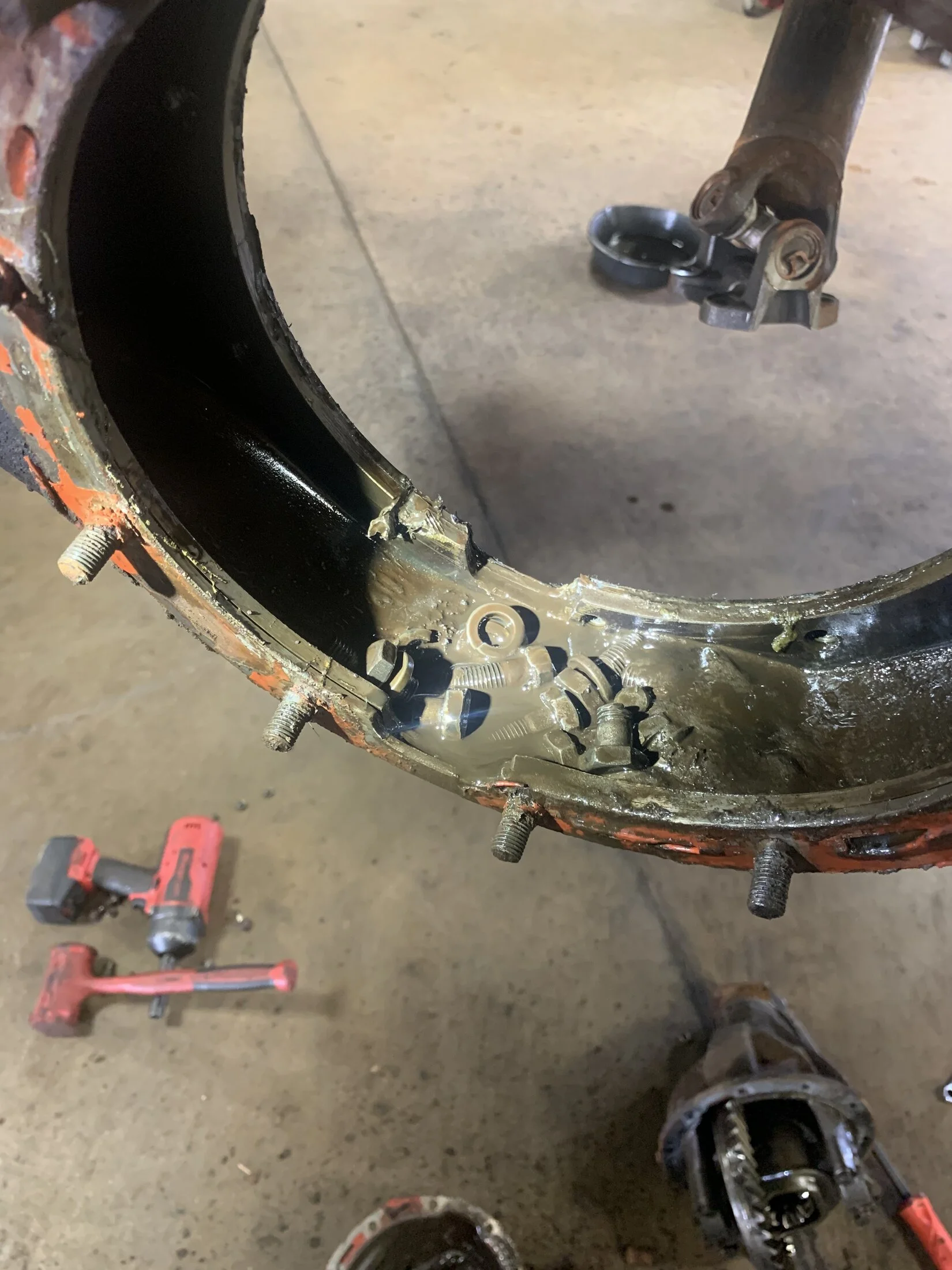

Did the bolts sheer off? or back out? thats sketchy. bet you found lots of metal in there.
They backed off best I can tell. I pulled the cover, found problem, saw bolts laying in the bottom, took pictures, put cover back on with a few nuts and put it back in the garage. I’ll tear it apart and swap the diff hopefully in the next couple days and get more pictures.
I guess sombody didnt torque them down or somthing. Looks like sombody was in there with the red RTV. I think if mine went (who knows) I want to put a full float in. But then I am pretty sure I will have to regear the front diff. I have done no research on it yet.

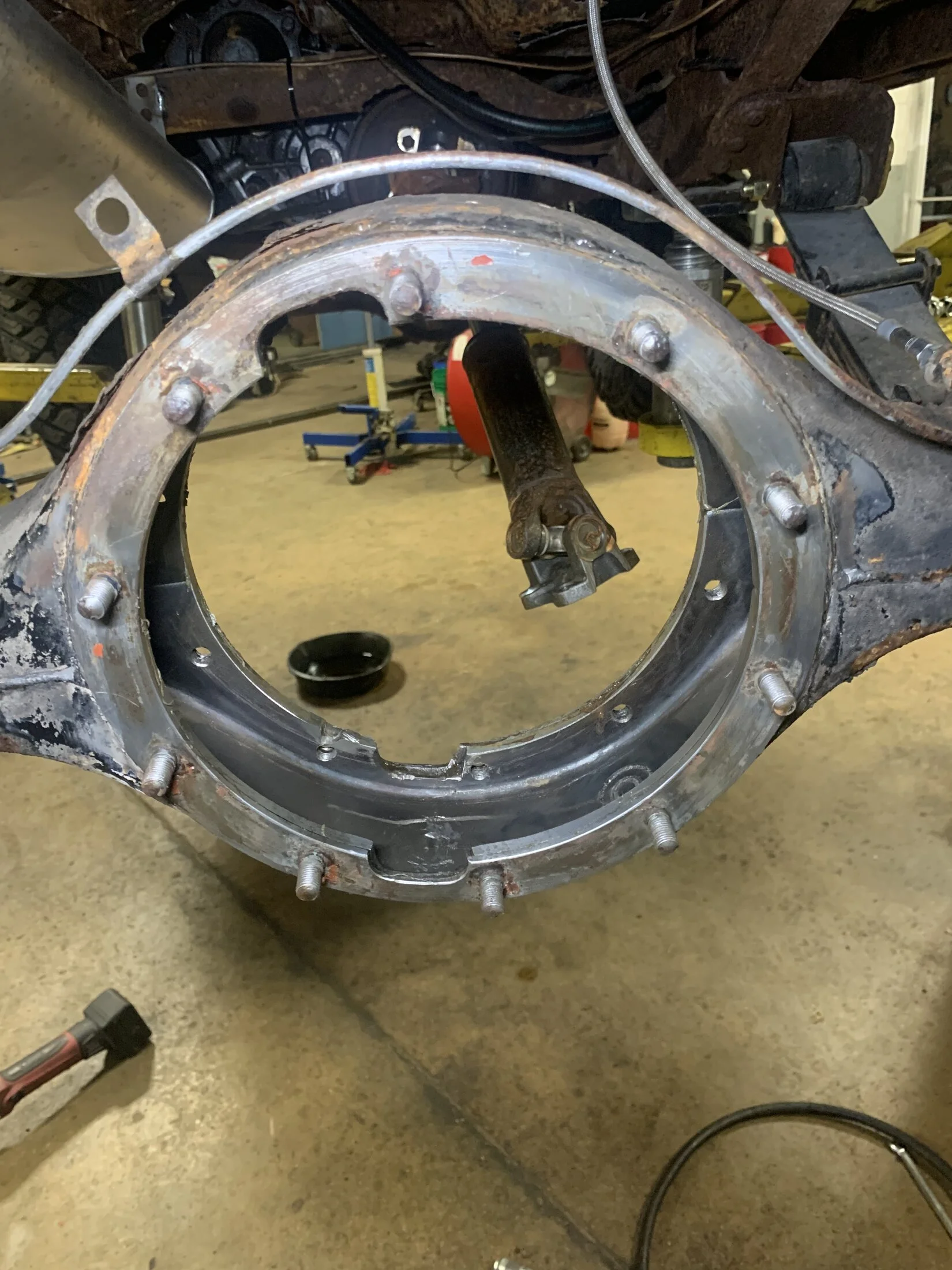

Got back to the shop about 9, cleaned, cleaned gasket surface, cleaned some more. Started re assembling, power went out, got it all back together using flashlights, built a new line to the driver side as this one cracked when I moved it. Hooked up my oem rear lights. Welded the driver front spring perch to the frame as it was cracked at the rivet and moving.

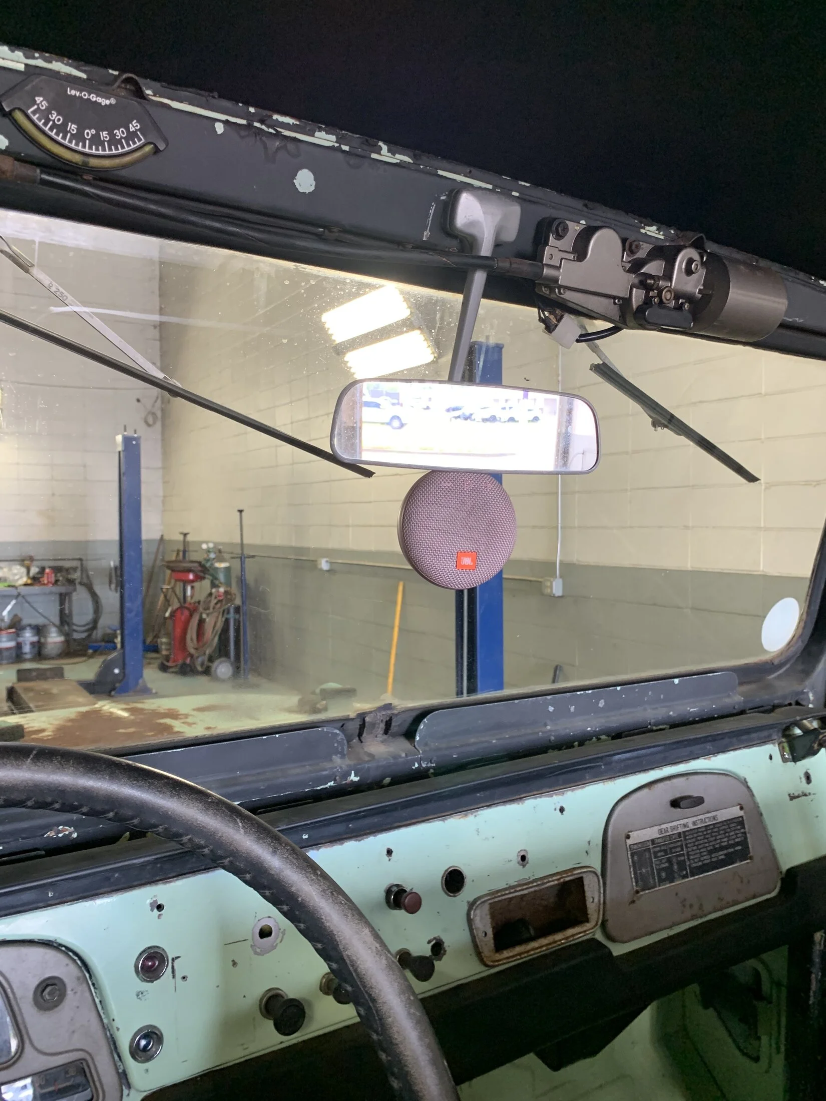

That’s one clean windshield wiper motor !!!

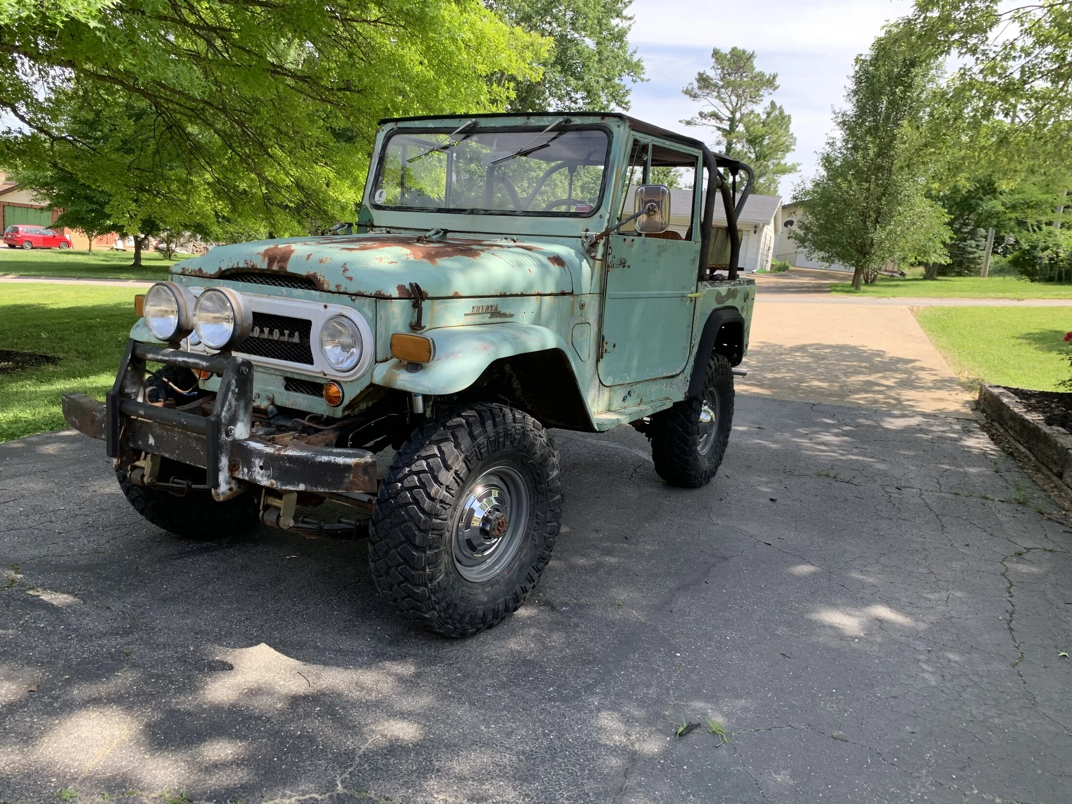

Drove the 40 off and on all week, rain was in the forecast for the weekend and we had family stuff so it stayed at the shop.

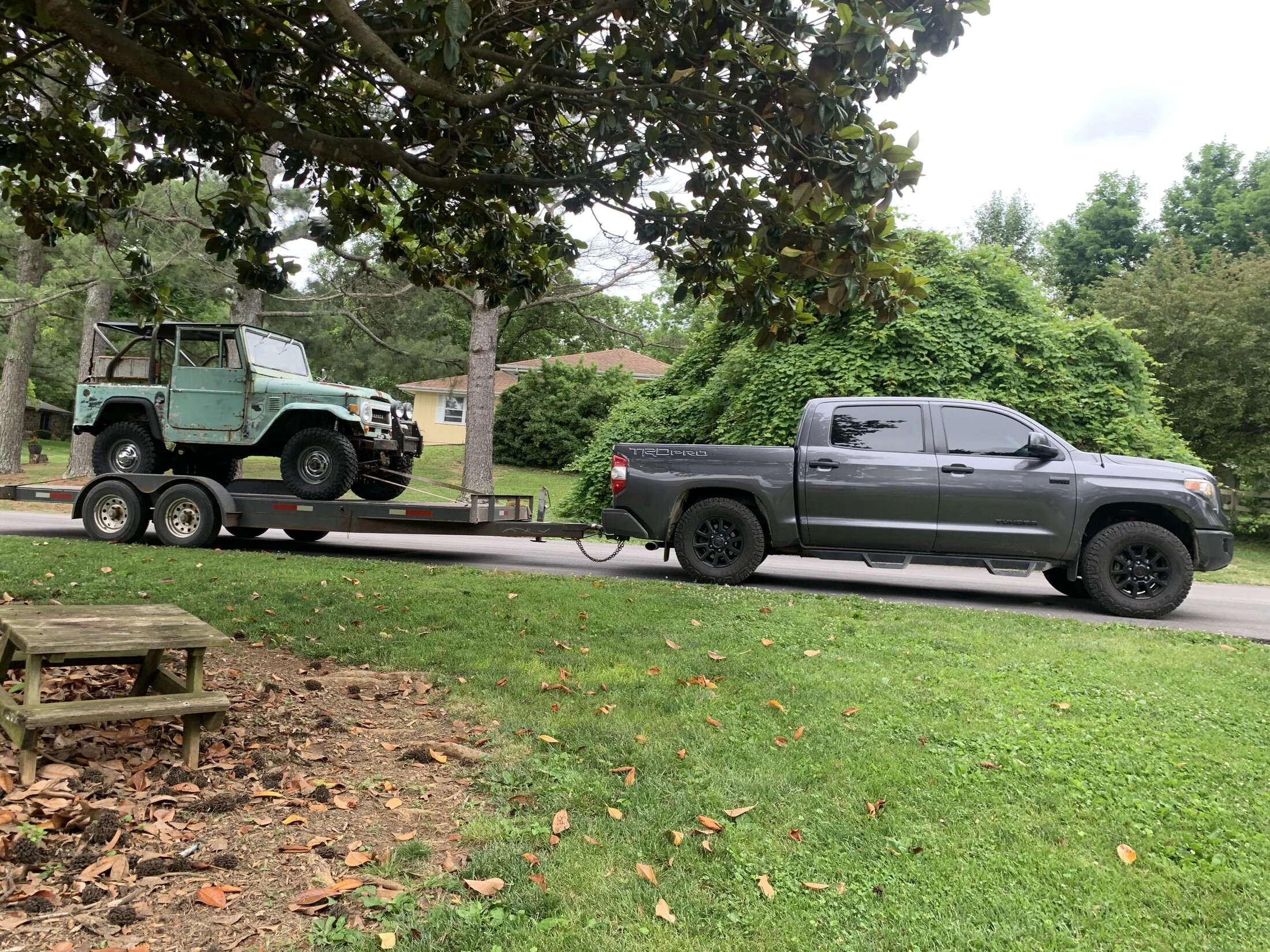

I had the trailer hooked up over the weekend to haul a mower and figured I’d just bring the 40 home instead of shuttling over. Drove it to lunch today then loaded it up before the trip home.
