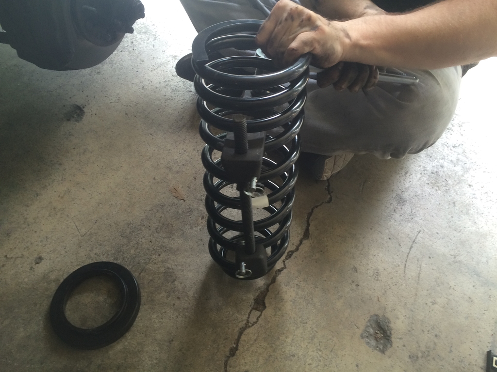

Yes I did ... their , 19 3/4" in the front and 19" in the rear - measured from center of hub to bottom of fenders for the before measurements

glad my buddy had a spring compressor ! fronts are almost done .... then the rears hopefully are easier !
In about a dozen (80) lift installs never used one yet. Always been able to drop shock and get the droop needed. Occasionally needing to push down on the front hub for the last inch of flex to get it in there. May be worth a shot of you have the height/droop as those things are sketchy. Or can be
He's used them a bunch on other yotas... so it was his call ... I am trading him some stuff for doing the complete kit ...after the compression they slipped right in ...I saw where some have dropped the tie rod and gotten more droop , but he said the compressor is faster and works great ....
YUP
He only had to compress them about an inch .... so not too bad
