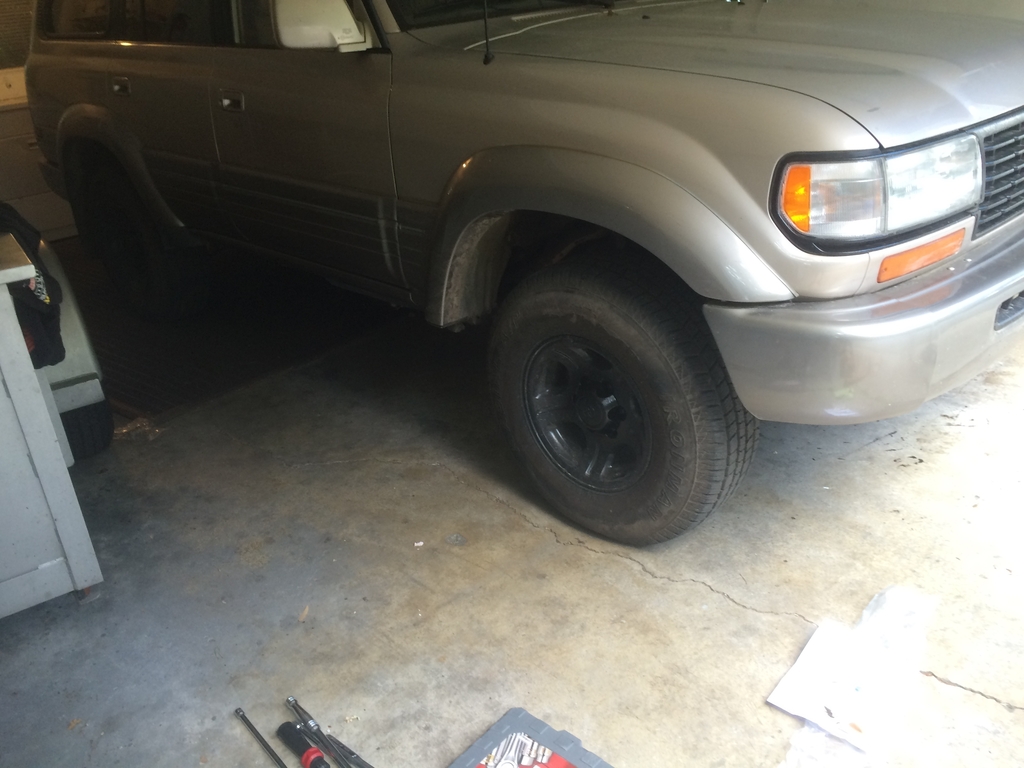

this is yesterday after takin the boards off before the stock height OME install today
