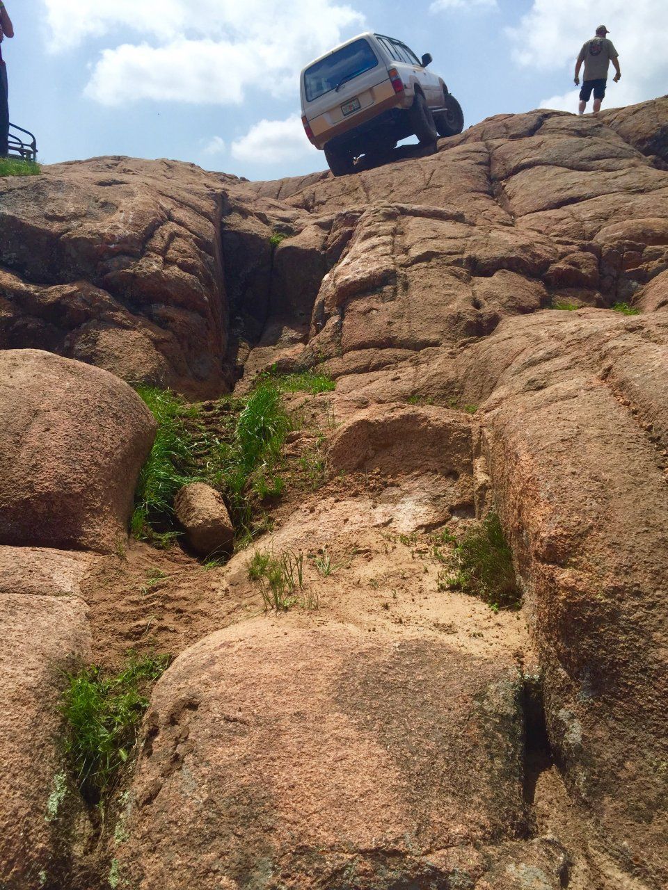

I like it a lot. My only complaint is the limited number of stake loops on the annex. Not an issue if your on softer ground. But we were on solid rock most nights. So when your getting creative with securing it down it's nice to have more options. The non-ruggedized models by companions had on the trail had more loops. I did not use the annex every night. I think my dog was happier to just be tied to the bumper.
I have to say I slept better in the RTT then ever before camping. Including the camper. The mattress is very comfortable.
Wheeling with the weight on the roof was a little tricky. Between the rack, tent, awning, and extra fuel I was in the 400lbs range up top. Body roll was violent at times. Things to consider. The ruggedized weighs more so it adds to that. I need to build a fuel carrier for my bumper.

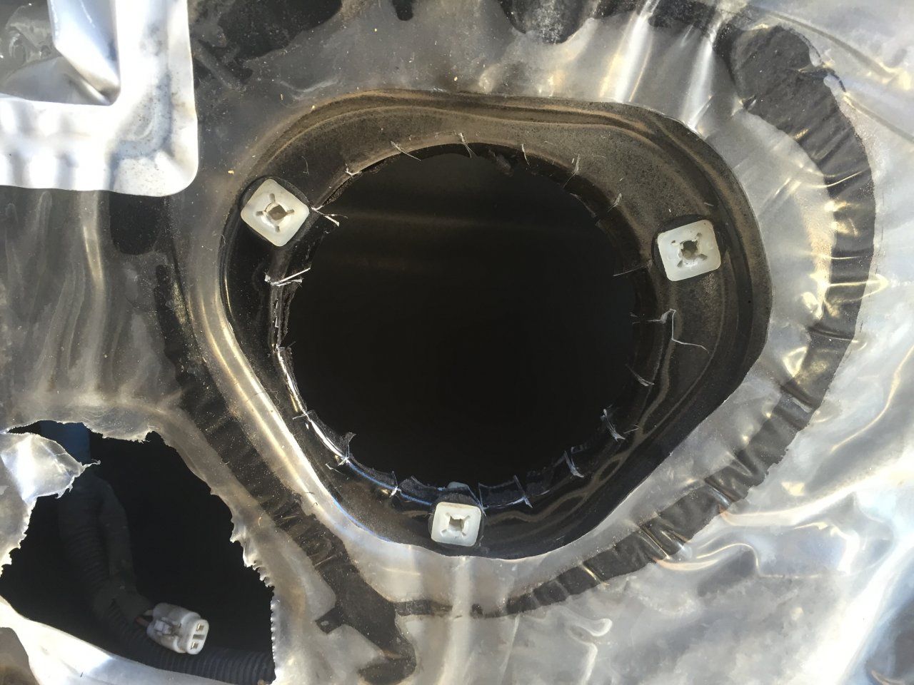

Finally upgraded my door speakers.
6 1/2 Kickers all around.
The fronts, I just easily mounted over the door panel.
The rears, I made 1/2 inch cuts with tin snips, folded the tags in, mounted the speakers over the door panel.
Took about 30 minutes to install all 4.
