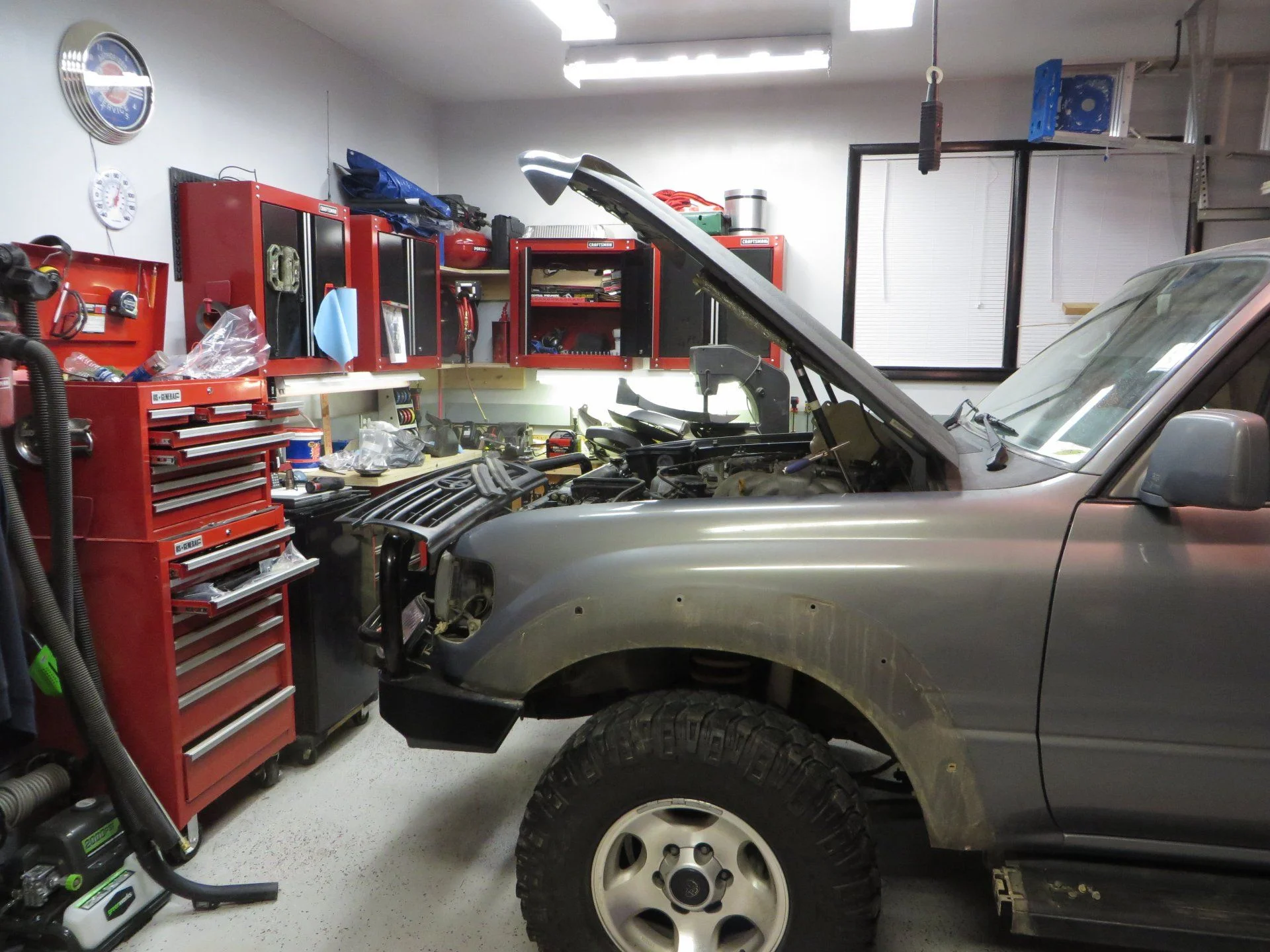

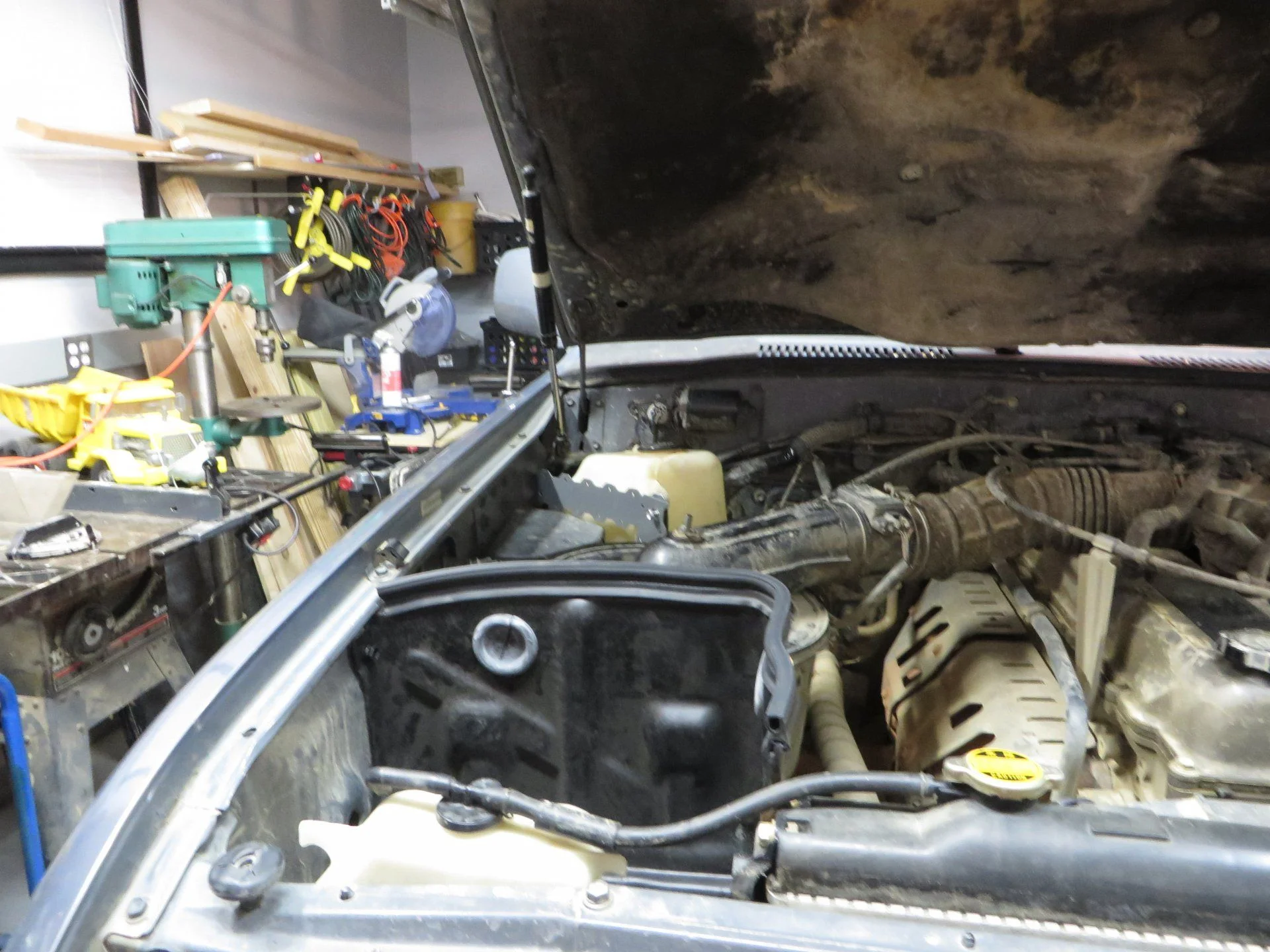

Pulled the clamshell on the 93 while tearing out the alarm. It was rattling and Gerry rigged in place by the PO. Put epoxy on it and will let it sit overnight. Same thing happened on my 92. Fixed it this way about 5 years ago. I have a new clamshell in case it doesn't.
