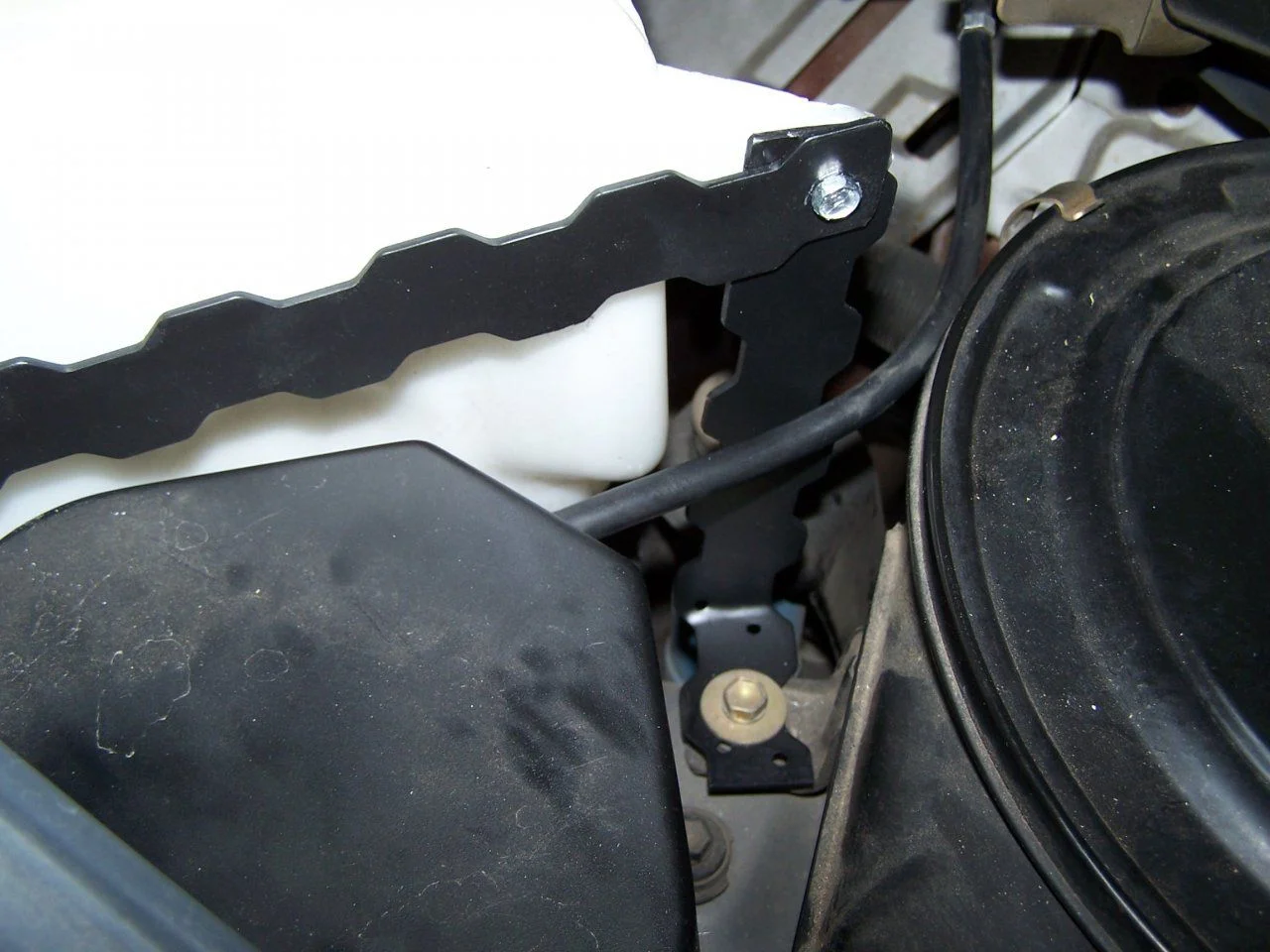

Picked up a used passenger side battery tray. Needed to move the washer jug.
FHA30 Simpson hold down strap $3.91
Two bolts, a dash of paint, etc $0.25ish
The strap is just soft enough to bend, but tough enough for the job. Patent pending....

The factory washer tank is smallish compared to the one Slee supplied with ours. Still, when filled, it's a bit of weight. I like the looks of George's homebrew better. Not saying you'll have issues here, but I would keep an eye on things until it's been flogged enough offroad to confirm the softish strap is sufficient.
For the money, I think just getting TWO of the straps and doubling it up should give you reassurance all will be well longterm.
