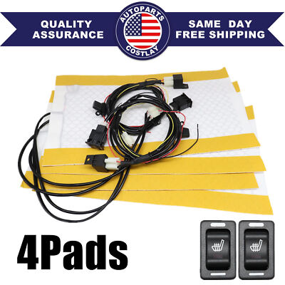

When I reupholstered the seats in my 80, I used a kit that looked just like this one on the eBay link below (I looked and the seller I bought from is no longer offering them, but the kit look identical)
I used the complete kit (heating pads and switches). If I remember correctly, I had to slightly trim the width of the trim piece on the switches so they would slide into the coin holder slots in the center console. I was originally planning to buy/use a set of oem vertical seat switches, but soon learned they were difficult to source (even used) so went with the ones in the kit and they have worked well.
