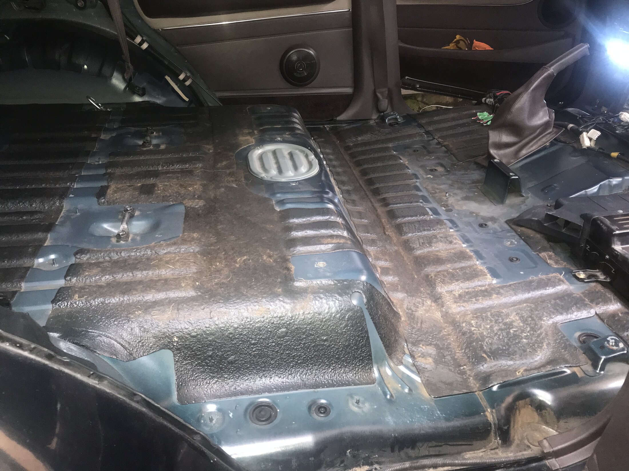

That's the cleanest looking floor I think I've ever eeen. Has that thing been in storage for 30 years?I hope it will help! Cheers
There are two body bolts that secure the lower rear edge of the front fender to the body. Remove the frontmost bolt. Both of those bolts are attached to weldnuts that are in the "floor" of the rocker panel pocket that the sunroof drain tubes exhaust into. That pocket has to fill in order to get water into the rocker panels, so that it can then drain out. One of the two major design failures of the 80 series, IMHO.You wouldn’t happen to have a good location description of those sun roof drain outlets would you? A picture is worth a thousand words.
