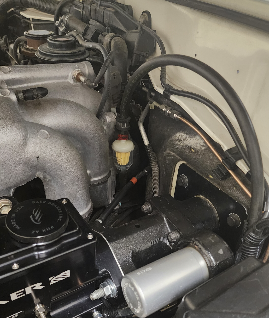

I routed my breather line up along the brake lines and to the back fire wall and installed a small replaceable filter. I also added a short length of tube under it, only a couple of inches. The clamp holds it very securely.
What up with your brake booster and master cylinder?

I got that much, using a Baer master cylinder but the deets are what I’m interested in. I was gonna mate a Tundra Master to a 2010 F350 brake booster, then modify the pushrod but curious what others have done besides Marks and Vanco.
Hmm. Well I still have my stockers. Buddy at work had these. I couldn’t find much info on them.
I purchased the setup through Sweeting performance about 4 years ago or so. I was not a fan of their customer service. If I did it again I would look for different options and probably put it together myself. The biggest issue is the adapter to the fire wall. They sell just the adapter and then you can put the system together yourself. I also have to install a pedal rod extension.
The Baer master I have is a 1 1/8". The pedal is firm but, I have yet to really drive it to have a good impression on braking and effort. I finally got this on the road a couple of weeks ago and still fiddling with some stuff. The one thing to take into account is the Baer system has the brake modulated mounted under the unit. It is a bit difficult to get to for adjustment. I have a socket and extension for this purpose now.
I added a PSC power steering reservoir that I added as well. Definitely the way to go. I had a tee in the line originally, the pump did not like it and had whine. Now, nice and quiet.
Did you use 1/4" line?
I don't recall, getting old, but I believe that is correct. I think it was the same filter that Tools-R-Us used.
From the limited searching I did I think 1/4" is the correct size.
