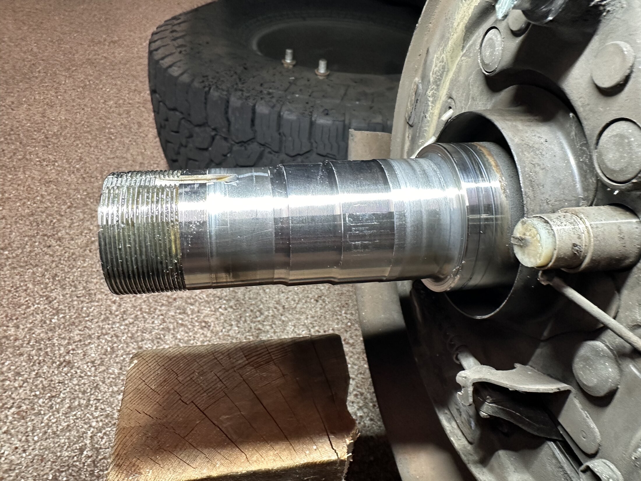

Rear axle service. Plus all new brakes except hard lines.
Managed to get this far in the rear. Wrestled both rotors as the parking brake innards were all foobard. I don’t remember when I services the pbrake last. Also never serviced the rear axle 😳
Bearings look ok. Zero grease only gear oil!!
