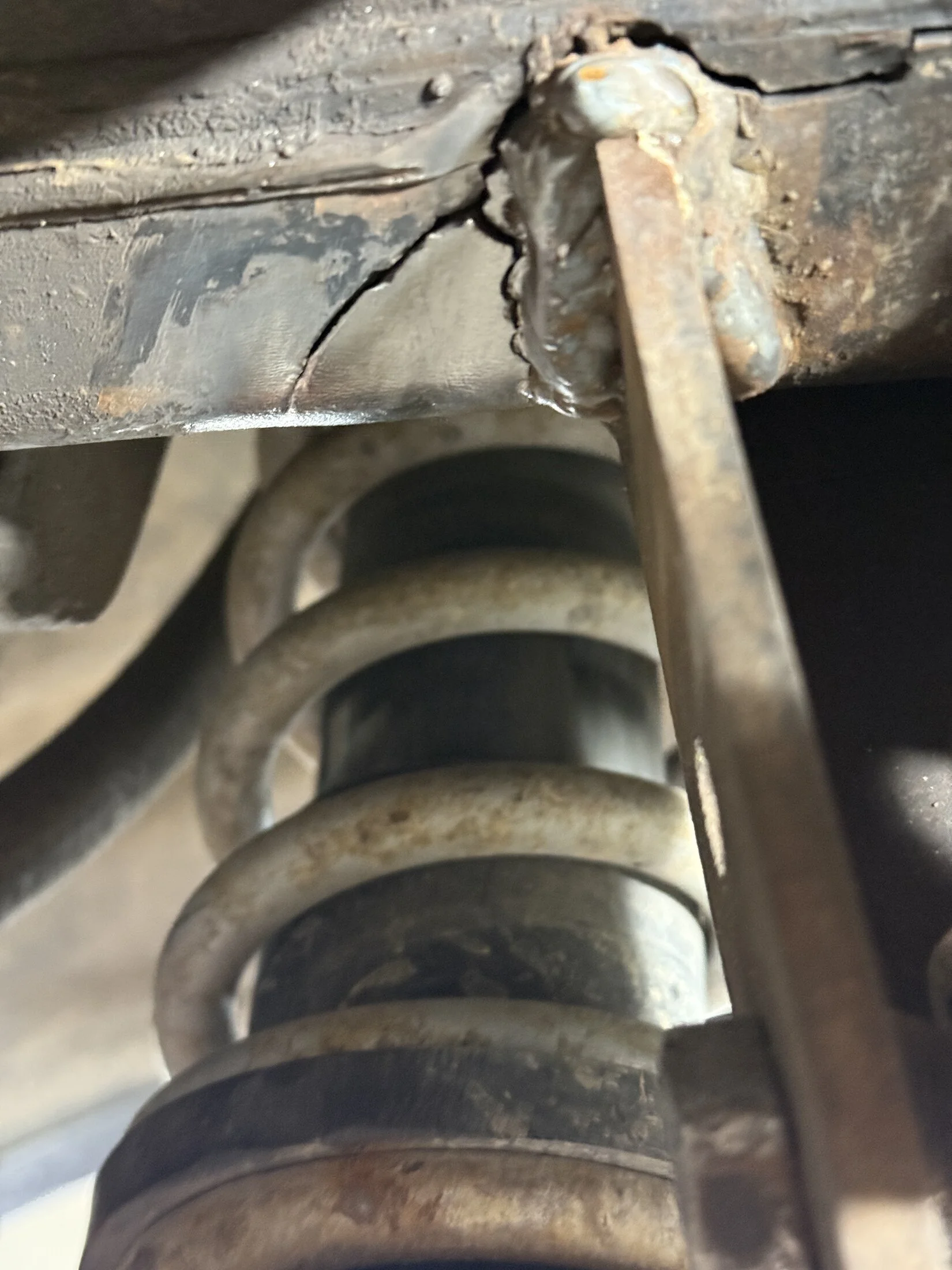

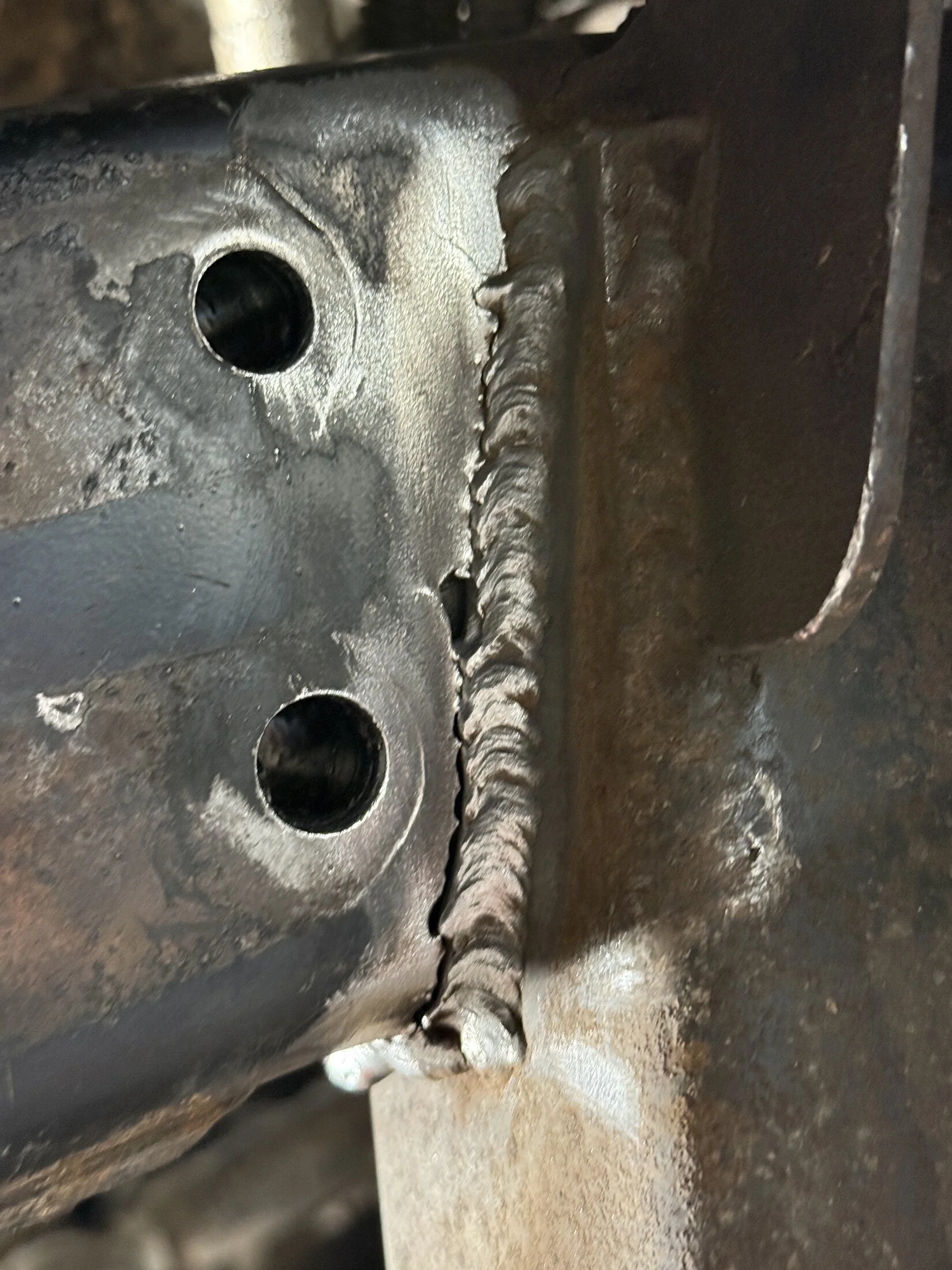

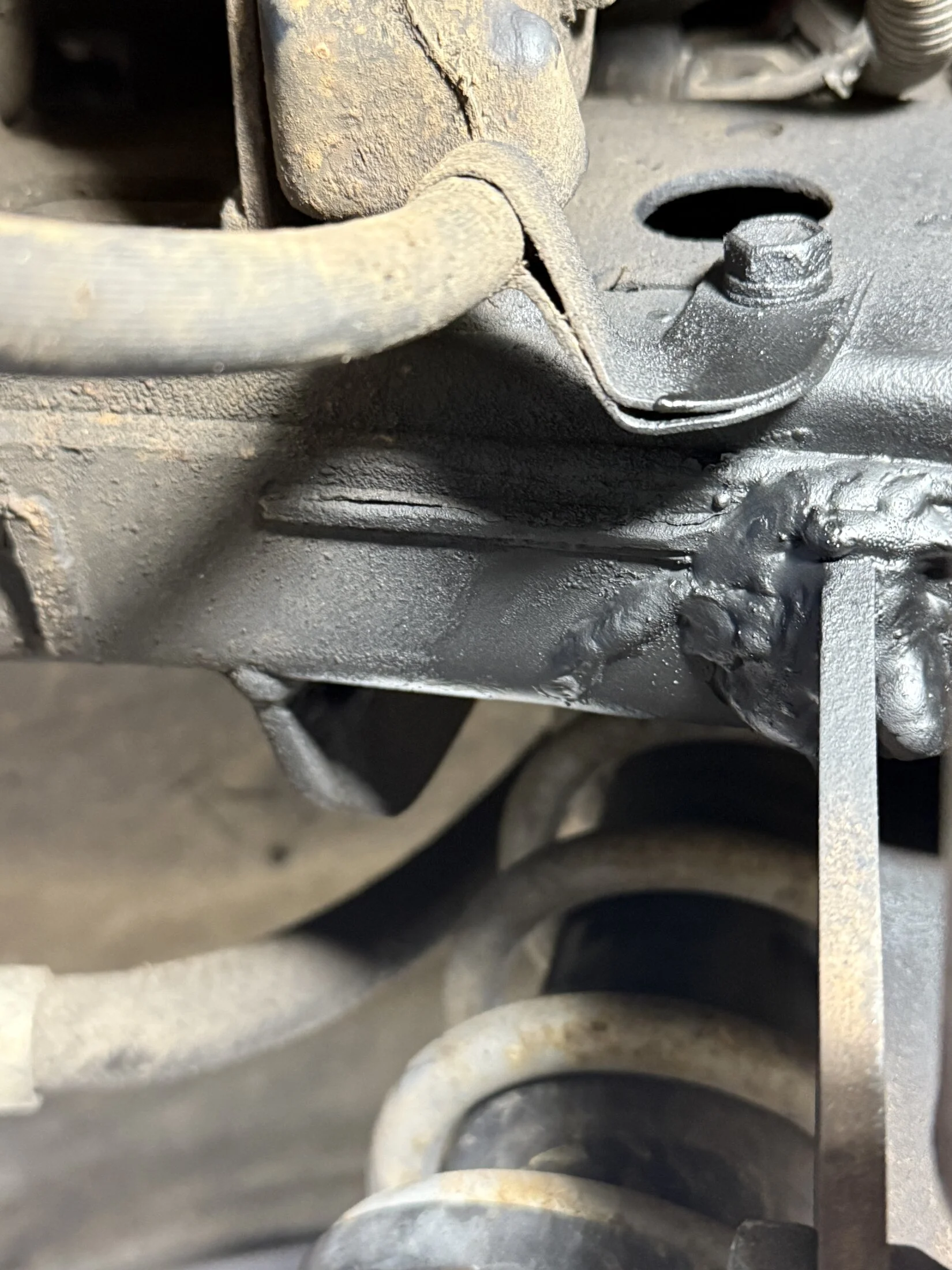

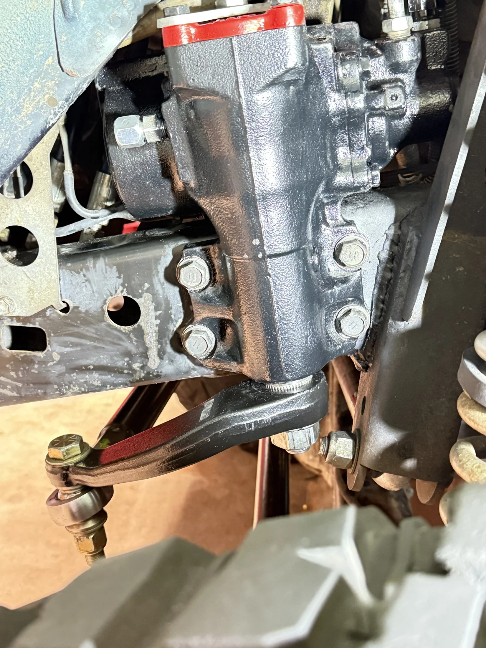

Fixed my death wobble.
Cleaned the weld up best we could and had to stack some welds. The old bugger welds are from when I tried to fix it last time.
Also installed the Redhead. Need to take some measurements so I can get my PSC ram and get the assist going
Yeah that’s a rip in my frame.
That shadow along the weld on that top photo makes that photo look way way way worse than it was. Not saying it was anything good but that photo/lighting angle does you no favors lol

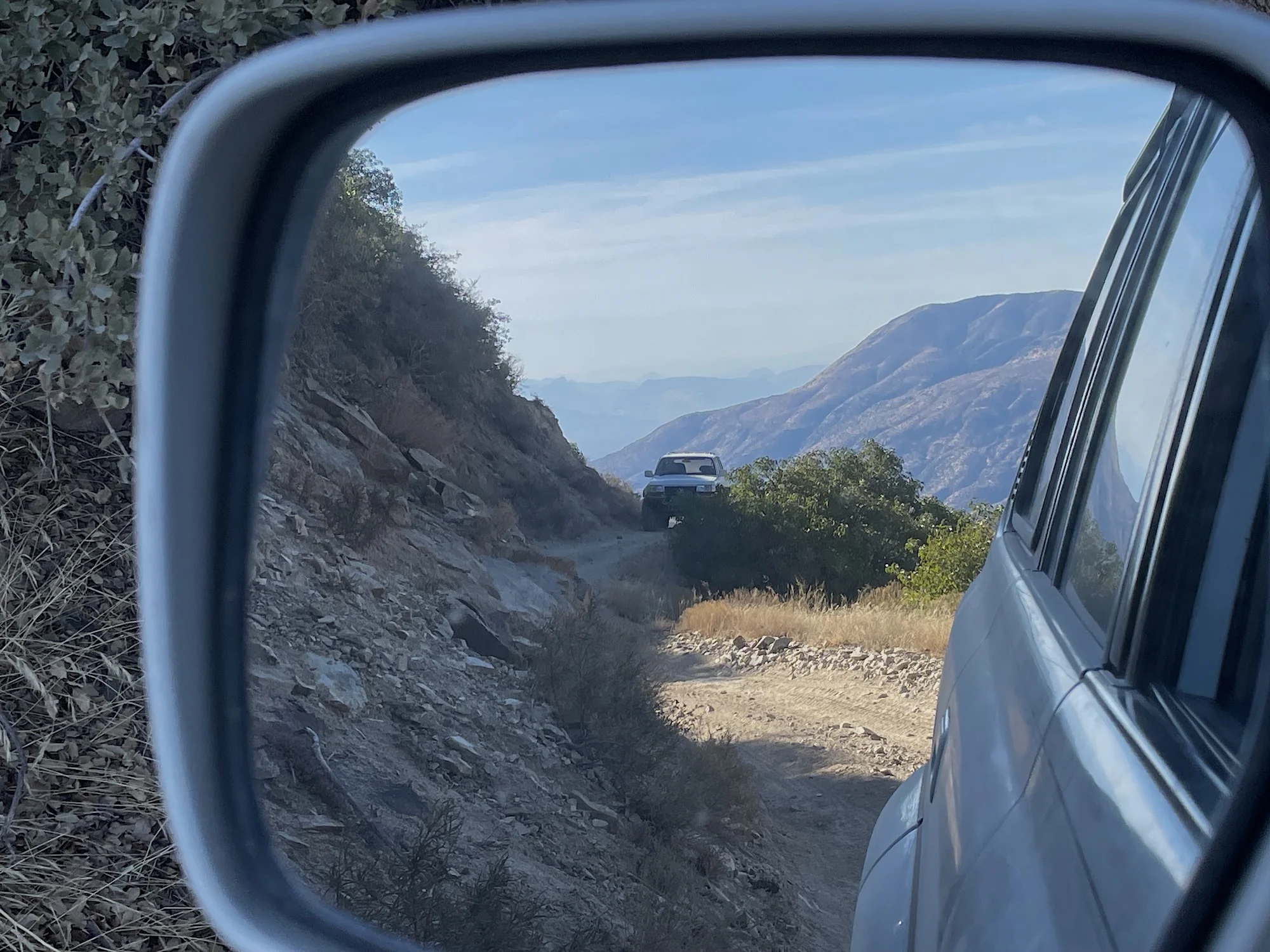

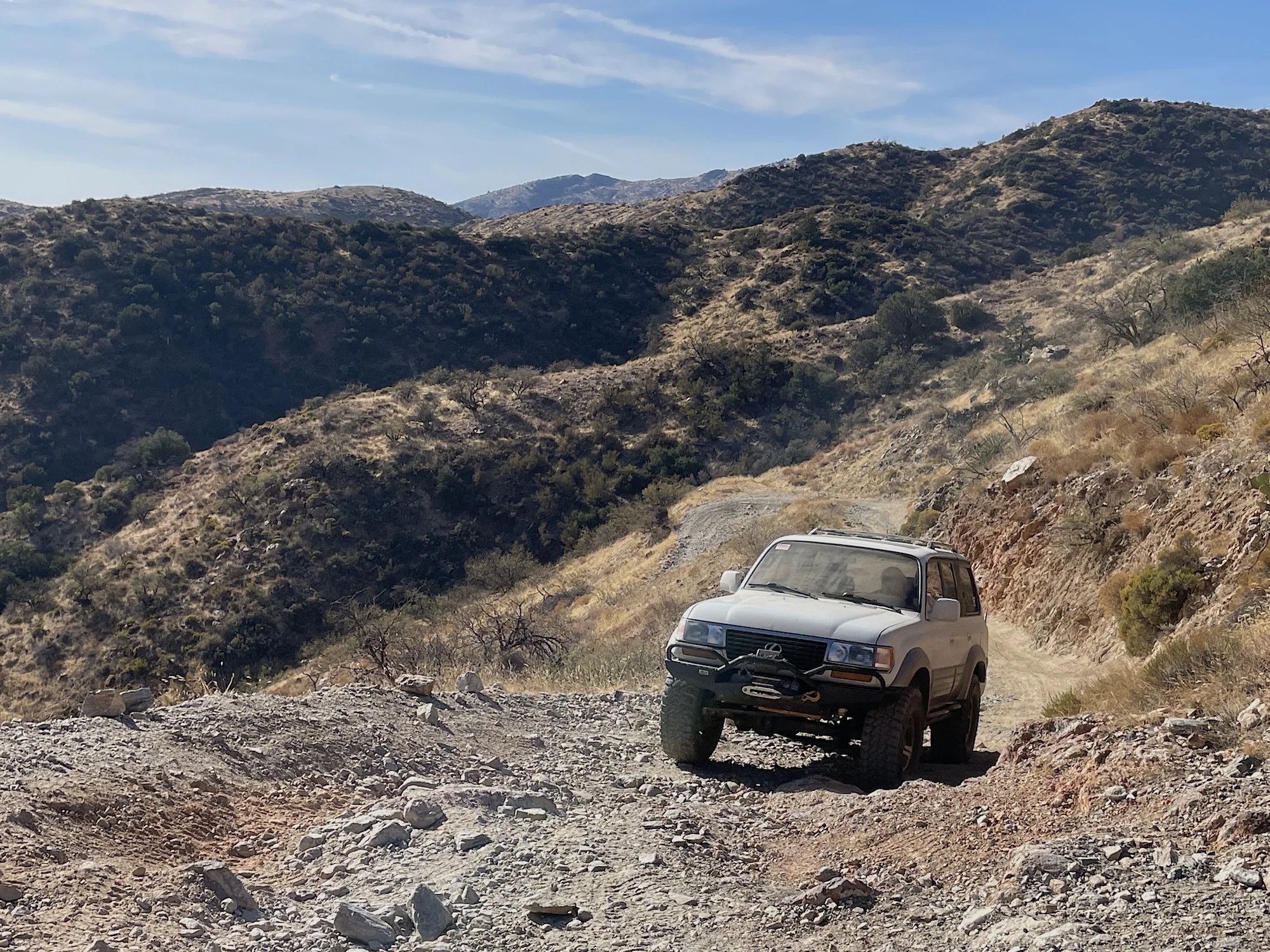

Claudia coming up on the switchbacks:

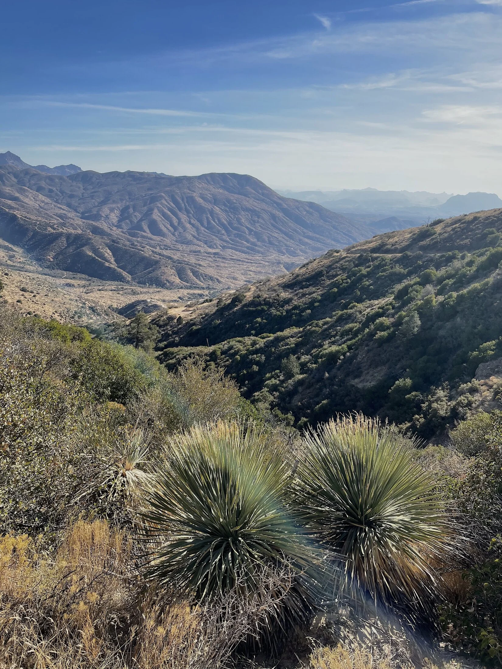

Looking back at the valley where we came from...
The flat-topped mountain in the haze on the right side is Picket Post mountain, and you might be able to make out a sliver of the town of Superior following the foot of the mountain to the left. Superior is a mining town, like many others in this part of Arizona.

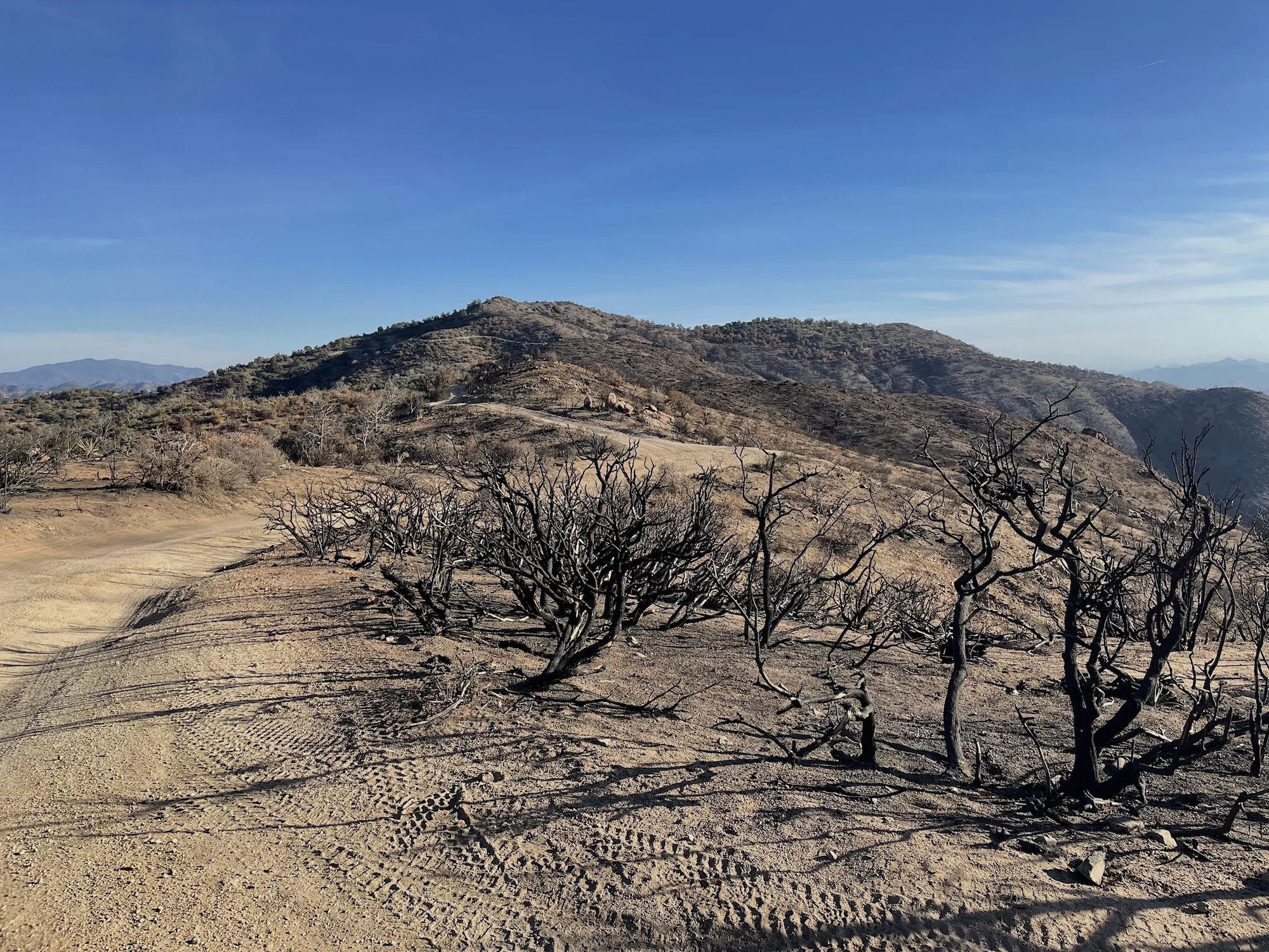

The old lunch spot about midway through the trail fell victim to the Adessa fire in 2024:

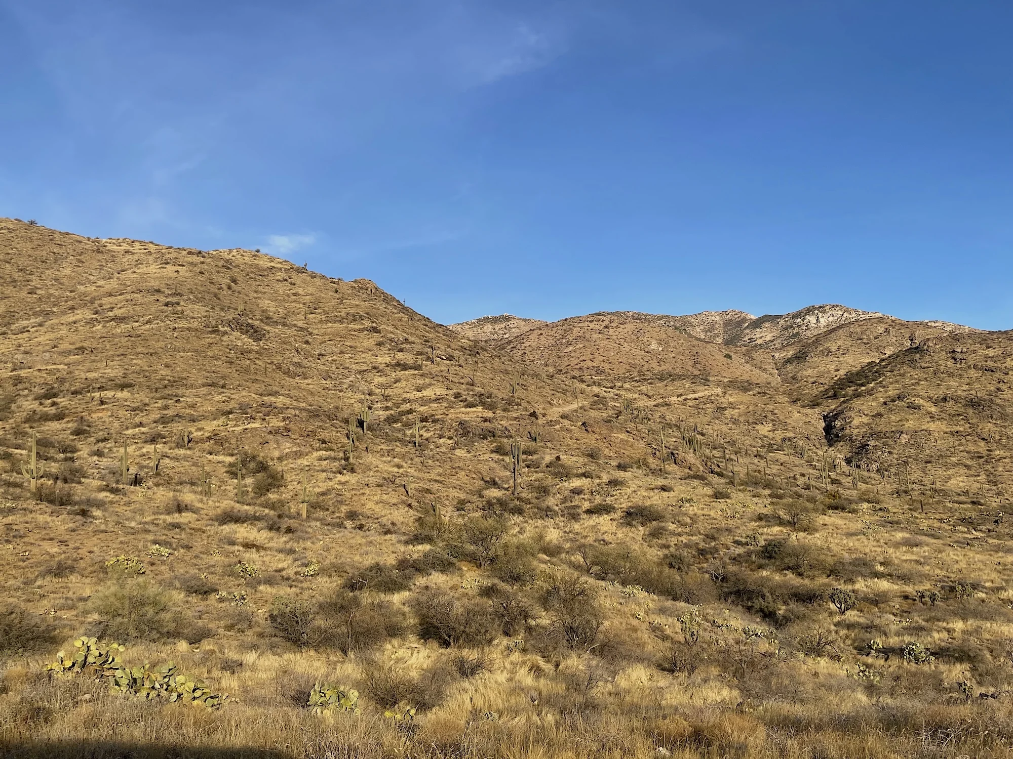

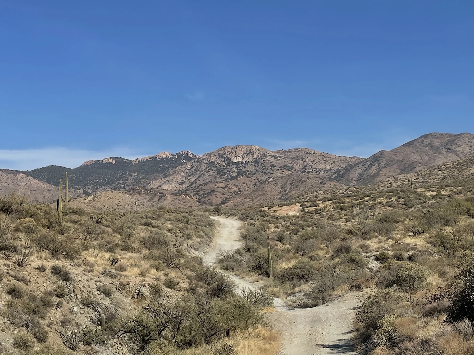

OK, fine, back to Saguaro cacti: as the trail descends back down, we get back to views similar to those of the last few weekends.

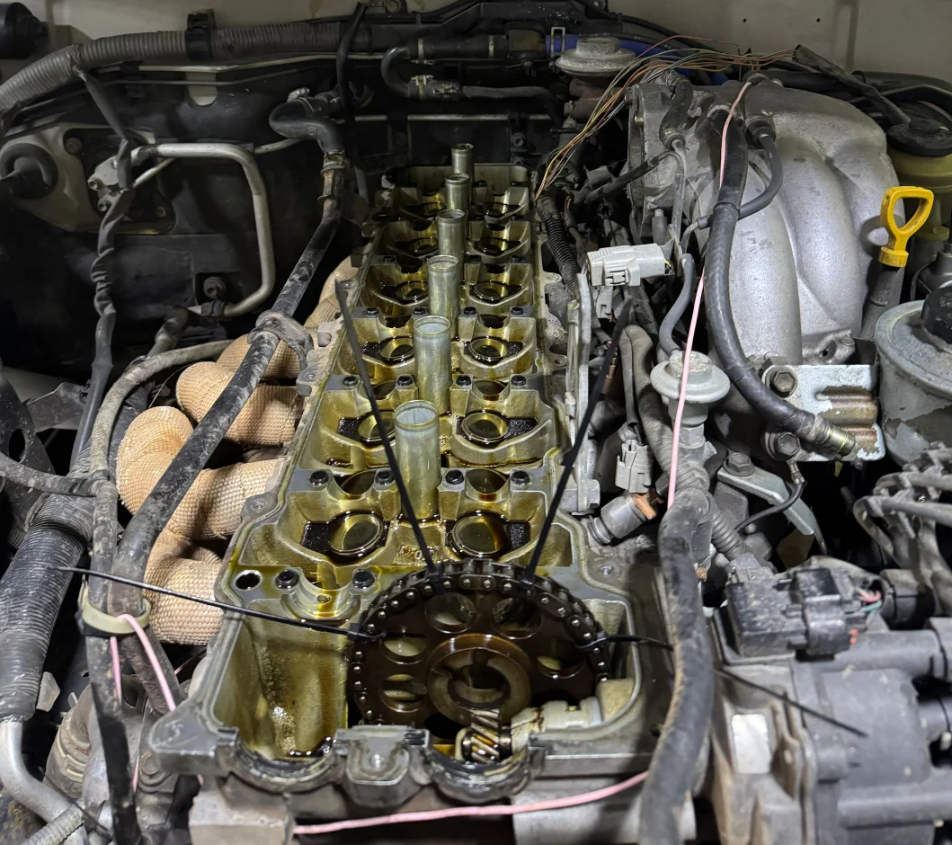

Tore into the Valve Seal job on my FZJ. It's needed seals for 60k miles so I decided now was the time. The PO had done a headgasket job and used non-OEM seals. Most of them were hard and crumbling. A couple weren't even seated on the valve guides.
The engine looks SUPER clean for 320k miles!
I hope to have it back on the road tomorrow.

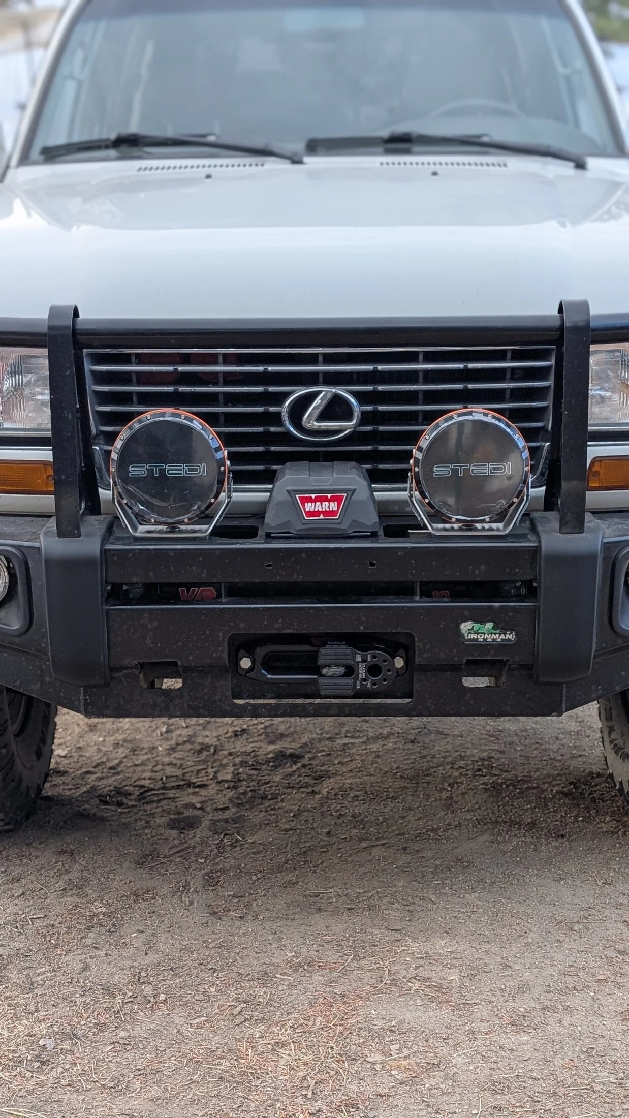

Also wired up my Stedi lights. I've got the same set on my 70. Really like that they come with a wiring harness and relay that handles tying into the high beams. I used the generic switch they come with but hope to get a more factory switch wired at some point.

That is extremely clean, especially if you have been running with leaking valve seals for a long period of time.
Now is also a great time to replace the fuel injector o-rings, pre-emptively wrap the fuel injector harness wiring with fiberglass wrap, as well as replace the fuel pressure regulator (on the fuel rail)
looking further…. might want think about also replacing those heater hoses and heater valve. they look original (other than the blue inlet hose). Might set you back a couple of days getting back on the road, but they are soooo much easier to access with the throttle body and valve cover removed.

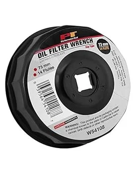

My life got better after I got this oil filter socket.
Description was "73mm 14 flutes Bulk Filter Wrench" and it perfectly fits the 90915-YZZD3 oil filter.
