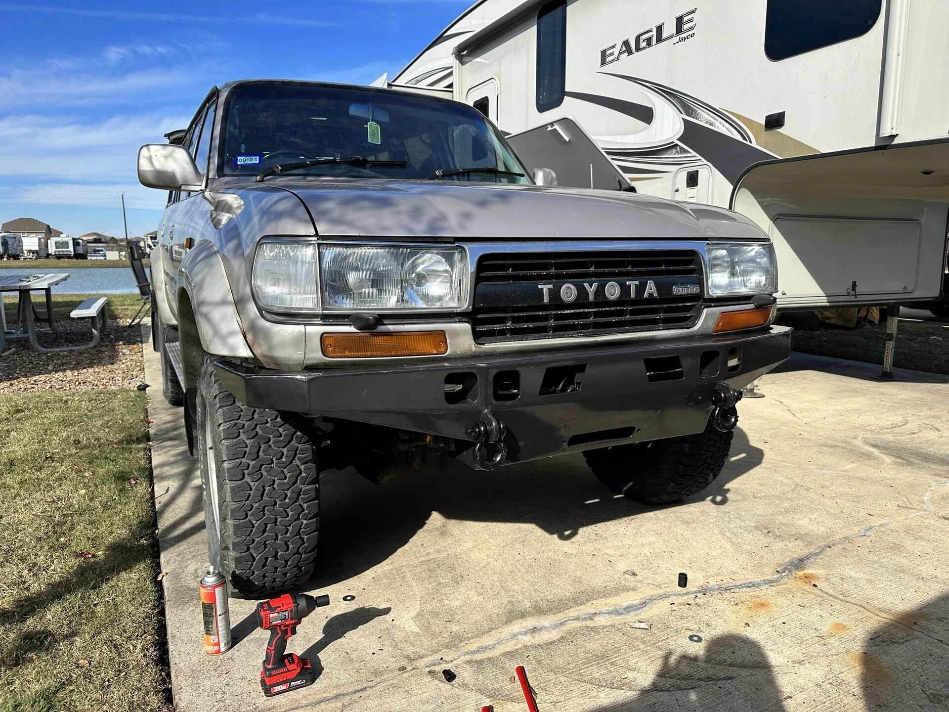

Got my coastal offroad bumper finished, painted and installed.
4 buffing pads and 5 hrs of sanding welds i'm very pleased with how it turned out.
Paint was a 3 coat system, industrial zinc primer for corrosion protection, industrial epoxy midcoat, and sherwin williams urethane topcoat with clear.
The color is "Black Magic" for anyone curious and its VERY close to the factory two tone grey. It has a nice brownish, grey, black tint to it.
Gonna try to stuff some 35s under it in a month or so.
