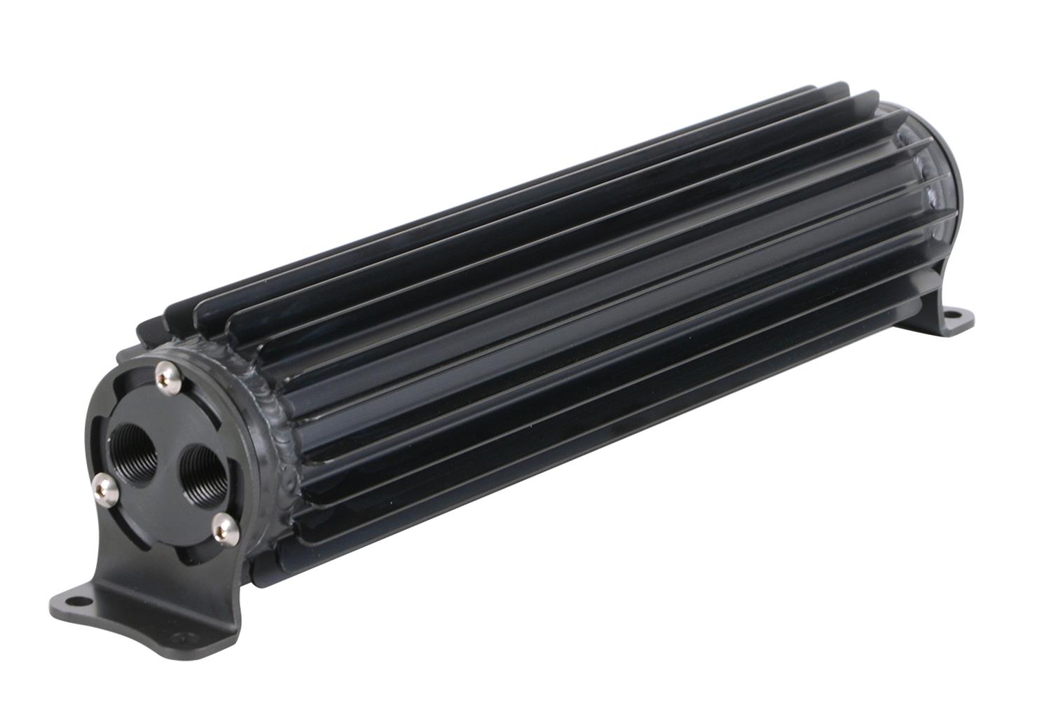

If you find the Toyota part number and google it. I don't think it is a discontinued part so if should be obtainable from almost any Toyota dealer, Google Ebay, Amazon etc.. Partsouq, Megazip are offshore sources. Otherwise install any generic cooler from Summit, Autozone etc.

You’re right it’s not discontinued but OEM is super expensive. Gotcha, I’ll look for some aftermarket ones. Thank you :)

I took mine off to do the upgraded cooler like the Witt's End kit...pieced it together myself and installed in a couple of hours. Bigger cooler definitely helps my growling when out on the trail, mainly long, slow uphill climbs when it would get noisy. Yours would be a breeze to install it on without the radiator in there (if it's still out). I wanted to try and save my OEM part, but had to do a fair bit of bending to do so. Upgrade cost me about $140 in Amazon parts.

Would you mind sharing the list of needed parts?
