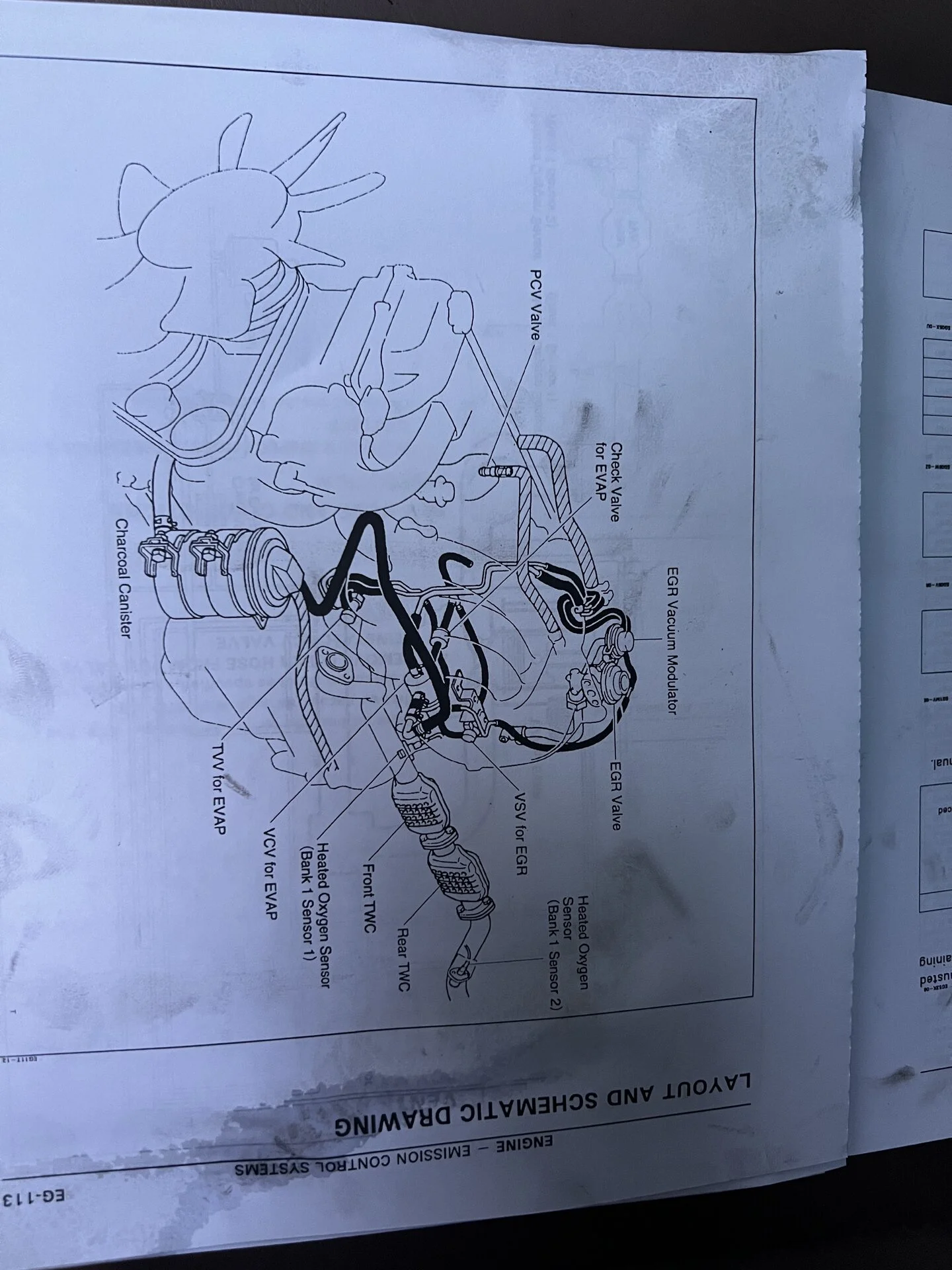

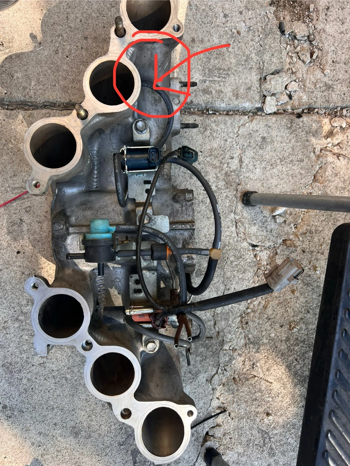

Chasing the P401 code I dove into pulling the manifold/throttle body and cleaning them, swapping the VSV all vacuum lines and while there the fuel filter. There are two vacuum ports on the manifold I can’t find in the FSM does anyone have any idea where these go? In these pics per the FSM I have these connected wrong. FSM states the VSV goes to the EGR valve. I corrected this and still the truck turns over but won’t start. View attachment 3439612
The circled hoses connect to opposite ends of a metal tube which is installed inside the upper intake manifold. There is no connection to intake manifold vacuum at this point, but one problem which can occur is that the metal tube gets blocked. A cheap vacuum pump w/gauge is an indispensable tool for diagnosing these sorts of issues.
Are you really having a no-start issue, or was that a mistaken statement? If so, that is more likely related to replacing the fuel filter.

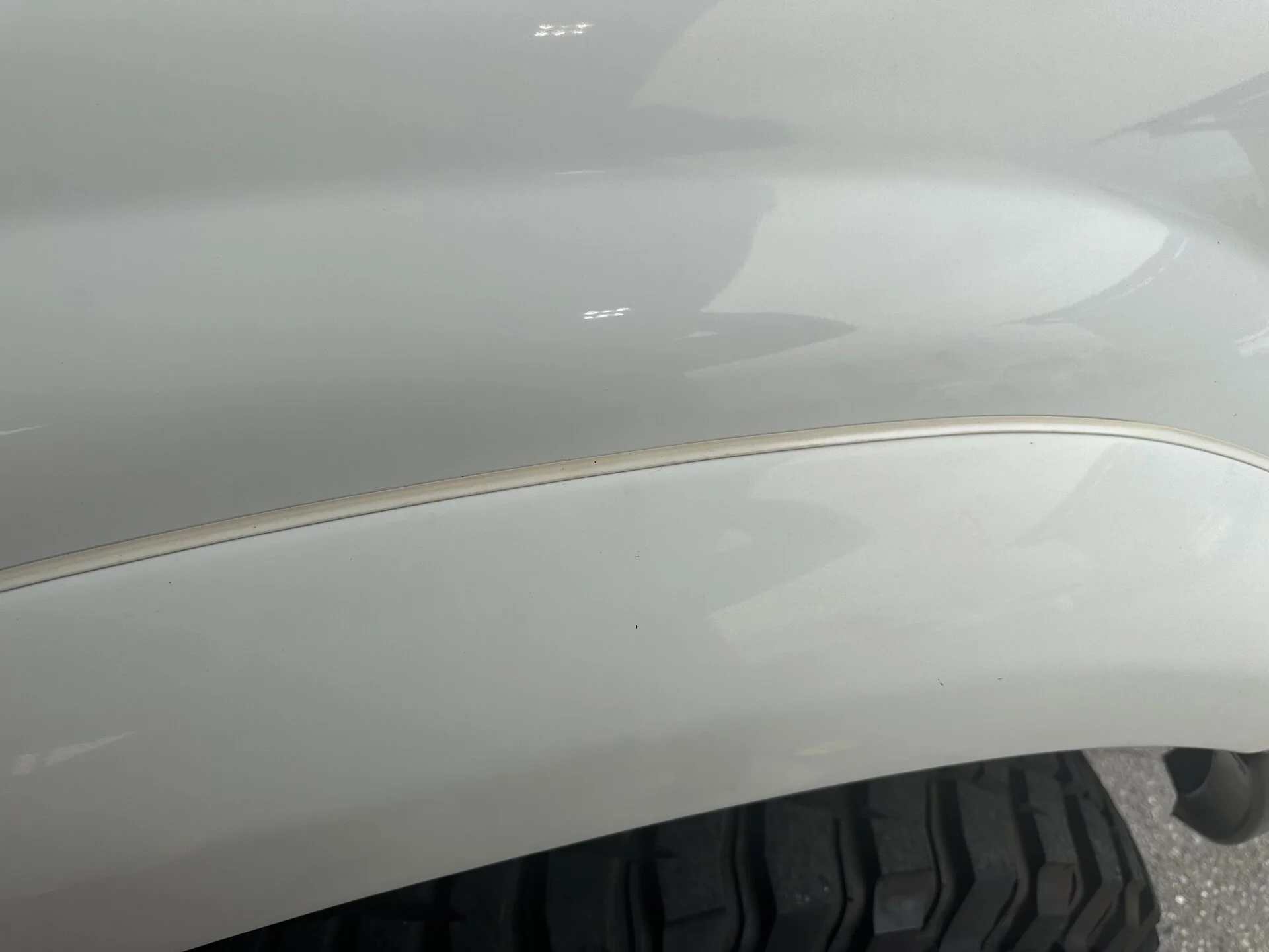

Front end rebuild, little brake refresh, rear window rust fix and seal replacement.

Accidentally bought the wrong window seal, this one has a cutout for a chrome trim piece. Oh well
Yes no start issue persists. The engine cranks but won’t fire over. All connections seem solid Rechecked the fuel filter and it seems good. I’m stuck here scratching my head on this one

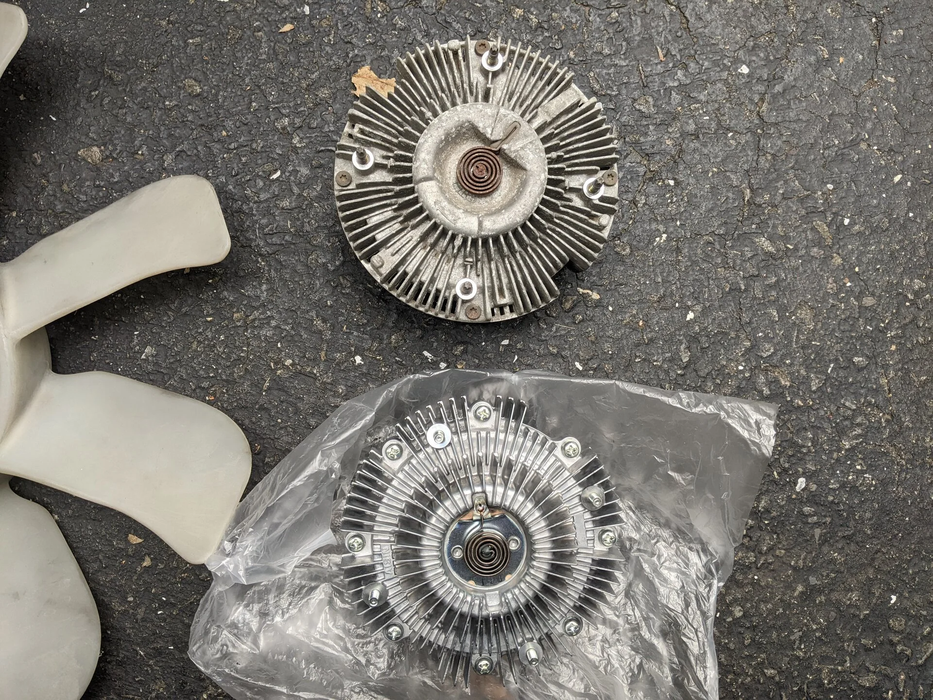

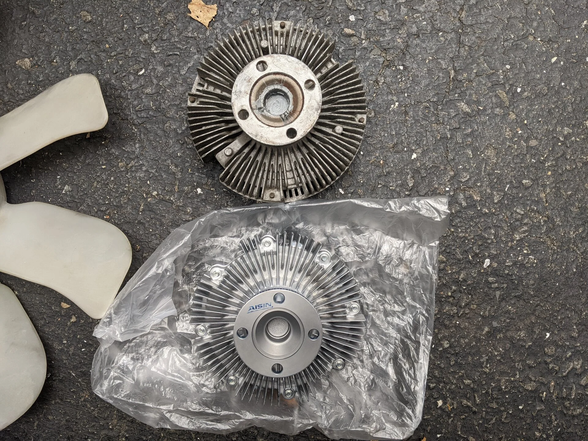

finally got around to replacing the fan clutch with one from landtank. any guesses as to the provenance of the old one i pulled out? no brand markings i could find. is it worth refreshing or just toss it?

thats an Eaton clutch. refresh the silicone oil and it'll be good for another 30 years as long as the bearing is fine
I tried to get my Eaton to work better and finally shucked it for the aisin, upgraded and reclocked. YMMV
I don’t know the answer off hand, but they clog up so be sure to clean them out.

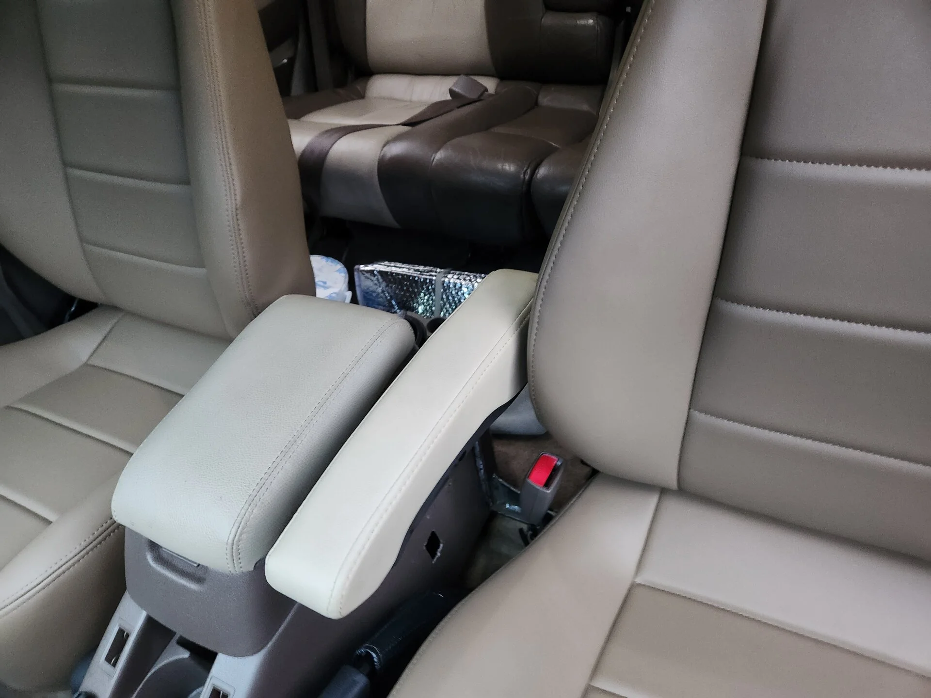

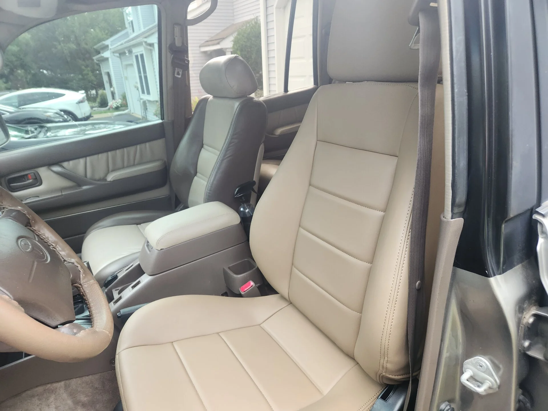

I was planning on retrofitting some BMW seats but I would have had to do some cutting of the floor that did not want to do and Installed new CORBEAU sport seats with Planted 80 Series seat brackets with custom armrest bracket. It was a lot easier installing these seats with the brackets and took away a lot time from customizing the BMW seats to fit I also installed a new armrest that I purchased from eBay “Adjustable PU Leather Seat Armrest Pair L&R for Car Truck RV Van Boat Universal” and made a bracket for the driver side seat.
