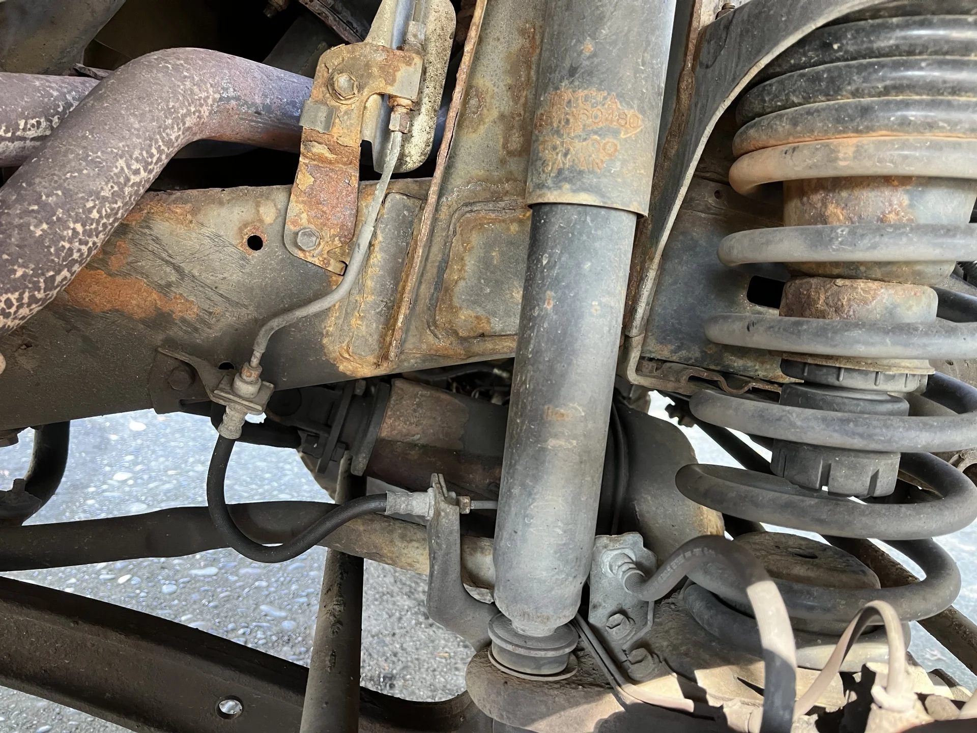

Things rust around here for sure, depending on where you are driving. This is what my Land Cruiser looks like after 10+ years of going to Snoqualmie Pass every weekend during ski season. It's not horrible but but definitely not rust free. I cleaned it up last summer to try to stop/slow the rust. Washington started salting the roads probably 10 years ago.

Yeah, I'm not really great at taking care of the cars. Not much chance of me getting out there every week to rinse it off. It was a bit of a surprise that it was as rusty as it is. I knew there was some rust but didn't realize it was that bad. I hit it with a wire wheel and used some of the Rustoleum rust reformer. Last year I did a half-ass job with some Woolwax and still need to spray it this year.

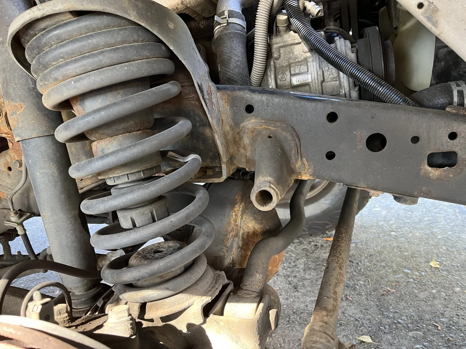

Found this deformation in the cross beam in the front oc chasis when i was cleaning the car. Not sure what to do with that, any thoughts?
I’d leave that and not give it another thought. Looks like possibly from a chain down while on a ride from a wrecker.
If the OCD won’t allow it a 3-5 lb sledge should be able to flatten out a bit.
