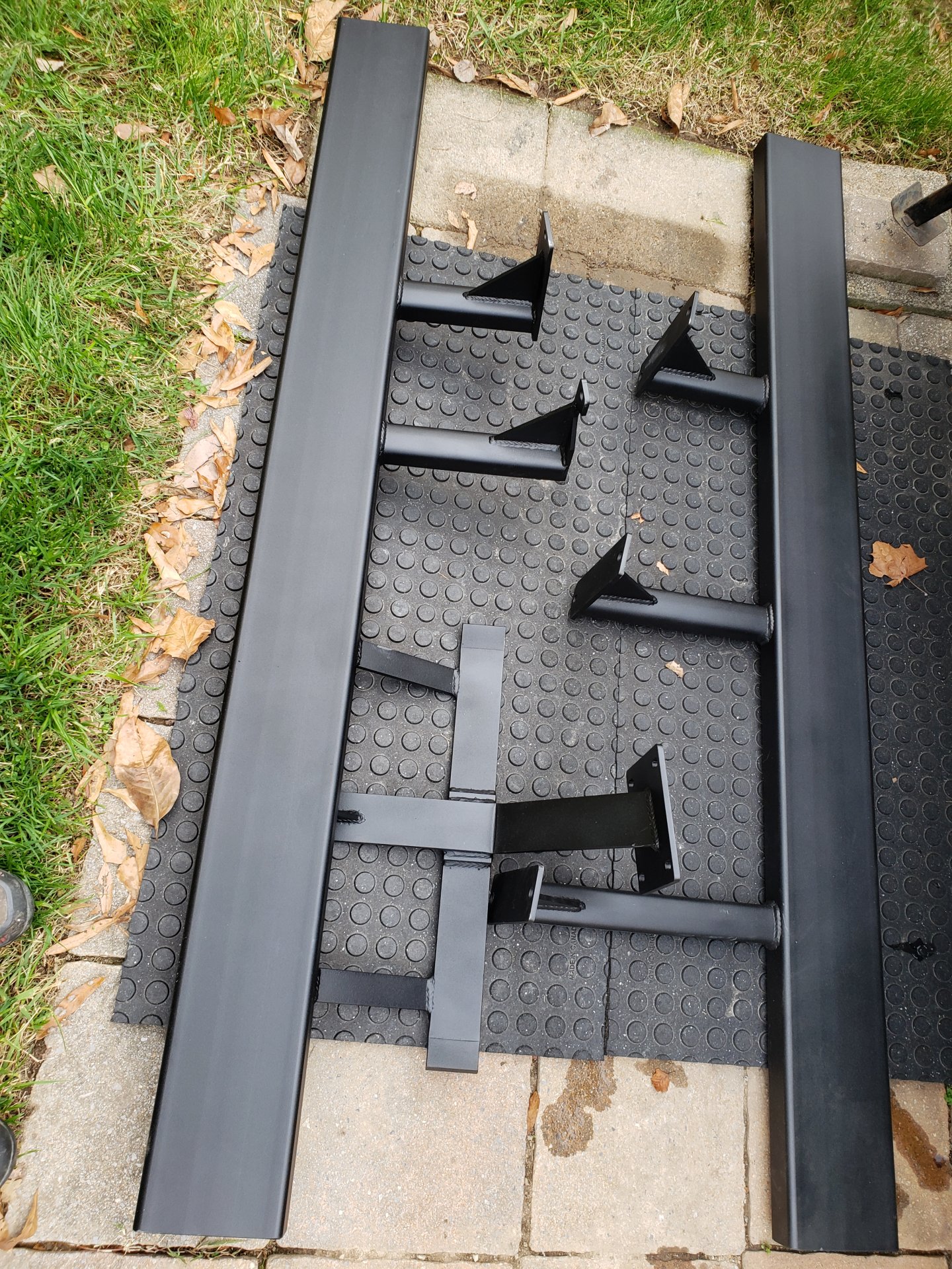

Just noticed that these are sealed and makes me wonder if plumbing these as air tanks could make sense in the future. Air line quick connect on each end would be close to the tires as one benefit. On some of the old farm trucks I used to drive the bumpers were sealed and used as air tanks, refilled at the main shop as needed. With the 80 I could see plumbing in one of the dc compressors for filling these slider tanks.
Anyone have experience with air tanks this size and if how much of/how many 33" tires they could fill?

Uing quick math to estimate the size of that slider, one slider is 720 cubic inches. At 80 psi it'll hold roughly 4000 cubic inches or 17 gallons.
1 35" tire that's deflated hold about 7700 cubic inches of air at 32 psi.
To calculate you use.
P1*v1=p2*v2
80*720^3=32*v2
(80x720)/32=1800
(7700/1800)*2 = 8 tires
2 because 2 sliders
But I wouldn't want to hit a pressurized cylinder on rocks
i used 35s because I was able to find the volume from an old pirate 4x4 post

Might be an interesting experience if one pops on a rock.
@Dusten @Bryanseye Excellent feedback, thanks!
I never thought about the risk with the bumpers on the farm trucks but there are plenty of differences from then til now. Is there any information about the risks of an exploding slider with 80psi air in it, from anecdotal to a scientific study? Given how heavy the metal is I figure that if beat on hard enough that a weld would spring a leak but I was assuming there was no risk of an explosion or even of a small bit of metal going flying. Seems to me that the danger would be minimal or non-material to anyone in the area of the slider but I'm aware that I could be totally off based with that assumption.
My concern would be that a weld splits but that when it splits it throws even a small amount of shrapnel off and if anyone's near it it could cause minor injuries I wouldn't expect a major injury to occur.
I honestly think it would be easier to just install a small oba then to try and weld those sliders up so that they're airtight and will hold 80 psi
@Dusten
Yeah, the details that would need attention start to add up from managing condensation, adding hose connections that are protected and stay clean, fixing the powder coating after making modifications, etc. I like the idea in a number of ways though and if I were ever in a situation where I needed air as often as I used to on the farm I'd consider making the effort to convert these sliders but I'm definitely not there at this point. The weldwork does look good on these though and I wouldn't be surprised if they are already airtight, though I'm not very experienced with how hard achieving air tight welds on a build like this can be.
Thanks again, the calculations were both impressive and valuable and will be saved in my notes in case I ever revisit this idea.
That was my first thought too after, "Mmm. Good price."
It's not that they would fill the tires, but to provide a buffer for the compressor while you're moving from tire-to-tire or side-to-side.
Pffft. Ever seen the myth busters episode with the 3000psi scuba tank?
Exactly. The worst thing that would happen would be a medium (not a big) pssssshhhht.
We had a vendor drop off some oxygen tanks in the sun outside our shop one summer day. We heard the valve blow while we were eating lunch a few hundred yards away away inside my grandma's house. The tank left a track in the dirt about 50' into the shop, through the shop without hitting anything and it was wedged under the work bench against the concrete foundation.
P1*v1=p2*v2
80*720^3=32*v2
(80x720)/32=1800
2 because 2 sliders
That's fancy math. Quick math is that if the tire holds 7700 cu in at 32 psi, it needs about 11 sliders worth of air at 32 psi, or one slider worth at 350 psi. 😉

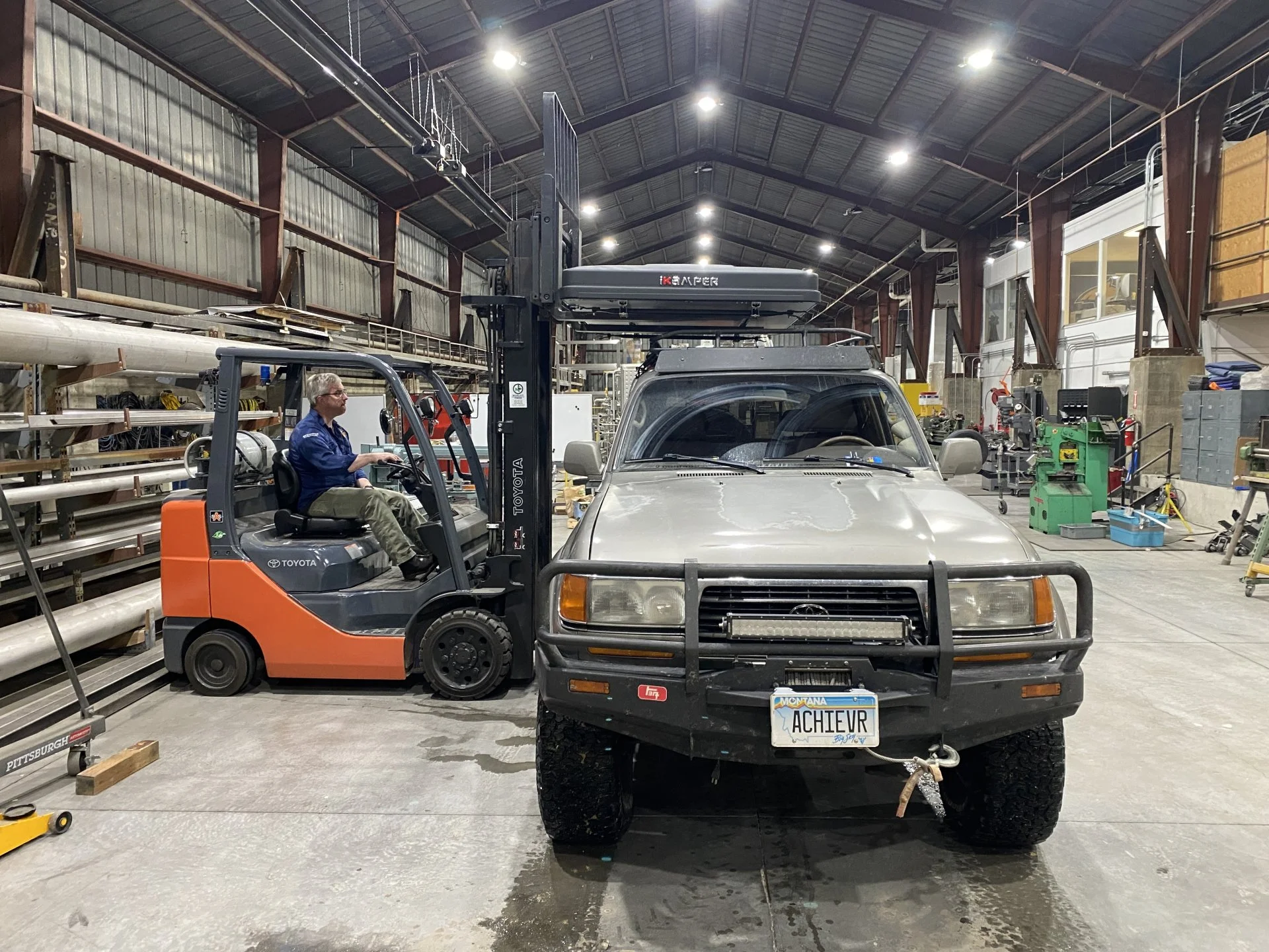

We replaced our old rooftop tent with a new one, and lucky for me I've got a buddy who owns a huge heated warehouse and a forklift. So much easier to wrangle hardware and rack cross bars with mechanical advantage, rather than wrestling all the weight alone in my exposed driveway.
Bonus: the forklift's a Toyota, too!
