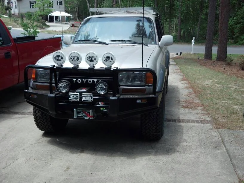

Haha...sorry about that.. Ya, that's about the extent I know about the build as this is the way the PO had it set up and he didn't know anything about the components he had installed. I myself have been trying to piece together what all has been done and using what parts. At first I wasn't keen on that big of a spacer but the current combination makes for a nice solid ride, a good amount of lift and reasonably priced if you aren't wheeling hard or carrying a lot of gear. I am thinking of going with a set of custom made springs and doing away with the spacers but my truck fund just got massacred with a massive vet bill... I will get out and take a few pics..

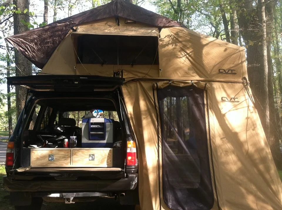

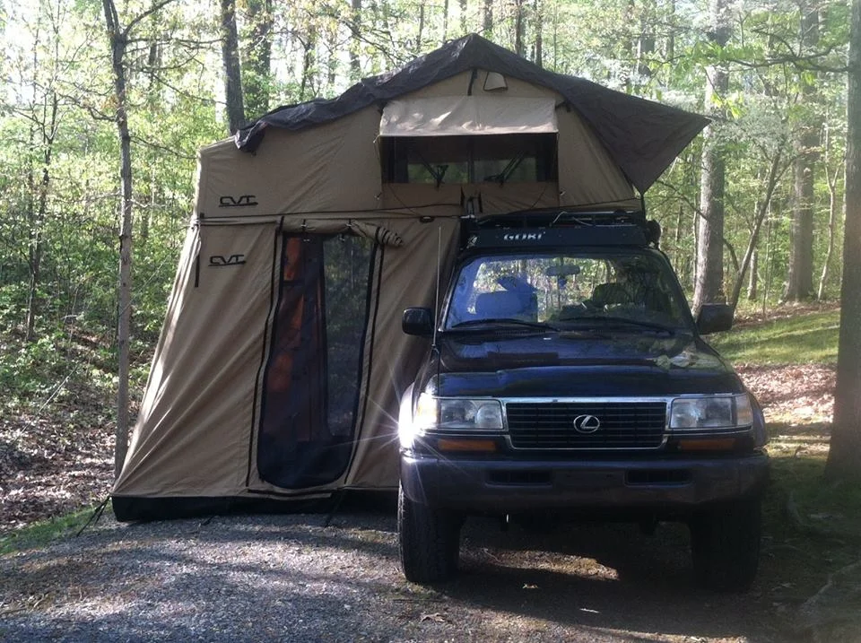

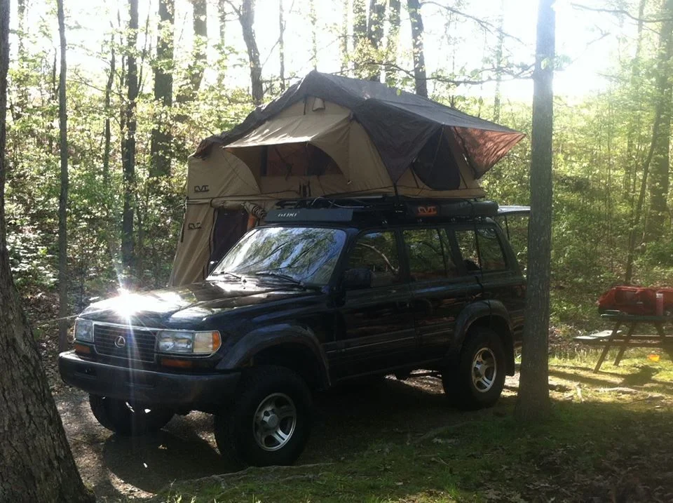

Did our first dry run this weekend down in GWNF - before our big 5 week trip out west this summer. Tested out the new RTT (along with everything else recently installed).

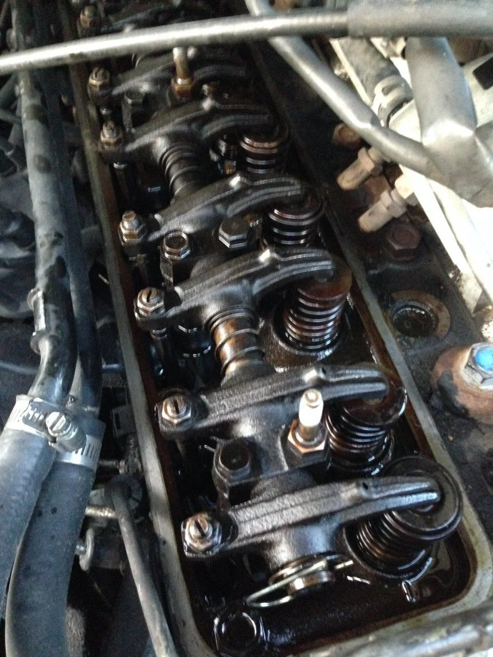

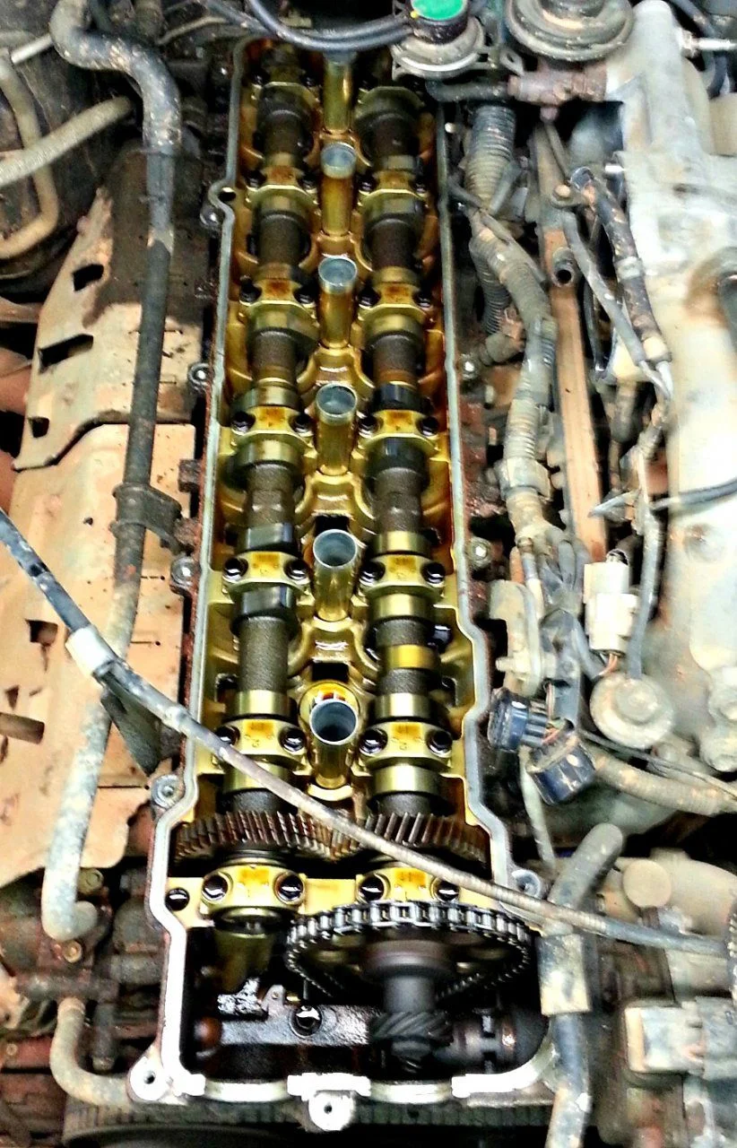

Been chasing a "chugging" sound upon startup and shut-down for the last 2 weeks on my 3FE. The only thing I could think of was valve issues. I opened her up and did the valve adjustment per the FSM and seems to have cured the issue. Odd thing is that I did this just a few months ago and it already moved out of spec? Why?
Anyway, a couple of pics of the head...she looks pretty clean for having 275K miles. I've not done anything but change the oil and normal PM to the motor. This is the third time I've done a valve adjustment on the truck. The first time I screwed up and didn't set the motor at TDC, the second time I thought I got it right but obviously something changed and this time I'm pretty sure all is correct. Anyway, I'm getting faster at it. It only took me about an hour this time!

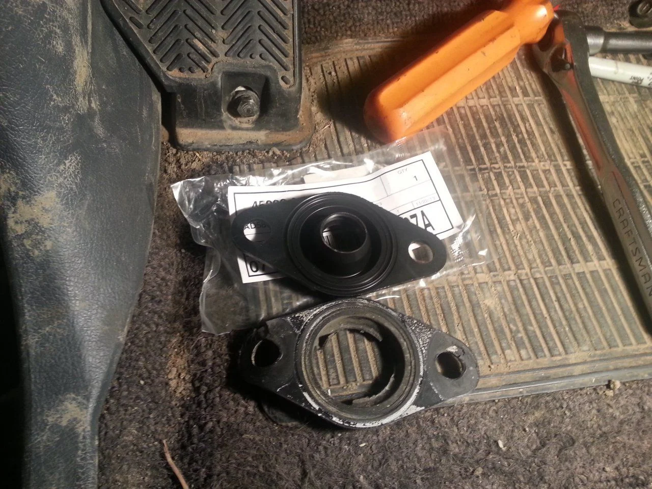

Got hot feets? I did last summer.
I replaced the main shaft seal on my steering shaft. There's a couple good threads on here. Took me about 25 minutes and bye bye hot feets. The old one was toasted.

You mean a seal is supposed to be there..... Hmmmm

Just a quick tip. I did this repair last year and kept getting a rubbery, squeaky sound. I ended up spraying a little silicon lube on it and its all gone. It will probably help extend the life of the piece too. Cheers!
