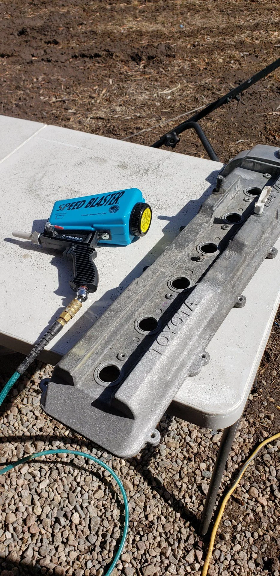

Media blasted then hi-temp engine enamel on the alloy. Took the spark plug covers apart to paint as well. Thinking about doing it to all the alloy parts while they are out. Waiting for the new short block to be finished.

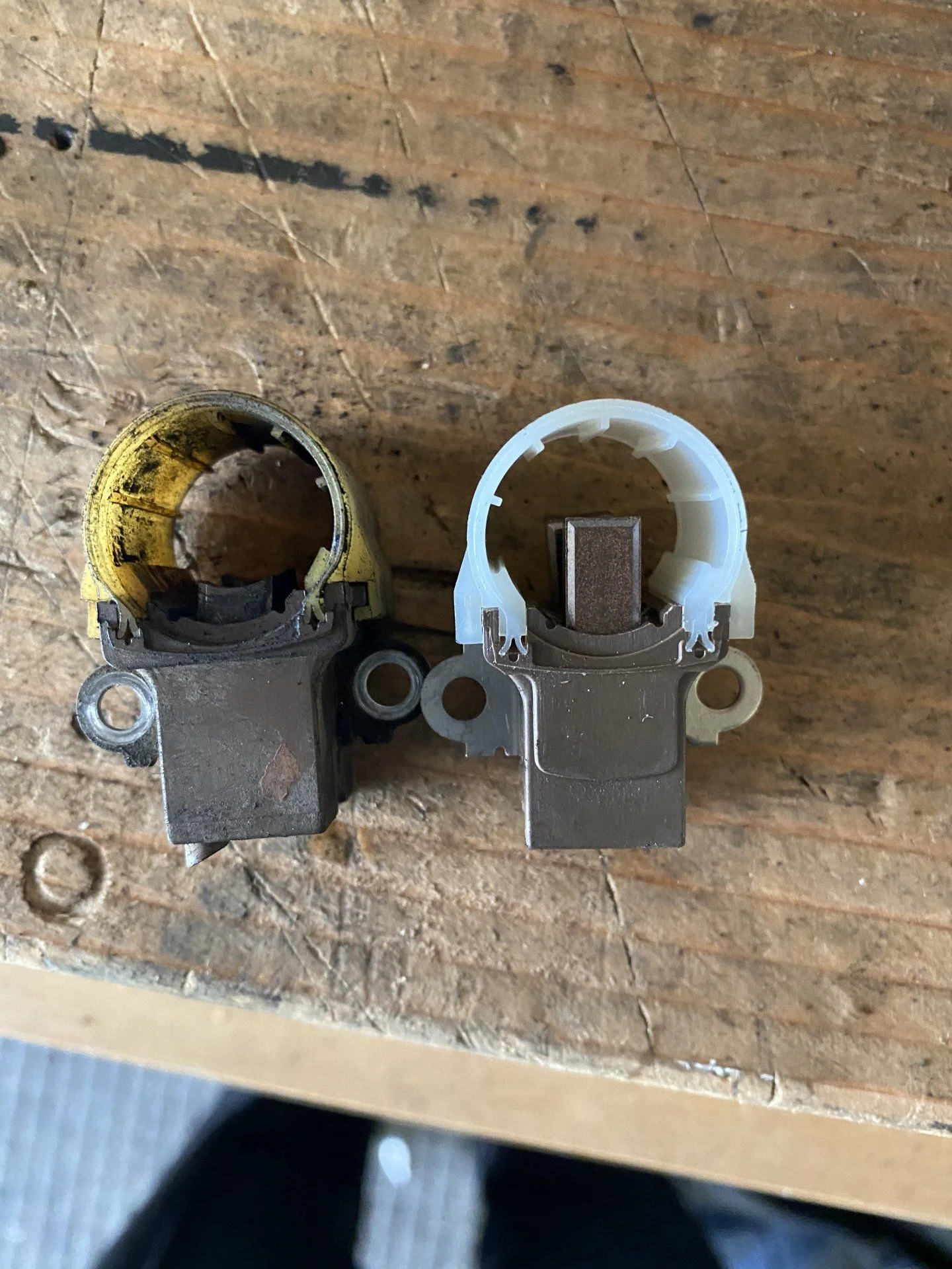

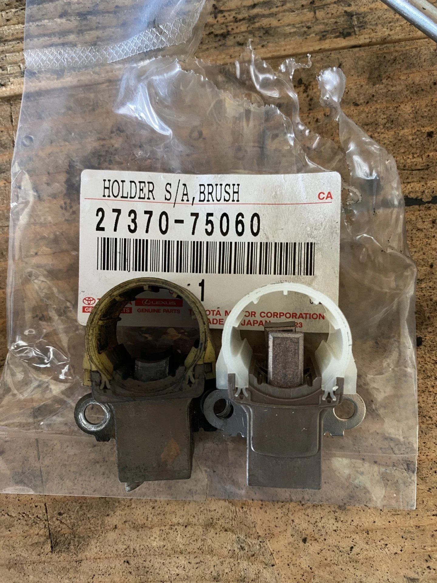

Replaced the brush on my alternator. Unknown if it had ever been done or if the alternator had been replaced.
