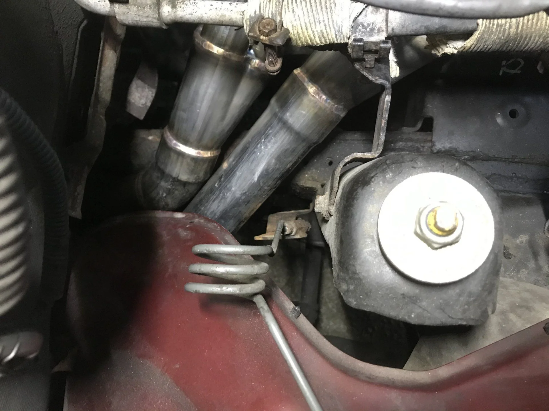

After troubleshooting code 25 (lean air), I wrestled the exhaust manifold off and watched the donut gaskets crumble to dust, the manifold gaskets were shot too. After looking the manifold over, it wasn’t cracked, but pretty warped. I used it as an excuse to get with Dugan over at ACC Toyota. I’m pretty pleased.View attachment 2471343
Wow, looks great. I need to do my whole exhaust soon. Can you share the link of the exact headers you got?

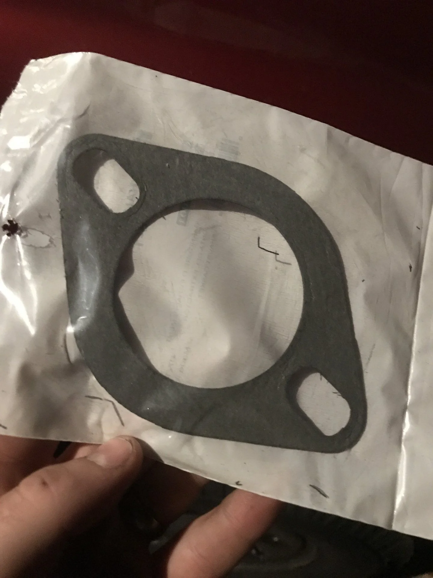

Sure thing. Just got it in the mail yesterday. It’s all stainless, and bolts right up to where the stock manifold would, even uses the same OEM gasket (That ACC even supplied!). It does however ditch the Toyota donut gaskets for the down pipe and instead uses a universal gasket like these. Apparently you can get these at any auto parts store.
View attachment 2471484The only thing I had to do for fitment was remove the bracket for a brake line under the passenger side wheel well. So far it doesn’t seem to effect it any. ACC did the same.
As for numbers/dyno, I don’t/won’t have any of that info. Sorry. ACC claims it gains 17HP, I’ll go with that. This is my wife’s daily, so it was more about making it more reliable and getting rid of rust.

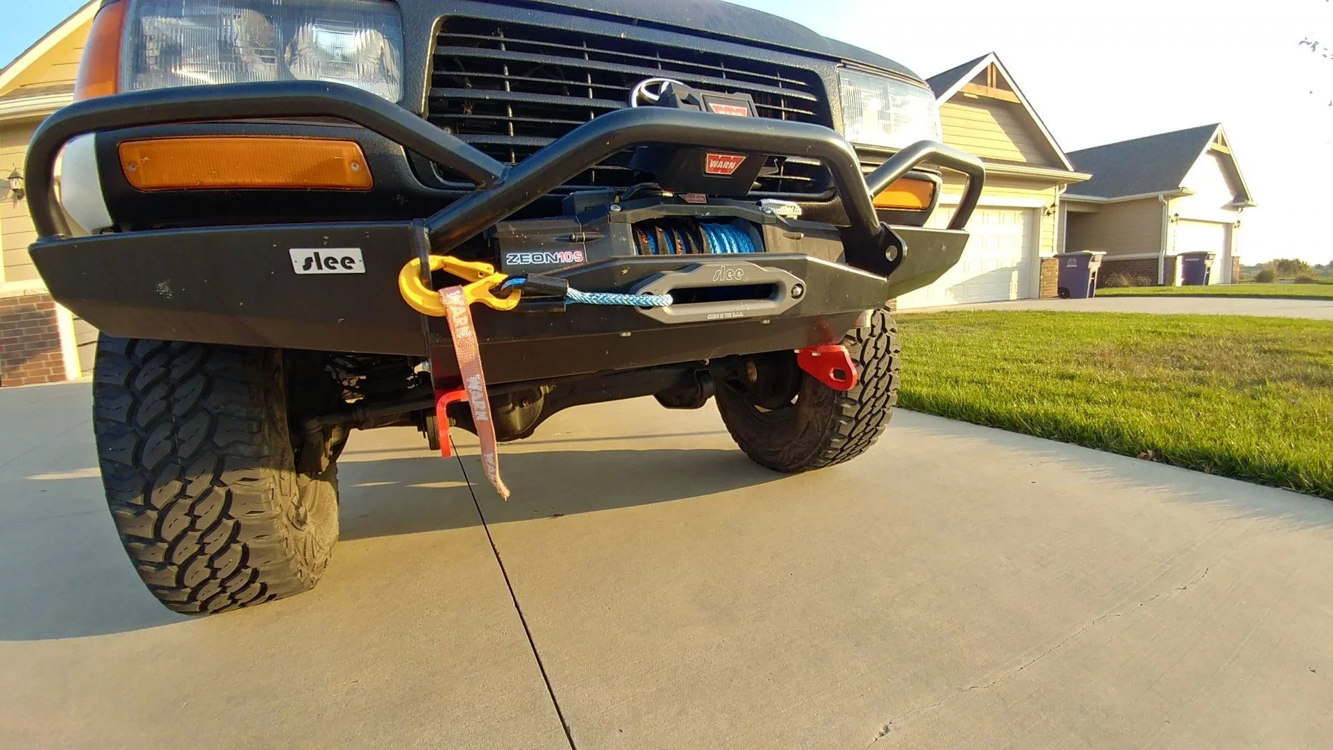

About two weeks ago, had some training in the desert, and the unit decided to give us two weeks of quarantine when we returned. So I ordered some things and had some other stuff in the garage that i wanted to do/install. Ironman had a sale going on for their recovery points so I got them

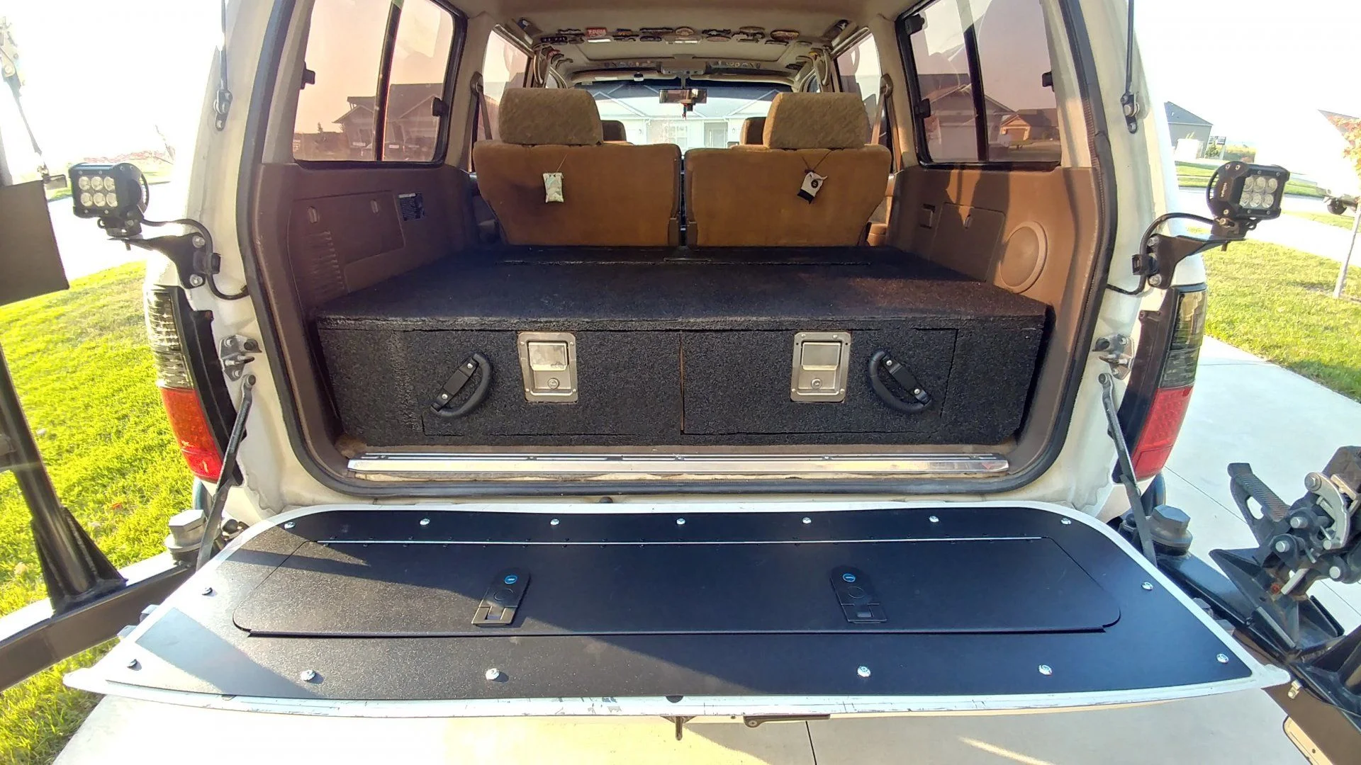

Ive been eyeing this tailgate storage from Huracan Fabrication for months

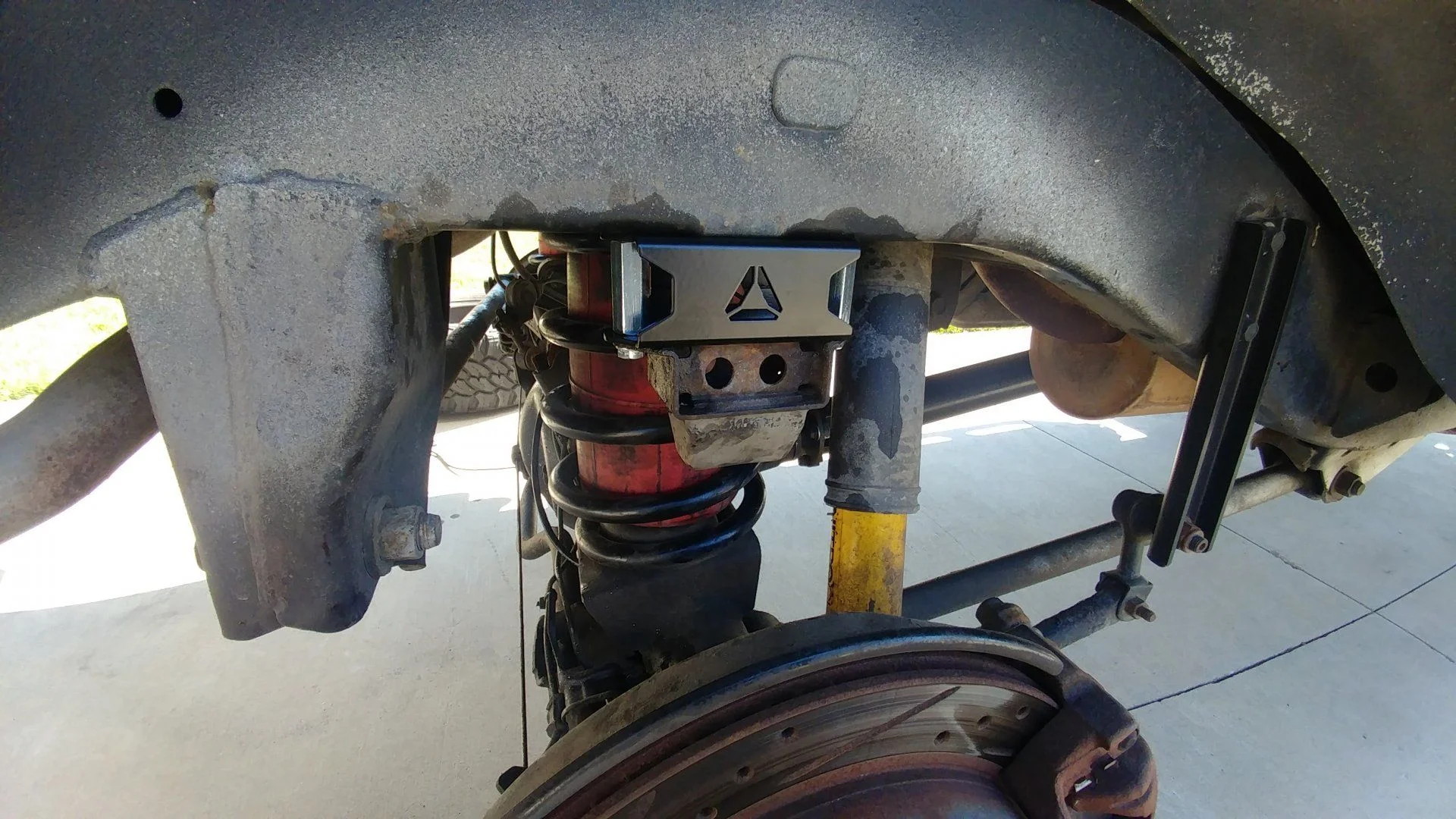

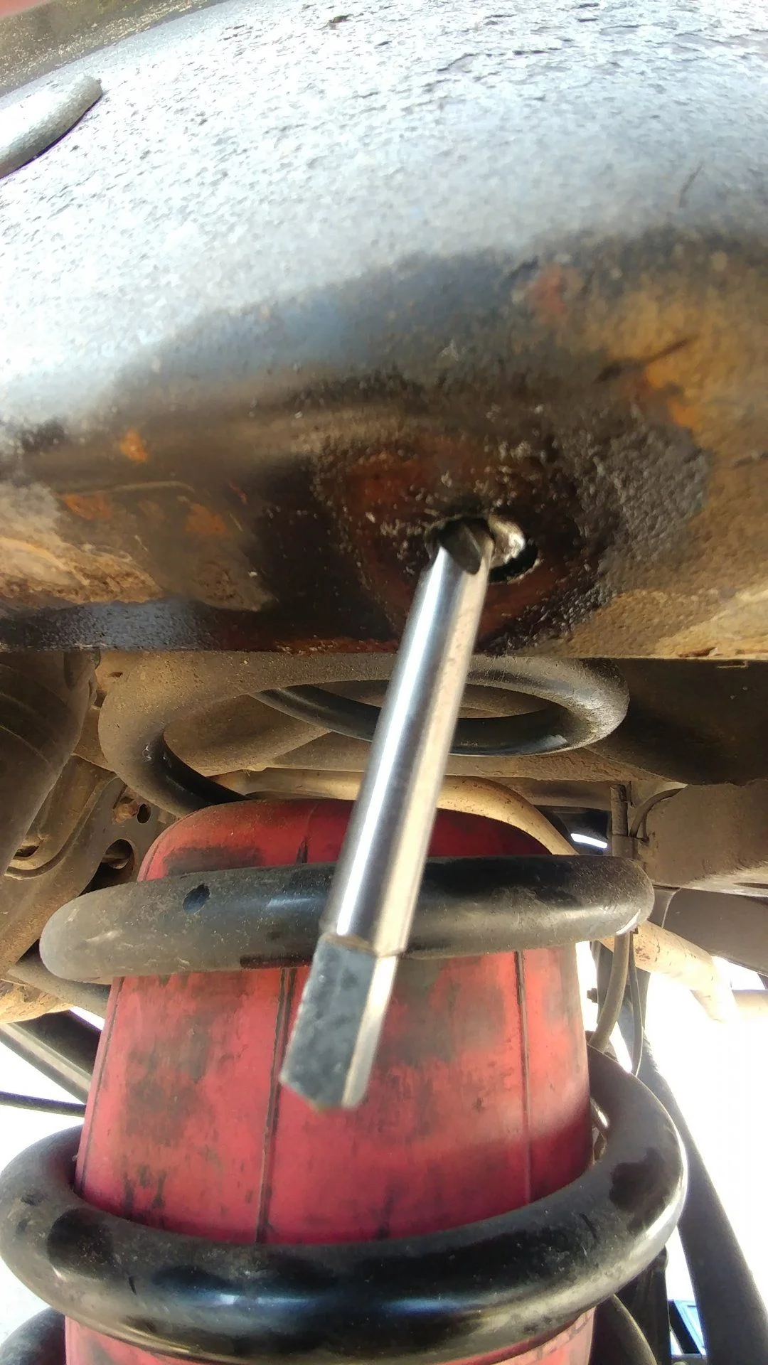

Also picked up a few things from DeltaVS. Broke one of the old drop bracket bolts in the frame, so that too a lot longer than it should :bang:

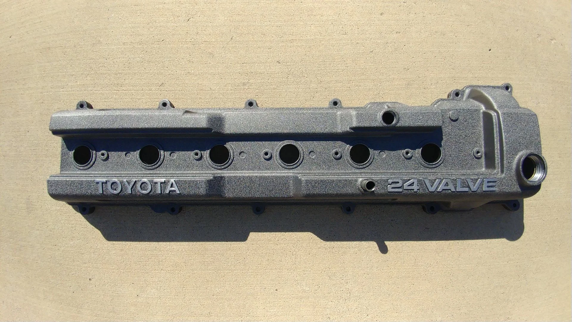

I was looking for a valve cover to paint. Ended up buying two from two different MUD members. One of them wasn't in the best shape, so I focused on the other. Wanted to paint one wrinkle black and the other gun metal. Since I couldn't decide, I just did the under coats wrinkle and top coats gun metal.

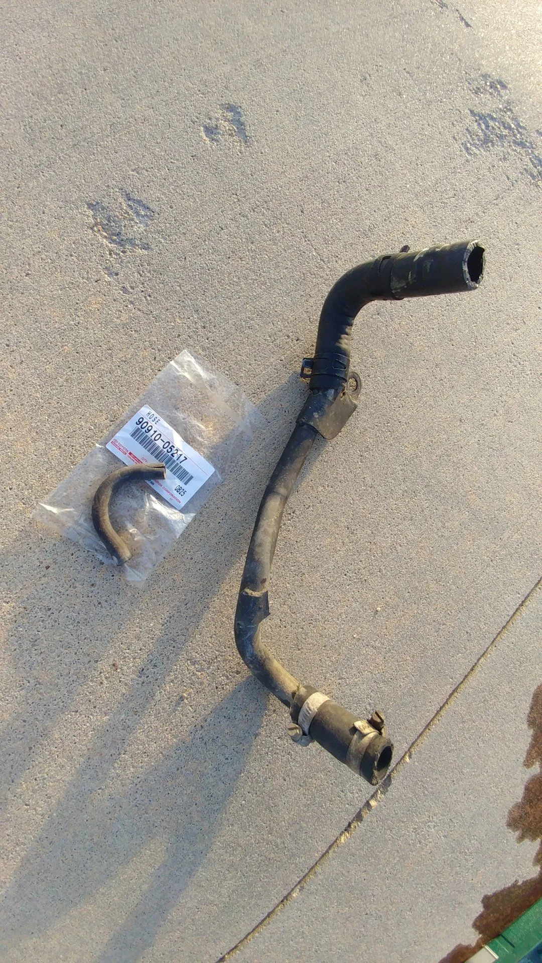

With the knock sensor being unplugged, something happened with the PHH. . it started to leak. I wanted to change this anyway, so month ago I bought one from Wit's End. Ended up just bypassing the system.
The little hose is a vacuum from under the manifold. Saw it was cracked and hard while replacing the spark plugs.

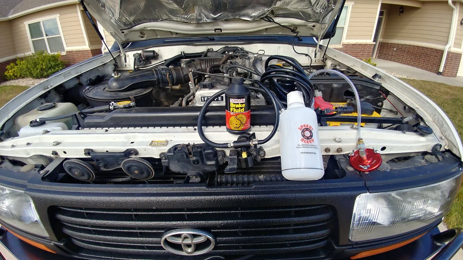

Changed the brake and used the Speedy Bleed for the first time. Super easy.

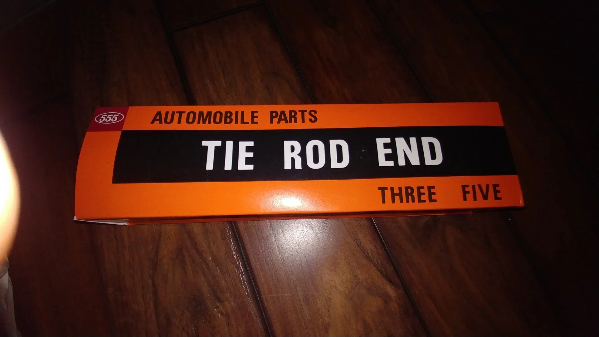

Did some driving to ensure the breaks were good, and started to hear some "clunking" when I turn. Got home, inspected and the boots on the tie rods ends have holes. Ordered the Three Five tie rods from Cruiser Outfitters, and waiting for tie rod/drag link from Slee (Tried just replacing them but they are so old and I don't have all the proper tools to break loose the ends from the sleeves. Pro tip: cheaper to buy all new stuff than take it to a shop)

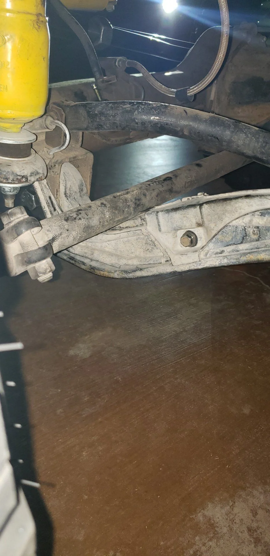

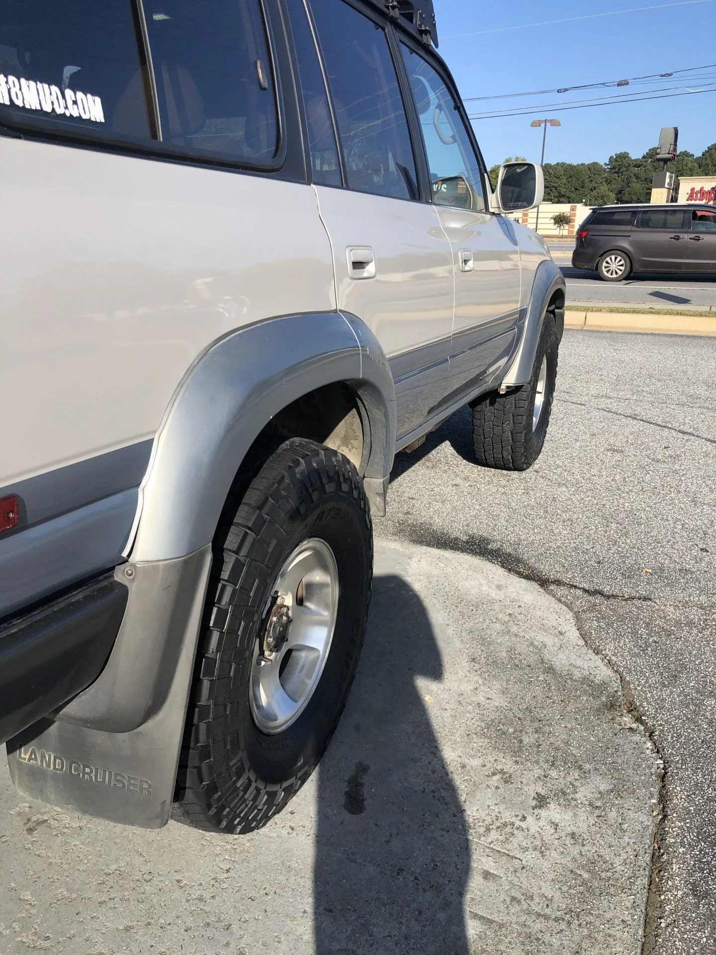

Finished my lift. But after I installed the caster plates I know have the steering arm touching the radius arms. It drives great though. However I have an occasional driveshaft vibe on deceleration (could be the steering arms(. Exploring options to remove some of the caster. Thinking I'll trade a perfect caster for better driveshaft angle and no rub. Also looking at Manafre drop brackets for the radius arms or aftermarket arms. May just remove the plates for now. The journey continues.
The arms can be ground slightly for some clearance. You also need to adjust the rotation of your tie rod clamps. They will hit the arms at full turn. Note your driver side....
Also, your diff breather is disconnected fyi...
