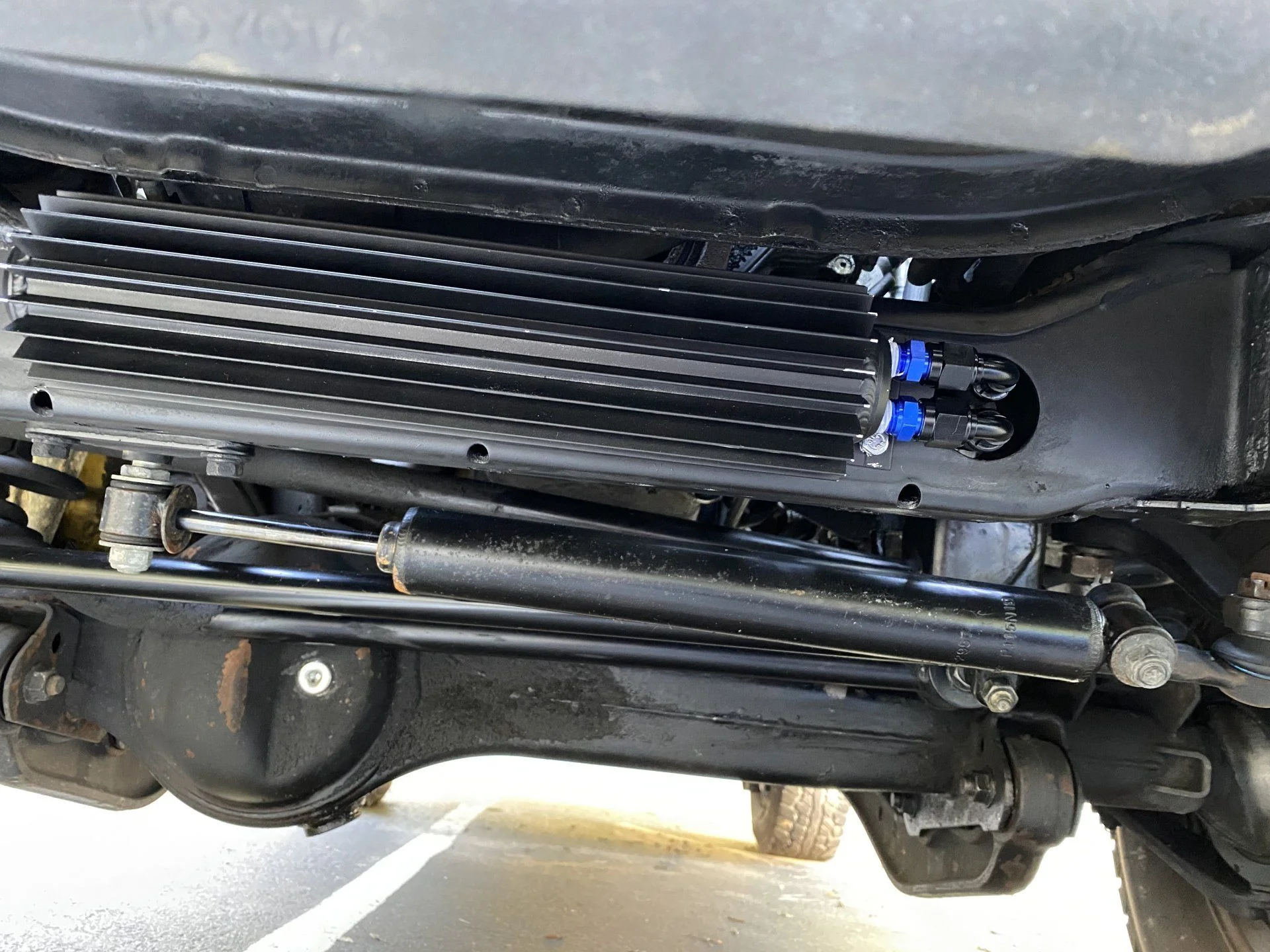

Nicely done! What mounting plate did you use?
I used a universal one from harbor freight. If I hadn't already trimmed the whole thing, I probably would have taken it back and found a different one with less mounting holes in it. When it came time to drill the new holes, I was cutting it pretty close to the pre-drilled ones. Besides that, everything worked out pretty well.

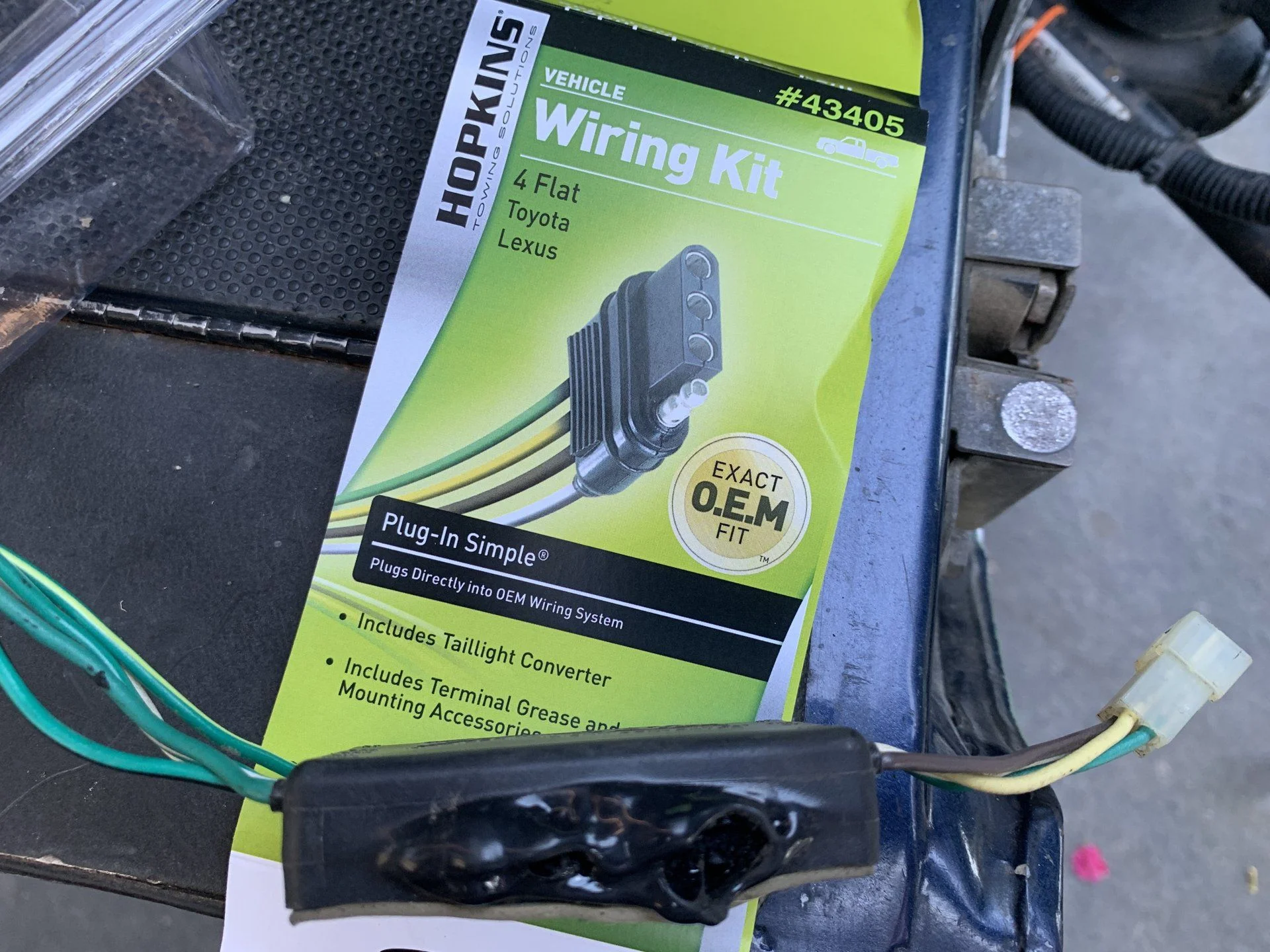

Pretty boring stuff but had to be done ASAP as I’m trailering either dirt bikes or jet skis every weekend. Thankfully this short ended here & not with my rig in flames or me having to pull the pin on Joey’s Wits End FEM
View attachment 2446386View attachment 2446387
I just purchased that same hopkins 43405 trailer harness for my rig. Is your shorted/melted part an OEM toyota part or a hopkins part?
The melted part is the original OEM converter. Worked fine for 24 years until last weekend.
