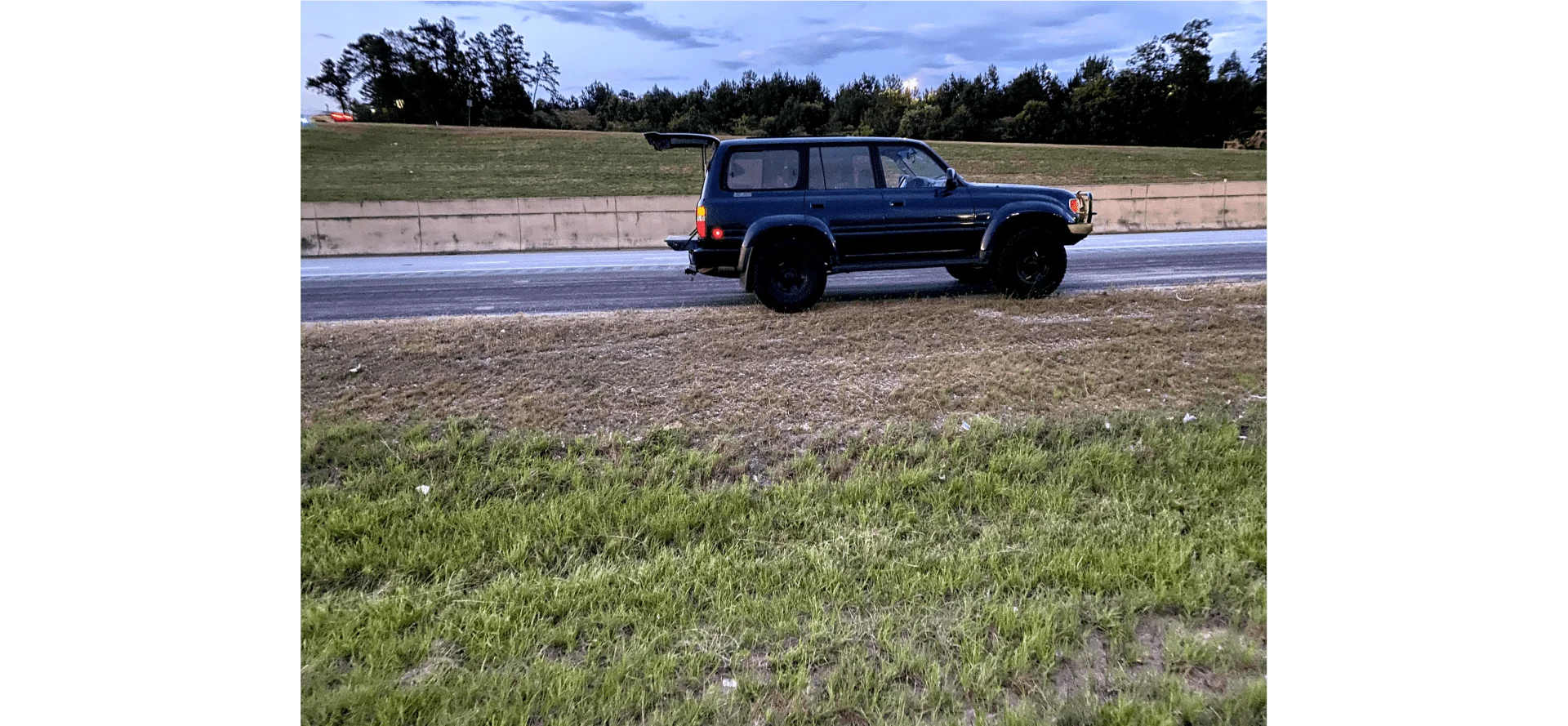

Got stranded on the side of the highway on the way to work :bang:
Got a flat and like an idiot I have never checked to see if the truck came with the bar used to lower the spare tire.
Surprise, it did not! Thankfully TDOT showed up and rigged up something to get the spare out.
Does anyone know where I can buy a bar to lower the spare?

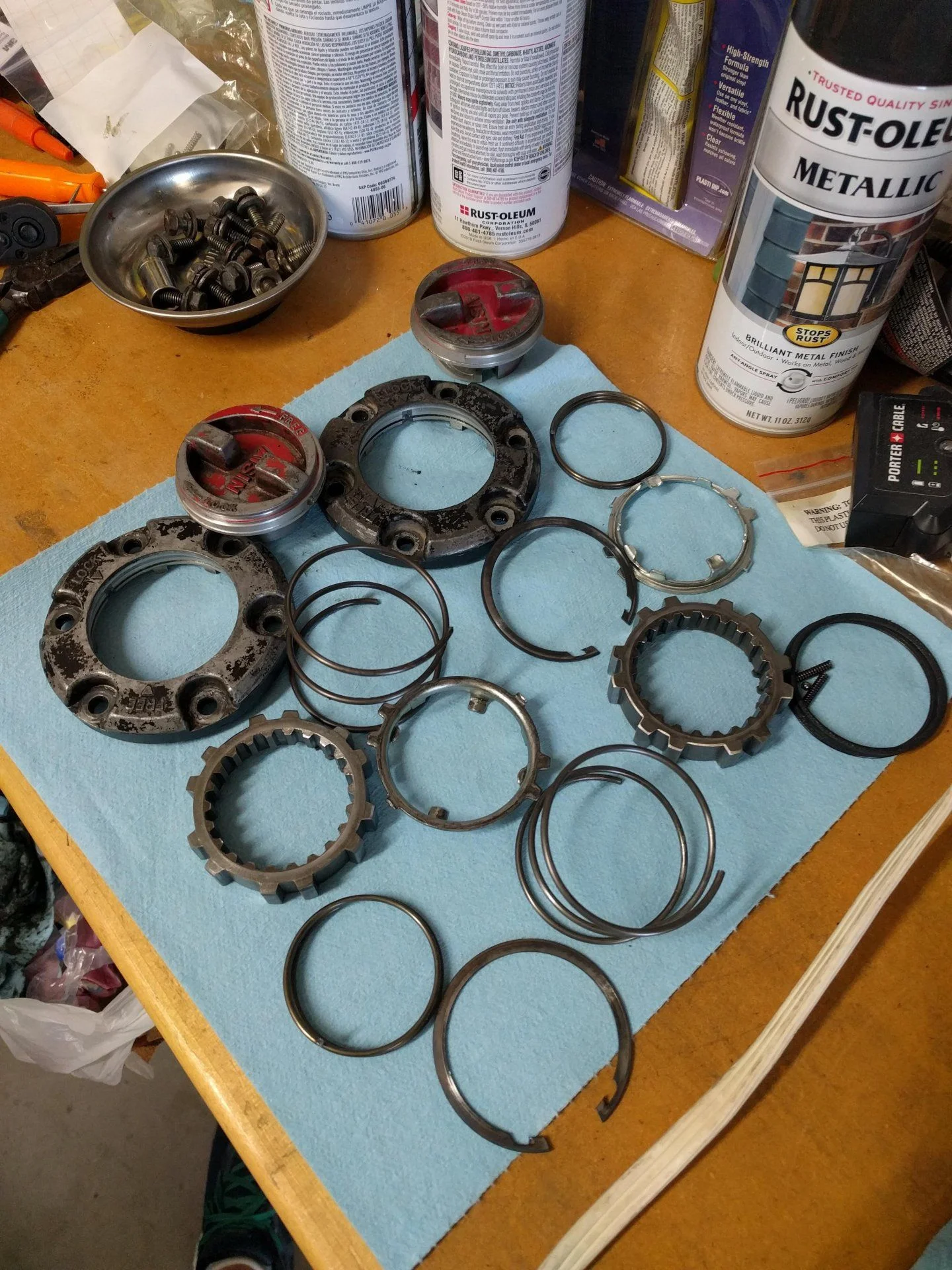

Getting hot here so I am just working on small simple things.
First was replacing the firewall steering shaft seal (from Wit's End). Very satisfying to replace.

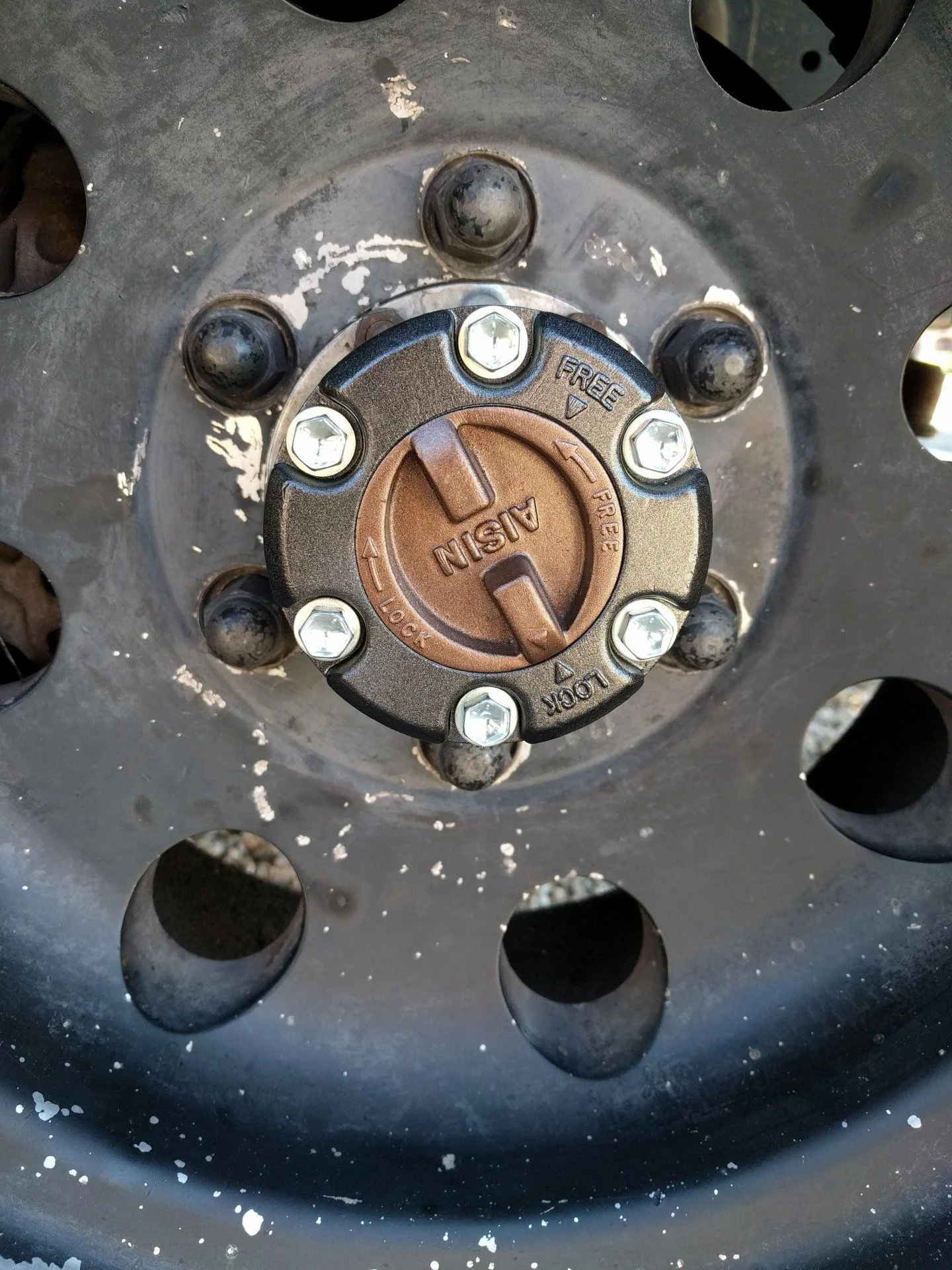

Next, previous owner had installed manual locking hubs. Surface finish on the hub face was leaving much to be desired, so I took them off to clean them up and repaint them. Painted with metallic black night metallic and dark copper metallic Rust-Oleum cans. Replaced detent springs and little ball bearing along with new hub dial gaskets, and hub gaskets from Cruiser Outfitters.
I saw that the axles were missing snap rings on both ends - I suppose PO took them off and for whatever reason did not put them back on. Hub cavity was also overly stuffed with grease. Took out all the old grease and re-greased everything. Ordered snap rings from toyota along with new bolts.
When things cool down this fall I will clean up the hub body when I put in new axle seals.
Now that my hubs have been repainted the wheel paint is definitely looking pretty crappy. How involved would it be to strip the paint and leave them with just metal surface finish? Or would it be better to just repaint them black?

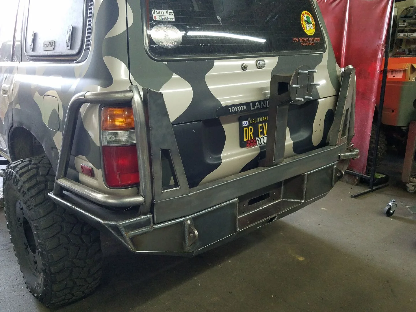

It might be time to get rid of the 100lb tire carrier (40+ HP); then, secure the tire in the back (20+ HP); or obtain a new bumper that holds the tire (30+ HP). . Either way, you'll gain at least 60 HP! Wahooooeeeee! let it fly!
