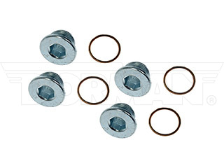

I live no where near Oregon. Would you be kind enough to post the part number and source?For all my 3fe loving brothers and sisters out there.... got me an exhaust plug!! Not that kind you dirty minded fools!!!
Now that I think about it... I have 4 spare plugs if anyone in the Portland Oregon area is doing a desmog...
Absolutly!I live no where near Oregon. Would you be kind enough to post the part number and source?
Thanks!Absolutly!
090-099 Dorman oil drain plug
I purchased mine on Amazon...![]()
Dorman Products - Aftermarket Auto Parts & OE Solutions - 090-099
Oil Drain Plug Standard M26-1.50, Head Size 14Mmwww.dormanproducts.com
Amazon product ASIN B001SG8YJ4
