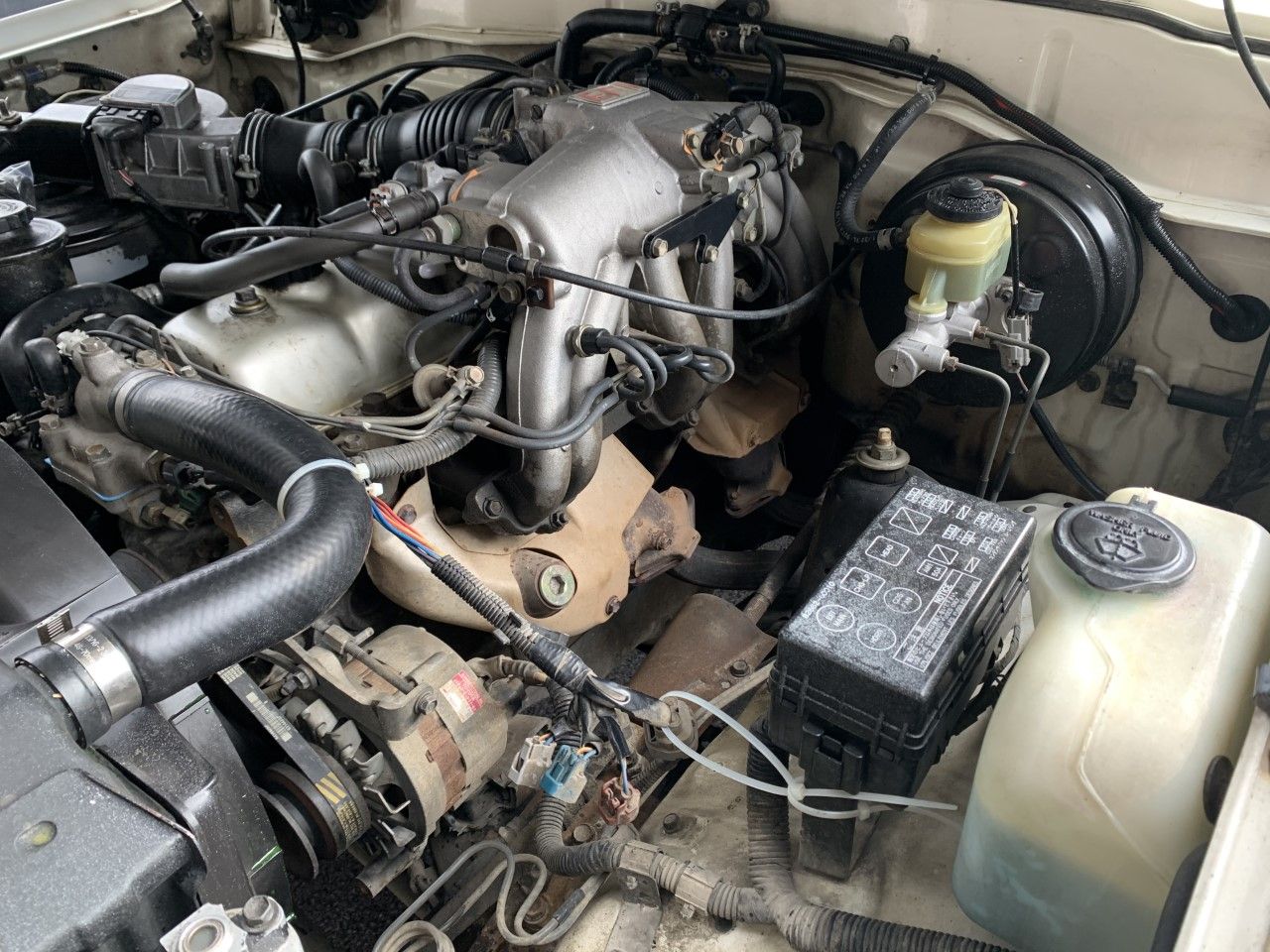

Greased U joints, finished desmog, and took the tint of the front windows. Will remove from the windows and hatch when the Golf get back from the body shop. Until then the Cruiser is gonna be the DD.
When doing the desmog I removed the IAC and throttle body warming system. It gets pretty cold here in the winter so I kept all the parts, if it starts freezing up I throw the system back on.

Also found a nice surprise, the PO or a shop over tightened the power steering pump and broke a mounting ear off :(

Not sure if it's worth it to you but I have seen where guys get tabs like that welded back on... what year? She looks a lot like my 91 and I DD that girl!!
Its a 92 so basically the same truck! Now that its back together I will probably drive it once a week to work just to keep it exercised.
The pump seams to be on its last legs, making noise and stiff steering. I'm planning on replacing the pump and rebuilding my spare steering box for a full power steering overhaul.
