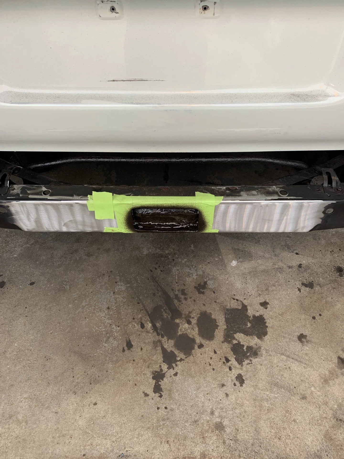

No, it caused full blown rust. I hacked it out and am toying with making a foot step in its place.
Just realize that it is actually one of your crossmembers and needs to carry load between the frame rails......

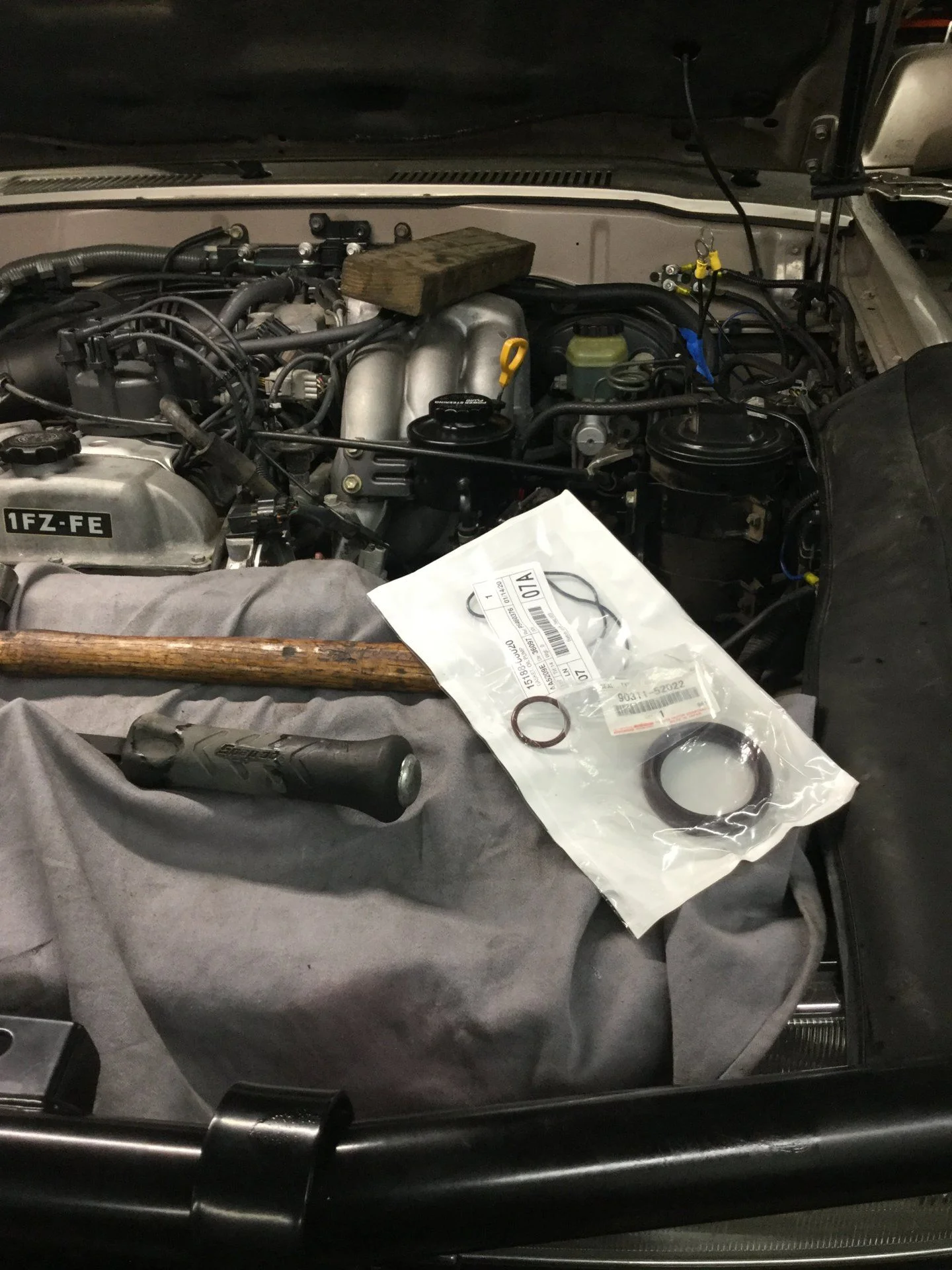

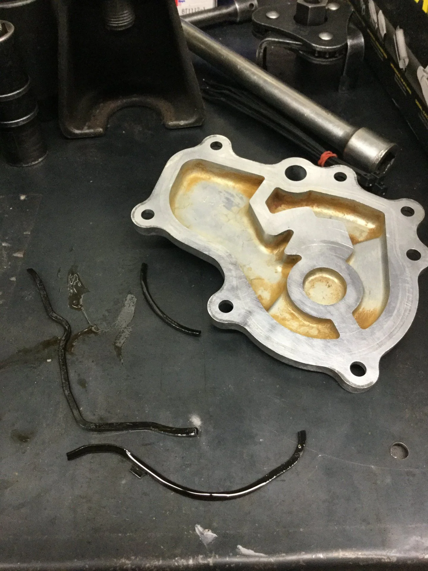

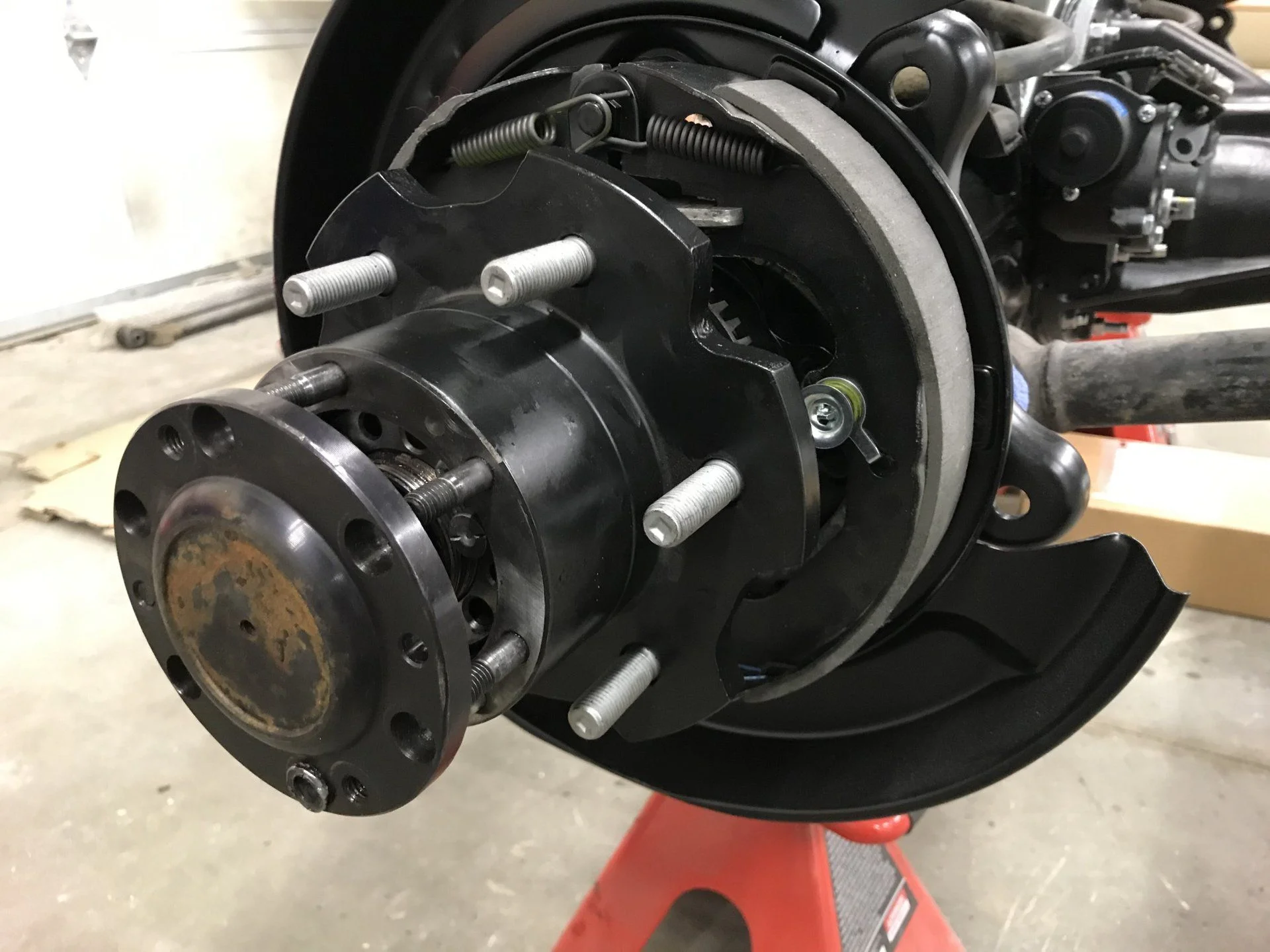

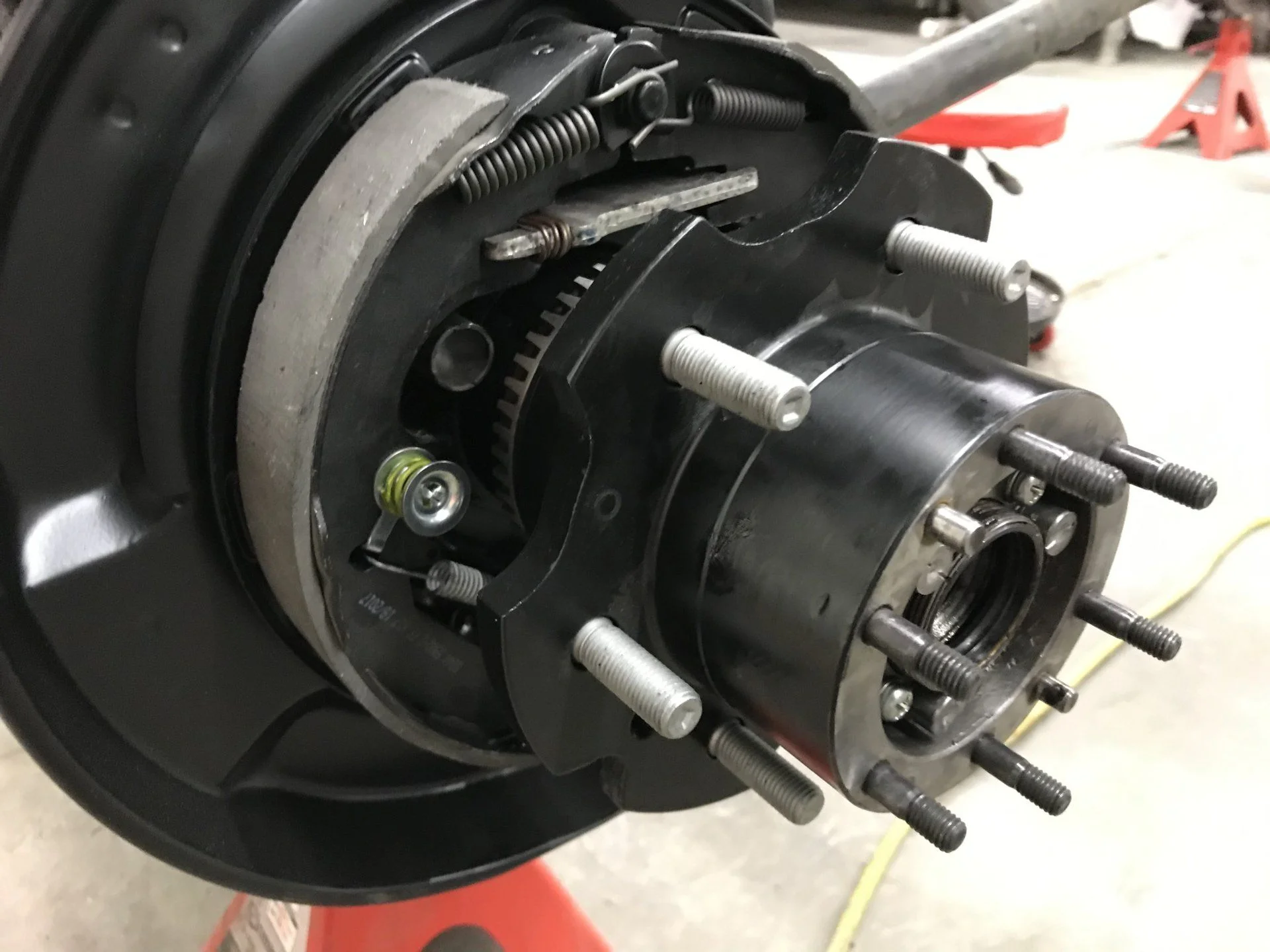

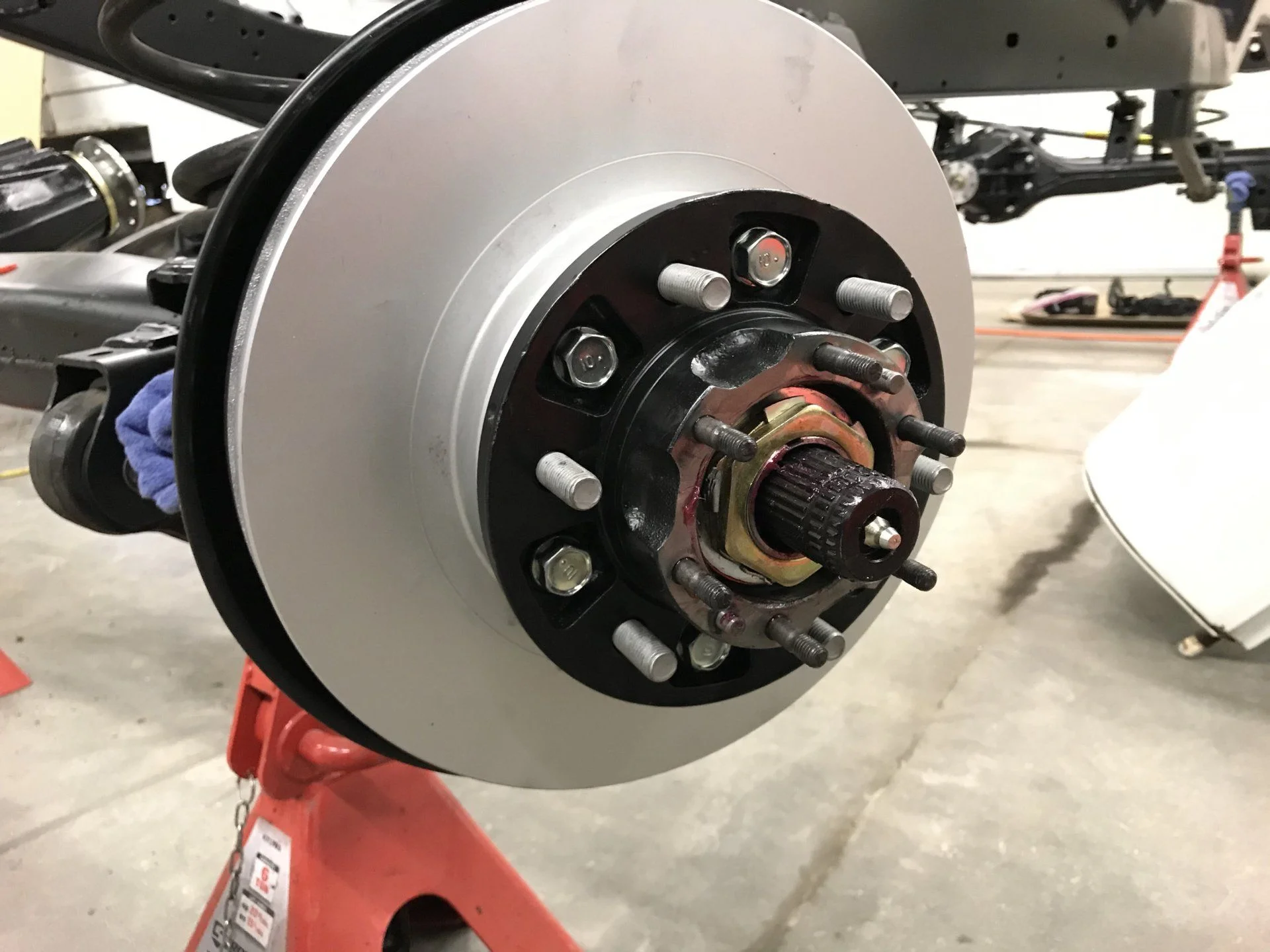

Did some much needed re sealing,,,,,

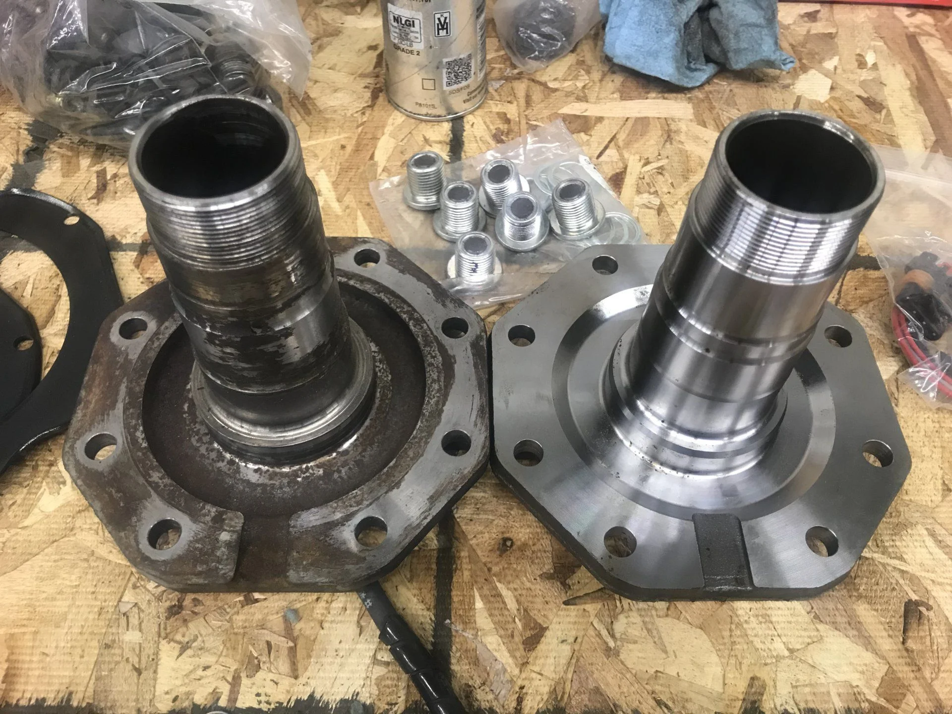

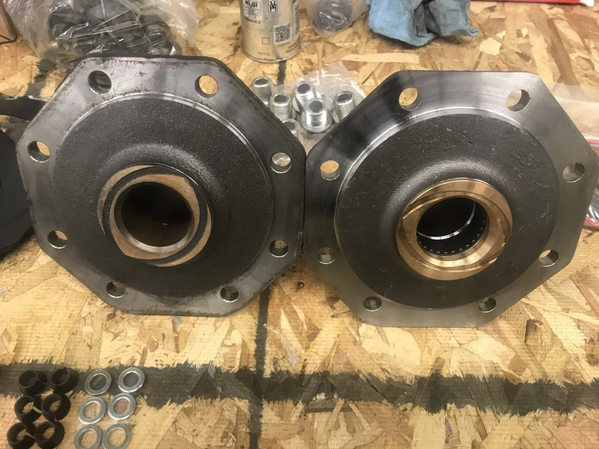

The 105 spindles swap right over to an 80? Any mods required? I like the needle bearings vs the brass bush.
Spindles are the same and are interchangeable. If your 80 spindles are in good shape still, you can just buy the 105 series combo bushing (half brass half needle bearings) to install into your 80 spindle. Lots cheaper than buying the whole spindle assy. I'm certain @cruiseroutfit can get you the bushing/bearing.
