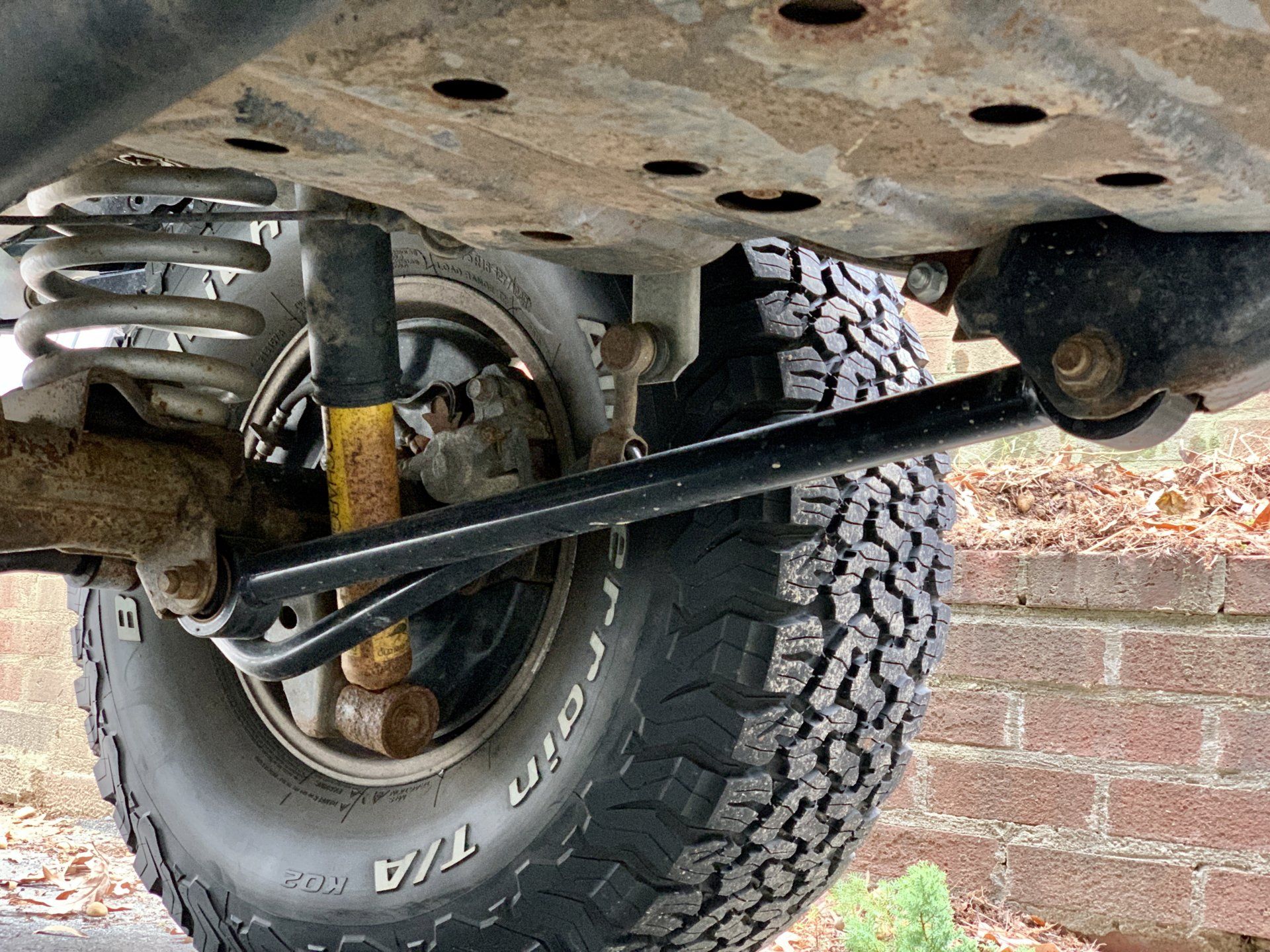

Replaced the hatch and hood struts today as the cold weather made my 4 yr. old ones start to sag. I used these from Amazon. The price was right but the locating tab on the hood struts needed to be rebent to fit. Not a deal killer, but just be aware. Rears were straight bolt in.

I chose to use the McMaster Carr conversion on hatch struts to get the hatch up and out of my way, even at -15°F.

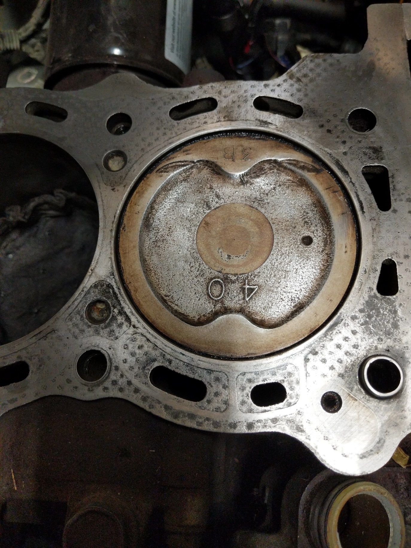

I havent posted in a while, even though I've done a lot over a lot of weekends on my FZJ80! Sadly, I'm in the middle of a head gasket replacement, and while cleaning the block came across this very disappointing etching. I dont really have the option of pulling the block to get it decked, as I"m doing the work in my friends garage and its basically time to get it out of there. I could try and get it towed out, but now that its in there it would be pretty tough. Anyone want to tell me what I want to hear and say it's fine to throw the new gasket in there and cross my fingers? Not really sure what else I can do.
And no, I dont have a machinists straight edge or feeler gauges, so I cant tell you how deep that pitting is. Also I'm about 1000 miles away with family for xmas.
I would recommend starting a separate thread for this and preface your subject with "RTH-" for "Real Time Help", since you seem to need a pretty quick response for your situation. Sorry I can't help more. Outside my expertise.

You need to find some way to measure things... Nobody can tell you what to do without knowing how bad it is. If you don't plan on decking the block during a head gasket job, a straight edge and gauges are pretty much a necessity.
The pic makes it look pretty bad, but I realize that isn't concrete evidence. Are the recesses deep enough that you can feel them with your fingernail? I am far from an engine guy, but I believe if they catch your nail, they're bad enough to need machining.
