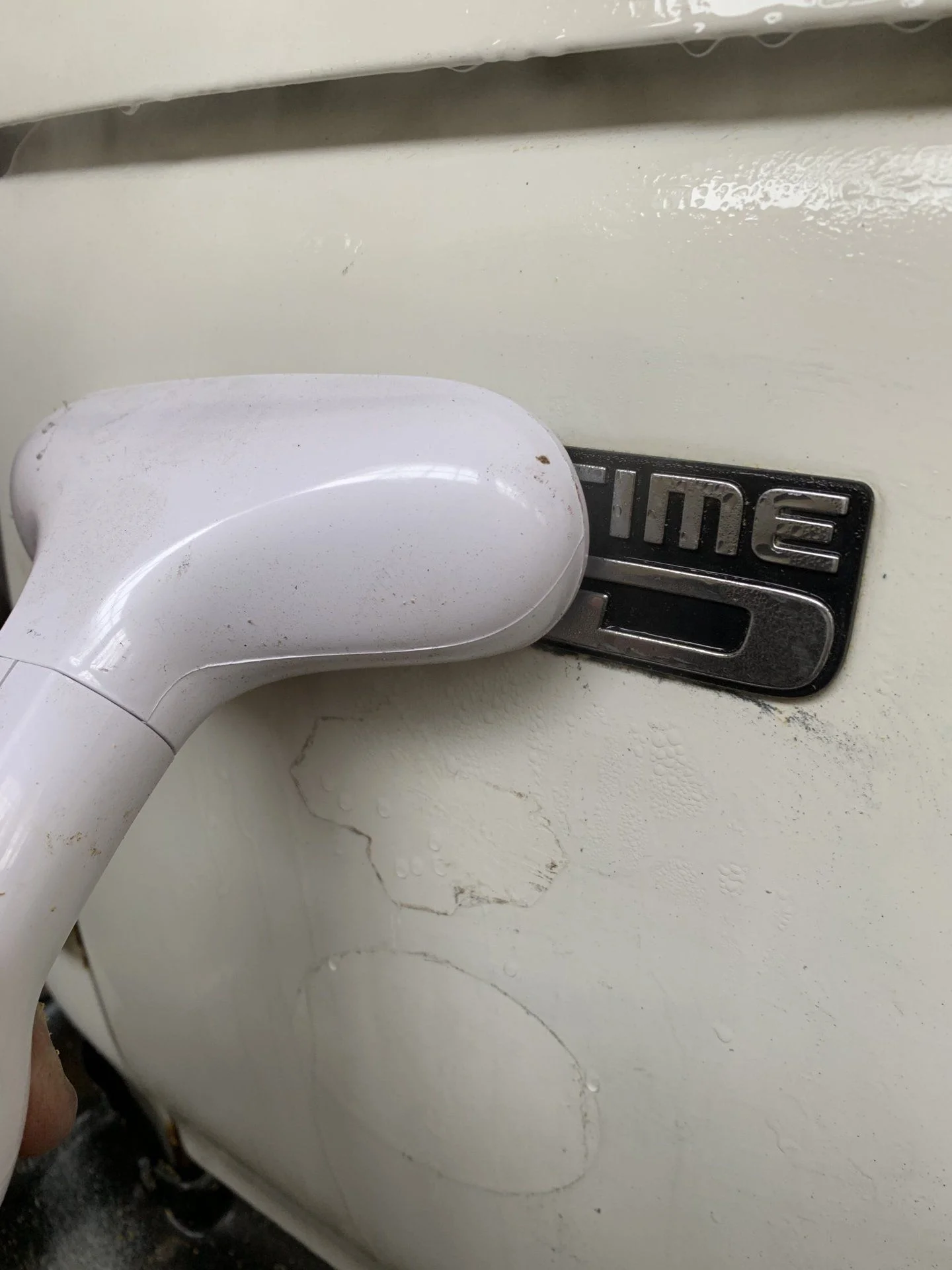

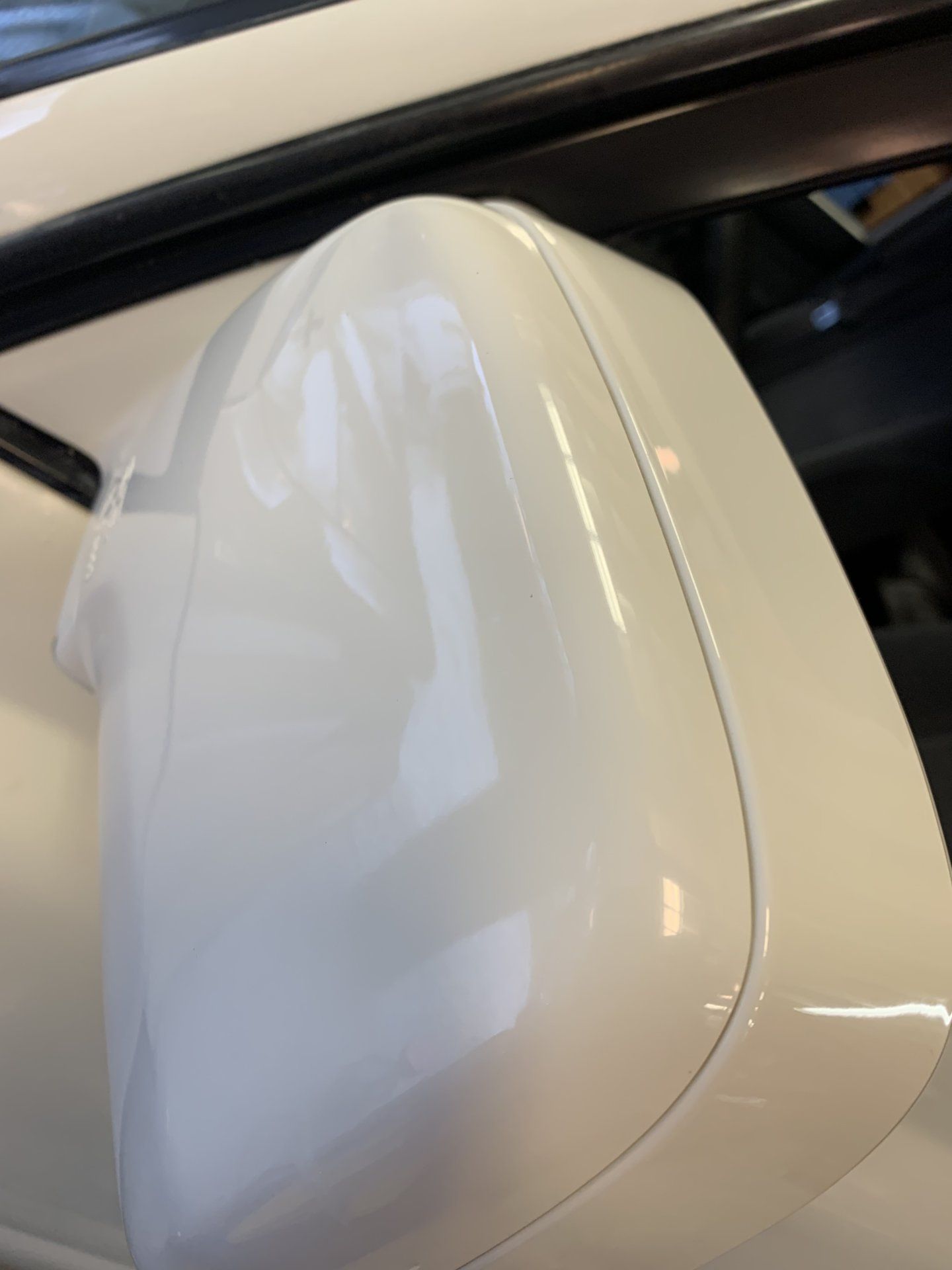

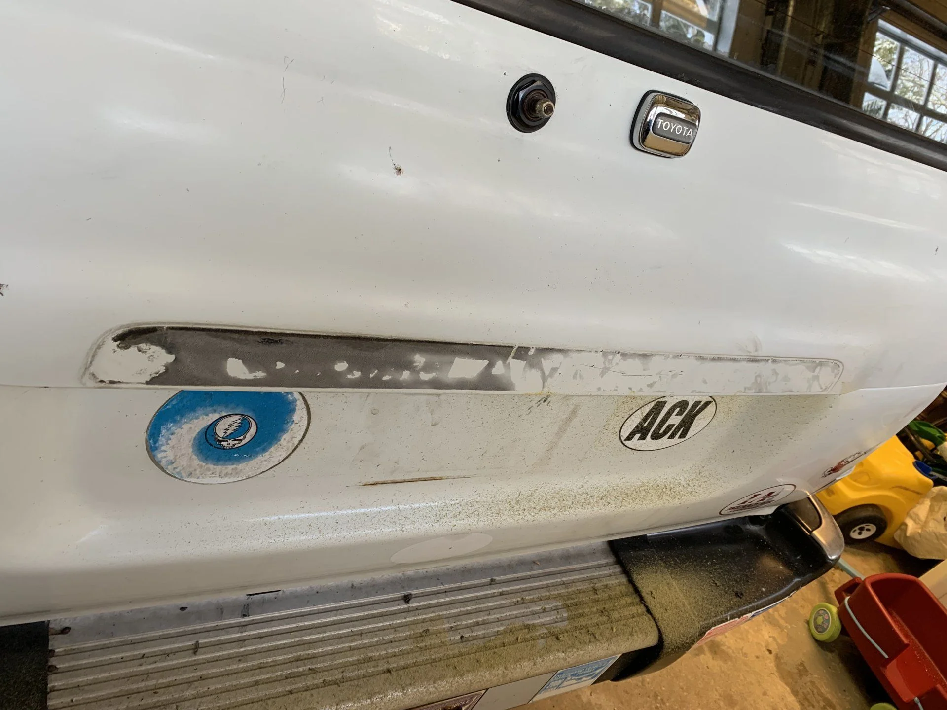

Today’s work.
Goof off
Sticker remover in the drill
Steam iron for clothes.

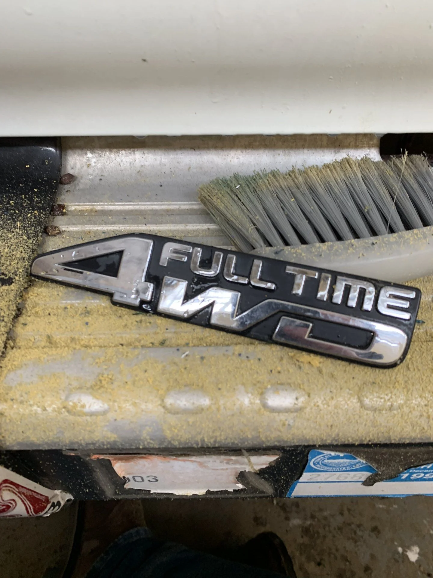

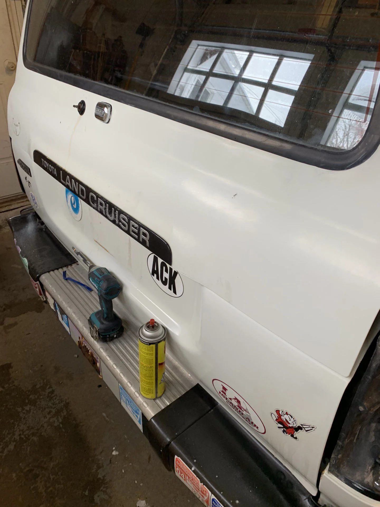

The old Land Cruiser sign came off pretty easily considering what I’ve read. I guess the cold helped to keep the glue brittle. I highly recommend using the steam to remove the stickers and small 4wheel drive decal. It took seconds. I used the beige/brown Sticker remover that can be purchased on Amazon to remove the remaining glue adhesive.
I used goof off And a paint auto body prep spray cleaner to remove the remaining Glue.

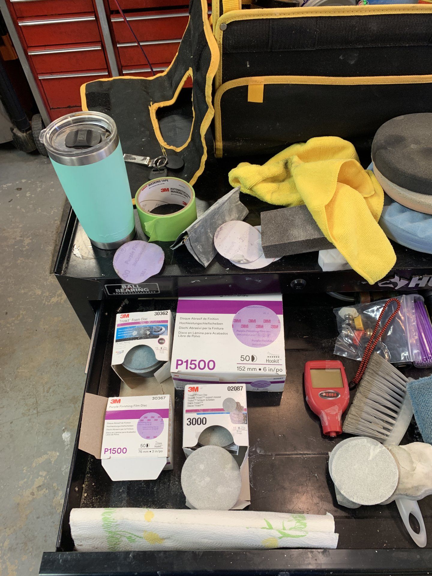

I’m still using the 3M trizact system.
To start the land cruiser emblem, I used a very small screwdriver at the top of the old emblem to Pry it from the panel and spray goof off in behind it. This seemed to help me to get to a point where I was able to use a small prybar running east to west to remove the rest of the emblem. I think if I had just started with the steam it would’ve been much easier and less scratches caused by a pry bar.

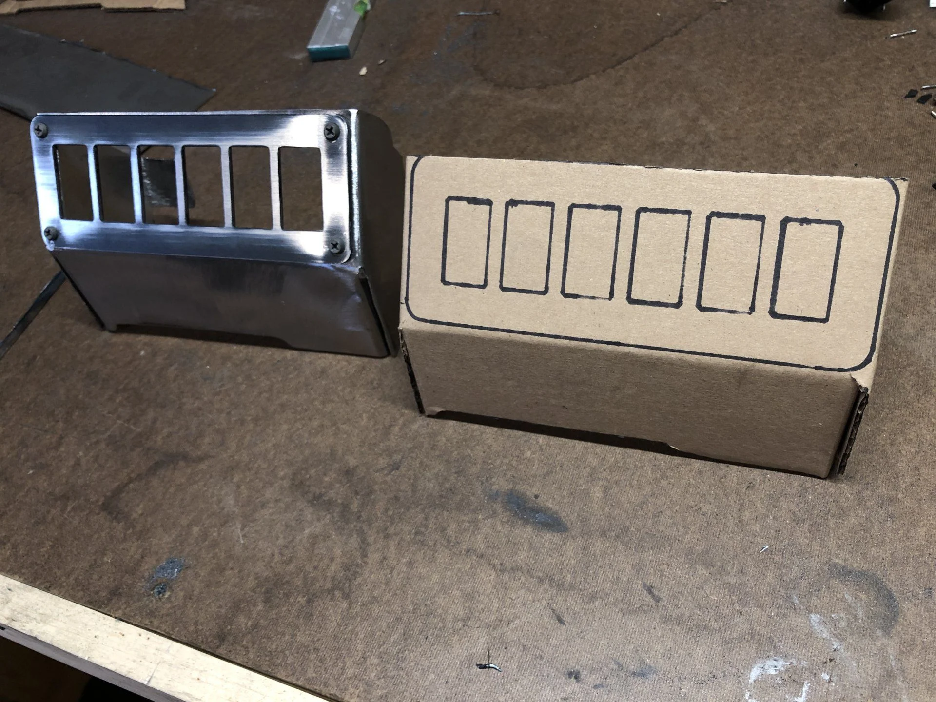

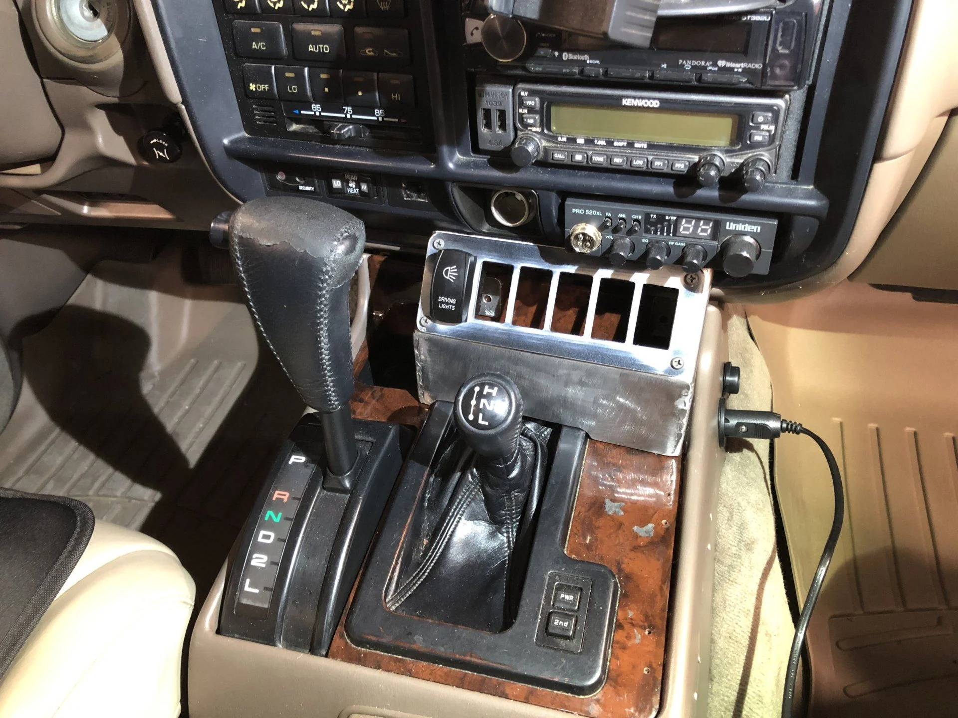

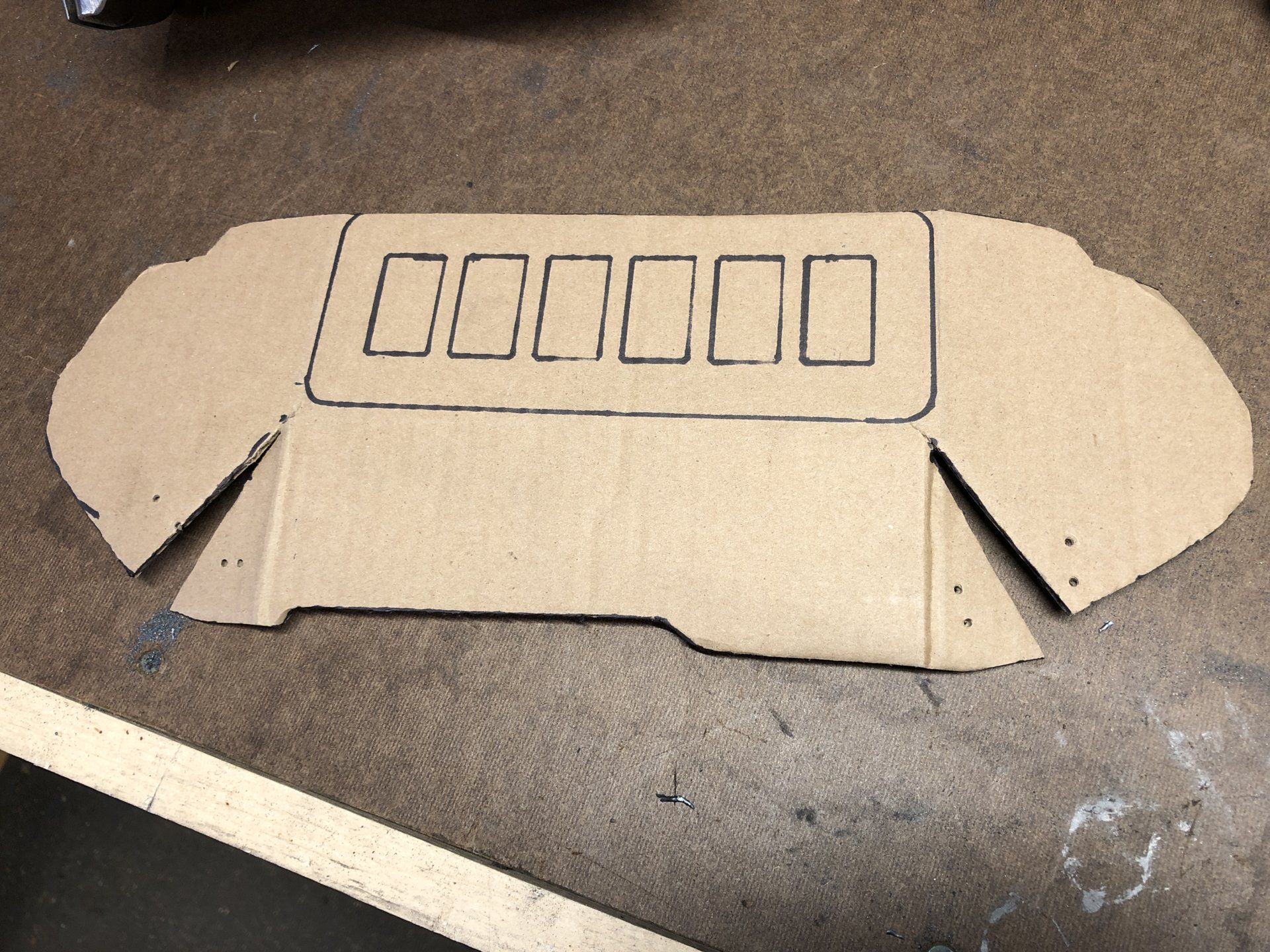

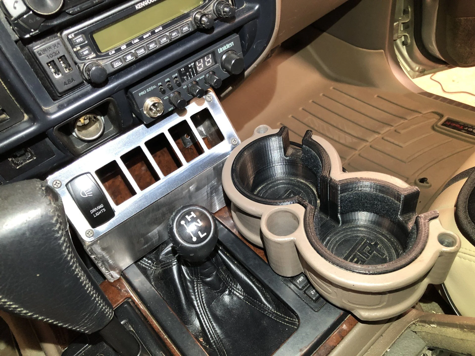

Fabricobbling a carling switch panel for under the dash.

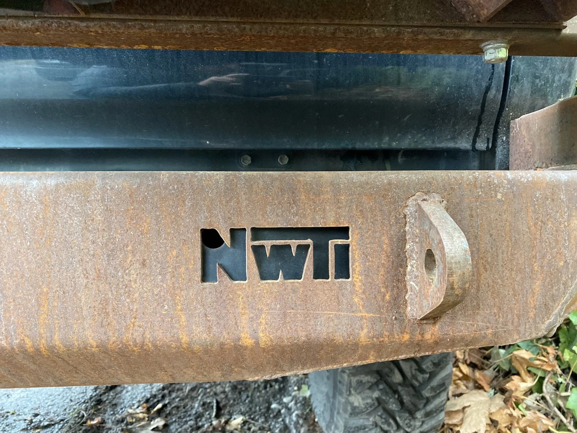

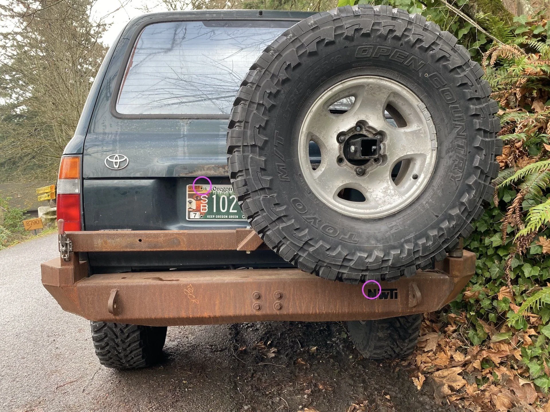

I'm ruminating on the best location for a backup camera, I already have wiring in the lower gate but the location of the swing out 35" tire blocks the easy spot up by the license plate. Two candidates circled. The license plate is easier in terms of routing but doesn't see the passenger corner, which is crucial for safe reversing. The bumper itself is a little tougher to get to, but has a clean line of sight.
Thinking about using the convenient bumper hole behind the NWTI logo if I can find a simple bracket to work:

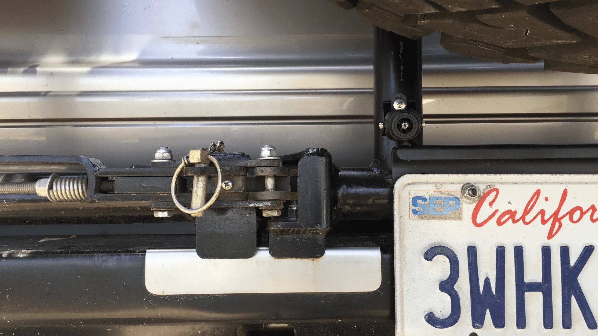

Why not put it put it on the swing out? I simple bracket could be made to hang it there even with the angle. Here’s how I mounted mine to keep it more centered.
I like your install, but on my truck the tire hangs down below the plane of the swing out and projects fairly far back as it’s a 315— eyeballing it, the camera would be blocked if it’s anywhere below the license plate or to the right. I could put the camera on a projection rearward from the swing arm which would be 6-8” long to give it clear view? I guess that’s why I’m leaning toward the lower bumper mount. What do you think about a fairly flush bracket in the lower circled location?

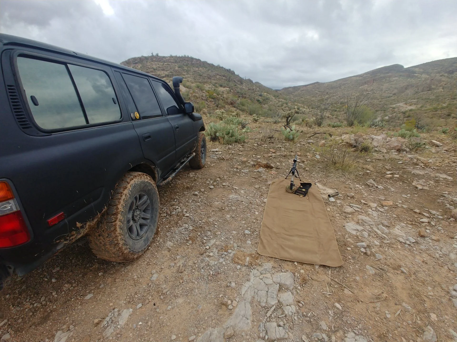

308 or lapua?
definitely not 308 shoulder angle is pretty steep to be 308 hard to tell in picture but looks like 6.5 creedmoor , scope looks same like one i have M5xi 3-15x50 and bullet looks to be hornady hard to tell in picture may be hornady ELD
Looks beefy...don't see these on his website. Must be a secret menu item... :hmm:
I think he did a preliminary run of a handful of links. Actually just got off the phone with him and he's looking at maybe doing another run based on the feedback from those that picked up a set.
Forgot about the 6.5 :)
