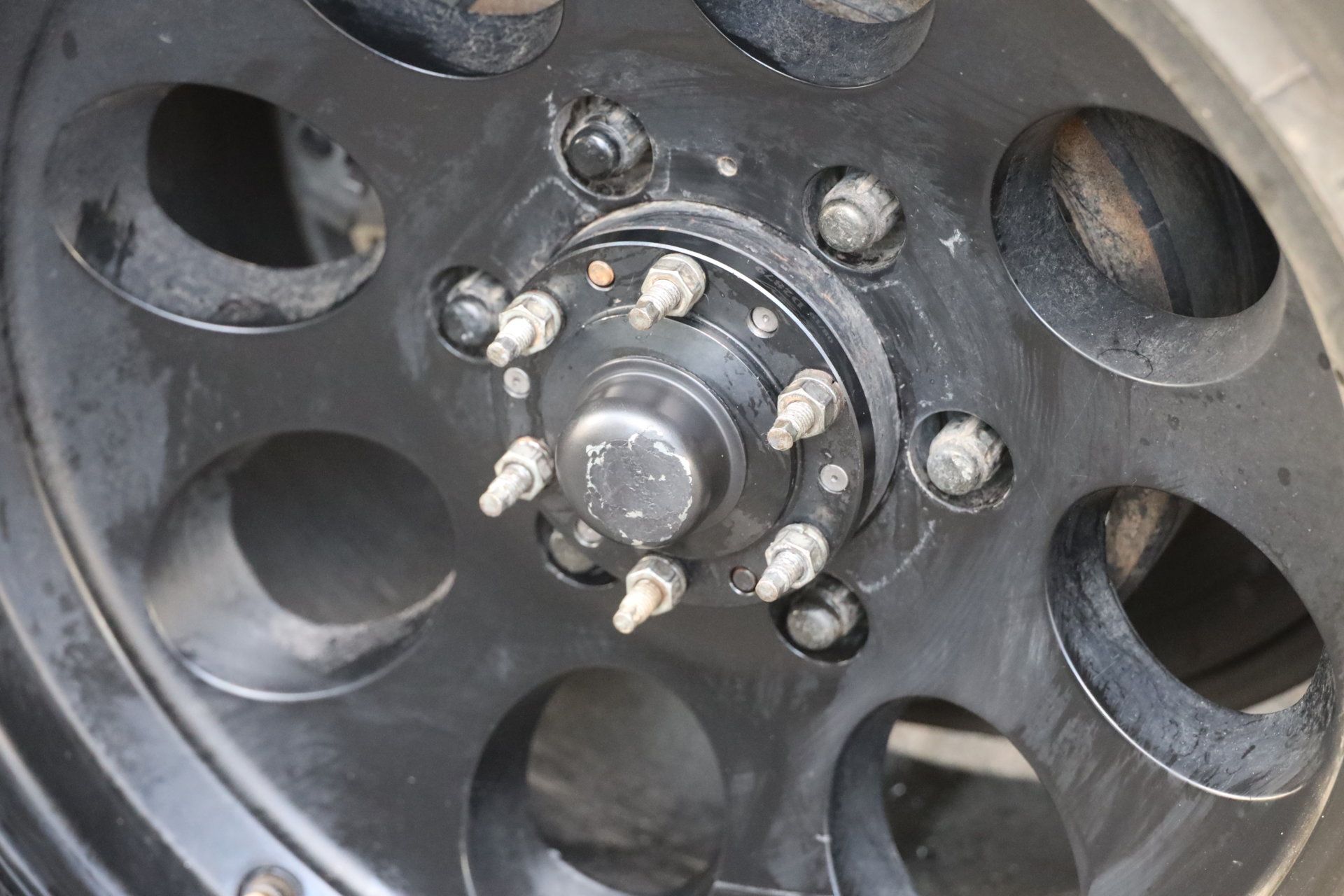

Finally got RCV axles installed all the way round, with Aisin locking hubs, transfer case is totally rebuilt all new bearings races actuator motor, hoping it isnt 20 degrees tomorrow so I can swap out TC and hit the highway. 300M axles are serious for anyone pondering. Just wish RCV would supply the C Clips needed for rears, and maybe make the C Clip slot a little wider. Nothing a file couldnt handle but stilll. Oh and Finally reinstalled NEW Red Winch, BUT it now requires an air toggle for free spool. You boys have sen me jump too quick a lot Well if I could do it over. I would have got the warn 70th anniversary over the RED WINCH. The RED Winch is amazing, its beautiful and stupid strong. BUT it has at least 3 extra points of failure that ANY winch does not. it requires air to operate, has way more wiring. so Im making sure alll the wiring, airlines etc are bullet proof. Not that I ever need to winch but still. View attachment 2132128View attachment 2132129View attachment 2132137
Can you give a little more detail on the rear RCV 's did you add more dowel pins ? if so did you drill them your self/ send them out ? So it's a two peace axle / drive flange do the c clips from the front axle work ? or where did you source them. And lastly are those ARP flange bolts with cone washers ? if you have any more pictures of the install to share would be nice.

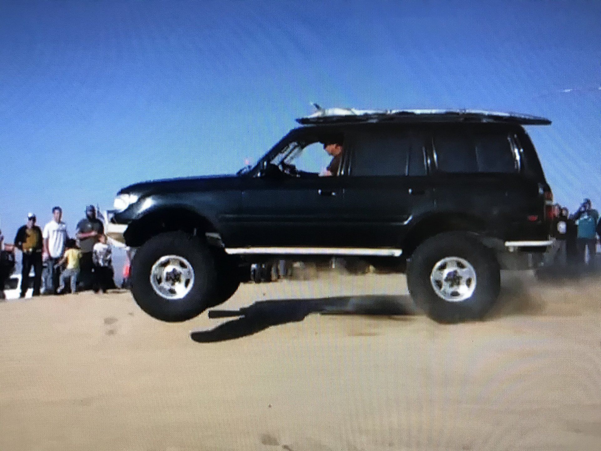

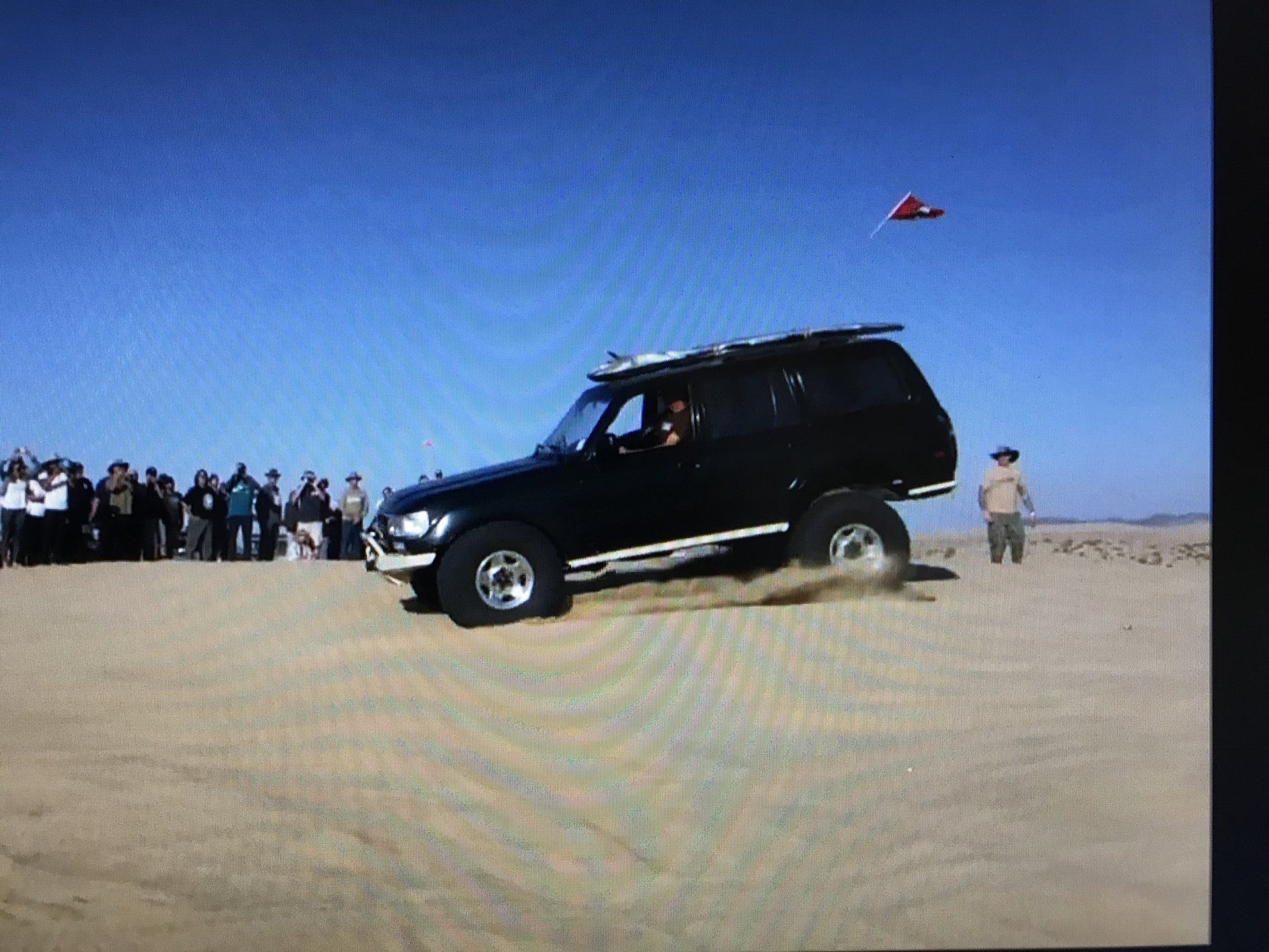

It appears it was a good launching dune this year. How many teeth did you break?
So does anyone agree that its time for @brosky to cange his avatar to his green rig from a pic of a f150?
Gary the landing was so smooth I did not think I even got air. That avatar is a full size E150 Van 4x4 on tons locked full built out Expo Reg that I built my self and I still miss it. I think it stays
Thanks Brosky .I got the axles from ozark overland outfitters, Jason is the owner and had a solid price. I drilled the hubs and installed all the dowel
s RCV supplies. They do not supply birf clips for rear for whatever reason. and yes ARP flanges bolts all around solved my cone washer loosening all the time issue.
