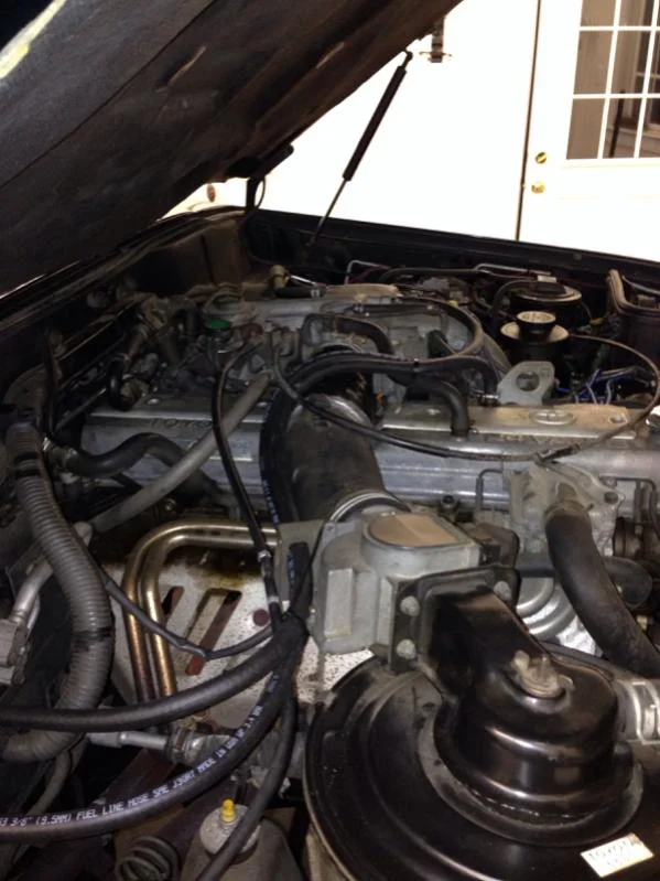

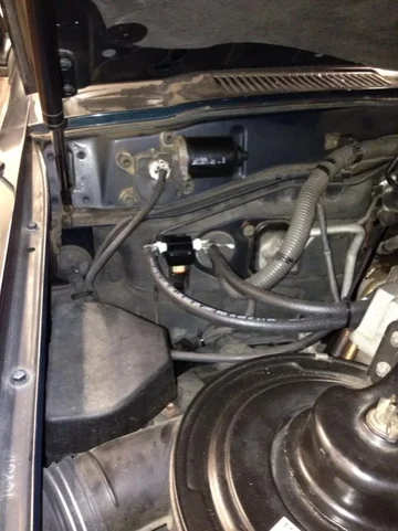

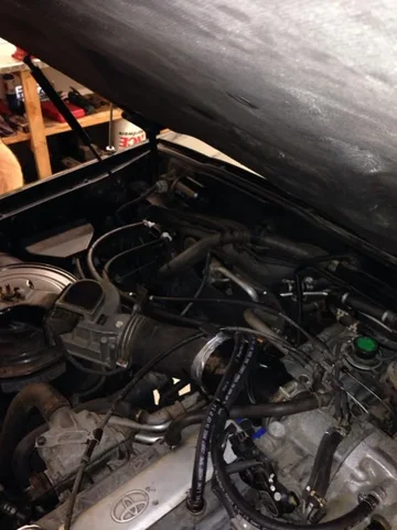

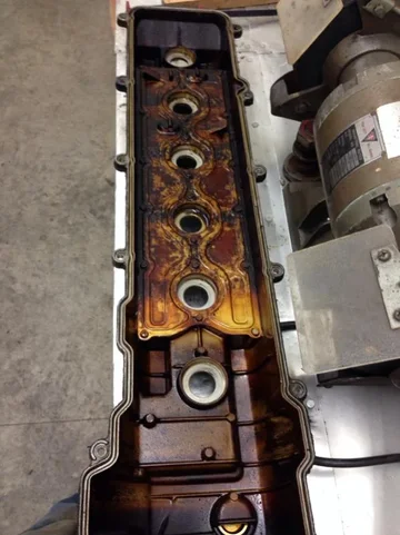

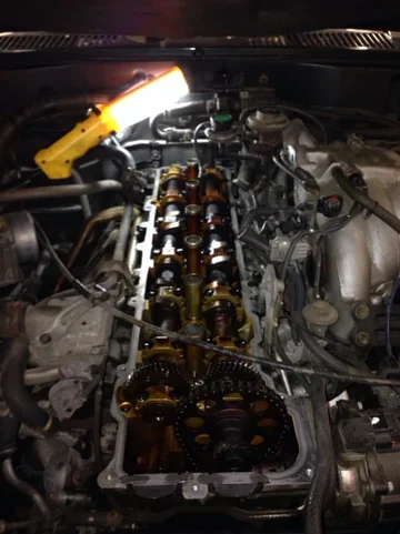

Replaced the valve cover gasket, plugs and plug wires along with a new throttle body gasket. Tomorrow I'm installing a catch can and replacing the front pinion seal.

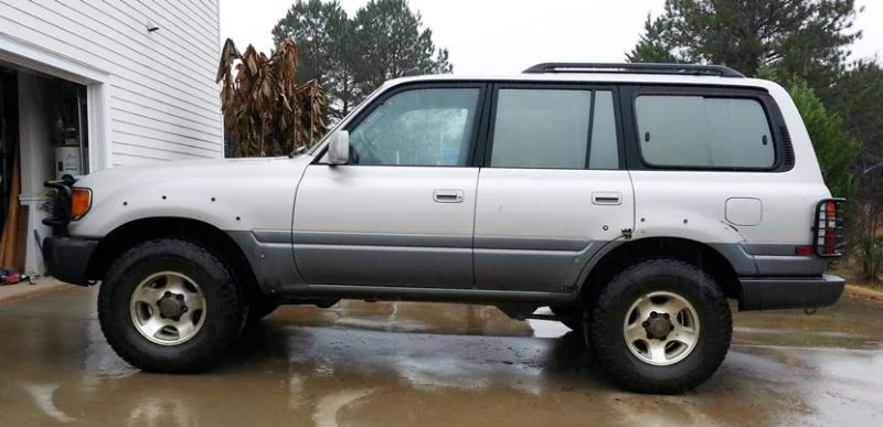

I plugged my flare fastener holes.
I took a step drill bit and drilled out the four small rivet holes on each side to 5/16ths. The other eleven holes on each side were drilled out to 9/16ths. I bought nylon hole plugs from Home Depot, painted and clear-coated them, and inserted them into the holes.
FYI - Dupli-Color Scratch Fix 2in1, NG GM 528 Fine Silver is a pretty close match to the Desert Dune Pearl (1A5). Dupli-Color Scratch Fix 2in1, NG FM 360 Dark Shadow Gray Met. is a little darker than the Moonglow Pearl (1A6), but you have to be up close, and really looking, to notice it.

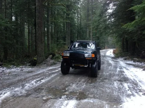

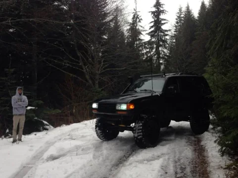

Explored tinkham road today
Tinkham is fun for a snow day. There are a few trails that shoot off from the main road that I haven't explored yet, and they seem to get less snow under the bigger trees- more passable in the depths of winter.
I'm bummed we haven't hardly had any snow this year- it's a big part of why I moved up to the mountains lol.
