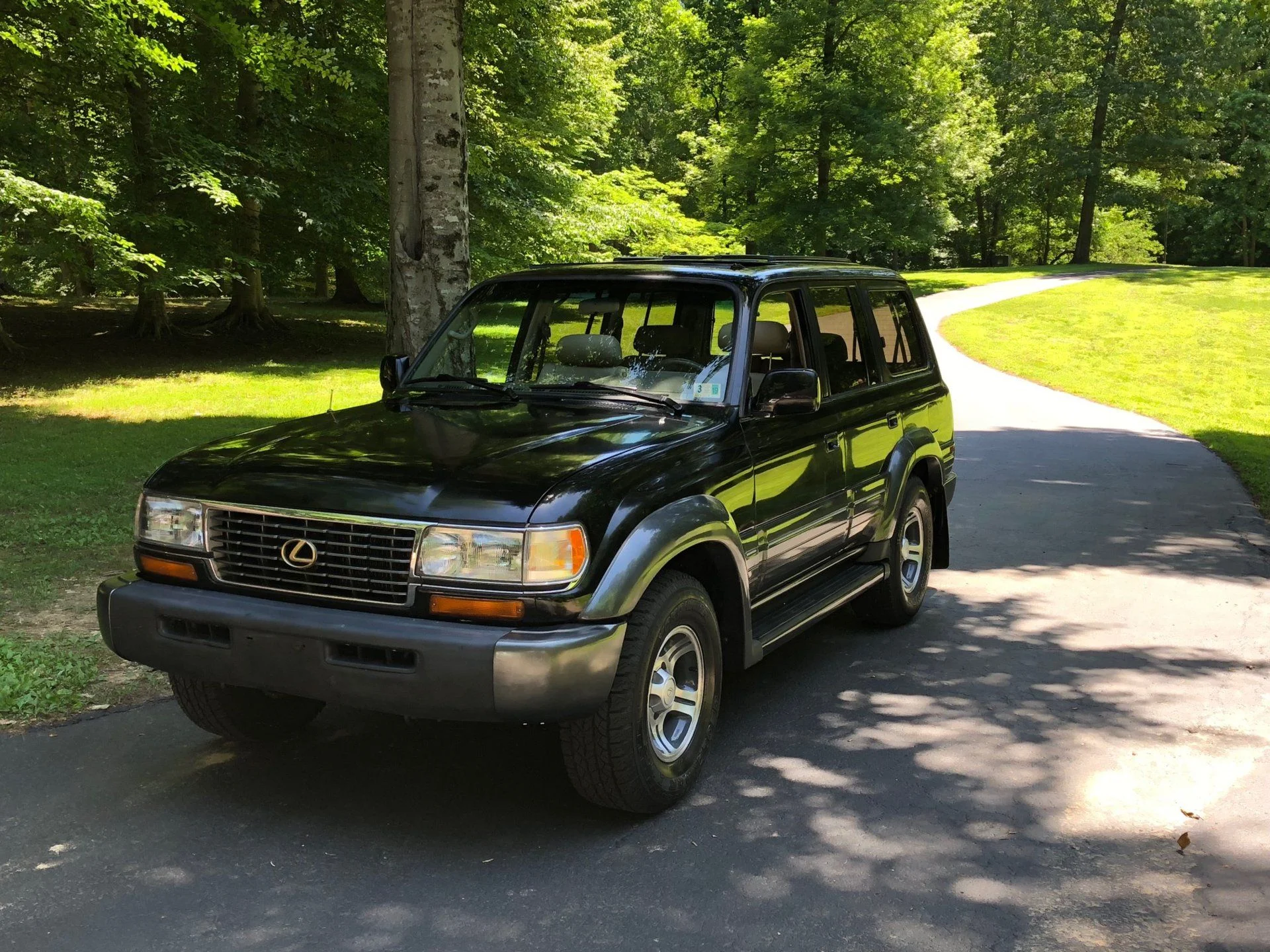

I picked my 80 up!!!!!!!!
It's a 97 LX with 190k miles and the previous owner did pretty much every PM there is (except HG). It runs like a top and doesn't appear to burn oil and doesn't leak.
Since picking her up, I bled the brakes with fresh fluid, installed the bh3d double cup holder, and did the CDL and pin 7 mod.

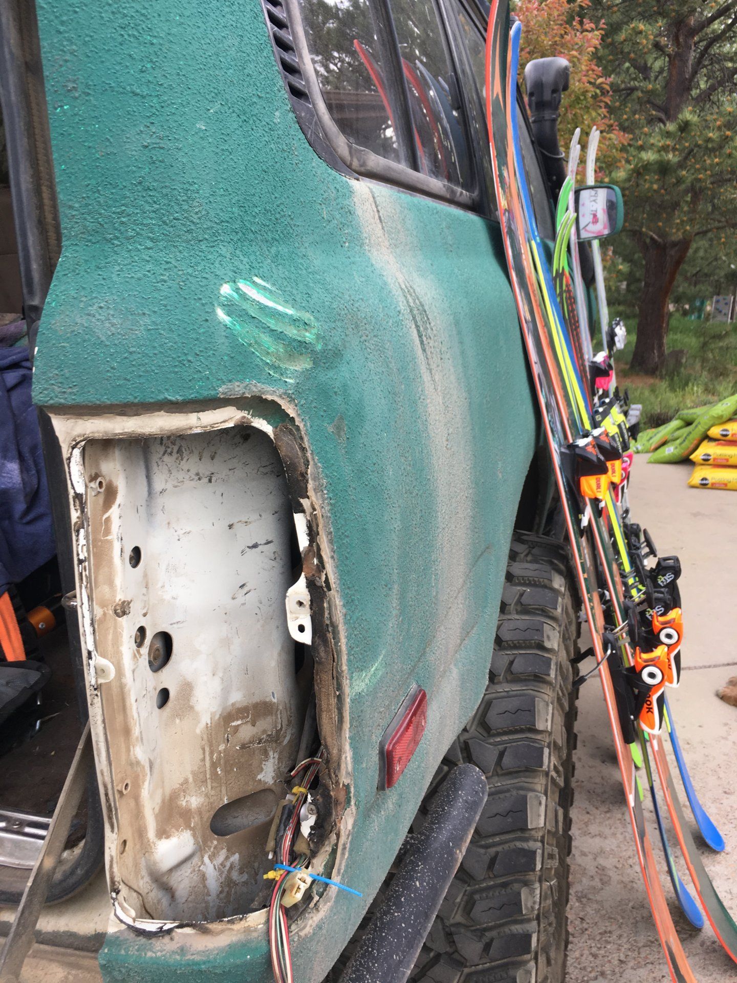

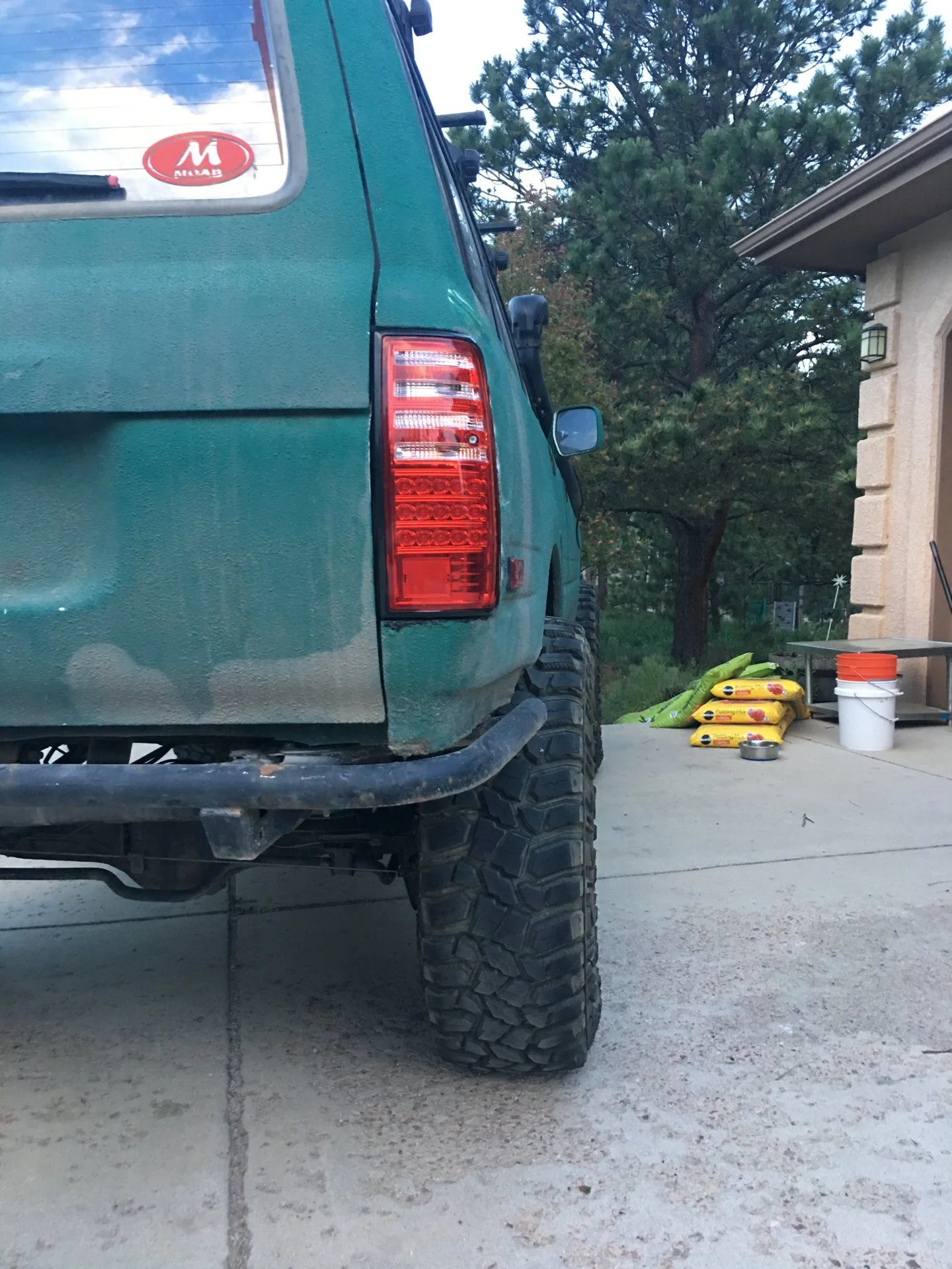

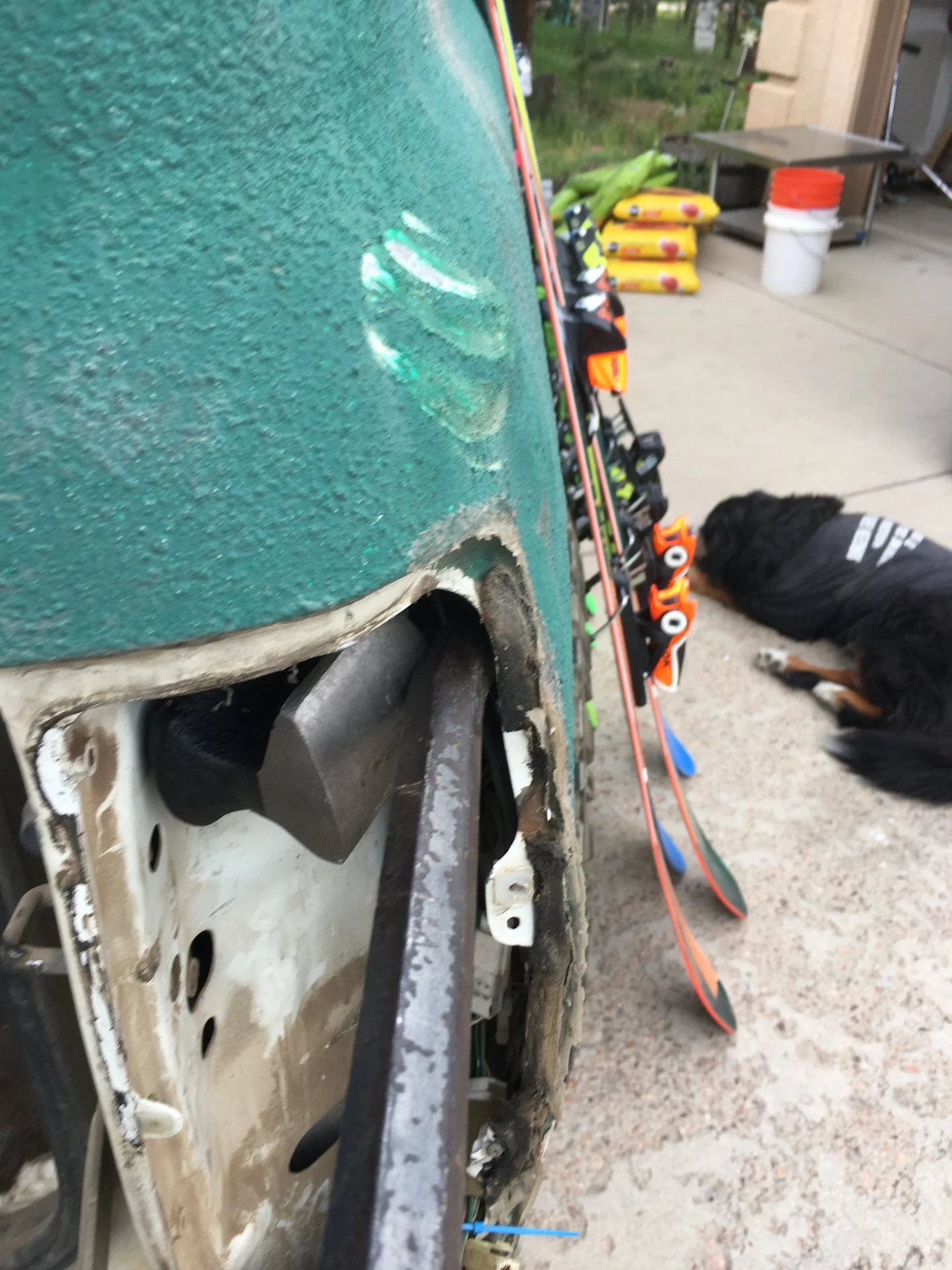

Creative dolly and crowbar work to do some undenting. The original dent here goes back to 2005. This was #3 and it messed up the tail light mount shape.
A cool thing about having Dynamat sound deadening back there is crowbar use doesn’t leave any punch marks at the crowbar tip.
Since I have a bit of Durabak repair to do I wasn’t overly careful with the rubber gasket stuff. I’ll scrape off the excess later and clean up those lines.
Since picking her up, I bled the brakes with fresh fluid, installed the bh3d double cup holder, and did the CDL and 7-pin mod.
