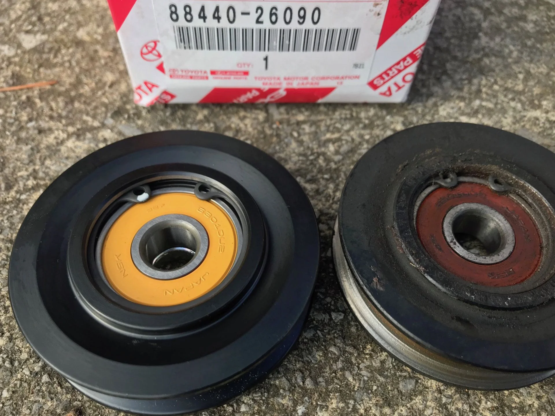

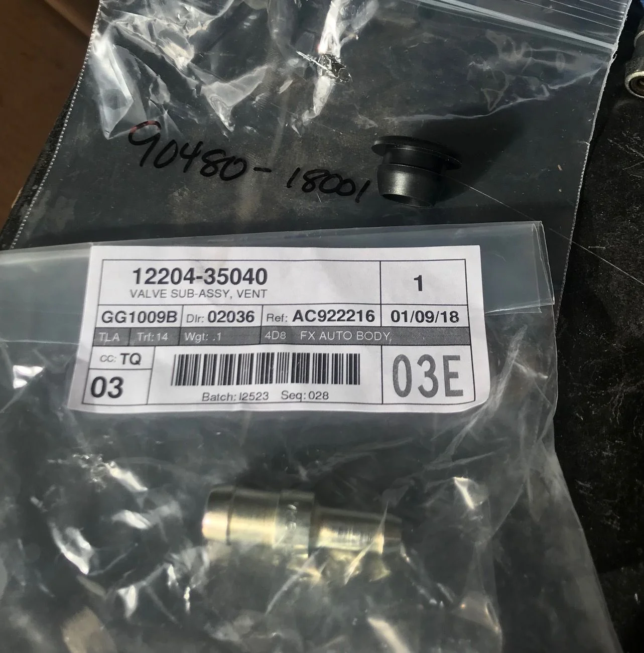

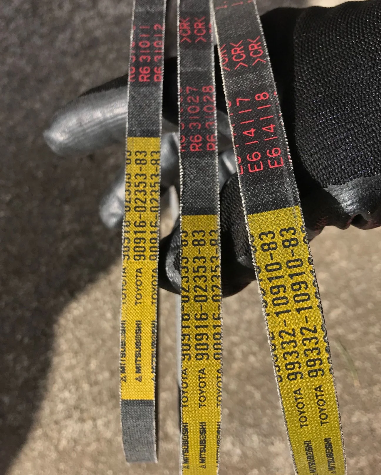

a little maintenance, nothing out of the ordinary. replaced the original a/c tensioner - i had rebuilt it around the time i got it (35K miles ago?) but the seals were leaking all the grease out. i looked at getting a new bearing but from what it cost i just got the new pulley. again, nothing that hasn't been done before but since i replaced all the belts, i lined up the alternator belts nice and pretty just to see how long they would stay that way - not even 5 minutes..
now this seems strange to me: the PCV valve has always seemed a little loose in the grommet. couldn't remember if it was always like that and it seemed like it was getting a little hard (7 years old). after replacing it, with oem grommet and valve it still is loose - if it's leaned over a little you can hear it sucking air... is that a common problem? naturally, after a little while it sucks itself down and the leak goes away but doesn't seem right to me
I don’t have the issue you described. Is the correct hose connected to the pcv? Or is the hose you are using too short or too long?
correct hose, but even at that, it seems like there should be a good tight fit between the valve and the grommet :hmm:
my valve and grommet are about 3 years old and have maybe 10-12k miles. I have noticed a growing oil stain on top of the valve cover around the grommet but no air leaks noted. Did you install the fat end of the valve in the grommet. The fit will be very tight as you past the barb through.
Mine was tight enough going in that I had to put a little oil on the valve to keep from pushing the grommet into the valve cover.
