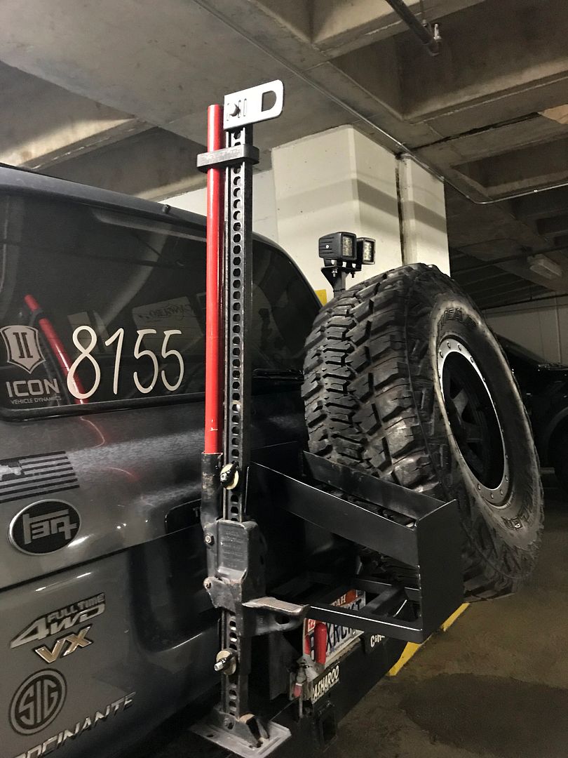

Did this a couple days ago. My highlift has migrated a few times on my rear bumper. It was first mounted toward the middle of the truck. Then it got moved close to the hinge when I added a fuel can basket last year. It's bugged me since then because the lift gate would lightly touch the highlift when I opened the lift gate. So I built new mounts that put it back to the center of the truck so I don't have a problem with the liftgate any more.
original.
Moved to hinge side because of fuel can basket
New location
What bolts did you use so your Jerry can would not rub?

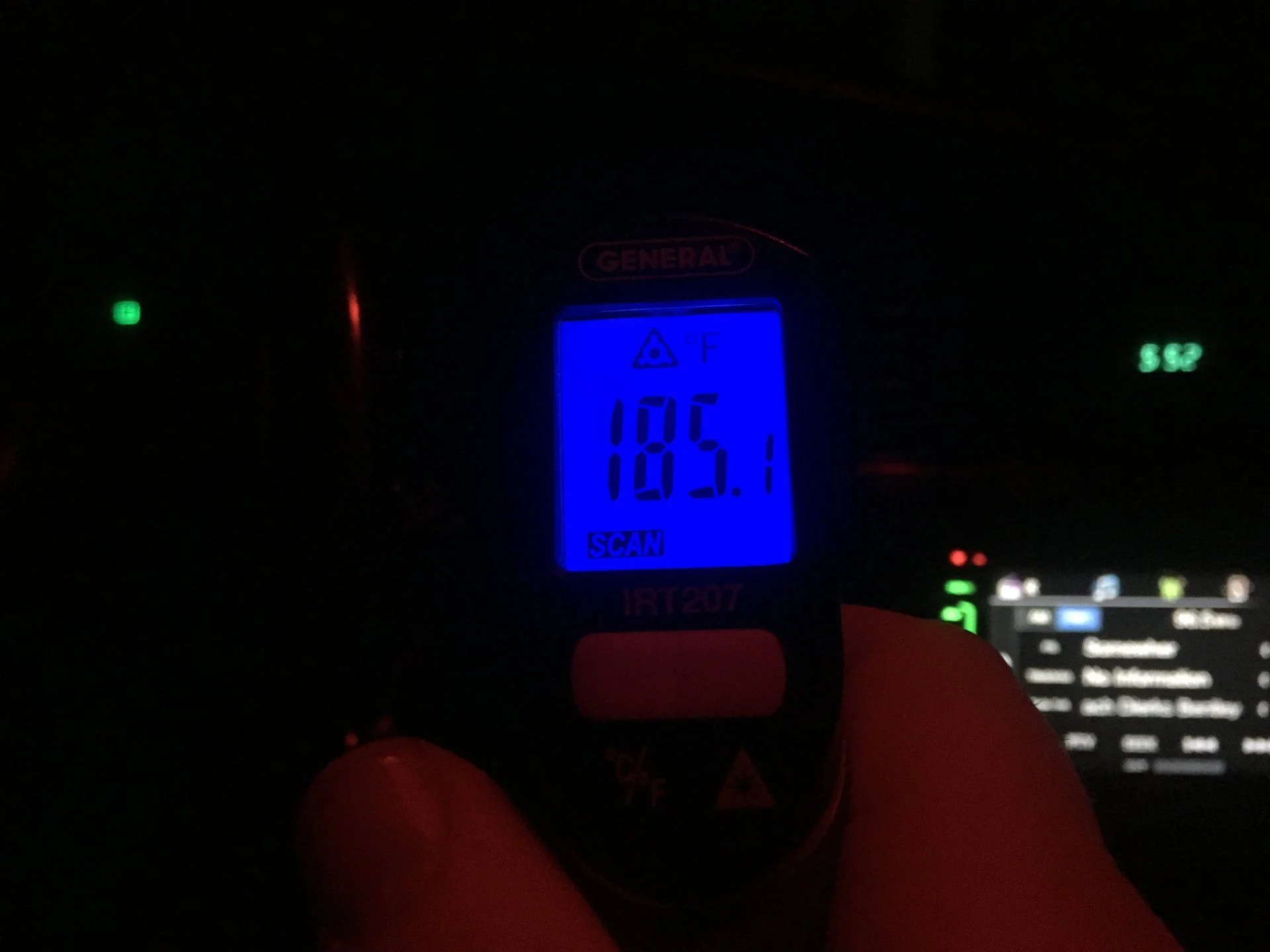

I did an engine swap a couple of months ago, the AC must have had a leak, it was completely discharged. So I don't have an AC option, like you I need to run on recirculate to get some heat out of the vents. Most of the time, engine temps run around 177-181, might warm up to 185 if I'm stopped at a light for a bit, but drops down once I start moving. The recirculate option works pretty good by myself as long as I keep my boots fairly dry, once I add a passenger or two that option is out. Already bypassed the under seat heater, due to rotted out heater lines. Thinking a propane tank with a Tiger torch (sarcasm) might work. Outside temp -18 celsius (0 Fahrenheit), bit better today only -8 (18 Fahrenheit). Ironically, last summer was hovering in the mid thirties (Centigrade) for almost two months, 95's for you old school Fahrenheit guys.

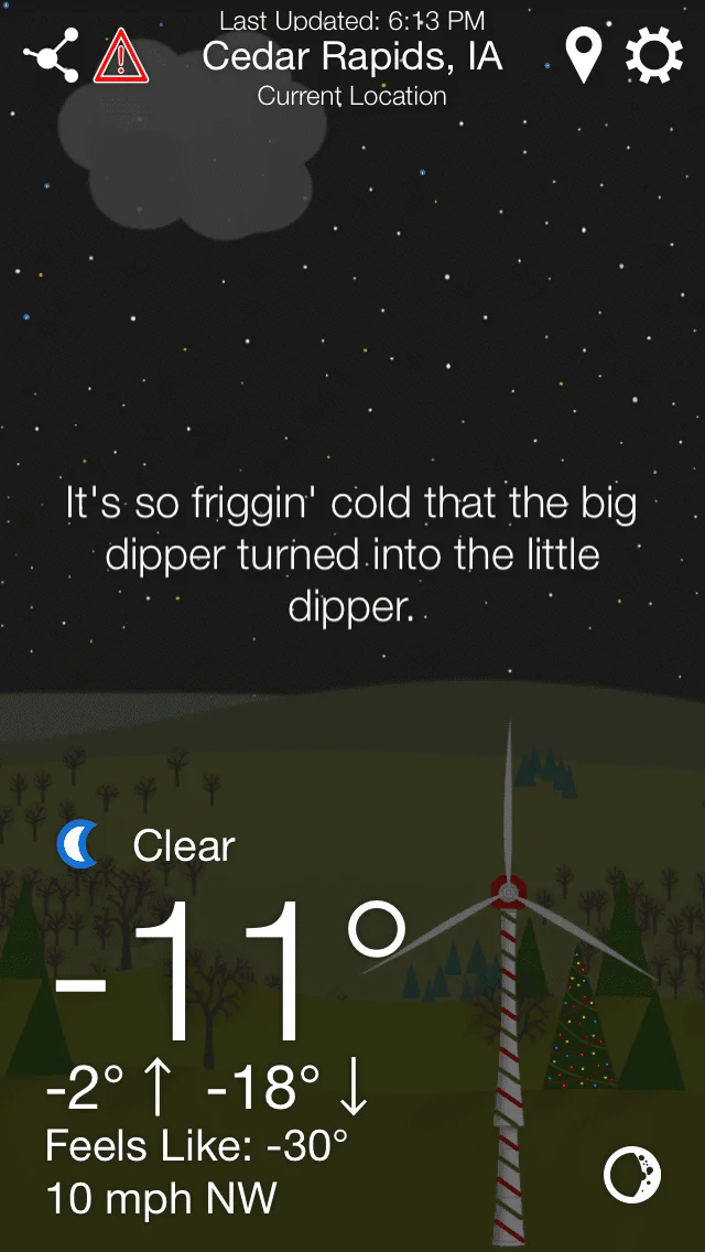

This is my vent temp with fresh air and the outside air temp.
