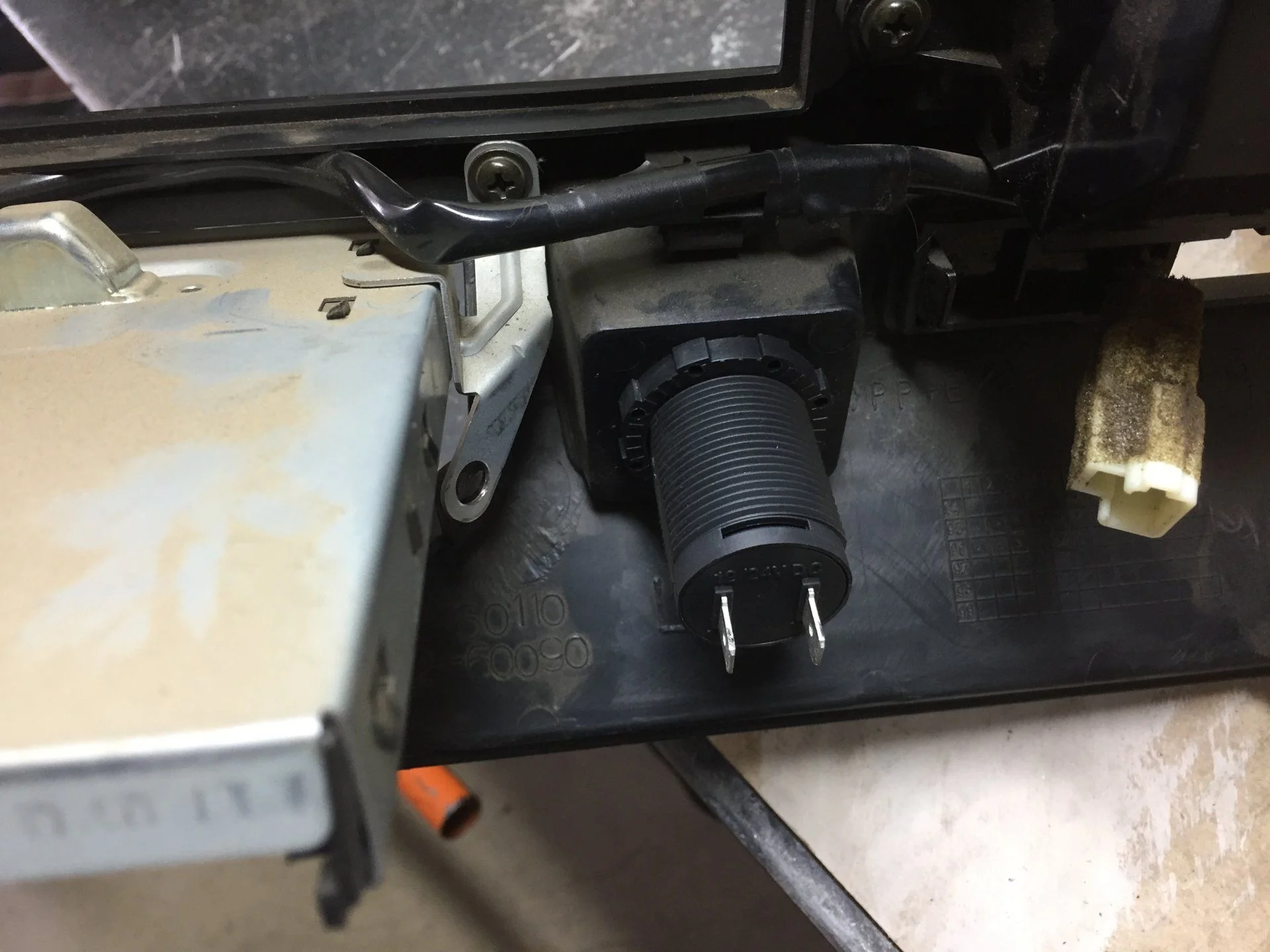

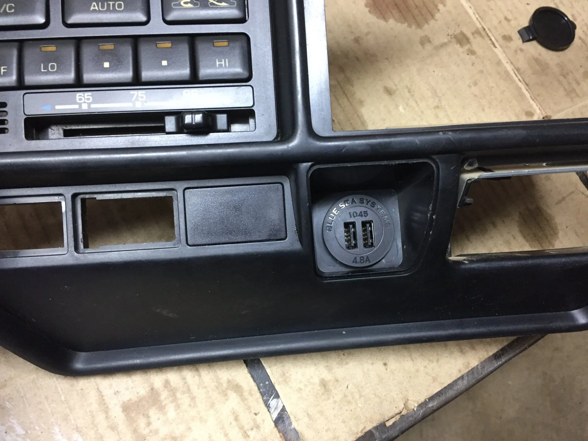

So I just put in a blue sea 1045 duel USB in place of the cigarette lighter, what a pain but turned out nice.
my big mits have a hard time dealing with dash parts and all them stupid connectors...thought I was gunna bust up everything.
Once you get cig lighter out you have to make the opening just slightly bigger, a round file worked ok.

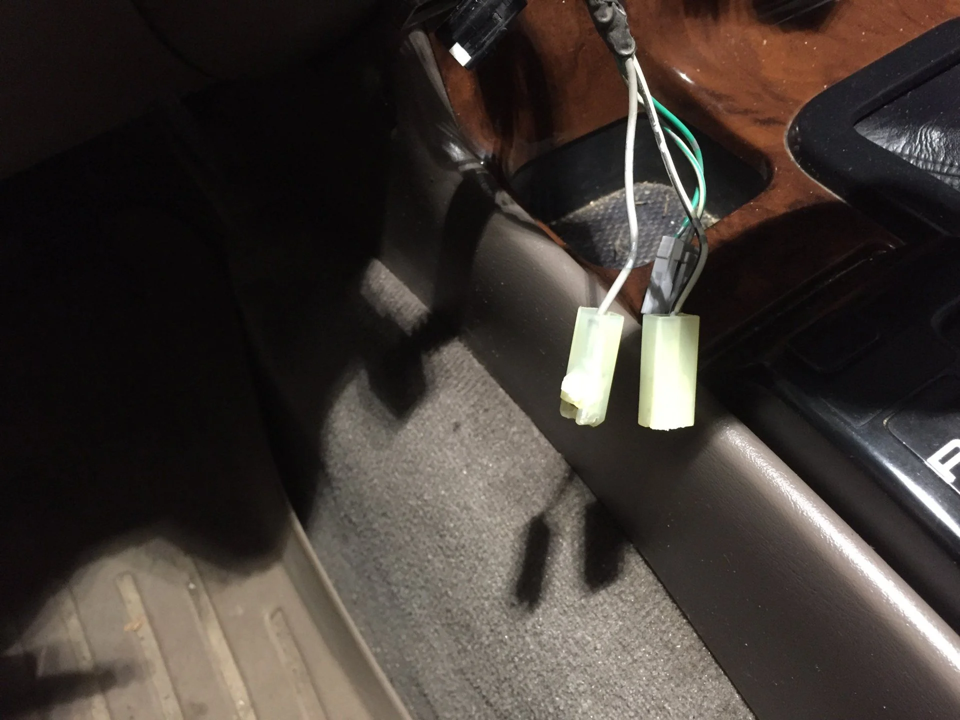

The plus and minus original connector I just cut in two and plugged it into blue sea USB...gray wire is plus (hot)

I’ve had the same exact USB port on the shelf for months. Since then I remembered a double adapter I simply plug into the cig socket. The problem I really want to overcome is no power there unless the key in ON. Did you set it up to be an always hot power outlet?
What about adding the Blue Sea rectangle one? It fits in to one of the many rectangle blanks. Slight filing needed but not much. Then just wire it directly to the battery or a Blue Sea fuse panel or whatever.
Blue Sea Systems Fast Charge 4.8A Dual USB Charger Switch Mount, 12V/24V https://www.amazon.com/dp/B01AHYC88A?ref=yo_pop_ma_swf
