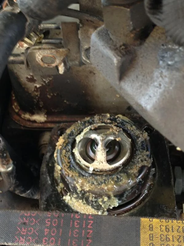

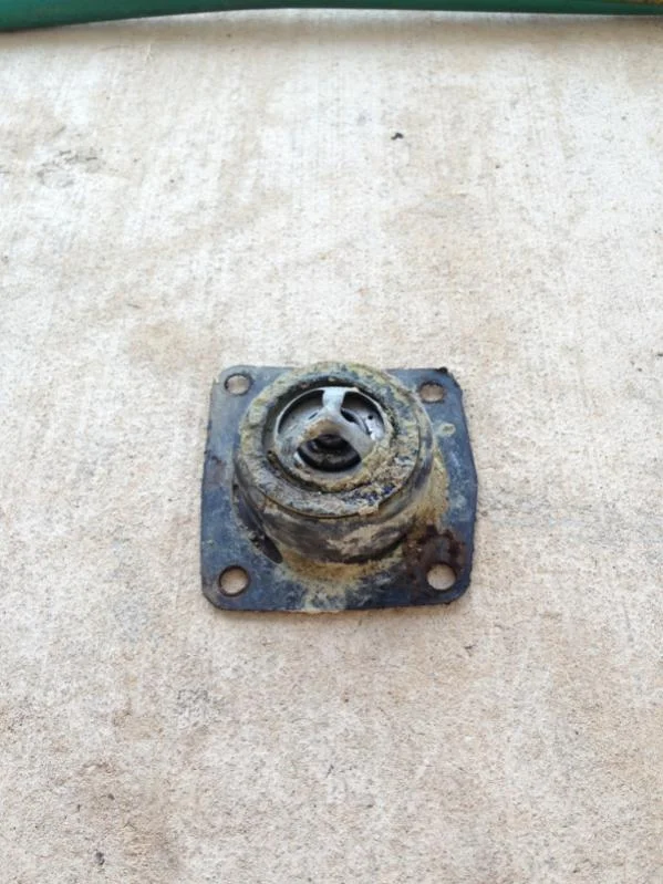

Replaced radiator with an all-metal CSM, new OEM t-stat and bypass hose. Looks like it was time! Flushed the system and made sure to use Distilled water and green coolant for the refill.
Looks like PO had been using hard, tap water. I was a little worried when I opened it up, but turns out it was just calcium buildup from hard water and sludge from the coolant. Cleaned up pretty good and she's humming along now...nice and cool.
