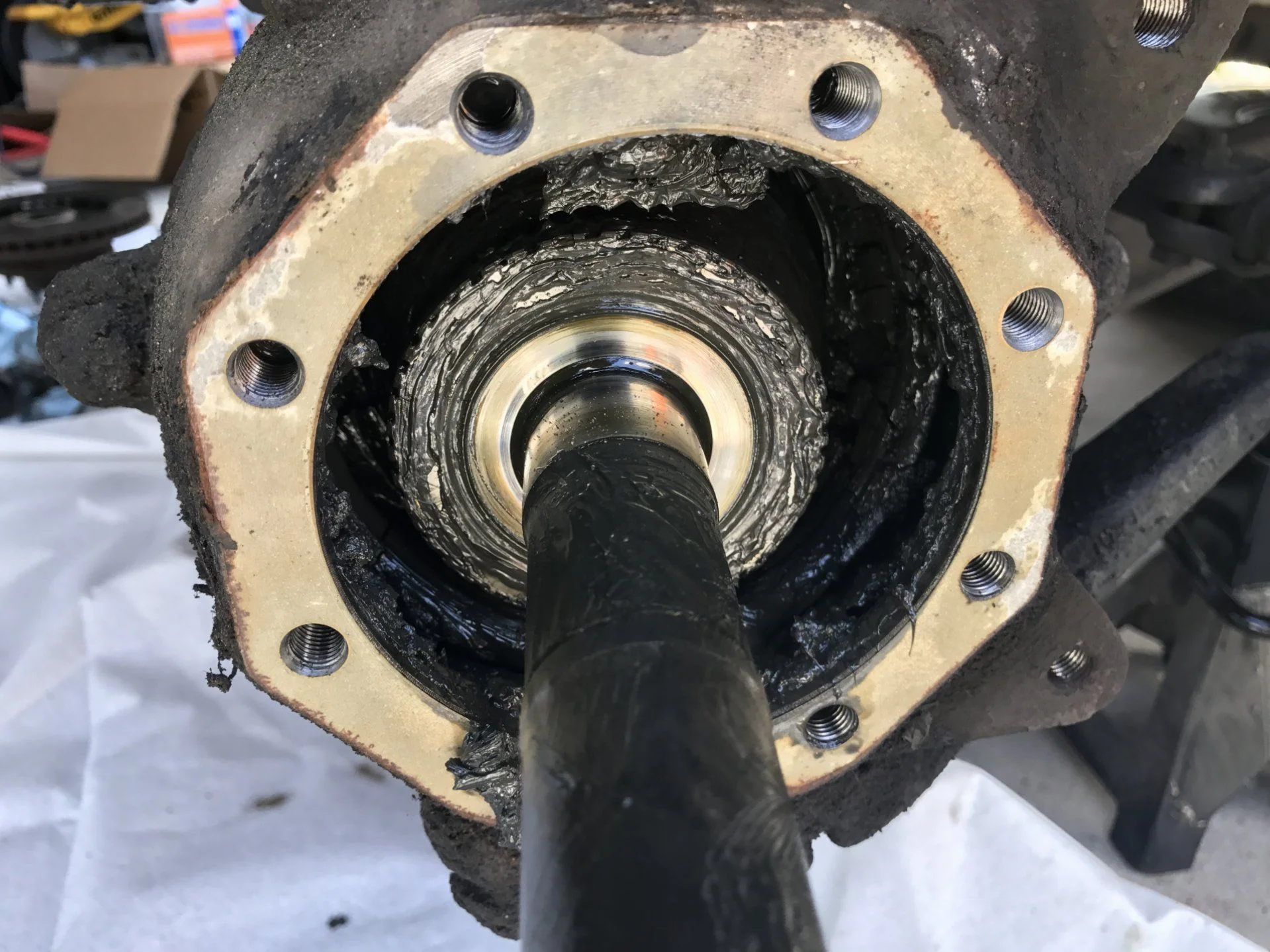

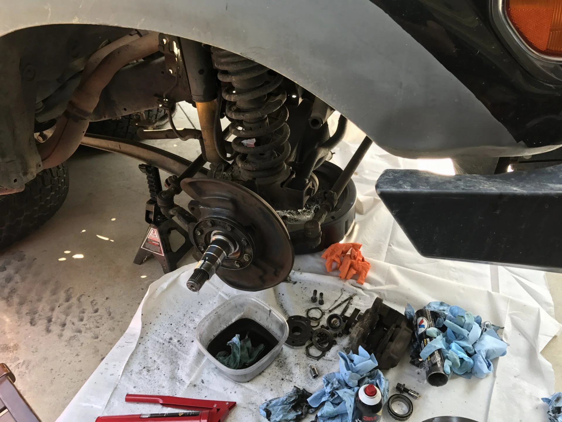

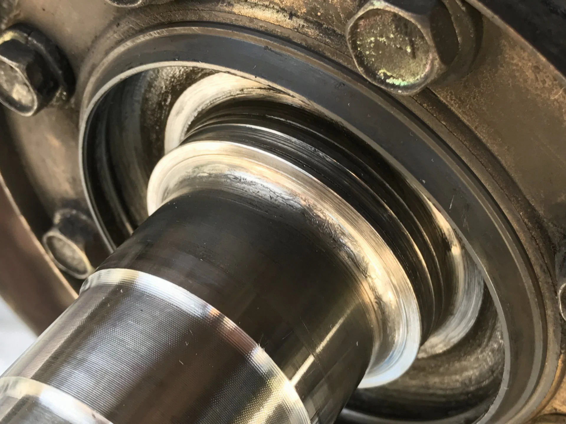

Doing a complete brake job on @jaymar's 80.

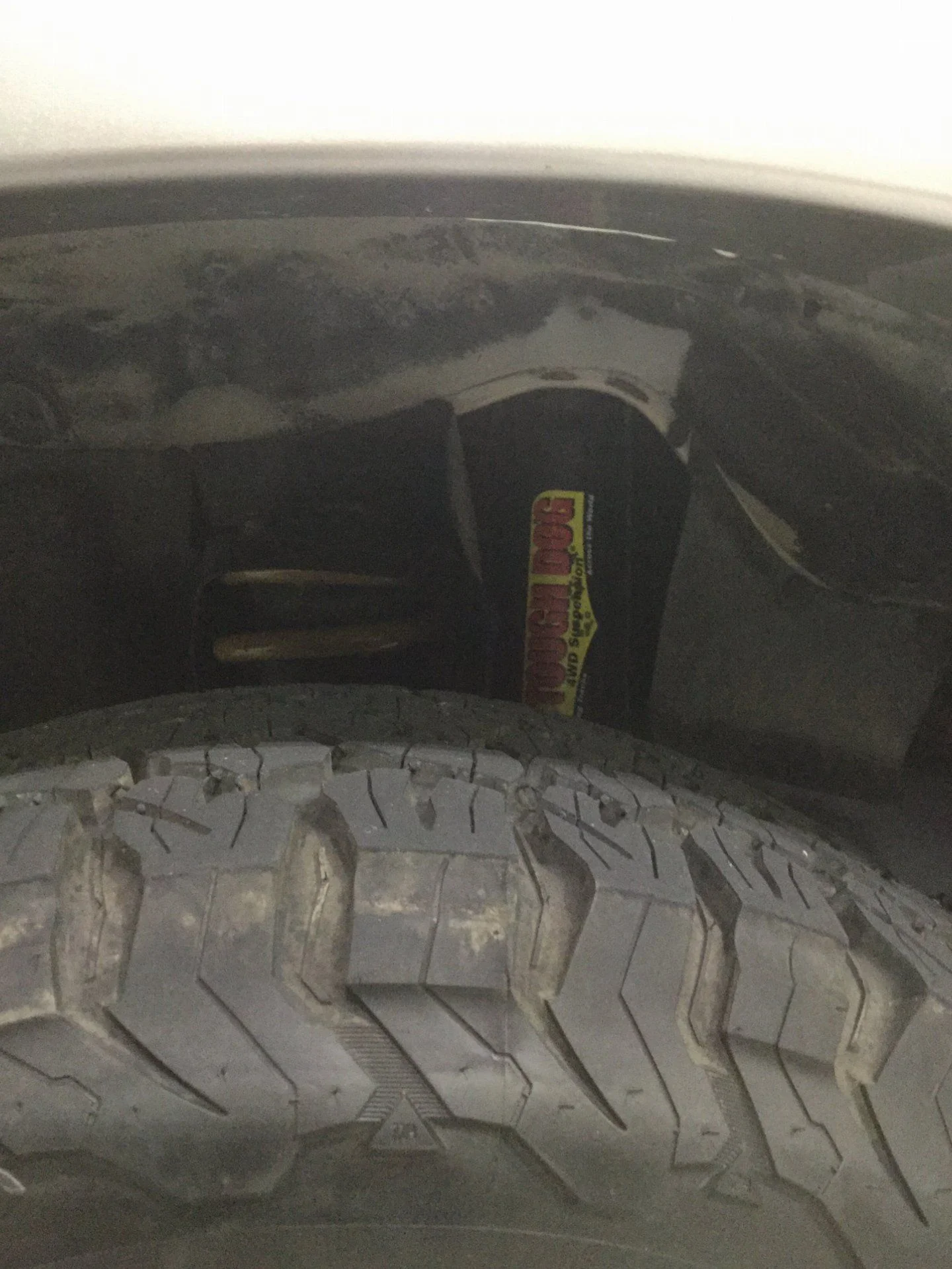

Installed my Tough Dog 3 inch lift last night.. rides so smooth looks great. Just have the caster plates and adj panhard rods left

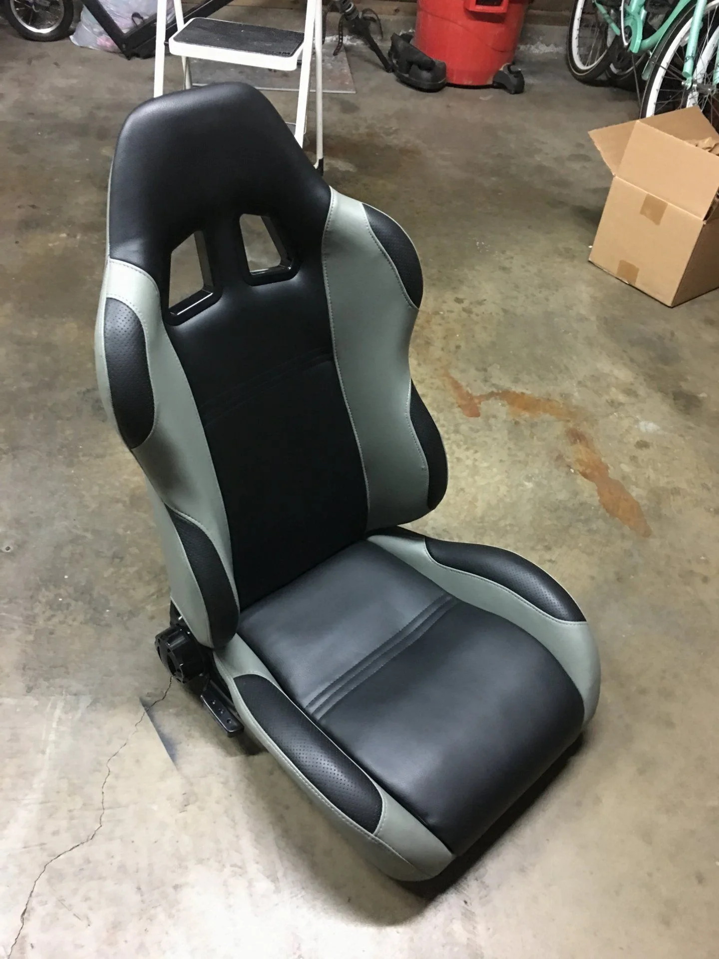

Also found some new front seats on CL for dirt cheap to replace the broken and torn up power leather seats in my 93. PO paid $1,400 for this set and he let it go for $300 with real Katzkin leather.
thats is a score, m really thinking recaro for the fronts

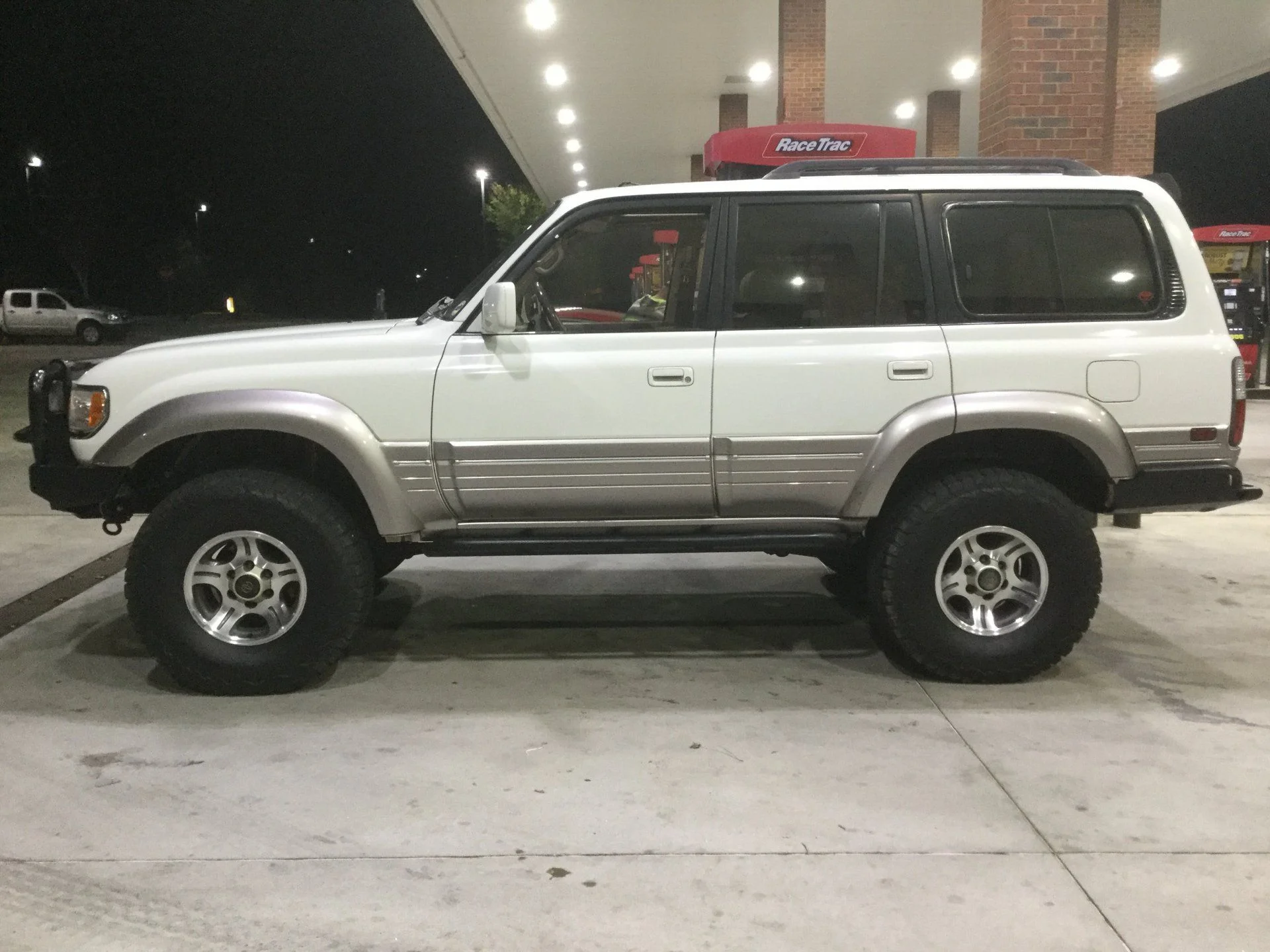

I got rid of the BFG Krawlers and replaced them with 37' Nitto Mud Grapplers. Krawlers are just way too soft for the heavy FJ80.
Grapplers sit about 1/2 taller and an inch wider.
Im looking to trade my beat 37 Mud terrains and was eyeing the grapplers, whats your total lift. suspension and body. and do you have massive wheel spacers?

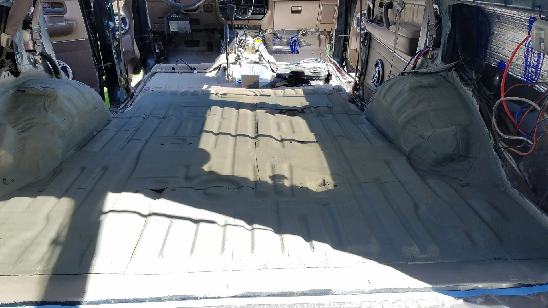

Installed some more sound deadener, replaced PCV grommet and had to dig out the bottom brittle piece with needle nose pliers, paid for my KISS drawers from @cruzerDave, and added some additional storage. I'll be spraying the interior with bedliner on Monday. Fridge will be mounted behind driver's seat for easy access on road trips.
Well it's not the best bedliner application job ever done but I think it will work. Sprayed some etching primer on the sound deadener to help adhesion. Spilled a little bit, splattered more than I anticipated, but it's not a show truck so screw it!
Alcohol rub down before it sets gets most of the splatter off. I added rubber granules for more traction, hence the bumpy look. Forgot to plug the few bolt holes I still need to use. Time to break out my new tap and die set!
