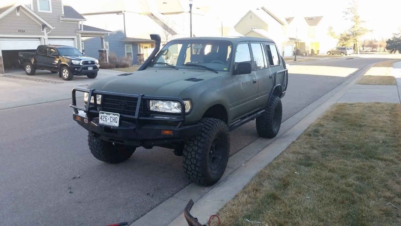

Paid for it and drove it from alabama to Boston on 37s in 19hours, so theres my first act as an FZJ owner. Im in
I plan on bringing this rig right back to 80baja left it when he sold it, it has been a bit neglected id say. dual batteries need attention as does liner and engine bay. Ill post em as i do em. I would like to swap the front 4xlabs bumper out for an ARB with 12k winch. and re install compressor

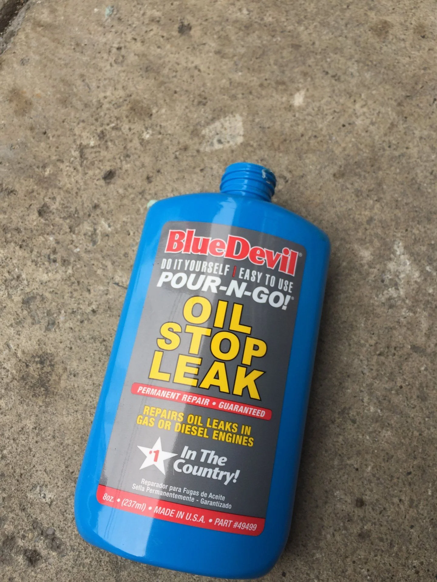

View attachment 1428631 View attachment 1428630 Well I think its time to replace the head. Theres no coolant in the oil but plenty on the coolant. It never runs hot and we drive it 300 miles a week to our cabin.Gonna try this stuff and if it does not work, well it was broken to begin with.
Well, you've probably read that people say don't use that stuff. In my experience it will clog up the little coolant passages you will see when you do a real head job. I'd advise getting the FSM and doing it right. It's not too hard! If there was "head gasket in a bottle" the 80 Series would be immortal!

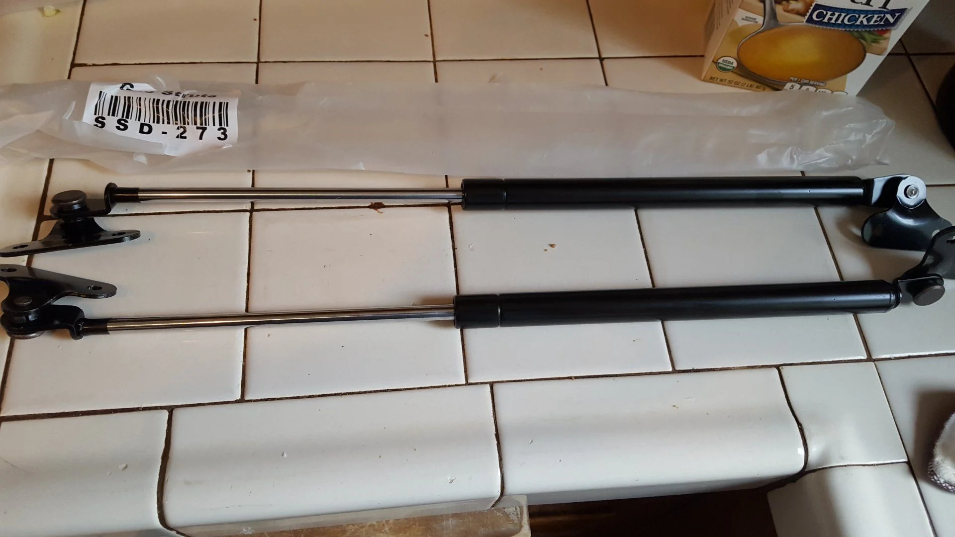

Thanks for that pic! Reminded me of getting clobbered in the head by my rear hatch while in Tahoe in December. Ordered these and forgot about them. 10 minutes and a 10mm socket...Wow....helluva improvement!

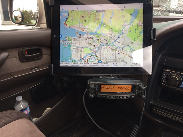

I guess this is what I did last weekend, but fits the discussion.
The truck came with the RAM iPod mounted on the passenger grab handle, added another mount and hung the FT8800 face on it.
The radio body is mounted to the side of the storage drawer, and there are 2 speakers mounted to the centre console for the ham and cb radios. So far working great, and really like the position of the face plate. Yes I still need to clean up the wiring :hillbilly:
When I finally get around to doing the FT857D/Screwdriver install I'll do the same and mount the faceplate below the 8800.

Damn...doesn't leave much room for the big girls! :D

Wife is 5'2" and not at all large. She has no issue with it, says it's not in the way at all.
Bonus on a long trip she can download a movie or 2 to the iPad, twist it to face her, and watch something with headphones.
Technically, at least. Not been tried yet.
