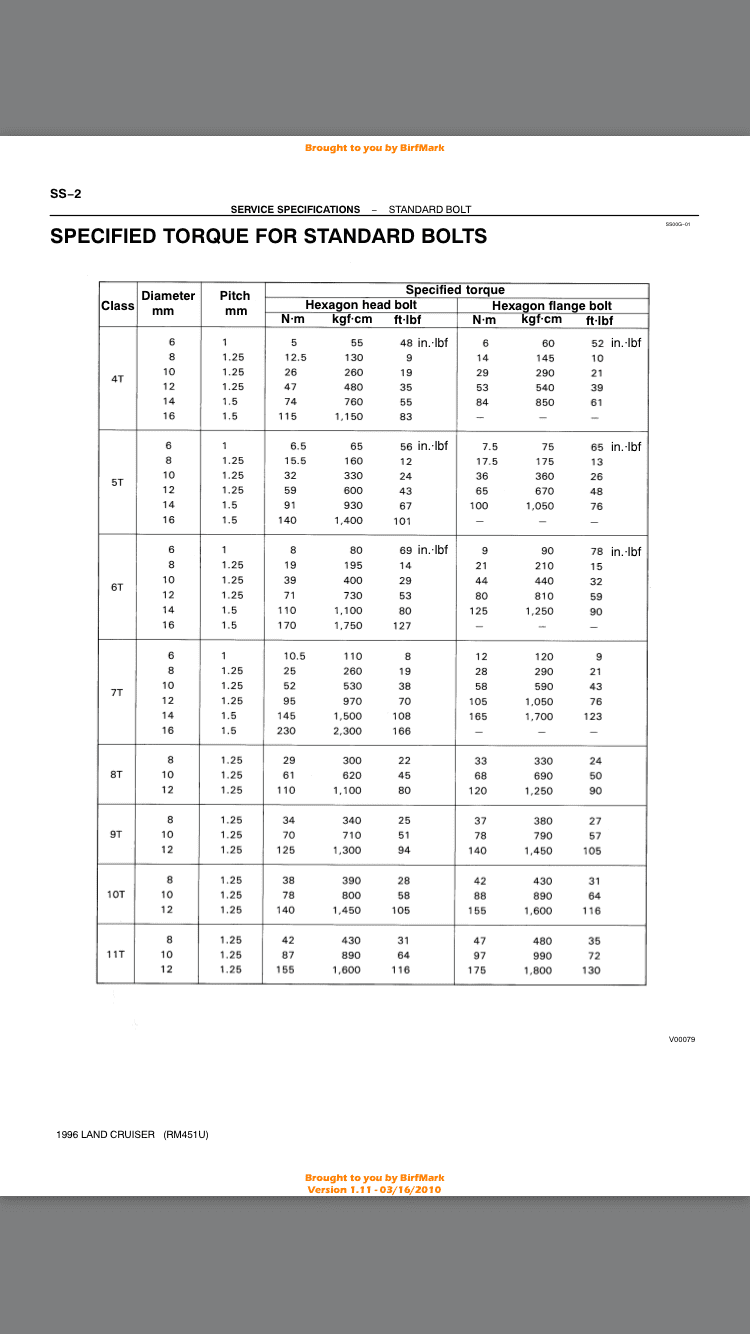

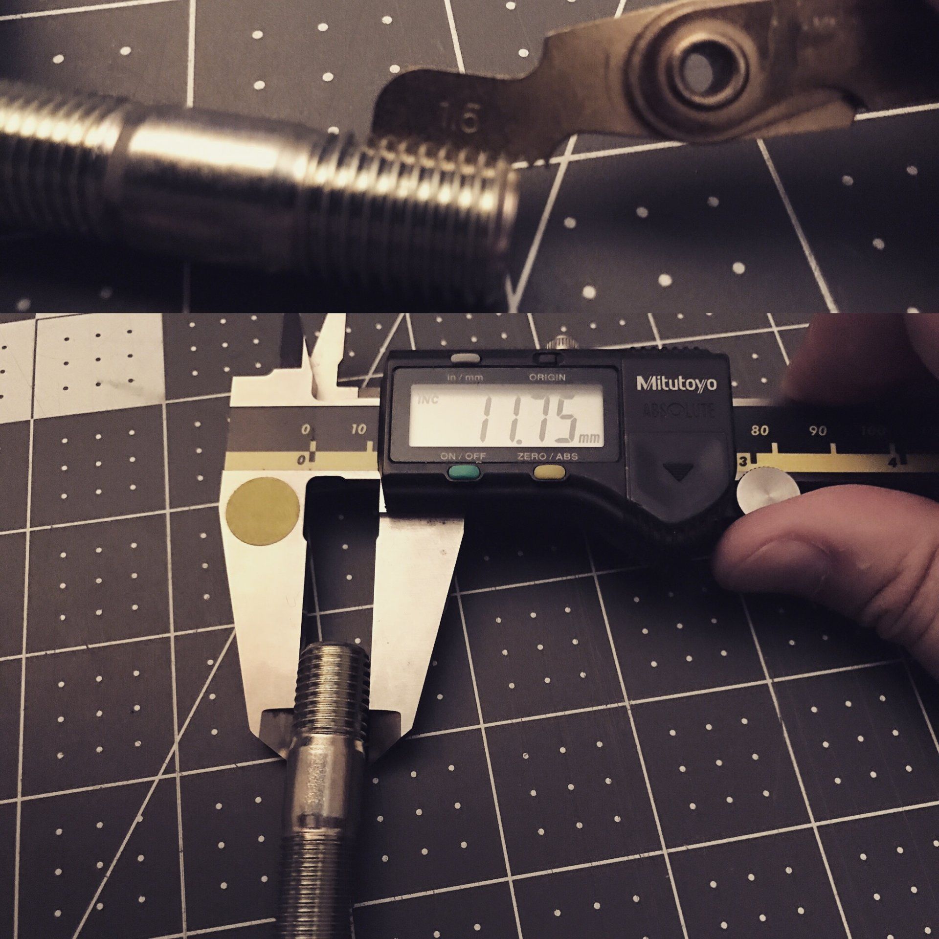

Just had a customer emergency. Guy calls up on a trip down in Baja Mexico. Steering started getting squirley so he pulled over. Two studs and hardware are completely missing from his right knuckle and the other two are loose.
Of course he has no spares but there is a small hardware store not terribly far from him. A quick measure with the studs I have here in stock and the knuckle-side of the stud is M12 x 1.5
The emergency solution is to get a set of 40mm long bolts to replace the two missing studs and tighten the two that are still on and use the new bolts in place of the studs.
The thing I made sure to keep in his mind is that Toyota does not spec a torque for the stud into the knuckle itself. It's just...tight. The clamping force and torque is on the nut and cone washer. The bolt could be threading into the knuckle which is why Toyota uses a slightly thicker shoulder to prevent that.
It's a good emergency solution if you have the correct bolt but definitely needs to be replaced when back at home. In fact all of the knuckle hardware needs to be replaced because it's been compromised.
Here is the torque values for studs and bolts

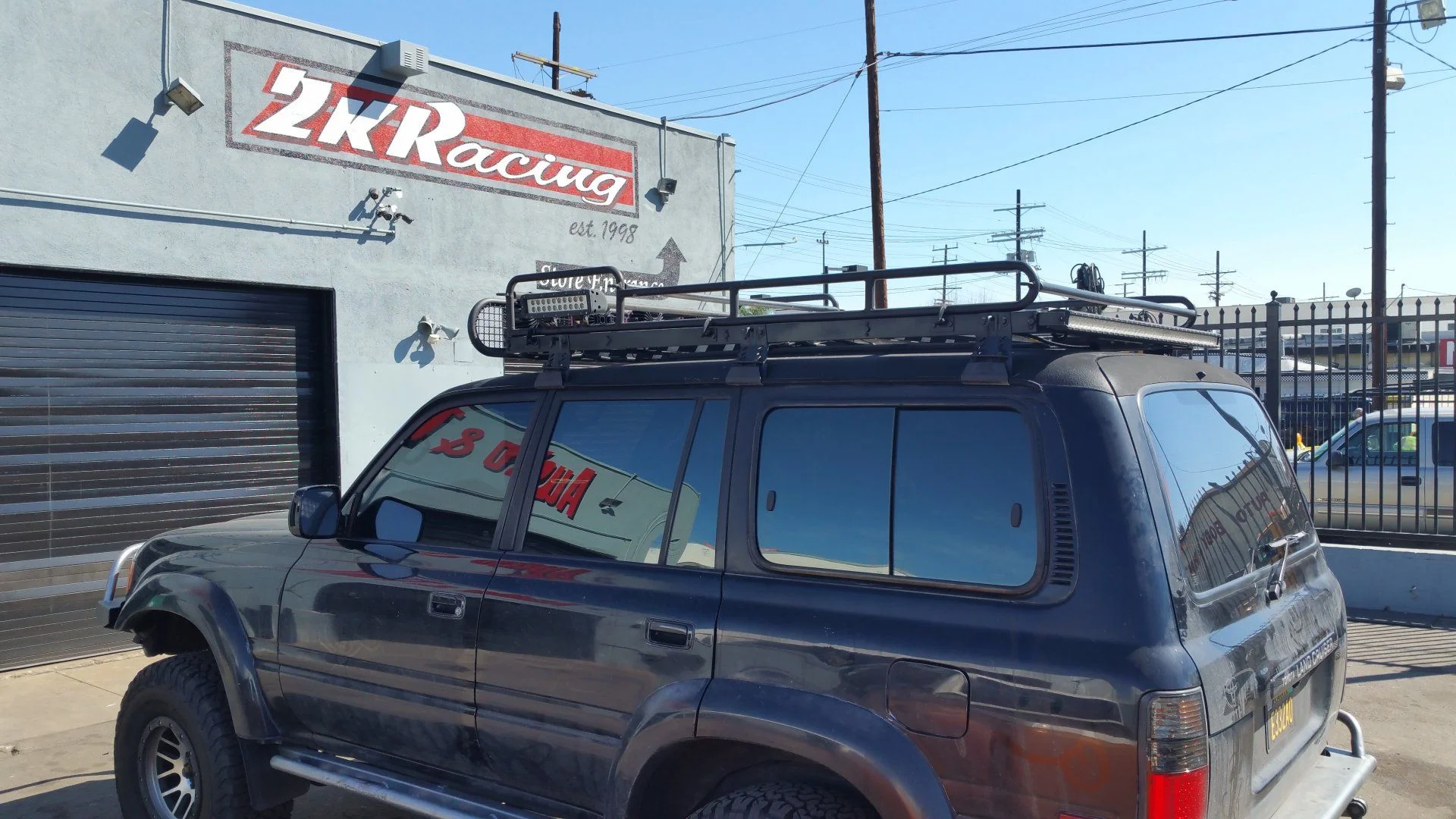

Finally got around to tinting all the windows before the scorching heat begins. Used 20% all around and used 70% film for the windshield. I also think I got a pretty good match for the front windows when compared to the factory silver mirror tint found on all the rear windows. Used two different films on top of each other on the front two windows to mimic the rear silver mirror style glass.

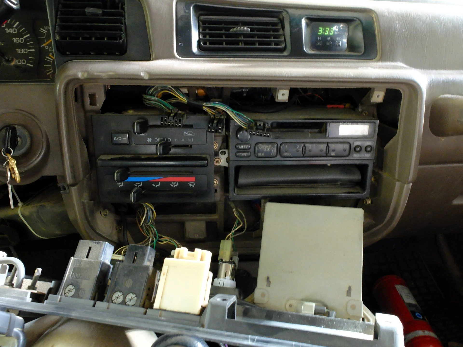

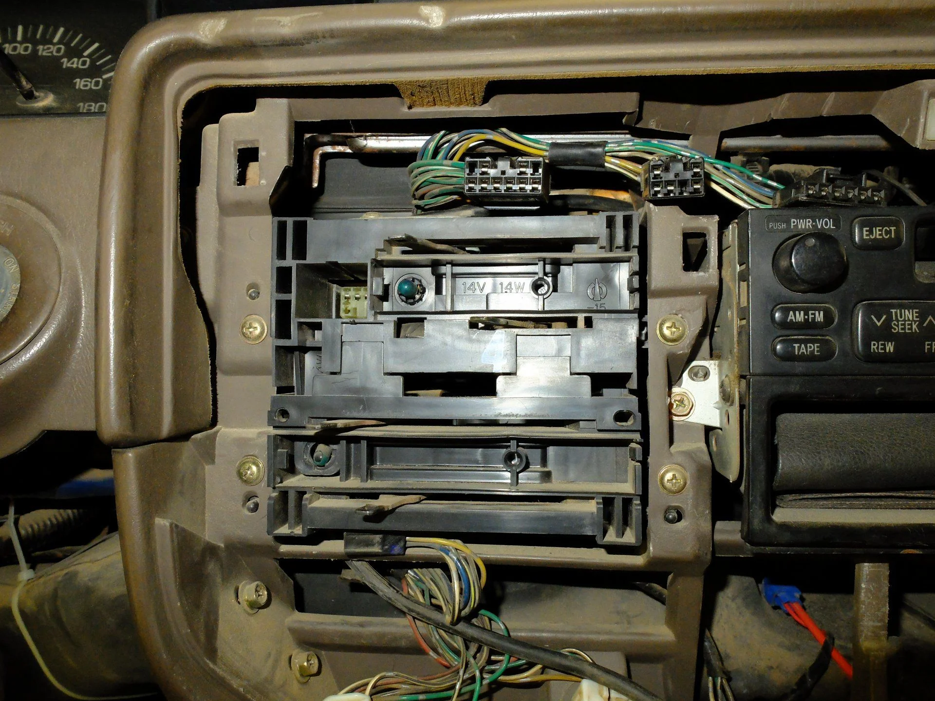

Finally changed the light bulbs on my AC control panel.View attachment 1418296
I'd switch to the bare-bones AC panel in a heartbeat if I had access to all the stuff. And yes, I know that means pulling the dash. Worth it.
Should also give the threads in the knuckle a good once-over and possible thread insert if they aren't perfect.
Personally I'd go as far as pulling the knuckle to fully degrease the holes and threads for proper install of the new hardware.
And I've always wanted that fancy looking AC panel with the thermostat function :hmm:. BTW I didn't have to remove all of the dash board, just the center console (AC control panel area) and used a pair of haemostats to remove those tiny bulbs and re-install the bulb-socket of the lower one in place (that was a b***h) and all went just fine.
