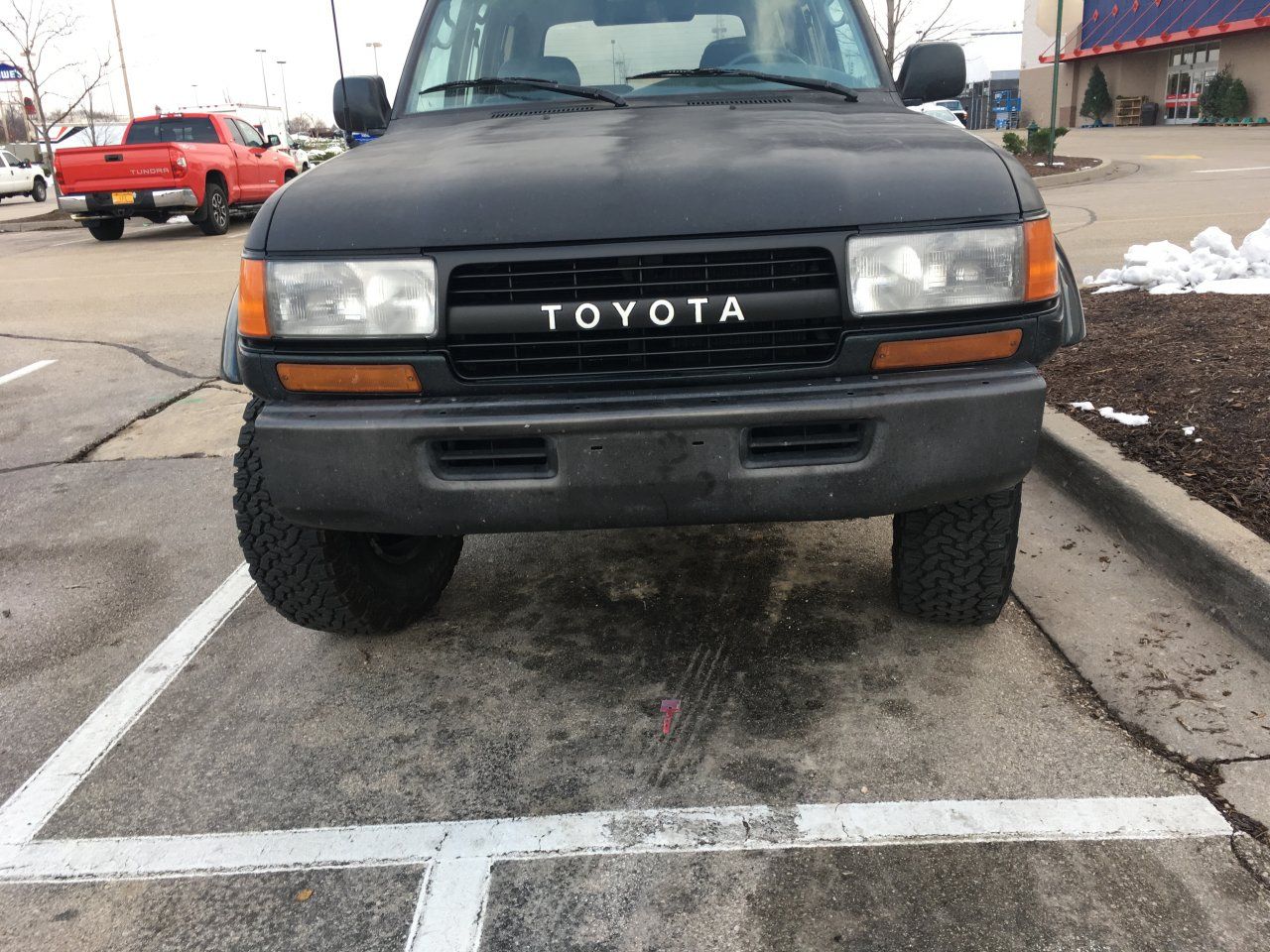

Installed the grill this morning before I left for work. Turned out pretty good. Need to clean up the overspray on the white lettering with an eraser but from 10 feet she's looks good.
May wet sand the hood tonight and respray it to even it out.
And going to spray the front bumper.

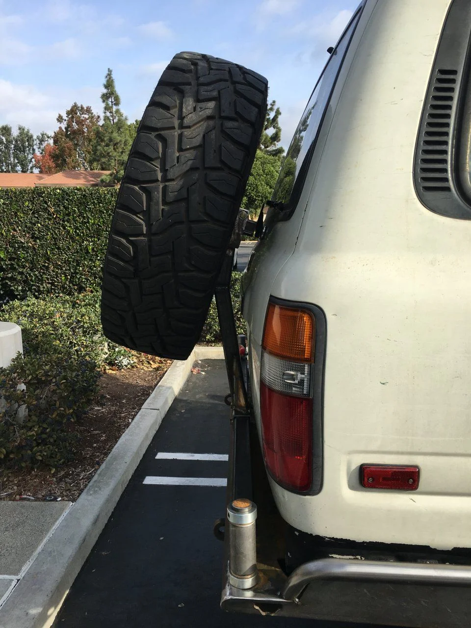

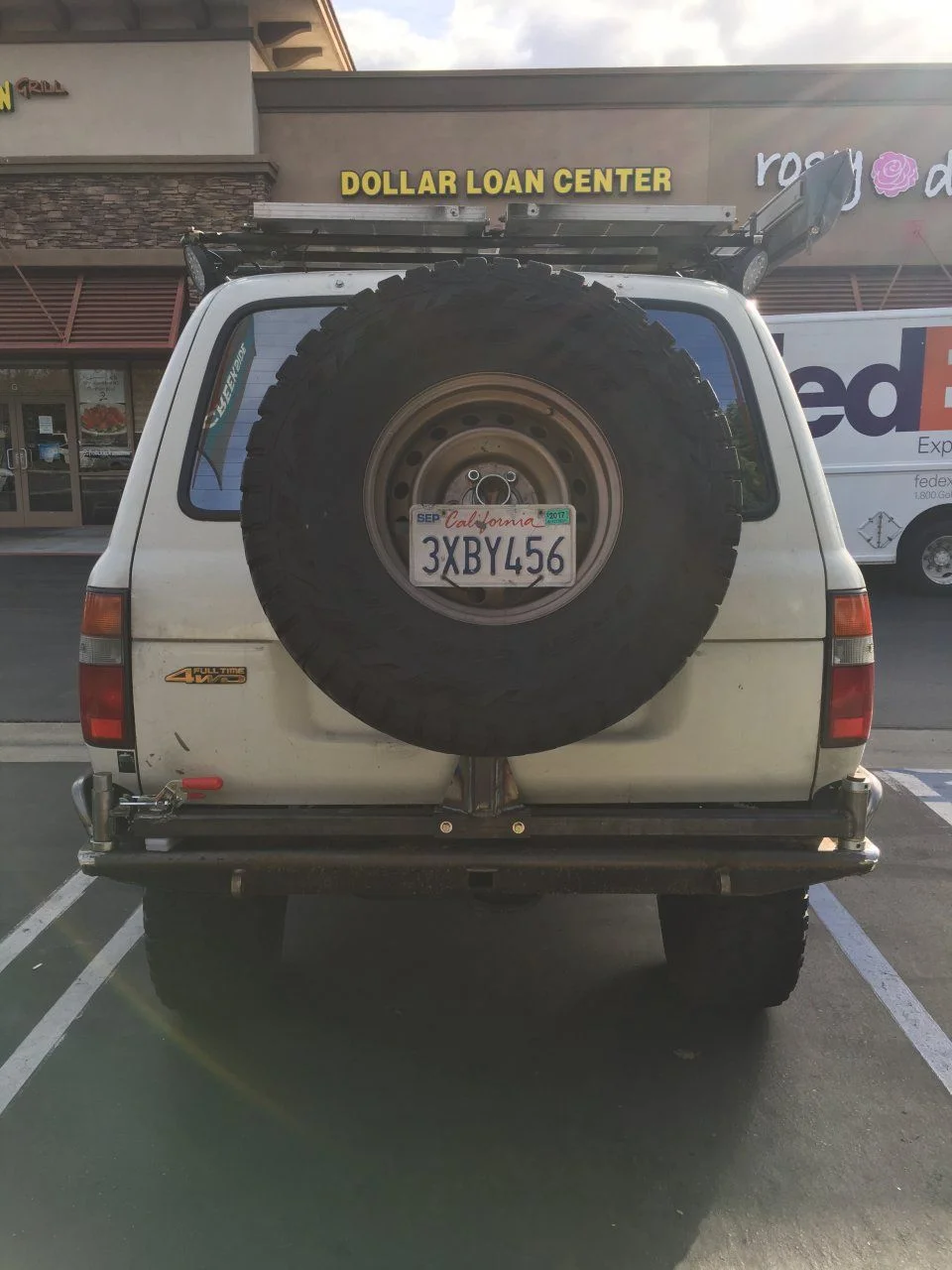

Got the 4X4Labs basic kit with no swingout. Did the single swingout because I want to mount the tire in the middle. Going to see how it works out. If I dont like it I can always swap a single for dual. Need to find a spot for hammock mount.
