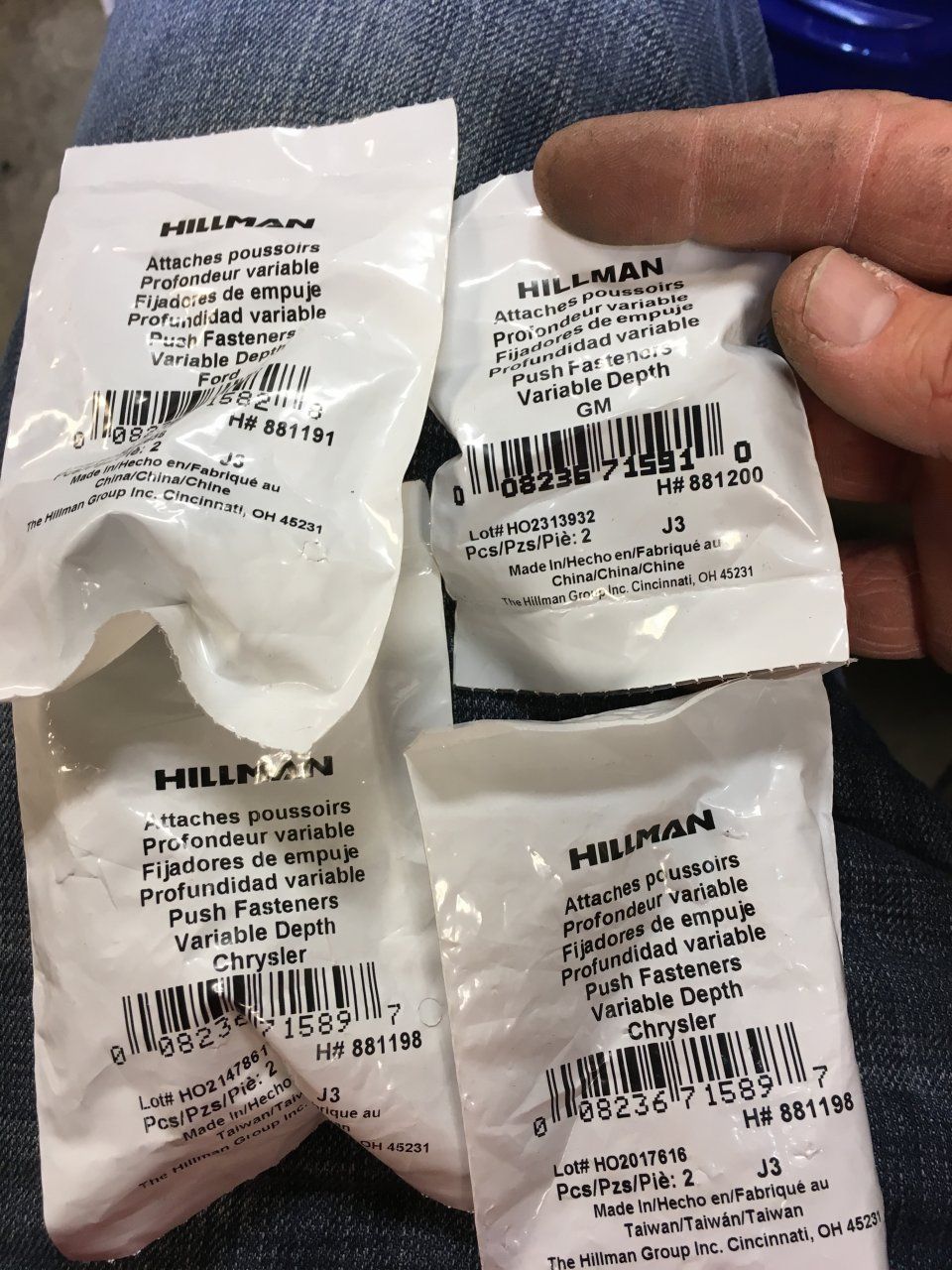

plugs were from lowes home improvement. Hillman #881199 variable depth push fastener GM $.80 per pair

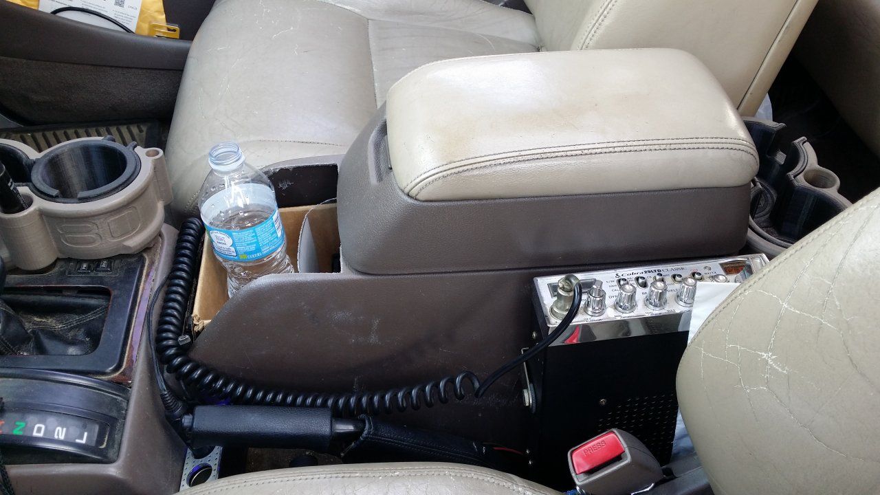

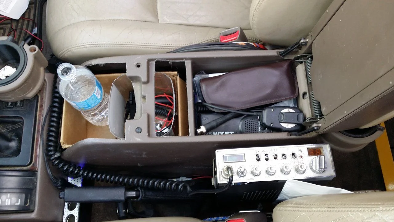

I made an attempt to gain some center console space... Don't laugh. It's better than what I had being a Lx450.
Dug through my box o misc stuff I've purchased and never used. Knew I had some. I have everything BUT that item number. Ha!

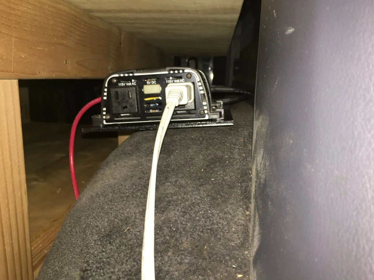

I got my inverter mounted under my sleep platform. I used 3/16" flat stock and the third row seat bolts. I squeezed a few washers under it on the one side to help level it out (could use a couple more). Rattle canned it then grinded off the paint on the one hole to use as the ground. Plugged a fan in to it and it works! Pretty exciting!
