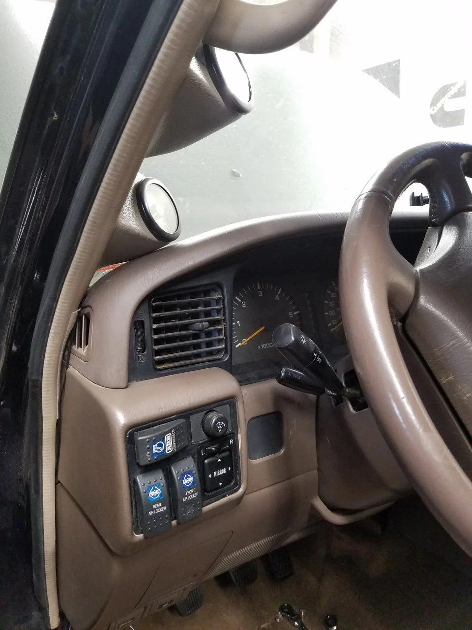

  • Modified an a ucura Guage pod and installed Boost and Pyro gauges.View attachment 1285232

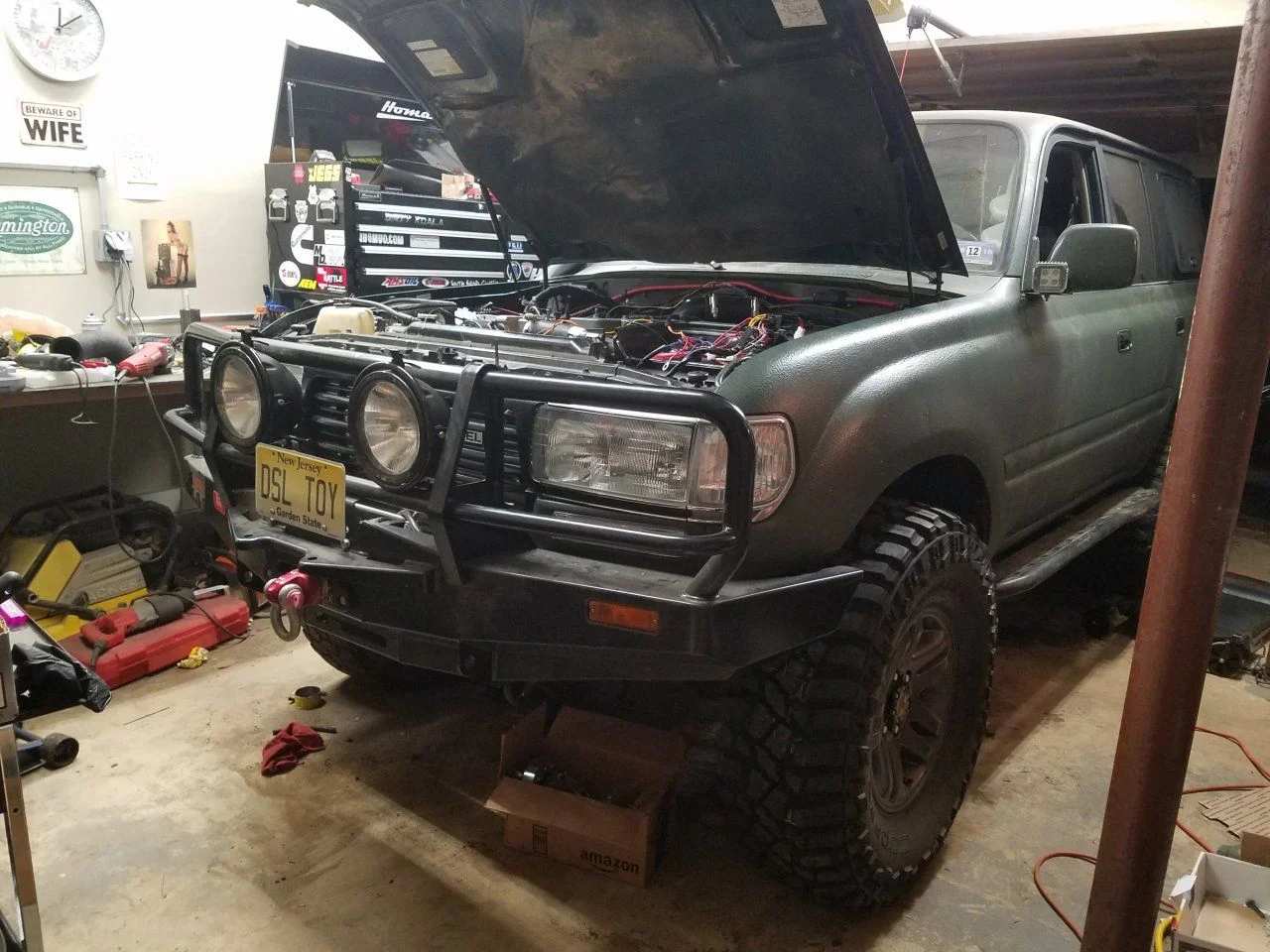

  • Put the ARB bumper and winch back on.View attachment 1285234

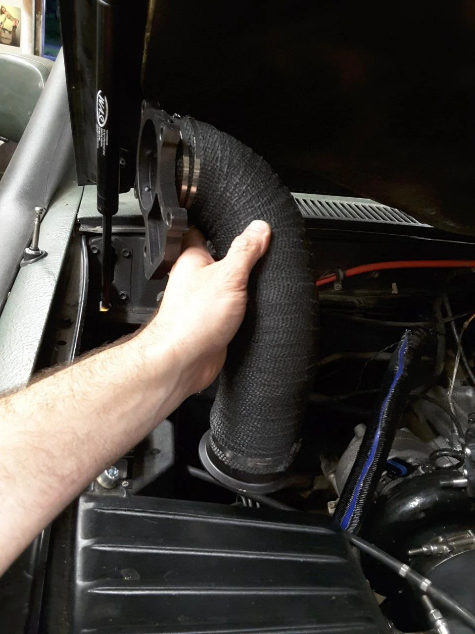

  • Fabricated a 3" exhaust downpipe l then painted and heat wrapped it.View attachment 1285233

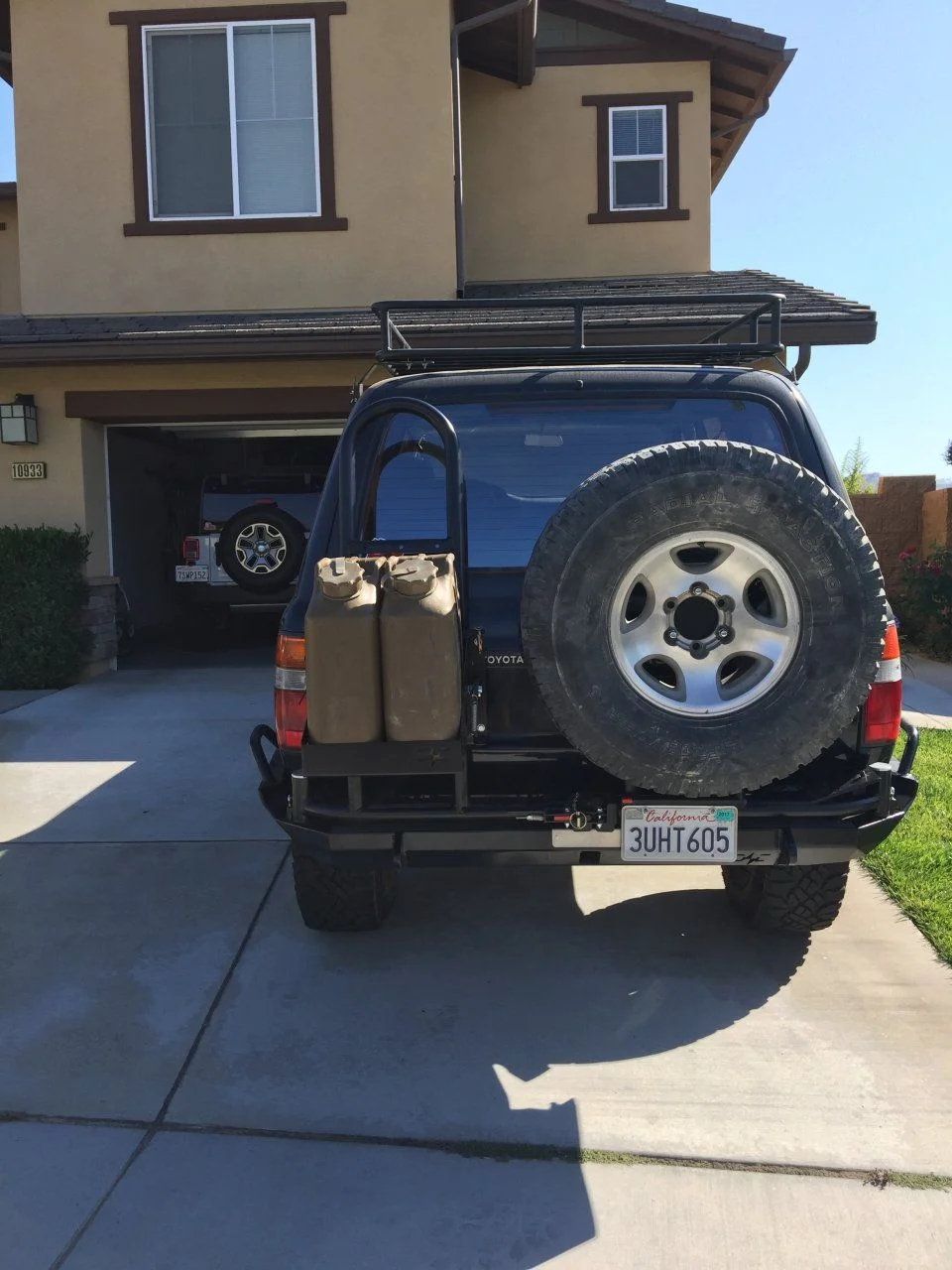

rear winch and aux gas tank?
Rear superwinch lp8500 custom mount and the rear bumper deal is just a piece of 3/16 2x6 I miter cut and capped, fairlead hole deal is a piece of 2x8 tube sideways I welded in. front is xrc 12k in a relentless fab bumper. Vision X lights front and rear and a couple china leds.
The tank is out of a jeep ZJ, 23 gallons ish. I made custom mounts and filler neck and whatnot. Hole sawed out a spot for the stock sender and pickup. Factory tank was in the way for np205 and 14 bolt so its gone. Running 1350 cv with 1350 joint (front and rear) drivelines. Put an air tank from a OTR truck, in place of the factory fuel tank, powered by a puma compressor, the stock puma air tank feeds that tank with a 1/4 dot air line. Takes a while to fill but itll run air tools pretty well.

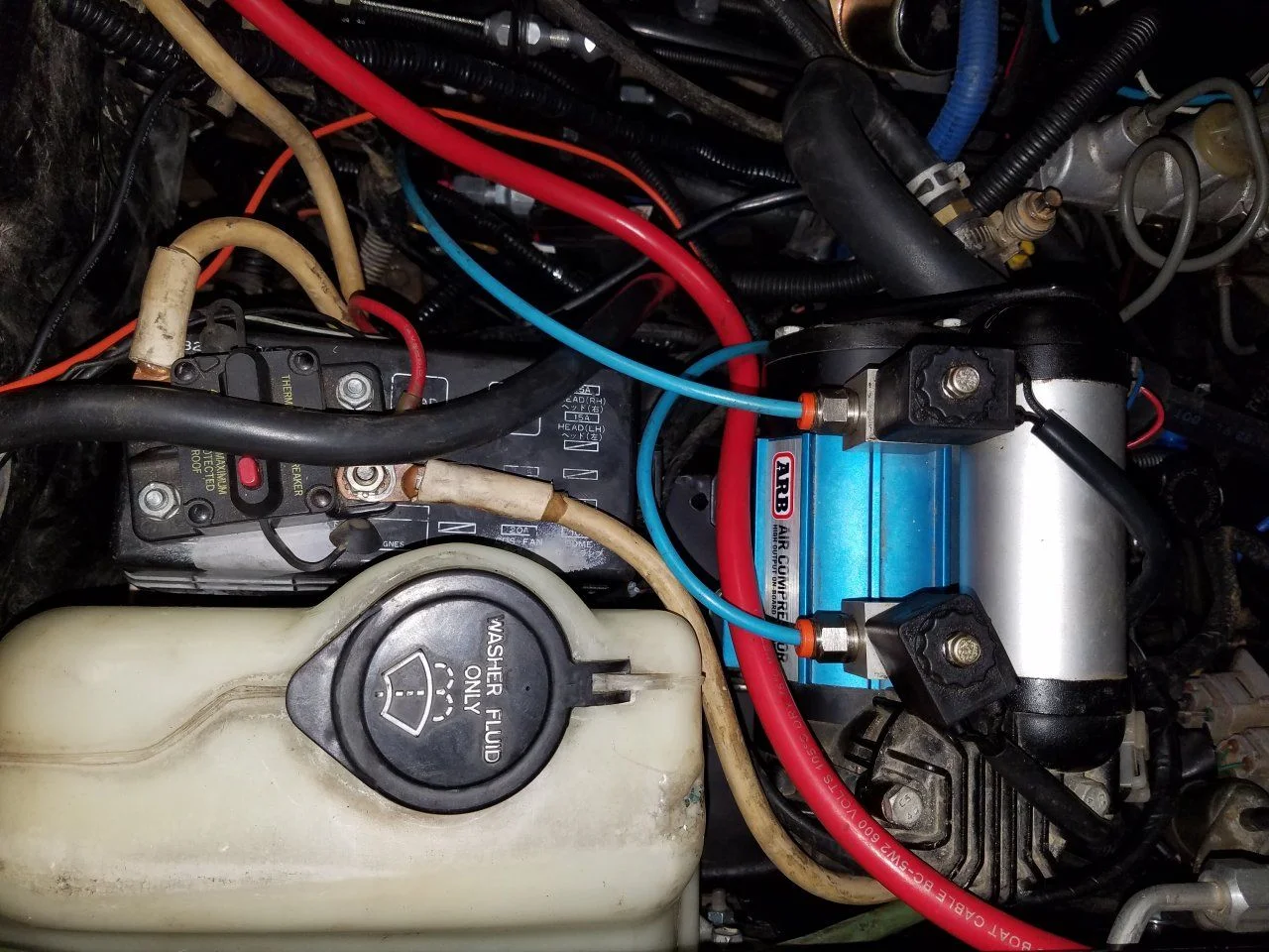

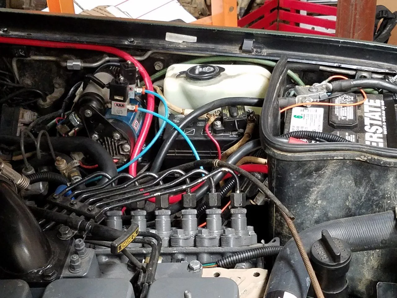

  • Since I have dual batteries and there isn't room for the windshield washer bottle behind the new air clearer, I installed a 1992 windshield washer bottle on/in the driver's inner fender. I had to relocate the fuse block to make room.
    20160704_215824-jpg.1285644

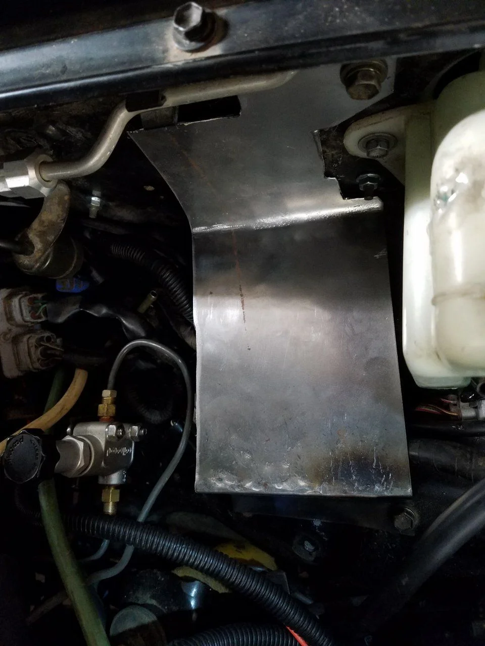

  • Since my clutch master is where my ARB compressor used to be, I had to find a new place to mount it. I fabbed up a bracket that bolts to the inner driver fender and the driver wheelwell, right behind the washer bottle. Gave it a coat of paint and bolted it into place.
    20160704_151438-jpg.1285639
    20160704_215510-jpg.1285645
  • I installed the ARB wiring harness and put the switches back in place.
  • 20160704_134339-jpg.1285640
  • Ran the 4ga cables from battery back to my distribution blocks in the rear. I now have power to the fridge, Puma compressor and amplifier.
  • Ran the battery isolator control wires and voltmeter wires out the passenger side wiring grommet.
  • Installed my completed down pipe.
    20160704_215540-jpg.1285642
  • Removed the clutch slave cylinder and replaced the push rod with a pushrod from an NV4500 slave cylinder (it's about .5" longer than the one in the NV3500 slave I am using. I need to bleed and see if that solved my engagement issue.
