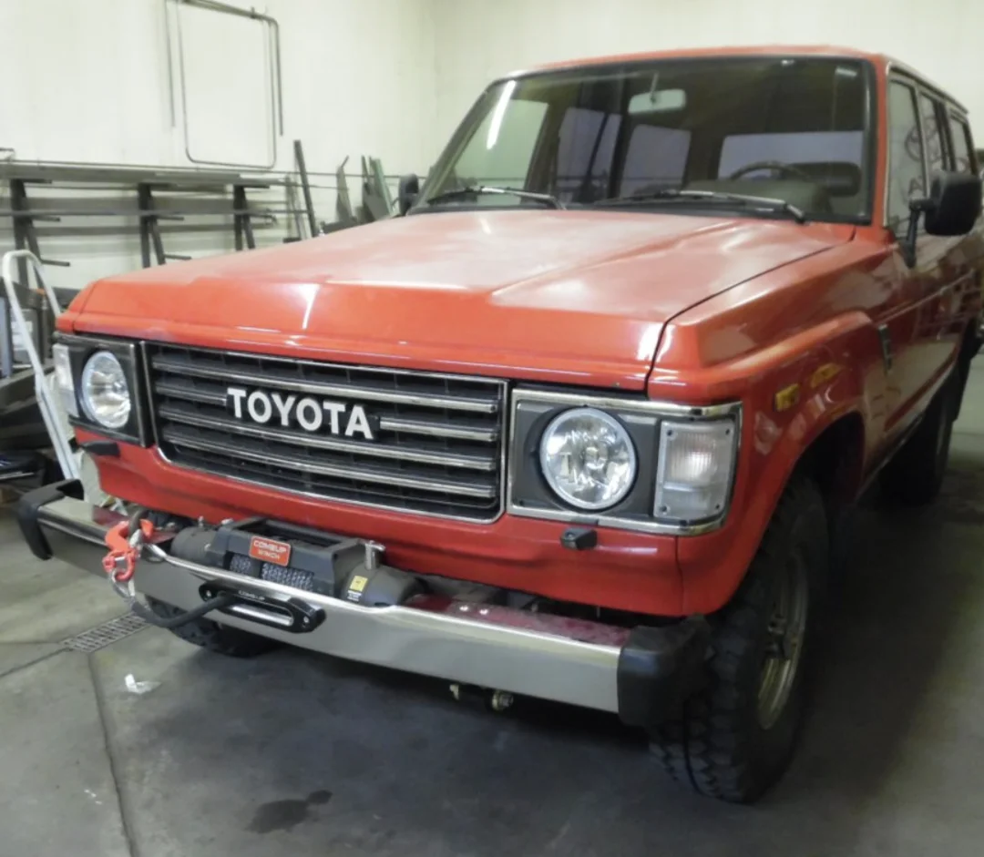

This is so awesome. I always wondered if there was a way to reinforce the inside of one of these with some thick C channel and mount a winch to it. Oem looking bumper but the strength of an aftermarket steel one.

Dude. This is so freaking awesome. Looks like it should have came from the factory that way. The oem toyota winch bumpers are ugly as sin

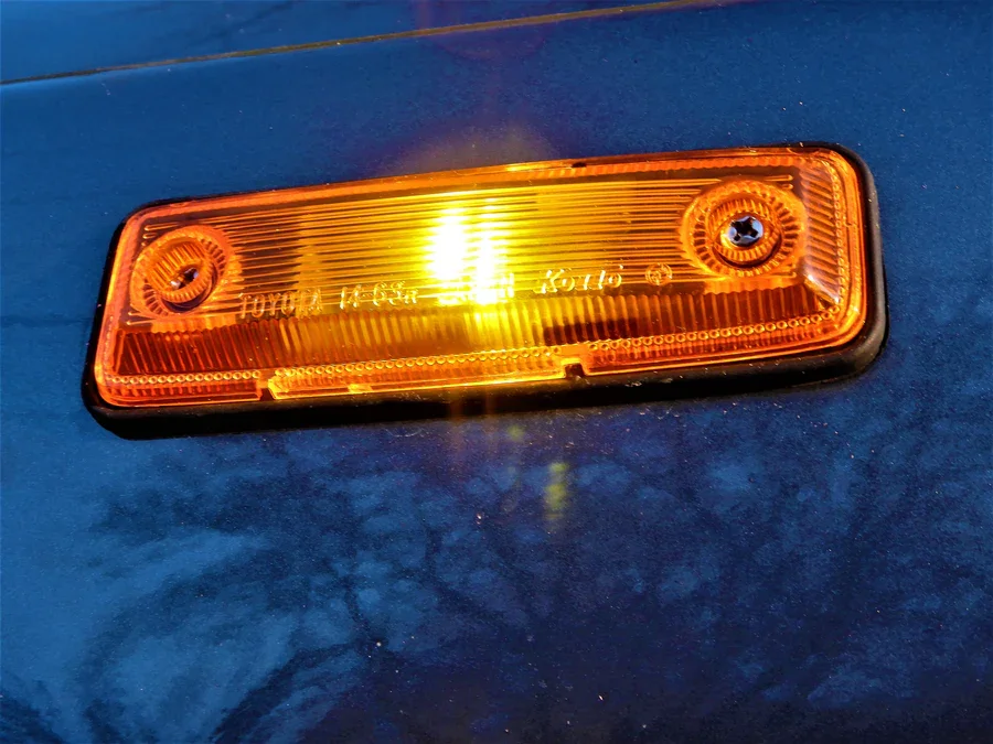

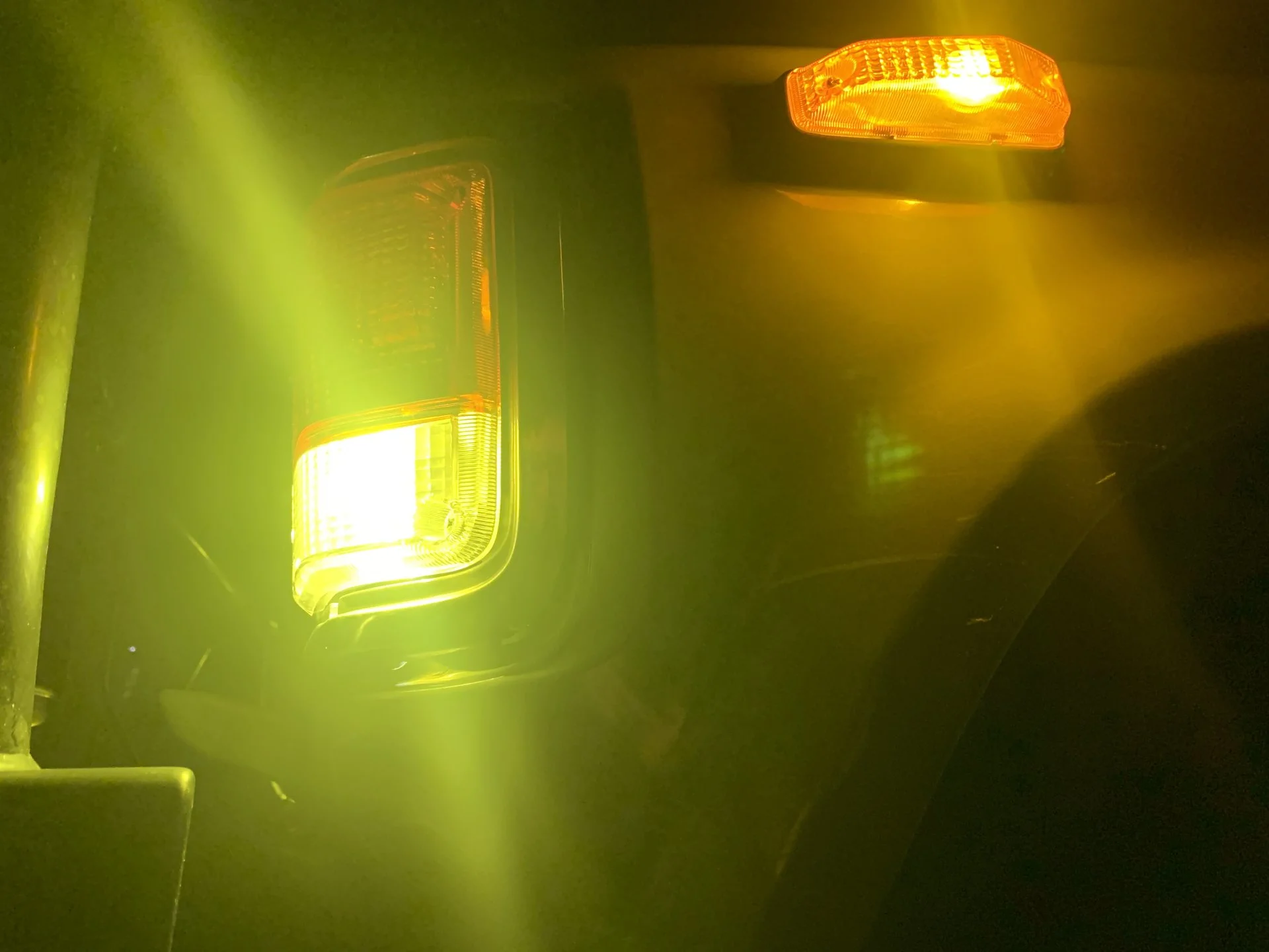

I have fine tuned the JDM Pure Yellow LED diodes in my 10/88 FJ62LG-PNEK with a 60 front end conversion …
I installed originally 8000k Cool white ones first and was …..like yeaaaa 🤔
So so so , too typical rest of FJ60 corner lamps society for me …
Instead of the standard 67 / 87 twist lock miniature single filaments the owners manual Calls for ….?
Using LED Diodes that do not generate any BTU heat to really speak
Of ?
I pondered the how can I install a real Full size 1156 size spec Diode LED ?
Well a little bit of this and a bit of that with a dremmel too to the main bulb sockets housings , nothing to compromise them water tite to be clear here ..
Presto a 1156 is now my norm and bench mark standard
The simply LUMENS difference is significantly substantial in every single way too !
Note : these images have NOT been photo shopped in any way ..
I make this point because typically I do adjust for simple sharpness and brightness 🔆 tone to make good look better ..
But , I feel strongly that the original color tone and sharpness and clarity be shown exactly as original as it should because then others can make a better well informed decision on the whole JDM LED Pure Yellow upgrade and non-USA far away look , feel , fit , form , and function. …
Note : the color tone Lumens of the japan Spec. HJ61 front amber-oarnge side markers
My final thoughts 💭 are simply 1 word. “ SICK “ 😎
I plan on installing the same Rear 2 color / clear and. Red only , tail lamps lenses @TRAIL TAILOR utilized , so I can have balance and pure JDM yellow in the stern as my turn / flasher lens cavity too …

hi ,
there were 2 uniquely different HJ60 BJ60 HJ61 BJ61 non-usa front amber side marker lights used in the EU up north and in japan spec. market regions
- 1st gen. ( aka razer clam lenses )
- 2nd gen. ( aka bubble lenses )
- note : my (
aka's ) i use to keep all 3 styles including the flat & dismal usa-spec. ones all categorized in my world in my head daily , as all amber side front 60 series anything lenses / lamps are also side specific too , as in RH and LH ,
where ALL rear red side marker lights all 60 series globally are simply Siamese in nature , 1 part # fits both the RH and LH sides ,,,,,
make sense so far ............? :wrench: :wrench: :wrench:
if not tell me , i can try to explain differently , its a
water weep holes TECH. topic thing for all front amber ones .....fyi

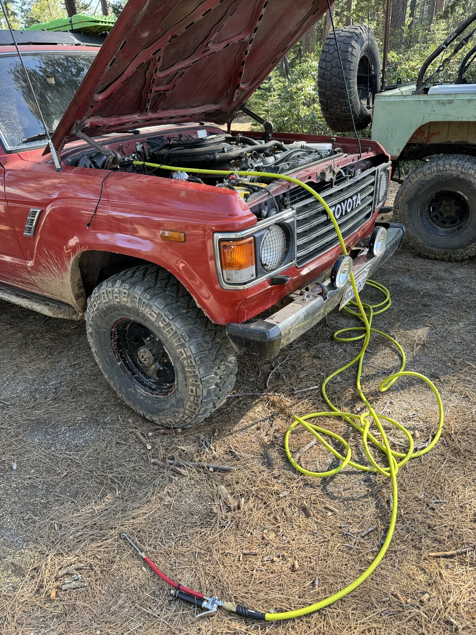

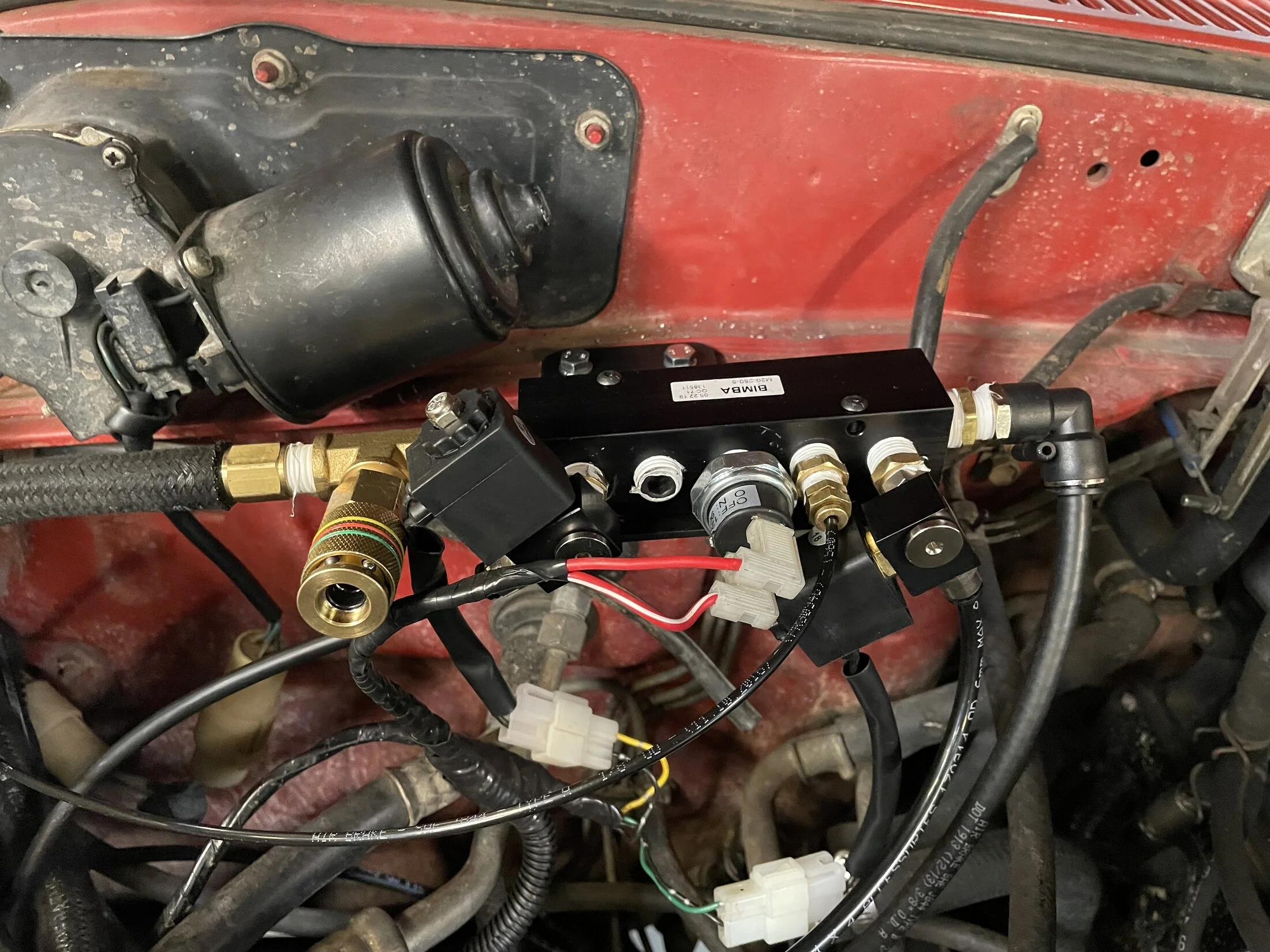

I recently added dual air lockers, 5 gallon air tank and a huge Extreme Aire pump. I can now air up as soon as I hit pavement. I could even run air tools if I needed too. Also added 115 Amp alternator. I’ve finally got 13 volts running through the system with every accessory and set of lights turned on. Wooo whooooo!

What made you choose that pump and tank setup? Looks nice

I worked with Georg, (@orangefj45) at Valley Hybrids on the set up. I had a single ARB when it was just rear locked. Extreme Aire is a California based company and Georg thought their pump would be best for my set up. We had to consider the real-estate I had to work with in the engine bay and this was a better fit overall. The pump works great and fills the 5 gal in about 2 minutes.

I like the tank location, seems to fit really nice!
