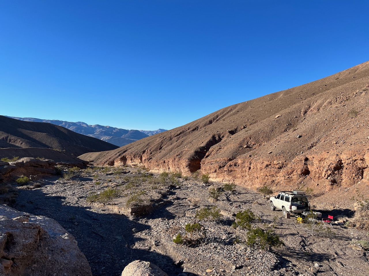

Came back from a recent solo trip to Death Valley with a list of small things to address on the 60 and knocked some of those out over the holiday.
One of many cold nights crossing Death Valley...in this case on the trail to Tucki Mine

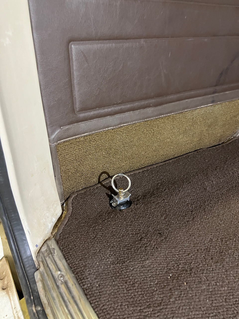

Added tie downs to the rear (hopefully my fridge and other stuff will be more likely to say in place on the next trip). This style allows me to remove the hooks and maintain a flat sleeping surface if needed.

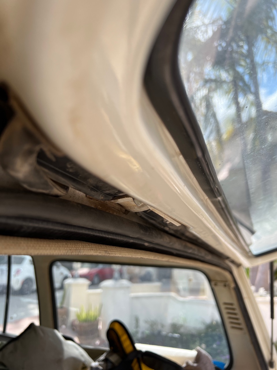

New seals on the hatch and tailgate...after noticing a significant draft during the night. Went with the aftermarket bits from @cruiseroutfit

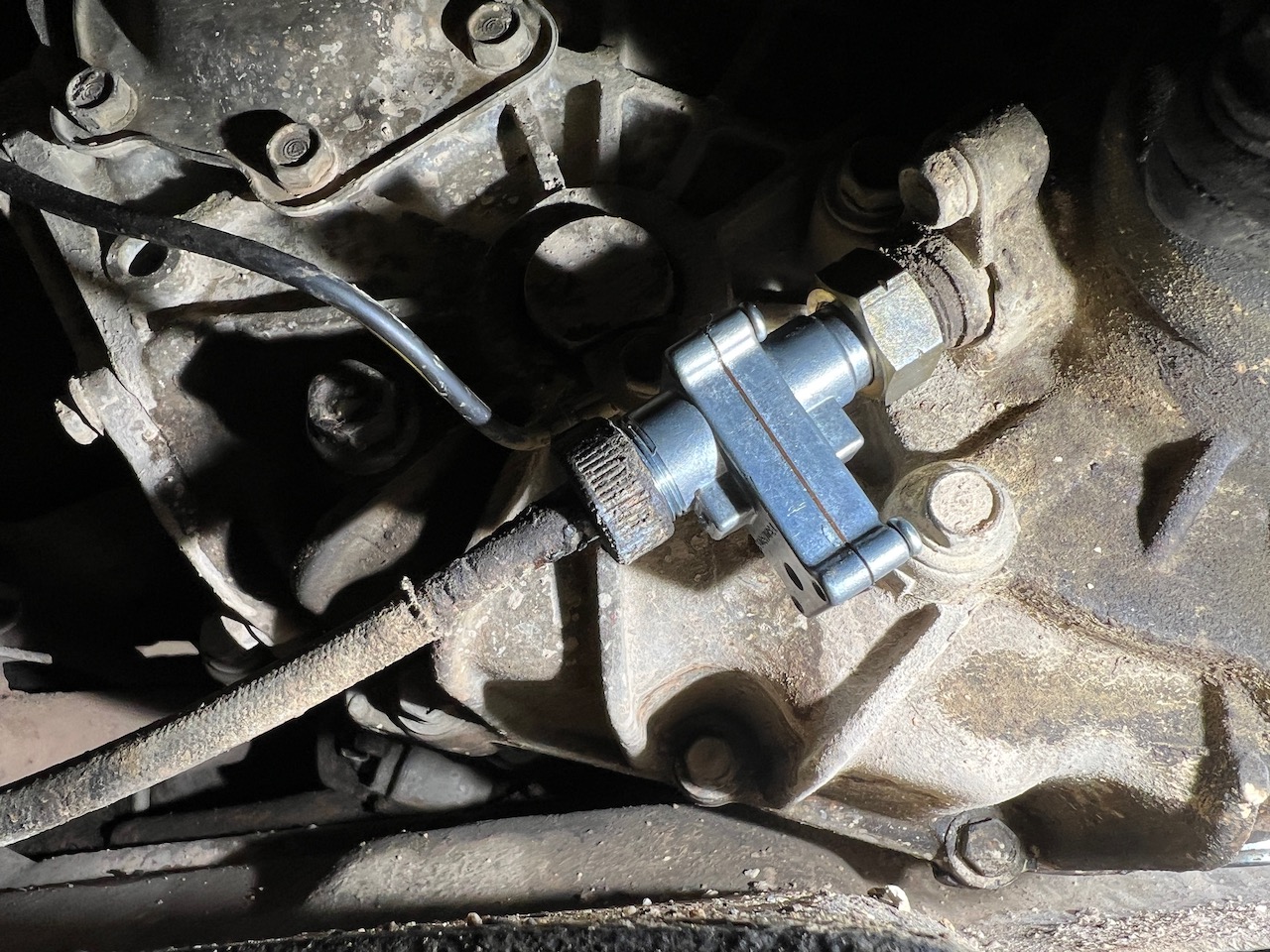

Speedometer correction adapter after finally stumbling across this thread. Thanks to @biomax who recommended Commercial Speedometer Service in Sacramento...those guys are amazing...highly recommended. It is also a fun novelty to have accurate speedometer readings. I actually saw the truck hit 70 the other day (downhill, naturally) and look forward to better gas mileage (at least uncorrected)
I was looking for a marks Speedo corrector that is similar, was it very involved ordering this one? The marks one has to come from Australia
Super easy to work with these guys perhaps aside from having to call and talk to an actual human. Tell them about your truck and what level of correction you want and they'll assemble an adapter for you. I have 33” tires so went with 1.155 as recommended in the thread linked above (which also has their phone number). They built and shipped the day I called. Since I’m in San Diego, I received the package a day later. Can’t really beat that!
Randomly looking at a GPS through various speeds showed spot on accuracy. So, 5 minutes on the phone, a day or so of shipping, and 10 minutes to install. Should have done this years ago!
dang that sounds great. This is definitely on my short list. I can get accurate speed through my GM computer but would be nice to lookat my speedo and it not be 10 mph high!
Thanks for sharing, my question is are you still running stock gear ratio in your diffs.?
Yep! Stock gearing and 33” BFG MTs with probably a bit more than half their tread life remaining. The guys at the speedometer shop should be able to help you calculate the right correction for different gearing. That kind of math is beyond my pay grade for sure!
