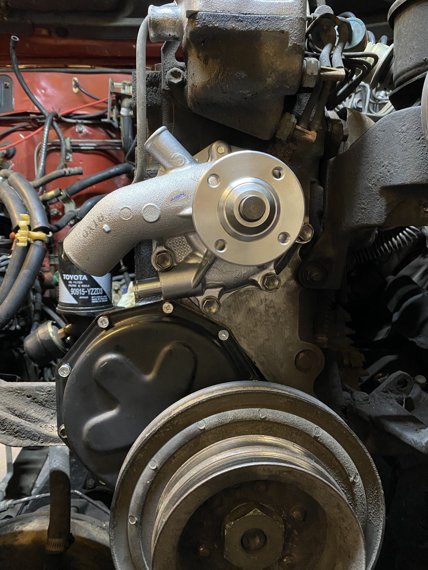

I got the timing plate back on and the cam back in. New water pump and thermostat on. I also disassembled the smog pump and repacked all the needle bearings with grease, the difference it made is wild. Lifters, pushrods and rocker arms will go back on tonight and then I’ll start putting all the new hoses and OEM clamps on it. Finished off with a new mishimoto radiator and 3FE fan clutch.

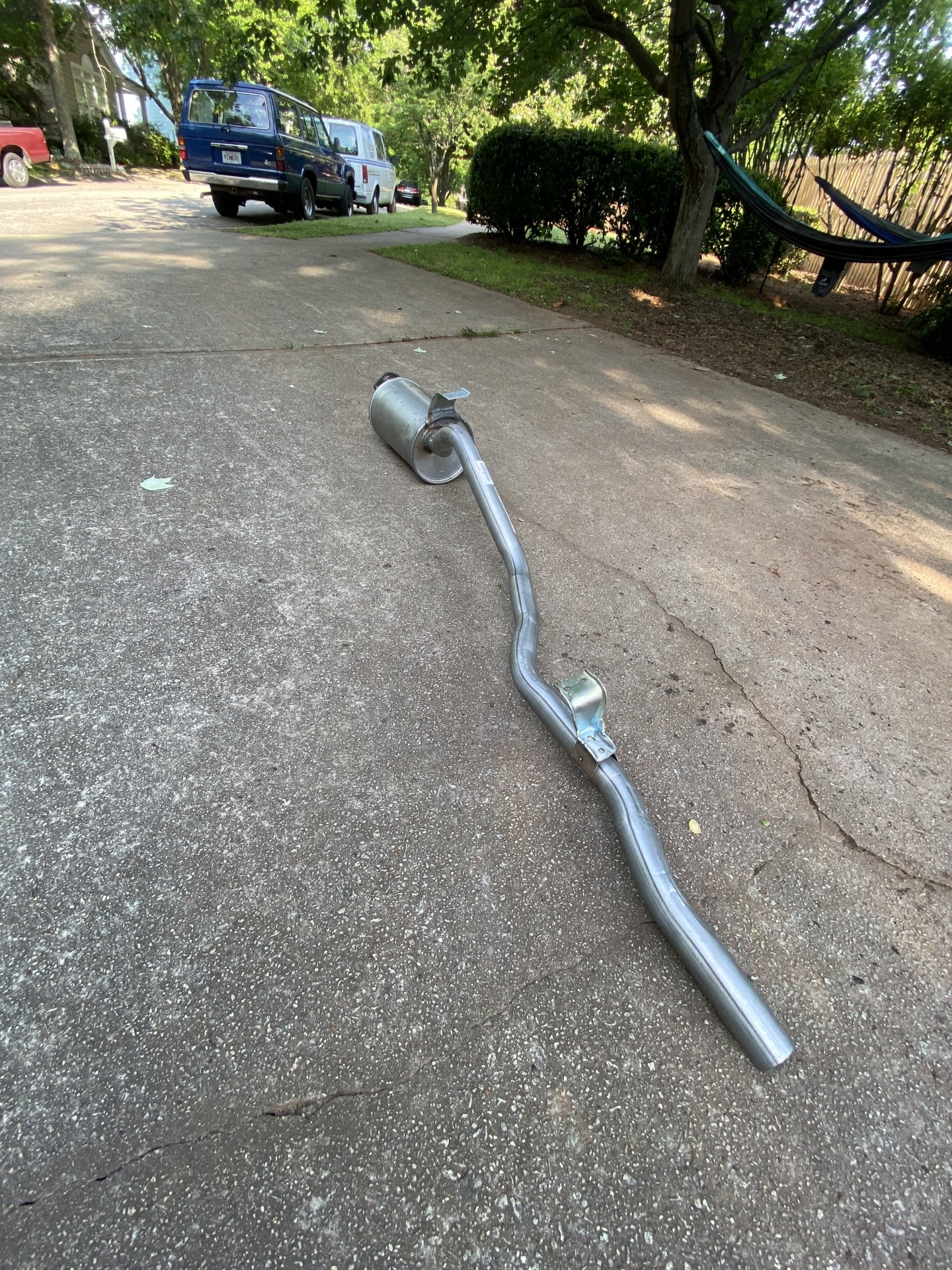

Also had planned on replacing the rear exhaust but someone forgot to order the exhaust pipe cushions. So that is being delayed until next weekend.
