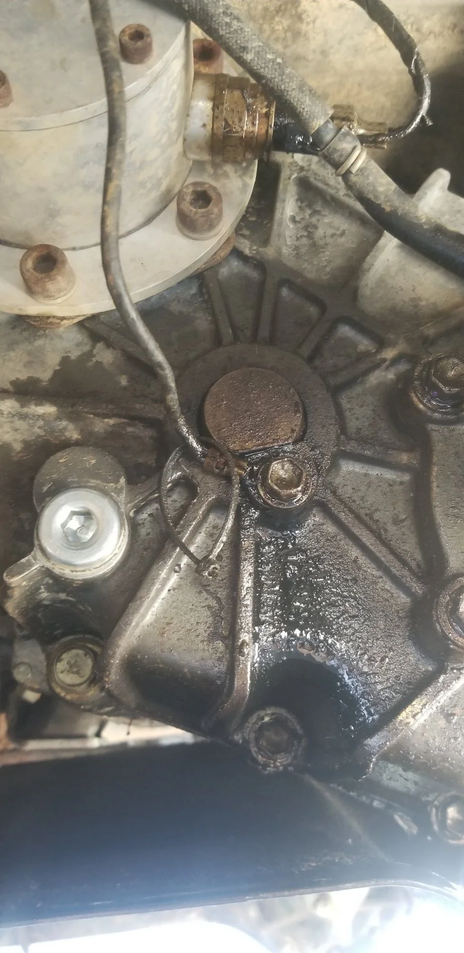

Well this part of the T-case has a good leak when parked on an incline and I cannot for the life of me remember what its called.

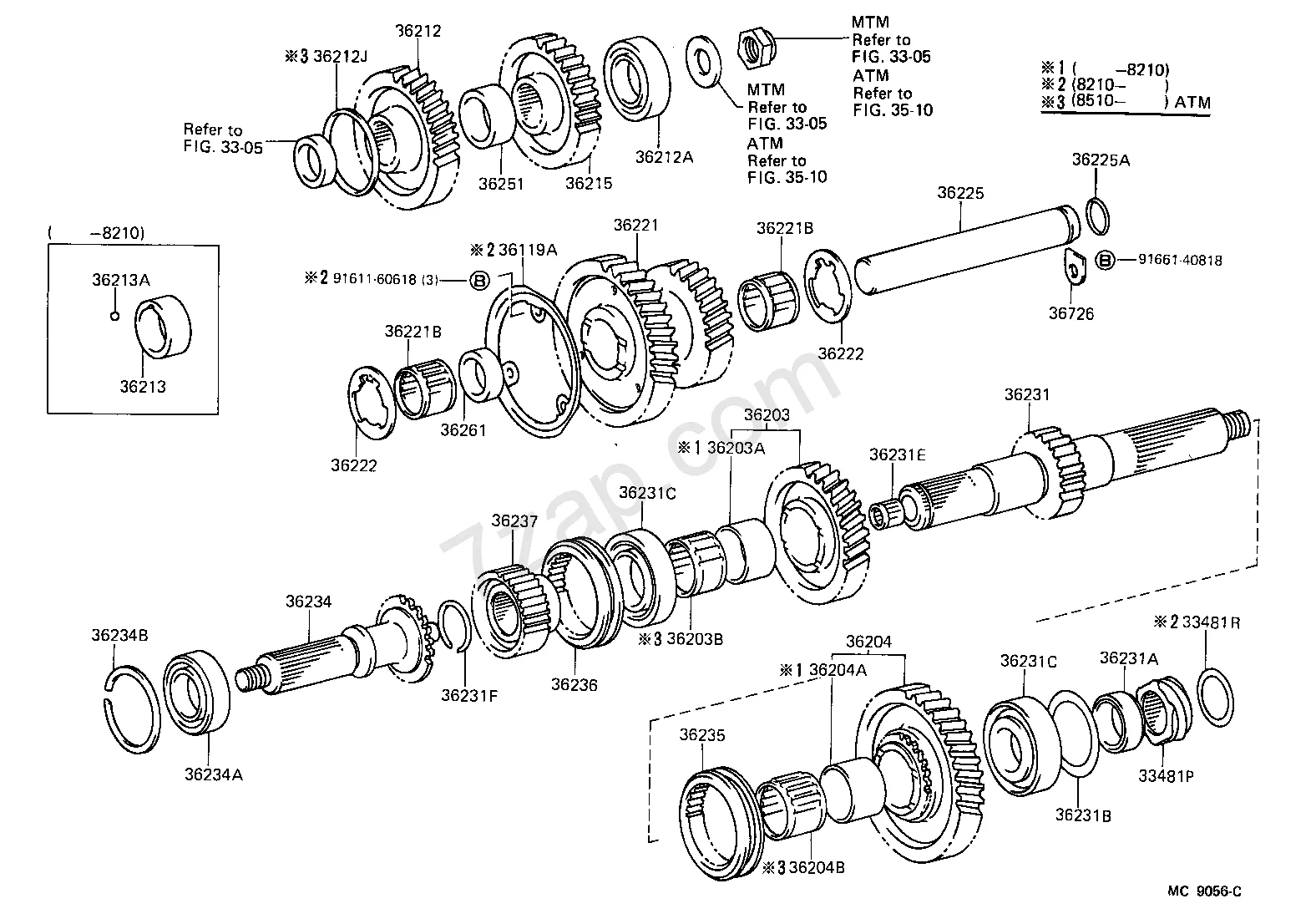

That's your idler shaft, along with the retainer and bolt. There's an O-ring on the idler shaft that seals with the rear half of the split case. Part ID 36225A here:
Unfortunately, you have to disassemble the t-case to replace it.
Life saver. I knew it was a _____shaft. I kept thinking it was the sector shaft. Ill be leaving it leaky til I get a new gear set and H55f. The leak is slow as long as I dont park ass dowhill.
