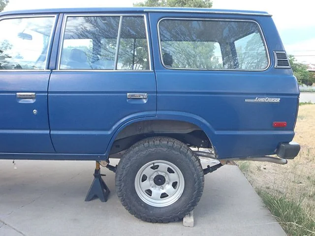

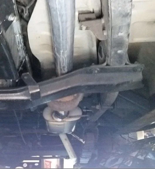

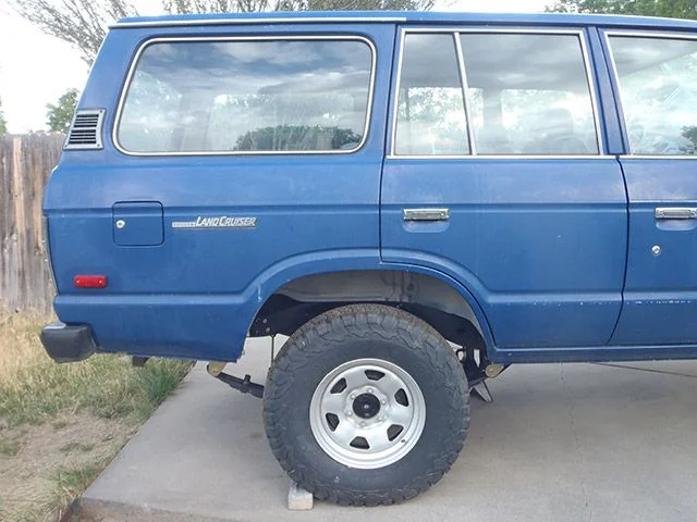

I need to reroute the exhaust to support installation of the sliders... plus the OEM configuration traveling under the frame in 2 locations was odd. New exhaust from the headers back, Y pipe for the O2 sensors, single cat and a fairly quiet muffler.

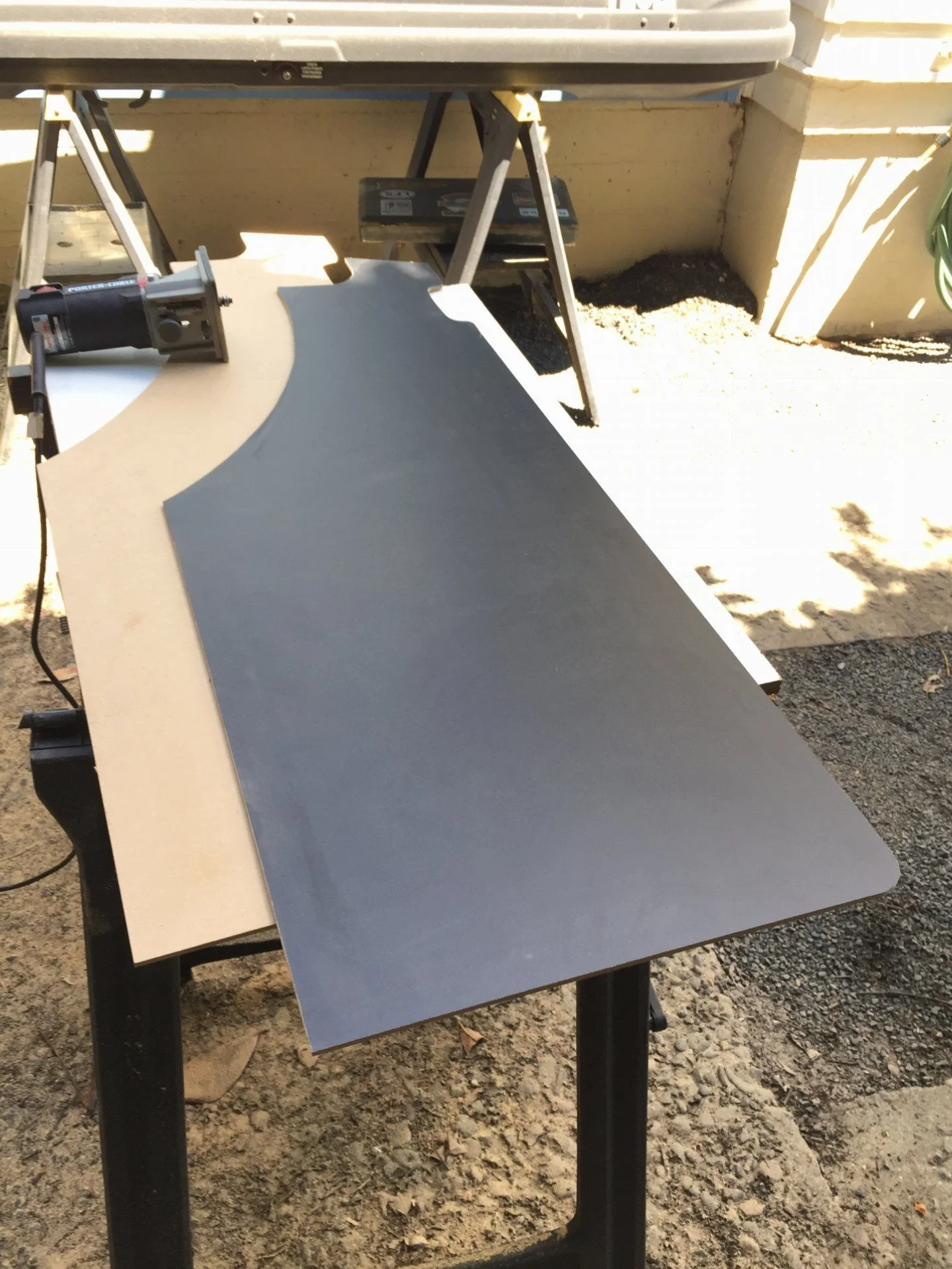

i did make these tho... this is not "bolt on" - still a work in progress though.

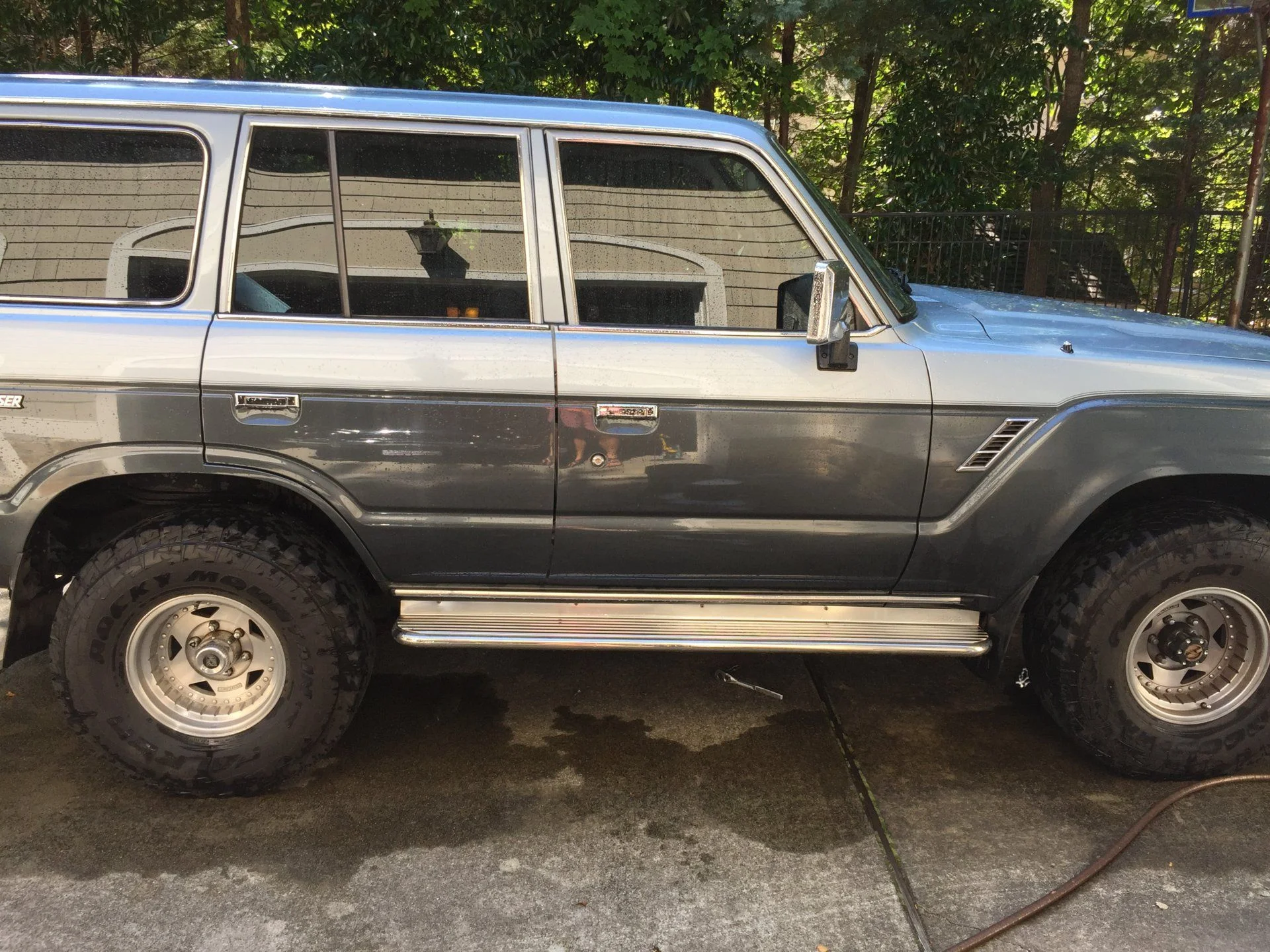

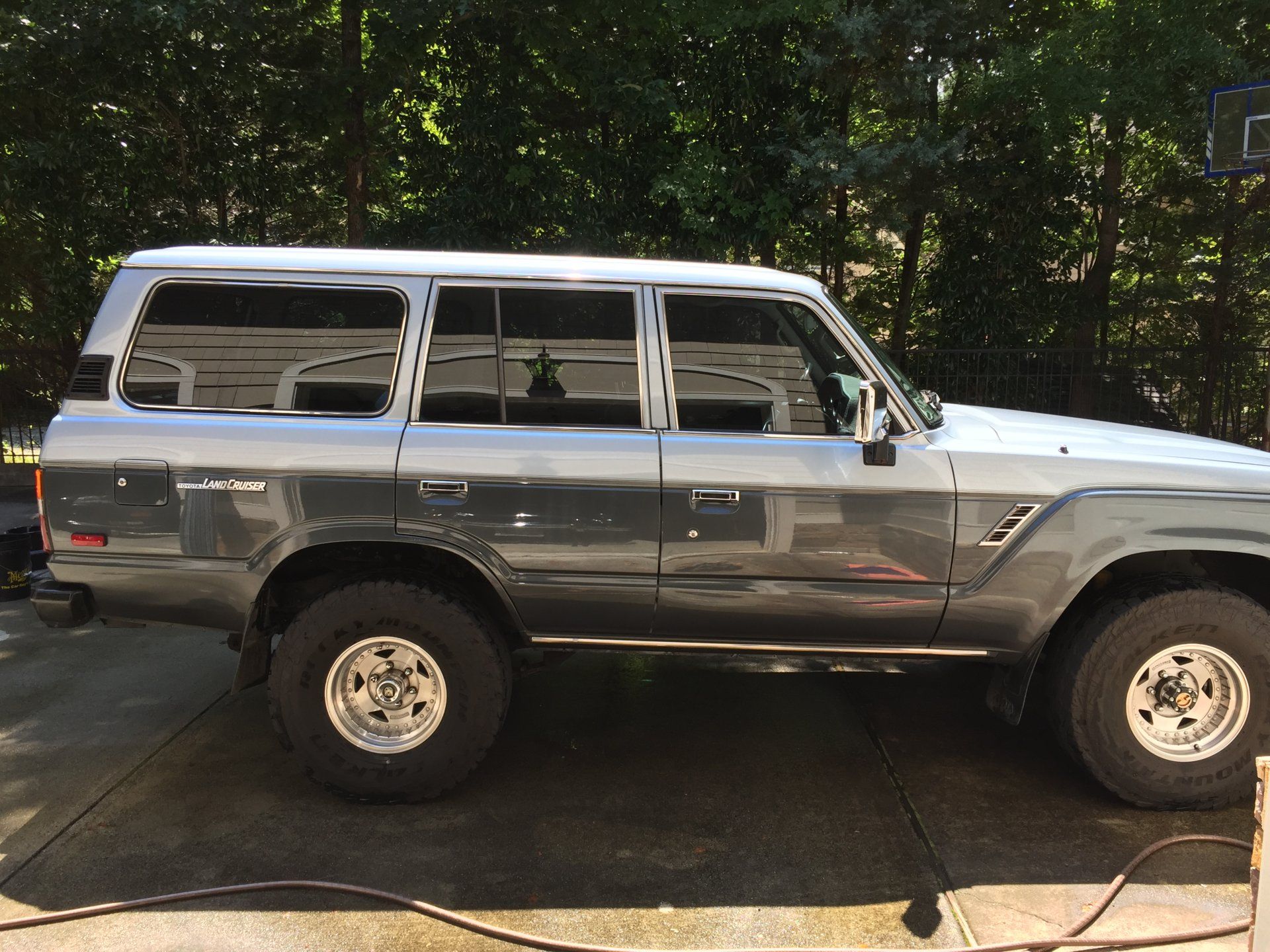

Pulled the running boards off my truck (they were on when I bought it), rotated tires, and did a valve adjustment. Also, dad and I did a 30 mile bike ride this morning so it was a full day! I also got the truck inspected and it passed with flying colors. They did give me a hard time on the tint.

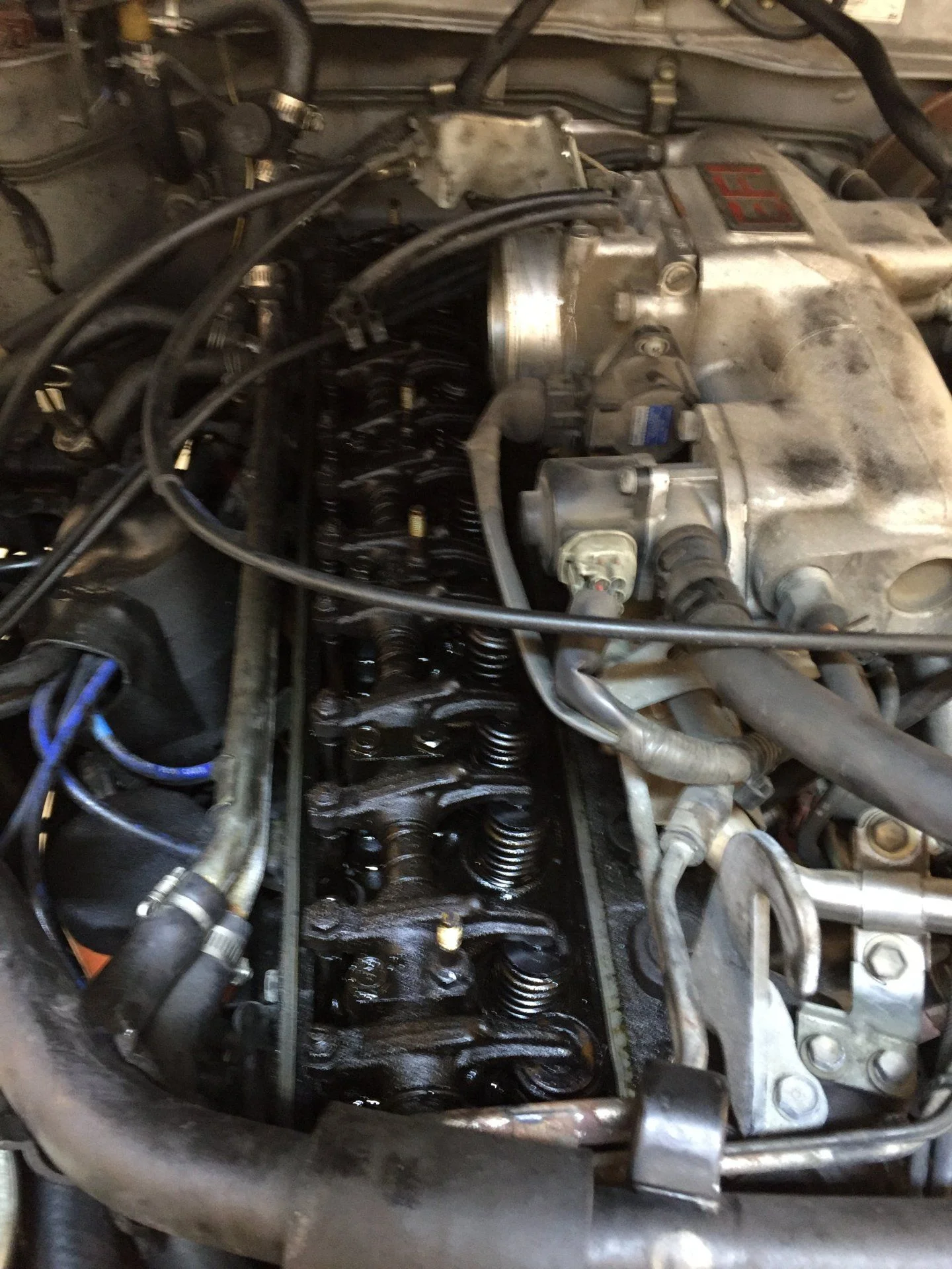

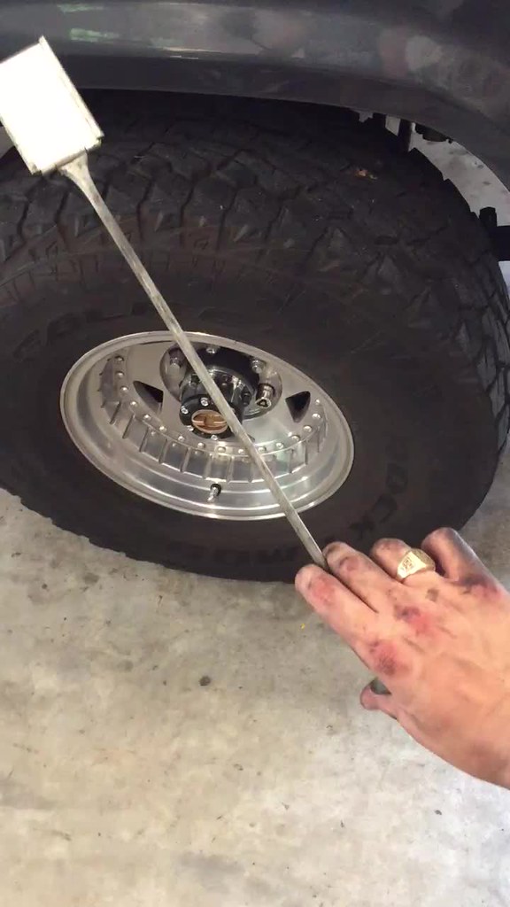

For the valve adjustment, we found the easiest way to locate the top dead center on the flywheel was with this tool. It does a fantastic job of making it easy to see when paired with a flashlight. I can't figure out how to embed the video but it is located here (IMG_2049.MOV)

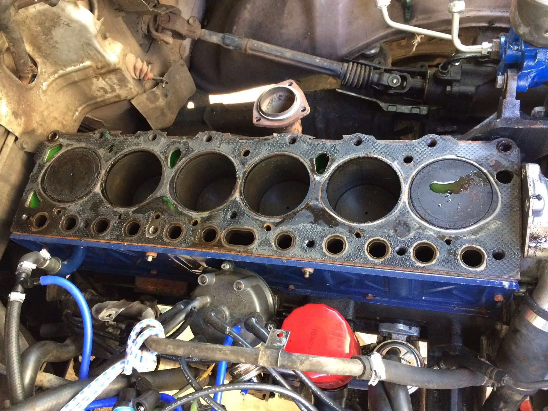

The weekend ain't over yet and neither is this weekend's project... should be back together by tonight.
Cool to see that. I appreciate the pictures. Amazing how not heavy the head is when it's held by a cable and big length of wood between two people.

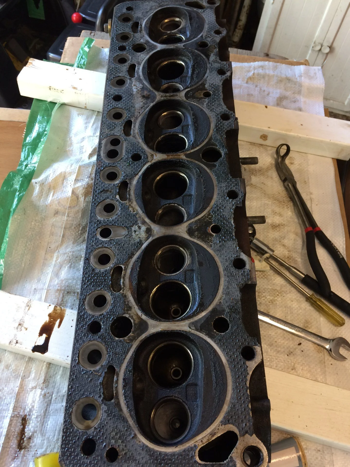

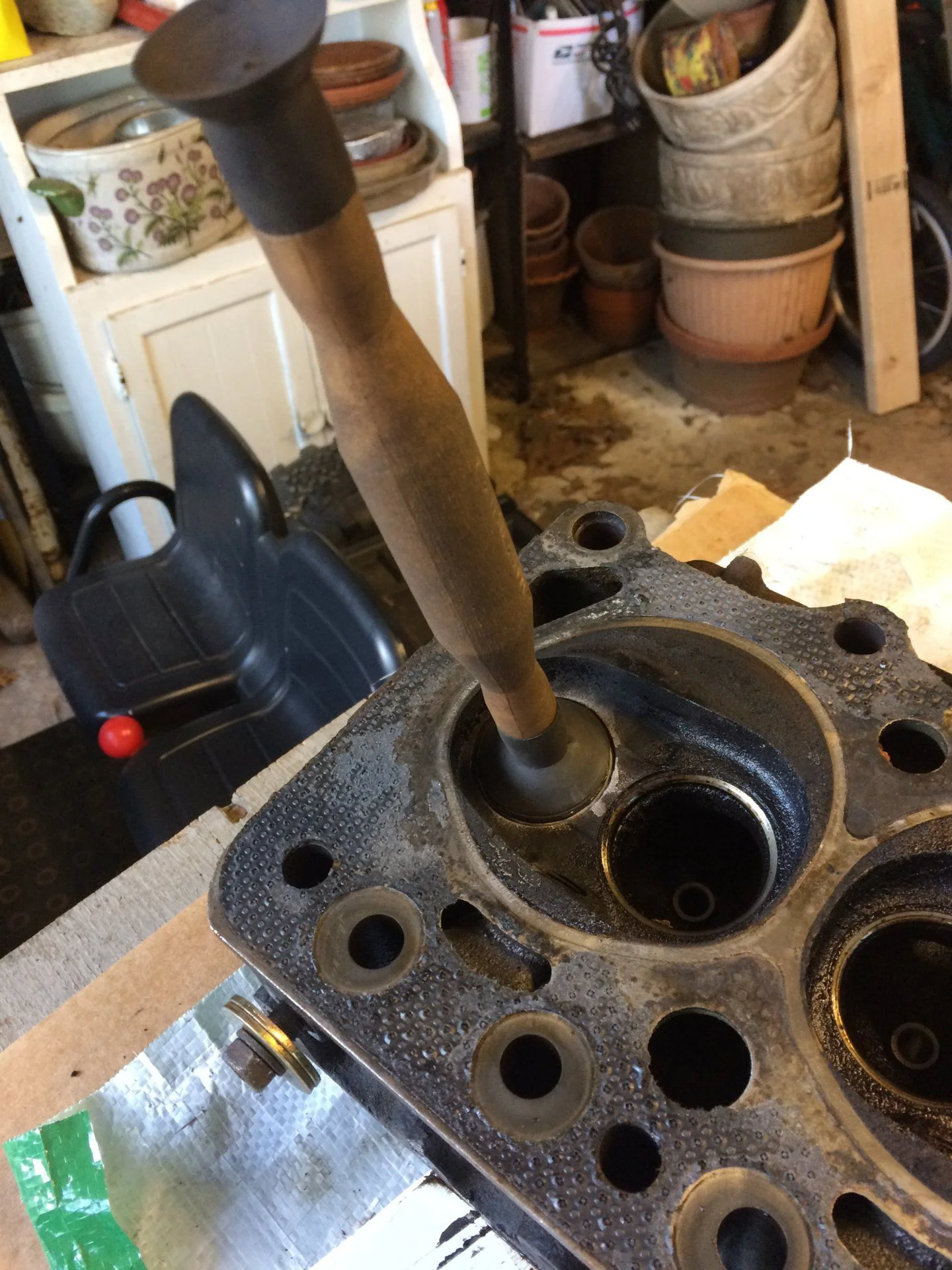

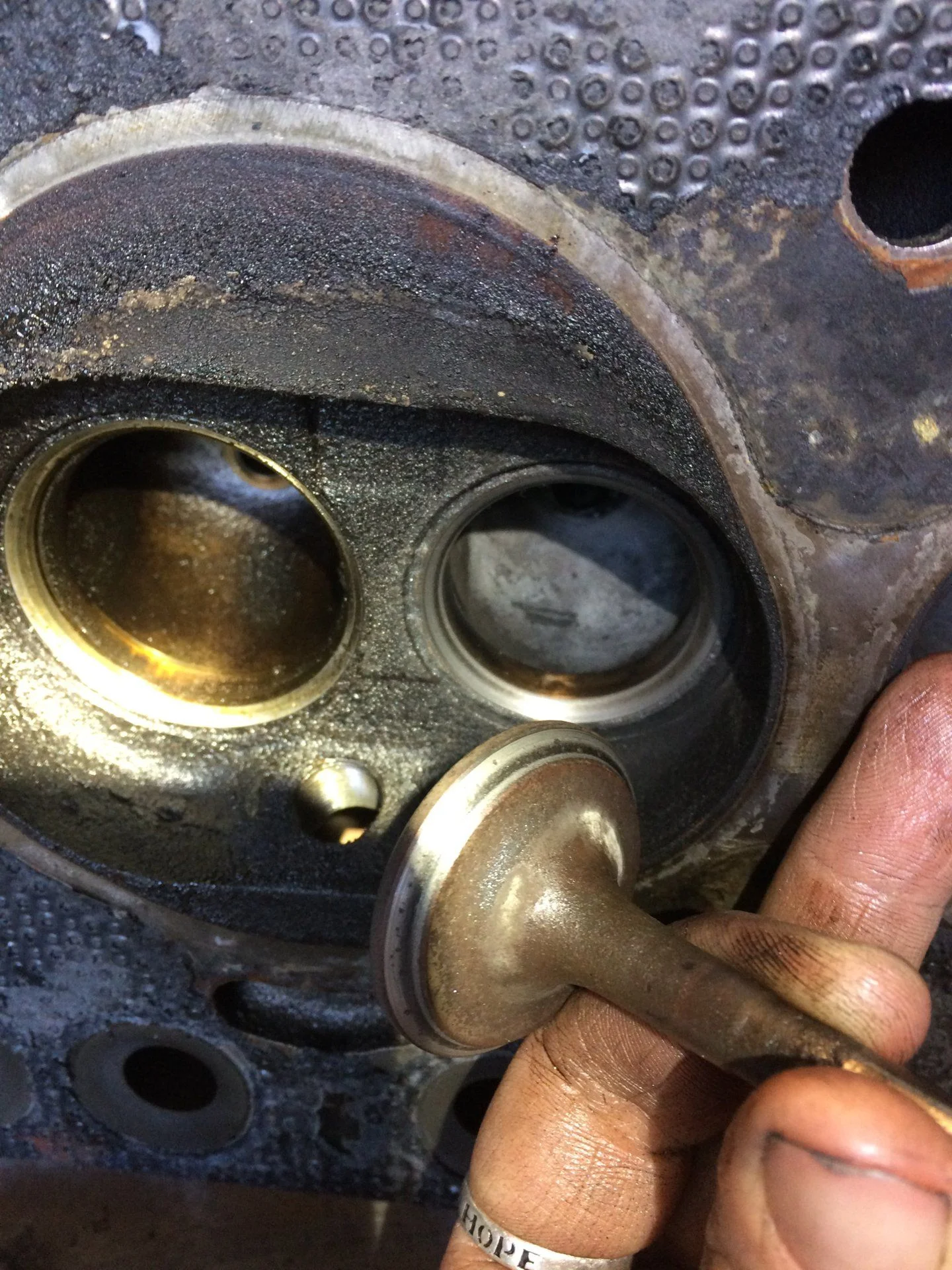

I'm not going that deep but yeah mines off now too. I did try a new art form... lapping valves. What a absolute pita.

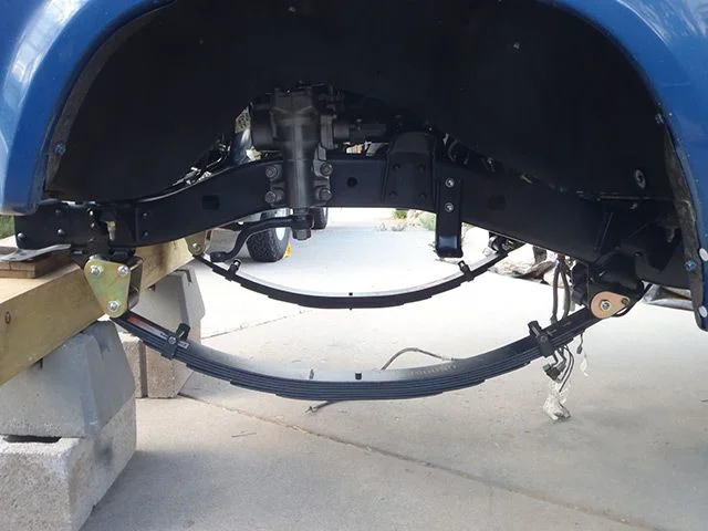

Got the replacement shackle plate in the mail from Cruiser Outfitters on Friday so I finished the installation of the front OME springs yesterday:

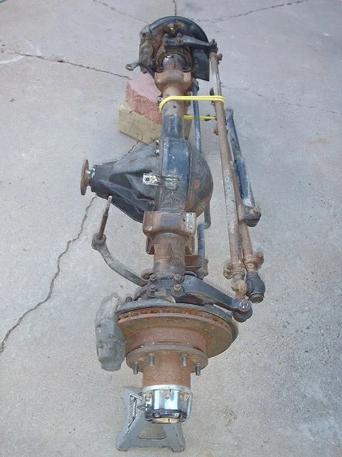

I started tearing down the front axle from my '89 FJ62, which is going into the '86 FJ60 project vehicle. I'll clean and paint it, install the knuckle rebuild kit, and replace the tie rod ends. Here's how it sits now:
I've got to get the front end complete to catch up with the progress on the rear axle and suspension:
F, The way I used to lap valves on my race heads between races was to run the valve in and chuck the stem to a drill. Slather the valve and seat with lap compound and then run the drill on high while adding a bit of pulling pressure. Perfect results every time.

That's how I did that last one held side to side, valve and its seat. I'm just not 100% how much change I ought to get from them. They are quite pitted. Last thing I want to do is screw up the seats. I'm very open to any and all words from folks who know better.
Anything is better than what they were probably. Its a 2F and while a nice polished un-flawed set are optimal... they will be fine. Most shops would probably say to replace both since they are pitted but I've re-run F/2F/Chevy 235/292 etc valves with no problems for years.
I keep new Toyota OEM valves and Japanese OEM replacements at the warehouse just in case, but unless I'm doing a full rebuild, I hardly ever replace the valves, just clean them up.
Thanks Jason. That's just what I needed to hear. I've been using that brass brass w/ the valves in the drill so I can push or not push too hard on the faces. Stems too? The intakes are super laden w/ carbon. Any tricks to getting it off?
Brake cleaner and steel wool or a Scotch-Brite pad.. Even an SOS dish pad works well in a pinch.

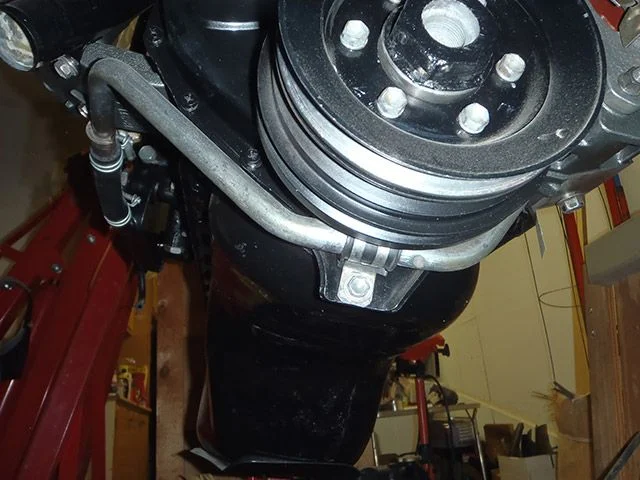

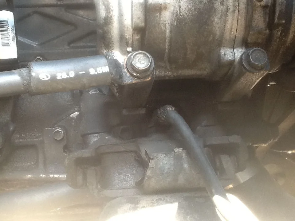

Anyone know how to get this bolt out? I want to remove the lower oil cooler pipes to replace some hoses and this bolt is covered by the bracket/pipe! Is it bent or is this how it always is?
Here's how it's supposed to be:
The upside of still having the 3FE on the engine stand in the garage is it's easy to get quick photos. The downside is it's still on the engine stand in the garage :frown:.
Thanks! That is one clean engine! I'll see if I can pursaide it back into the right position. Is it still available new?
Also, how long is the rubber hose from the tube to the pump supposed to be?
The clamp and grommet are no longer available separately, but it looks like the pipe, including the clamp and grommet, is available, but it's $76.40 retail.
The hose to the pump is 4-1/8" long.

Couldn't you just use a rubber lined pipe clamp for 1.29 at most hardware stores?

Thanks a lot for the measurement!
One of the pipe mounts doesn't even line up. Not sure how it got all buggered.

If I ruin the clamp that is the plan! ;) The pipe itself seems to be in nice condition thanks to a healthy coating of oil.
